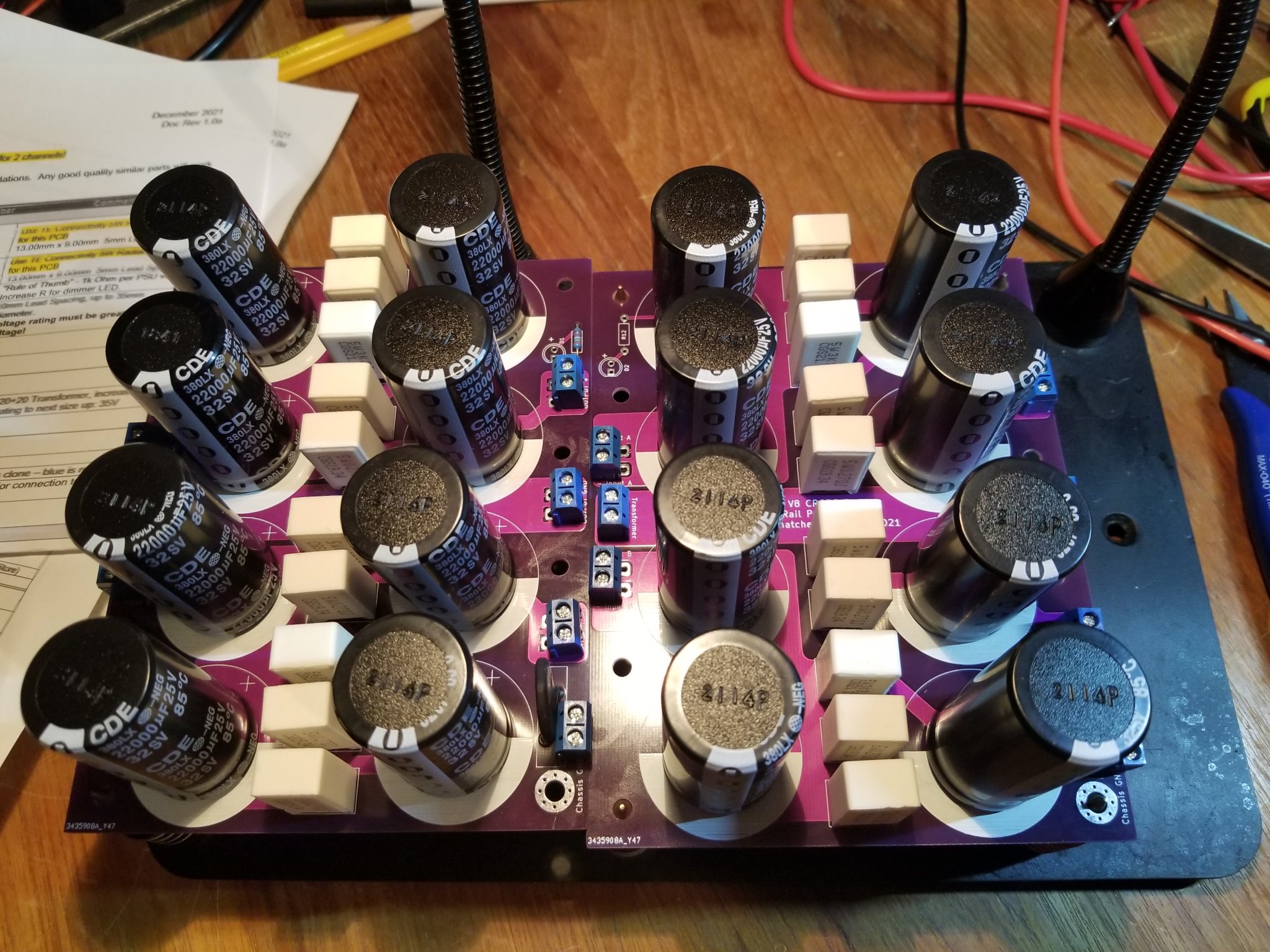

The Digi parts arrived today and got all laid out for the Aleph J 30 build. The Mono PSU PCBs went together in a wink -- here's what they look like (see attached).
Mr. Thatcher seems to have a gift for designing good looking PCBs. A certain symmetry and round versus rectangle theme that works on the visual level. Let's hope that they sound just as good and that I can figure out what the Transformer Center Tap connects to...
Will be doing the circuit boards tomorrow and having all ready for the chassis when they come. Takes a while to get the heatsink drilled and tapped and since there are two chassis, one for each channel, there are two extra, unusued heatsinks. One in each box.
Wonder if:
A) The rectifiers should be mounted on the blank heatsink to reduce temp and,
B) If there is a way to share the heat from the active heatsink to the facing one. A reflective rod, for instance? Probably not the case I think.
But this is one fine build and the design and parts are suggestive of an upcoming success. Hope so!

The center tap connection came about when I did an amp restoration that had a center tapped transformer. If you're using a standard Antek or similar with 2 bridges you will not be using that center tap connection.
Nice pick using the screw terminals! The idea with those PCB footprints is they're good for QD spades, bare wire, or screw terminals. Pick whichever flavor you prefer.
How did you like working with the tall 5W resistors?
The rectifier on the chassis floor is fine, no need to mount it to the heatsink.
What chassis did you get? I imagine you'll simply end up with an unused heatsink per amp. Gianluca is supposed to have a mono chassis option available any day now.

The tall 5W resistors were easy to work with if you use a simple technique: Place them all in their slots, tack them with tape just strong enough to turn the board over then allow them to provide a level support for the leads all on their own -- leads can then then be soldered 'en toto' and all will stay in place and be tight. The same technique is used for the screw terminals as they have a tendency to drift and not seat completely.

The baseplate will be fine for heat dissipation of the rectifiers, plenty have done that in past builds.
A little tip - I always apply some mica goop between the end of the heatsinks and front panel so that heat dissipation is easily shared. That can help in your 4U/300 build with using the other blank heatsink but it's really not that big of a deal.
I do not see an R12 resistor you mention but if you have two power supply boards and you want to use one R11/LED combo to identify that that PSU board is working and use the other R11/LED combo for front panel display that shouldn't be an issue. Many builders will actually mount both LEDs on the front panel so they know each mono PS is functioning. Up to you.

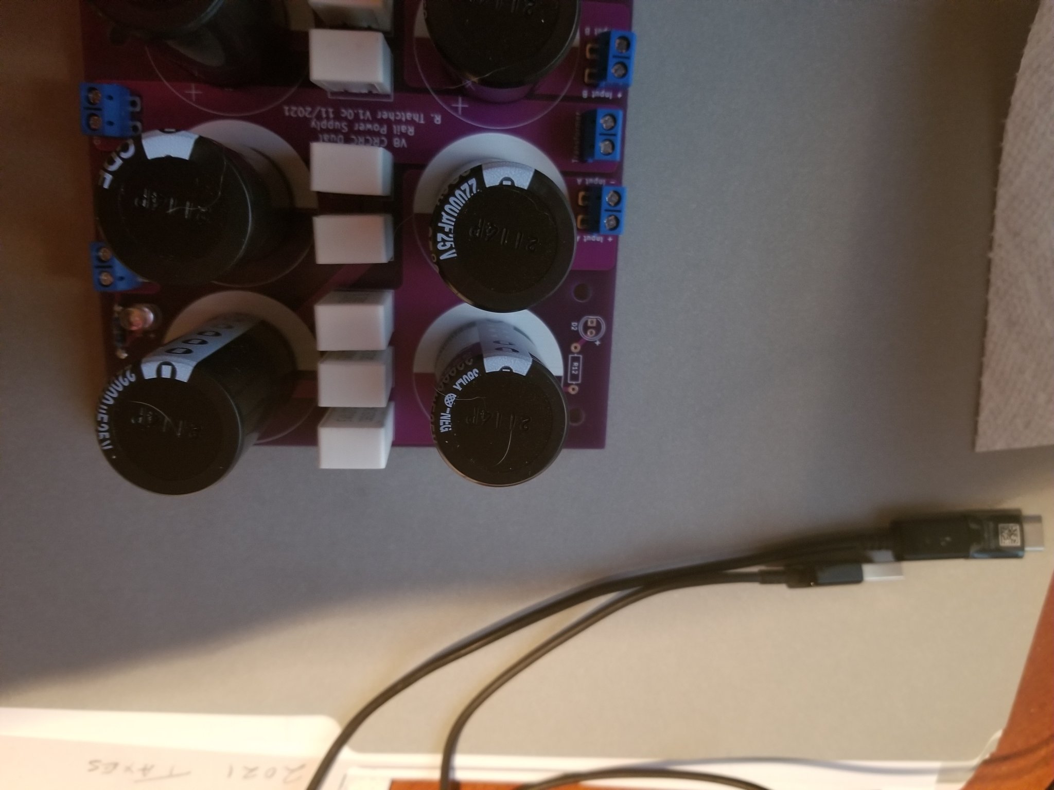

Thanks. R12, BTW is on the other side of the Mono PCB board facing R11. My concern is if I use this will it require the same 25k resistor as R11 and are there any other reasons to use just one or the other.
@Craigl59
No, I mean thermal paste (mica goop is a proletariat’s way of saying it here on diyaudio). Thermal paste is a thermally conductive compound which helps to maintain a good interface between thermally conductive surfaces such as between a semiconductor (ie. MOSFET) and heatsink or between heat sinks themselves. In your application, since you have the MOSFETS on one heatsink (which I am assuming you are using Keratherm or similar to be the interface between the MOSFET and the heatsink), you want to be able to use the other heatsink as well right? Well, one way, is by enhancing the thermal conductivity of the front panel which is attached to both heatsinks. Wakefield makes nice thermal paste and they come in various sizes. You just wipe it on smoothly (and thinly); you won’t need much.
I wouldn’t SEAL anything to be honest. You may need to remove the panels for some reason. So no plumbers seal stuff required!
It appears R12 and R11 serve the same purpose… they are dropping the current to not burn out the LED and a 25K resistor is a wise choice. LED resistor calculators online will help you determine this value in the future for your other projects which may use different colored LEDs that have different voltage drop values (available in the specifications of the specific LED you are using). It is just an application of Ohm’s law. Here is an example: https://ohmslawcalculator.com/led-resistor-calculator
You will find that values of 10K to 20K work well for a lot of them but it’s always best to calculate and double check things. Randy’s rule of thumb that he uses 1K per volt works fine. You can always use different values if you find that the LEDs are too dull or too bright.
Best,
Anand.
