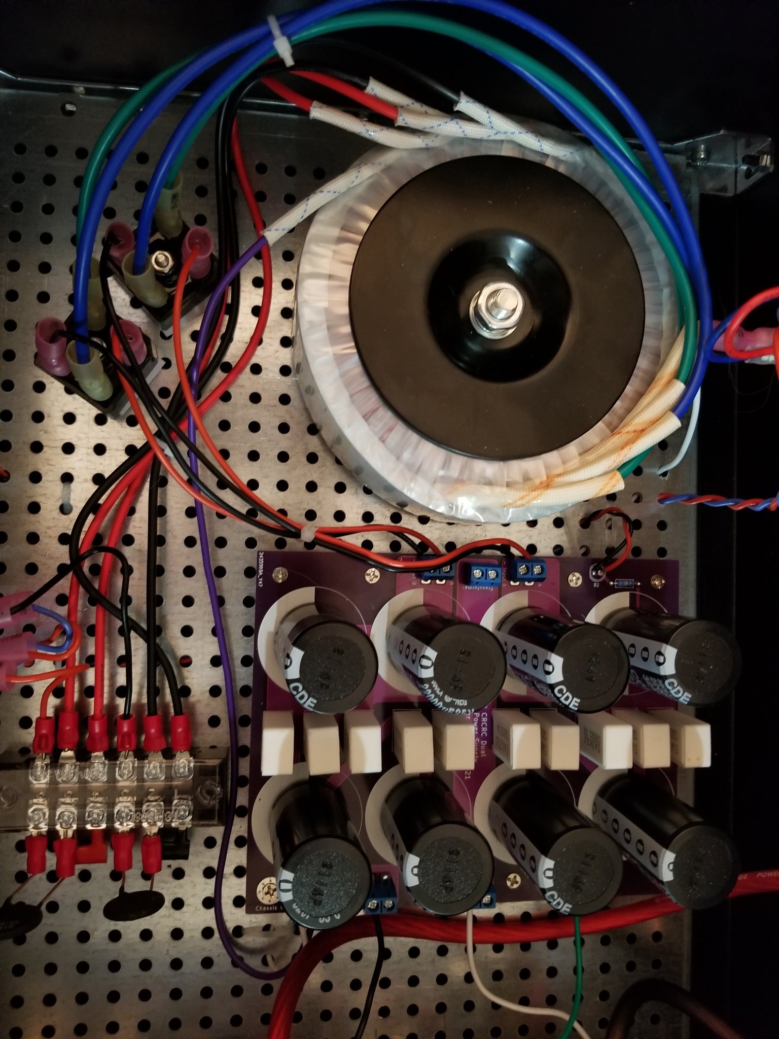

Am assembling all of the stuff and have two questions:
1. The Antek Transformer has an extra, purple wire coming off of it and it appears to connect to the middle windings as shown here:
https://www.antekinc.com/content/AS-2218.pdfIs this a center tap and should it be connected to the center tap connection on the mono PCB?

#1 - see build guide "Wiring" section, or search for the word "purple"Am assembling all of the stuff and have two questions:

Thanks, Randy. The purple goes to the chassis ground on the PSU PCB where it will join with the earth ground off of the power line. The R2 as you so carefully describe, has been measured from the center pin to the pin underneath the adjustment screw -- as shown on your fine PCB with the white dot.

Purple to chassis direct is also fine, no need to go to the PCB.

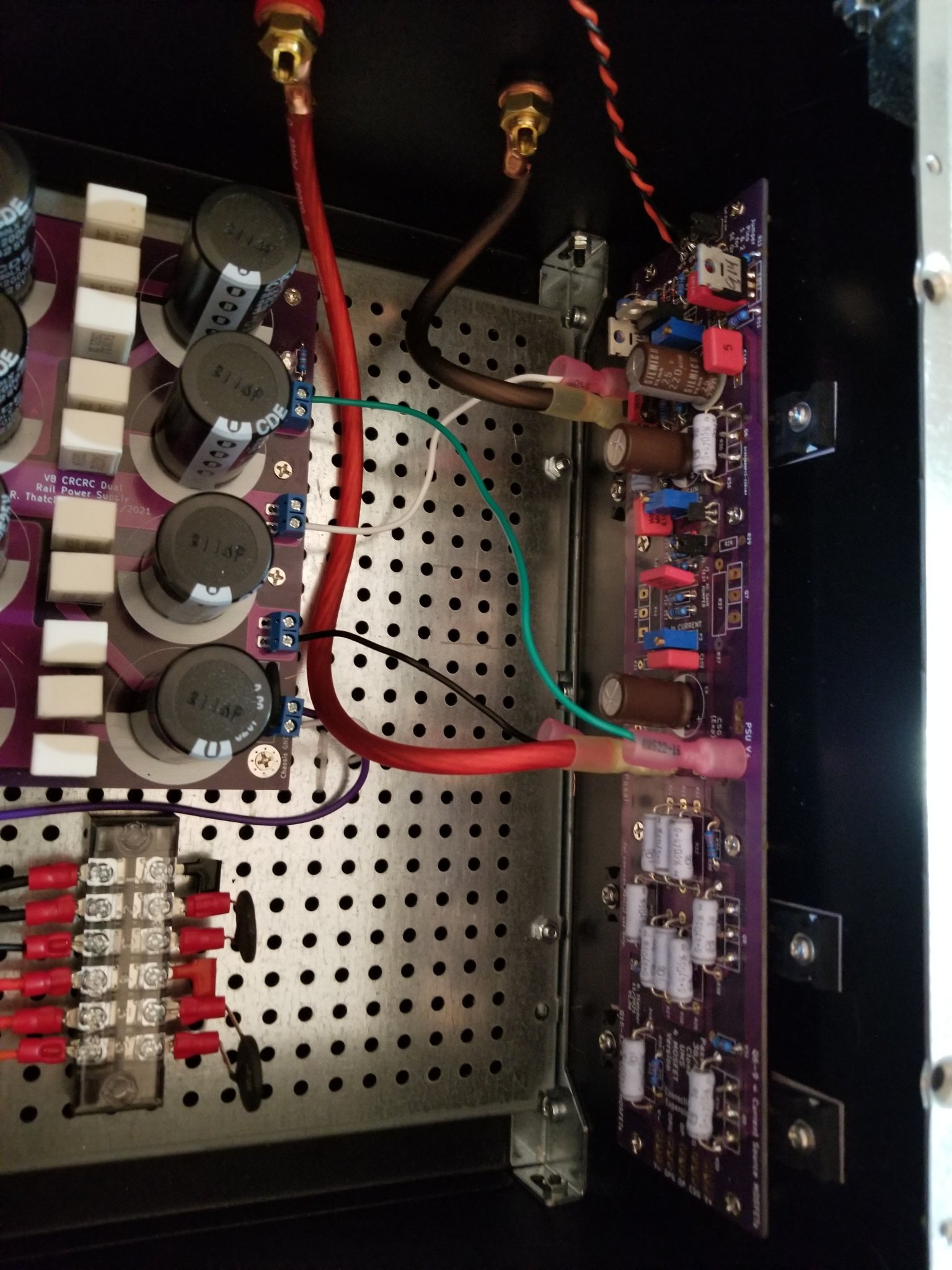

Have gotten one of the monos ready for testing and thought I would show the progress.

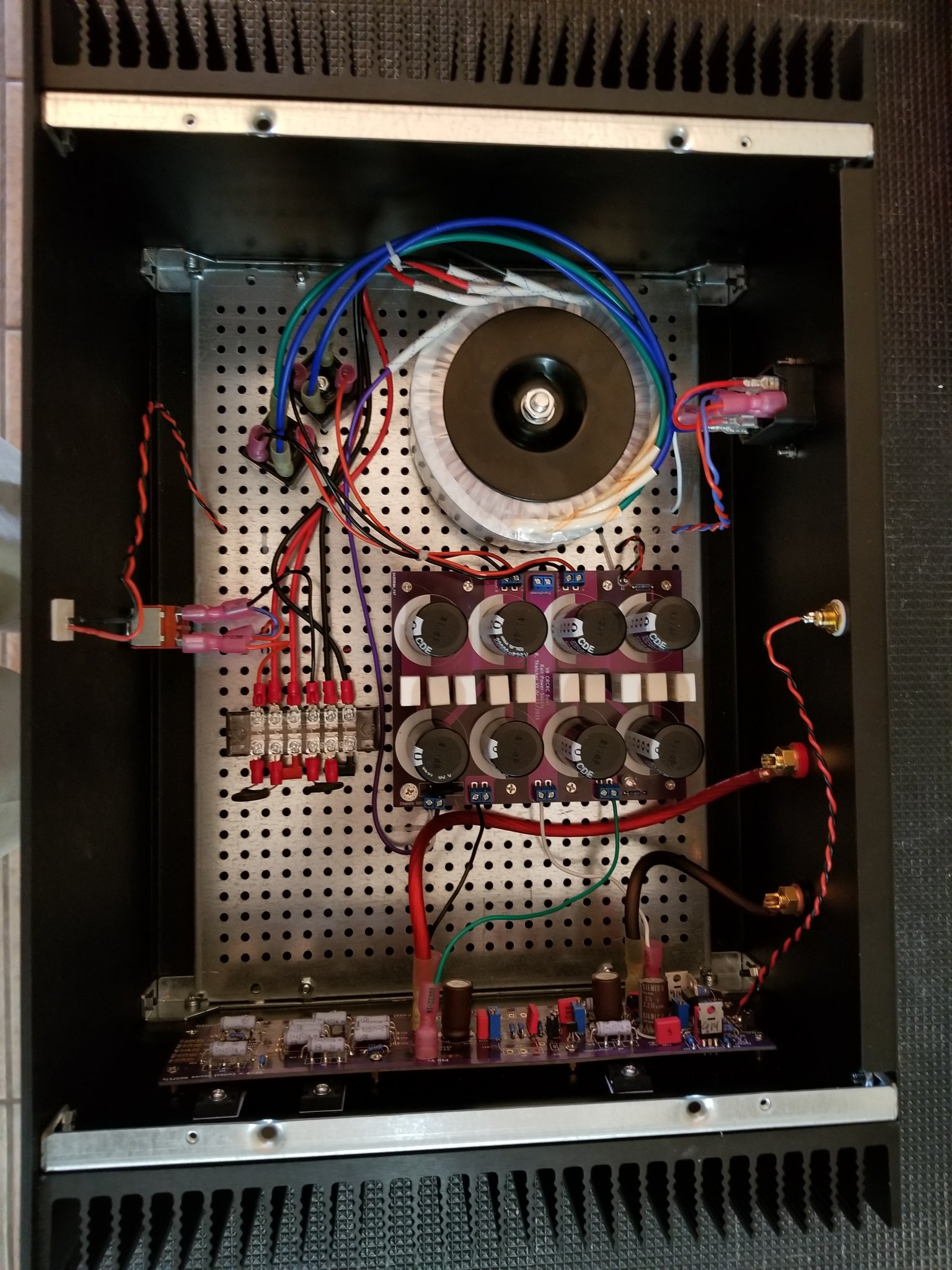

This is the second try at organizing the innards. Decided to push all of the power stuff as far to the left as possible to leave room for testing the circuit board with a small screwdriver -- and avoiding the PSU caps. Nothing too unusual here with an Antek 200VA transformer hooked up to the two rectifiers and passing the DC to the PSU for levelling.
The incoming power switch has a fuse and there are two CL60s feeding the transformer. The PSU also has a CL60 so there should be plenty of surge protection. We'll see.
Used 8awg speaker cable for the connection between the board and the speaker terminals -- this is the AWG used throughout the entire system and all fittings (period!) are copper. So the signal is maintained from the board to the speaker at the 8awg copper level.
This unit is ready for testing but am going to finish the second mono first, then take some deep breathes and do more reading. Have lots of testing equipment that is used for my tape decks and am ready to go at it -- once I get the nerve up, right? That first turn-on is always uncertain...

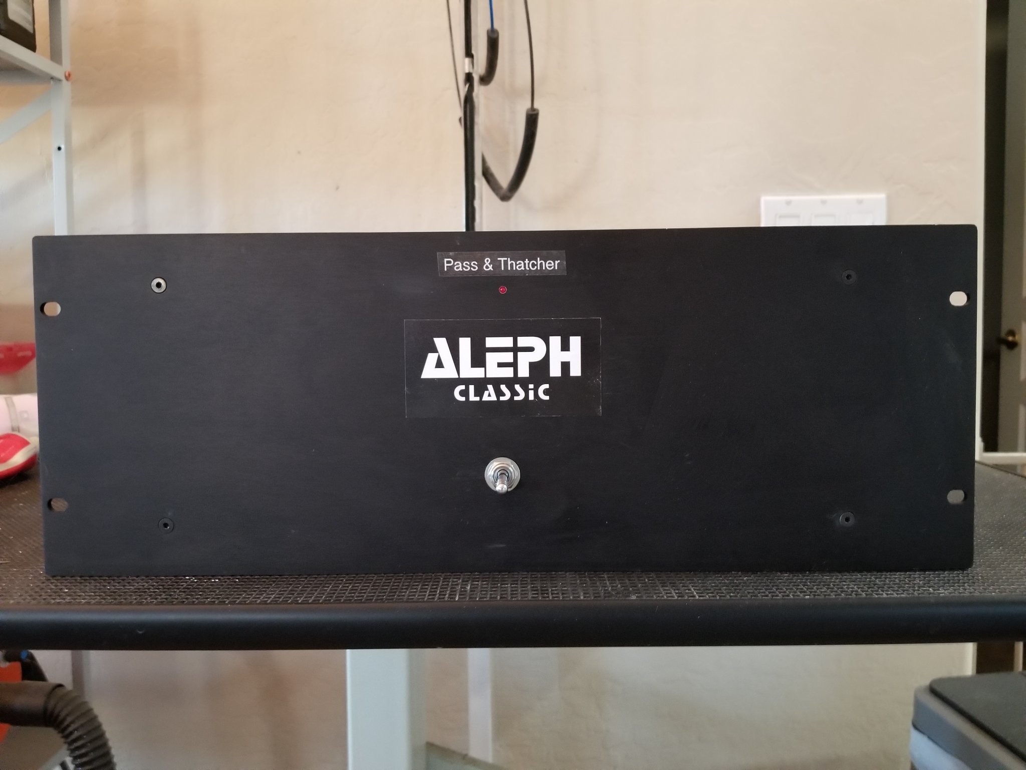

And the FrontPlate benefits from the label that Randy supplied. Will be able to see this across the room along with the bright red LED.

That will be step one after the second box is done. Will remove the connections to the board and make sure the +/- is close enough to 24 dc -- and no other problems. Have built this design before and hope that the previous successes are duplicated.

Craig, how can you not try on a test speaker!?!? Did you fire up the power supply before wiring up the amp board?
randy: In the past have just removed the 3 board connections and hooked the +/ground and -/ground to a multimeter. Works well enough to let you know the VDC level.
Use test speakers once the PSU is OK but am thinking with all of the tests prescribed by your manual that it might be better to just do those before any connection is made. Does the board have to be under load (ala a tube amp)? My M2x seems to be fine with no load when I do the testing.

Had to visit the dentist this morning and so got off to a late start. Was able to complete the builds for both chassis, test the power supplies, and connect the boards to make sure they are not smoking -- and they are not, thankfully. Still am waiting to get the speakers hooked up as my regular test speakers are at the summer home.
VDC was right at +/-24.63 for box A and +/-24.54 for box B. Seemed very steady and lasted WAY after the power was turned off -- a bleeding resistor would be of some help here to calm those caps down. Perhaps that is part of the Soft Start PCB.

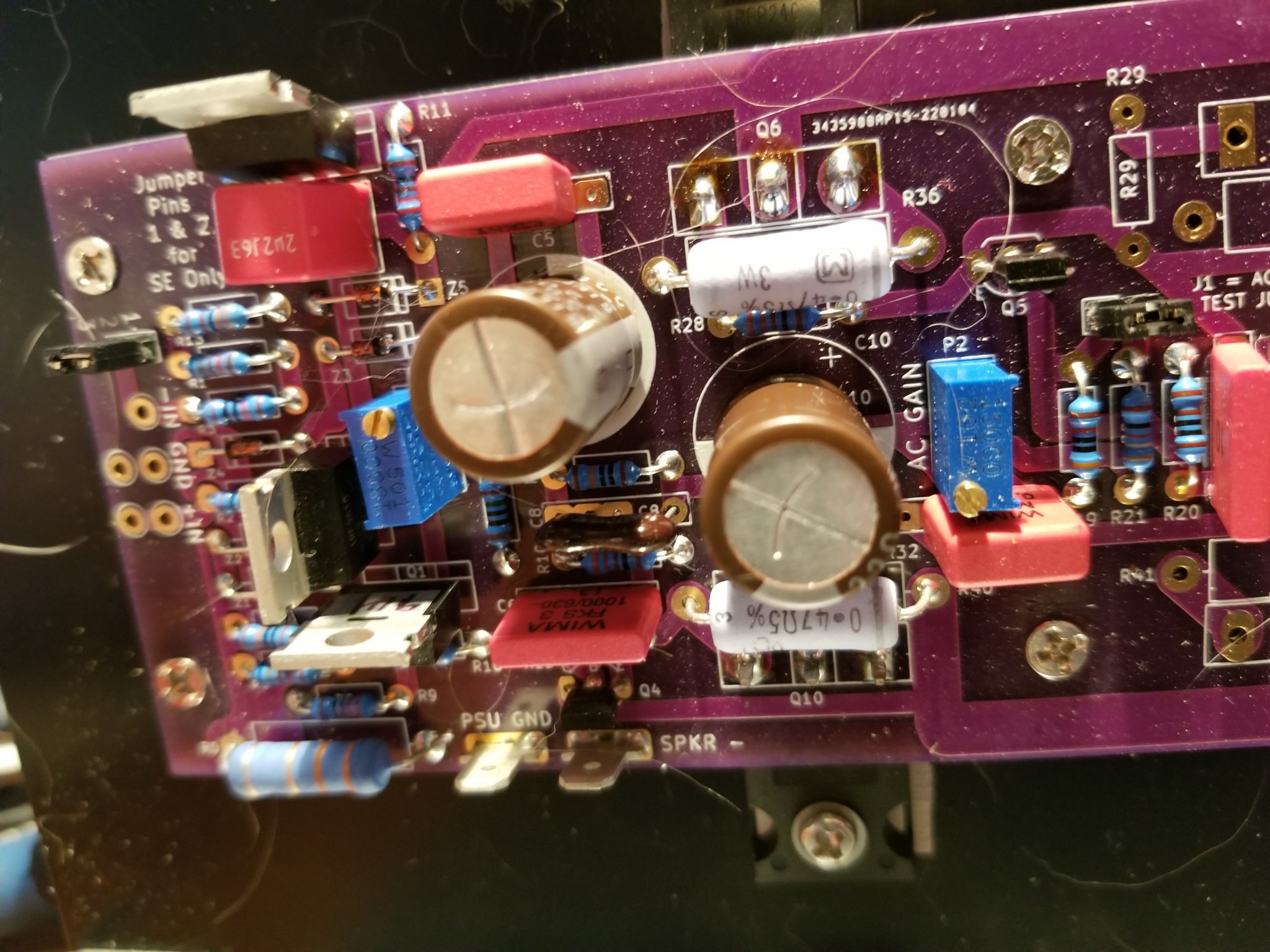

Folks: To set the DC Offset, do you need to short the RCA input? Think this is what is done on the M2x and cannot find any mention of the procedure in the build guide. Thanks. When I make small changes to R1 the mv offset value doesn't change. It is around 560mv right now.
I thought were going to wait another week to listen. 4 days start to finish is fantastic!Folks: To set the DC Offset, do you need to short the RCA input? Think this is what is done on the M2x and cannot find any mention of the procedure in the build guide. Thanks. When I make small changes to R1 the mv offset value doesn't change.
Short the inputs to measure DC Offset. No need for an 8 ohm dummy load for this on the speaker terminals. I imagine based on mosfet matching you won't be turning R1 much or at all.
