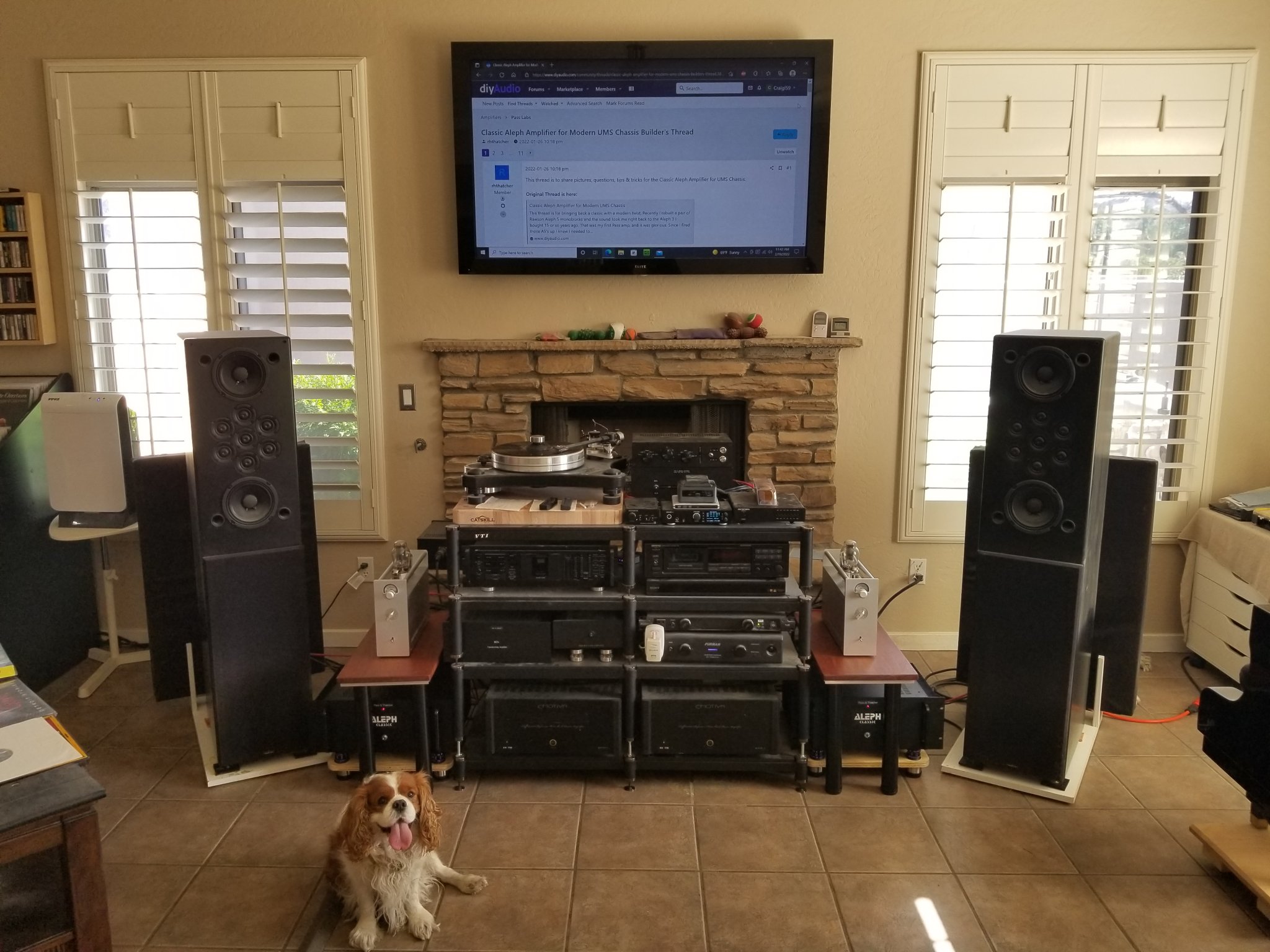

Got all finished and, as promised, here is a pic of the final setup with 5 active amp sets. Took one week from arrival of parts to this stage.
Now I know that some will say "there's too much audio equipment in this room!"
But are you one of those "90% occupied" people or one of the "10% for more amps" people?
Think I know what this site prefers (LOL).
Go ahead. Ask me about the cavalier spaniel. Ask me where the computer is (hint: it's the most powerful computer in the house).
All will be answered in due time.

Your Tekton Double Impacts Look like they have a top and bottom cloth cover and that you have left the top one off. Mine is a single cover over the entire front. Is that an earlier model with two covers or did you modify yours? Also, how many class A watts do you think you are getting into its 4-ohm impedance with the Aleph 30?
Roy
The Tekton covers are a custom format and have a pair at another place that I cut myself but this pair was done by Eric in house before shipping. Need the lower covers because my dogs are natural and want to "lift a leg." They specialize, thankfully, in subwoofers (love them a bunch...).
Double Impacts simply sound better with the upper cover off. You can make this adjustment easily yourself but you will, of course, ruin the full cover. Eric dislikes covers in general and his have always been difficult to obtain. Now he is charging for them as an extra.
