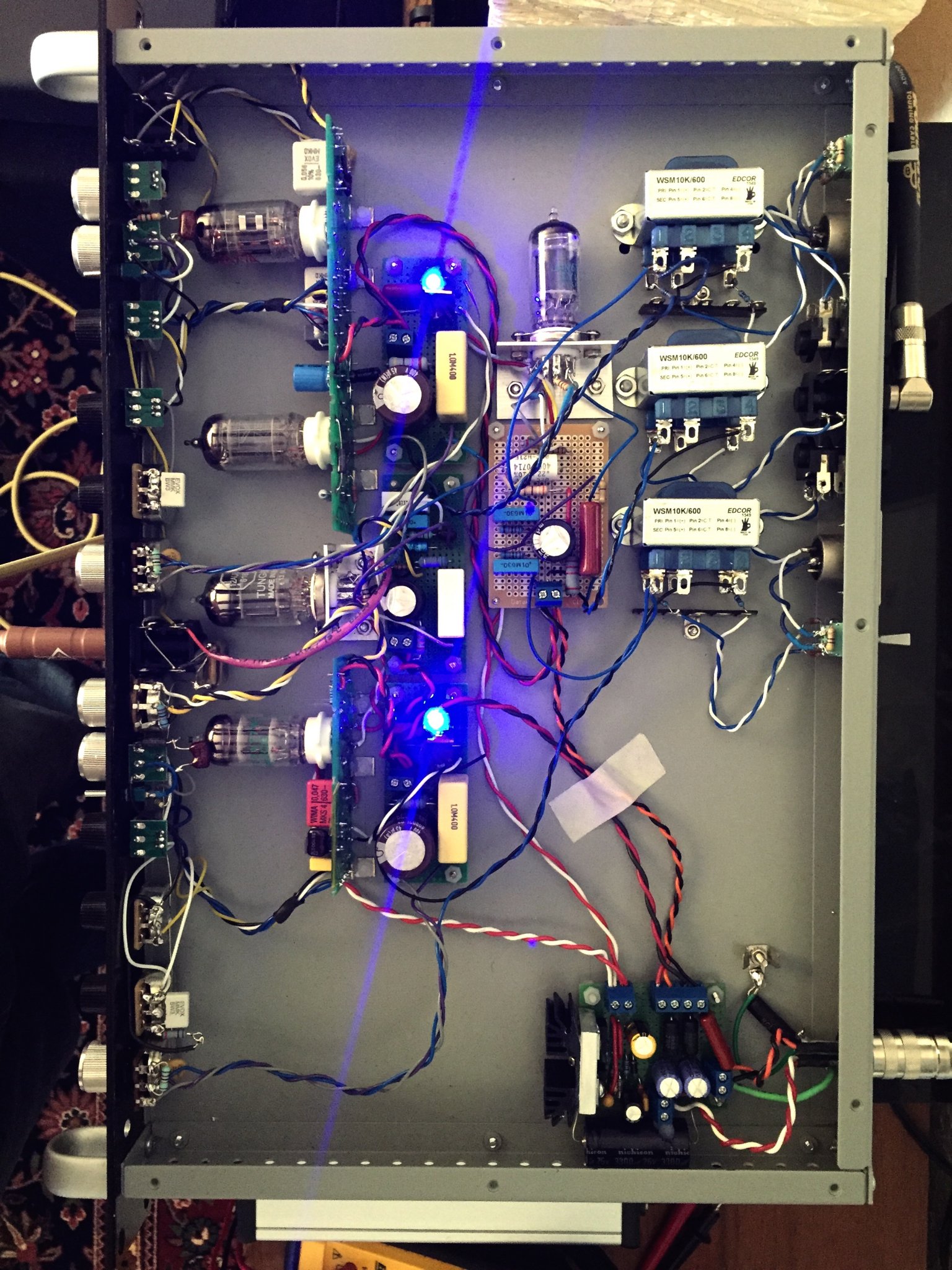

My own solution to this issue of not enough tubes was to build a separate tube hybrid preamp with an outboard PSU. Five 9-pin tubes, a pair of high-voltage Mosfet followers and three signal transformers made two separate channels that could be optionally combined in either sequence, plus a final White Cathode Follower if extra drive was necessary. Too much fun.

That is fantastic! I'll DM you on the preamp, I want to know more!

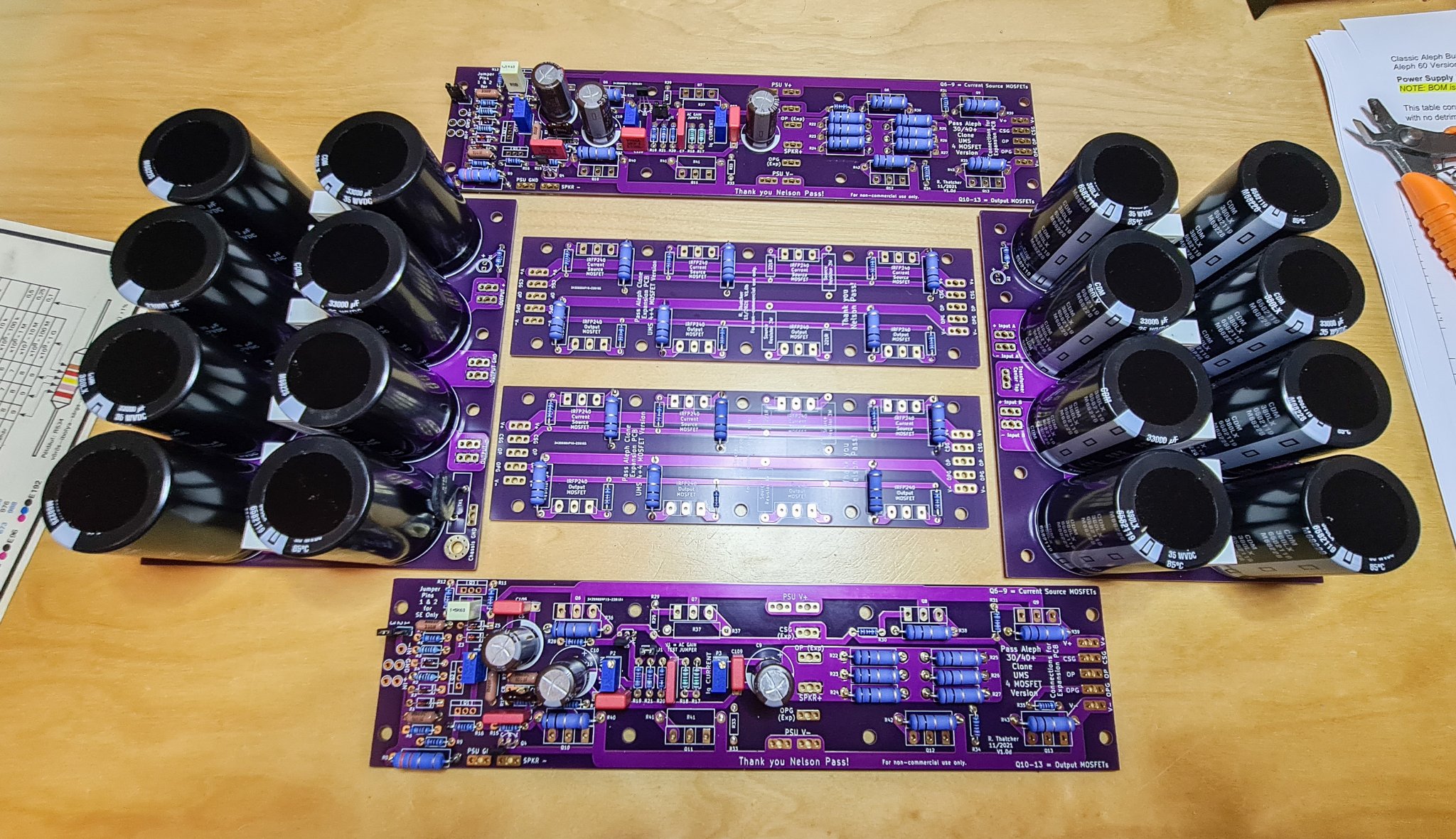

Randy, in your build you don't use the rectifier/snubber and CL-60 boards (I don't see the boards at least).
Are this boards a must or just nice to have?
I don't have Quasimodo, so determining the snubber resistor is not possible.
