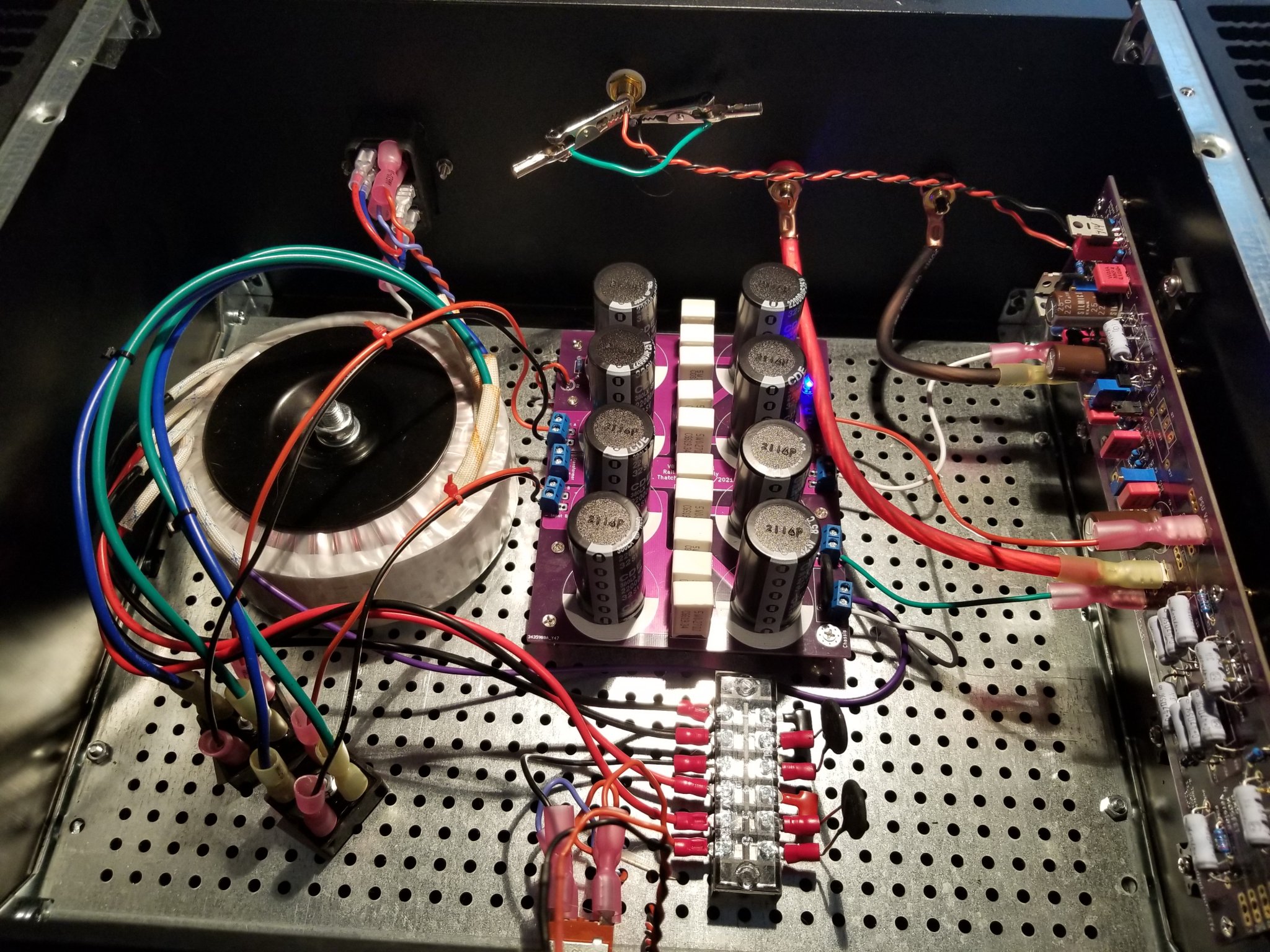

The amps sound superb with one major issue -- there is hum/buzz in both. Am assuming this is from the calibration yet to be done and am looking over that info.

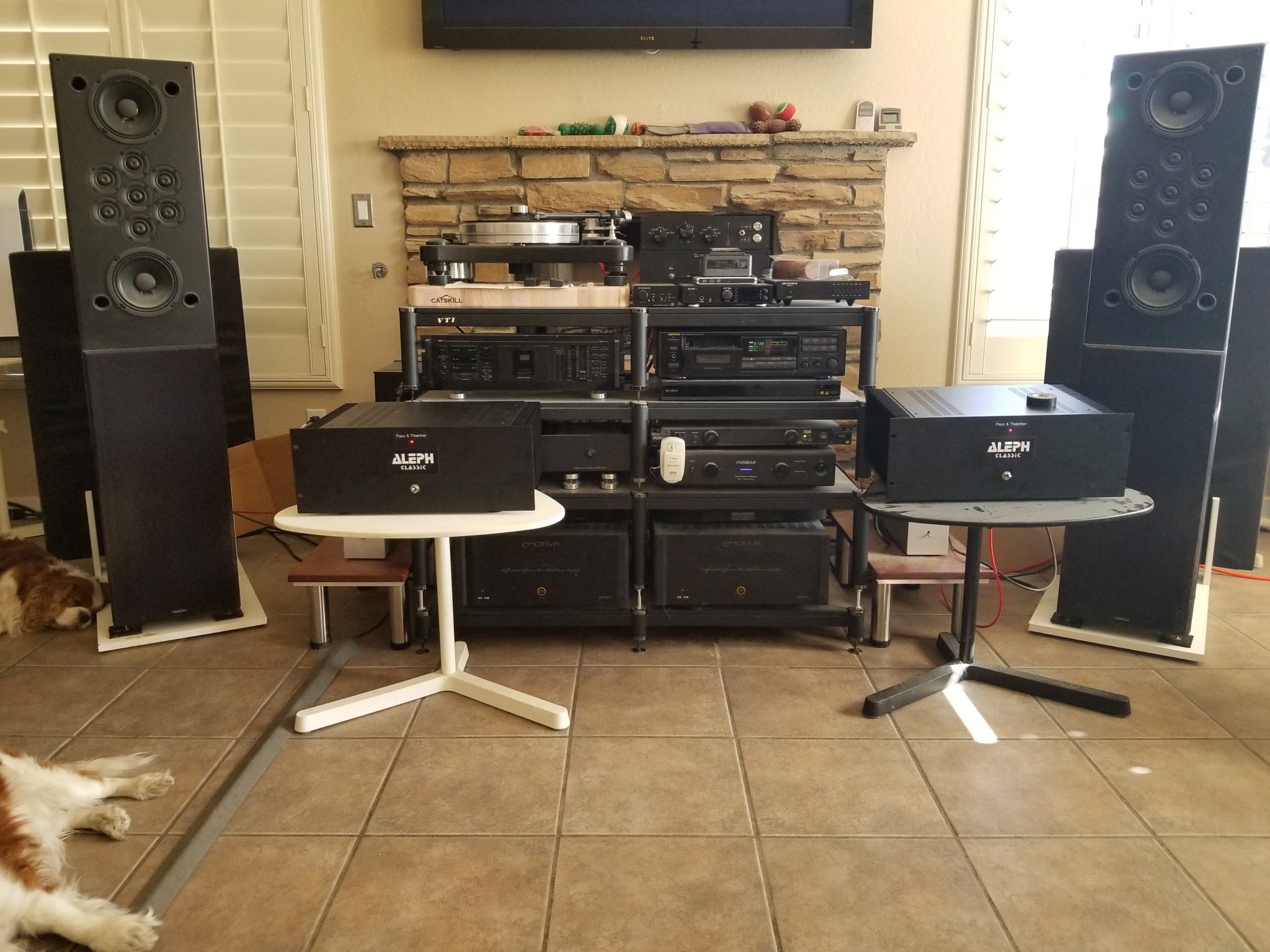

Here's a photo showing the "not ready yet" positioning of the Aleph's. They will get stands so that the tube 300Bs and they are arranged in a vertical stand with plenty of room to breath.
Realized that by putting the spring supports under the current legs I can probably drop the temp by around 4 degrees -- this is what I use with the M2xs.

Can you post pix of both amps and the twisted wires.
P1 isn't going to change hum. If you're measuring lower than 100mV of DC Offset, call that portion of the setup done.
Read the PDF on grounding and hum. Did you loosen up the donut bolt and slowly rotate the donut to get to the lowest hum? Did you move around the twisted wire bundles to see if you get a loud or quiet way of dressing the wires?

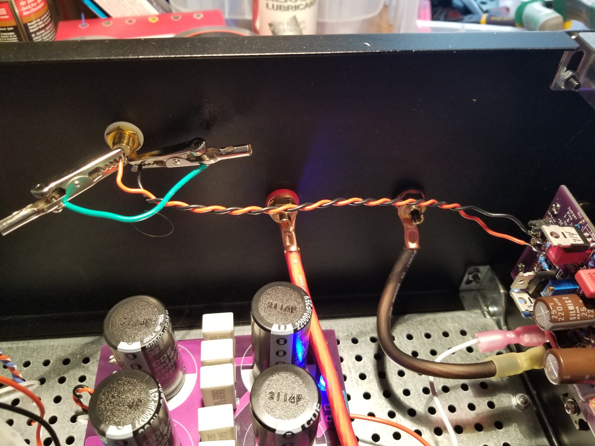

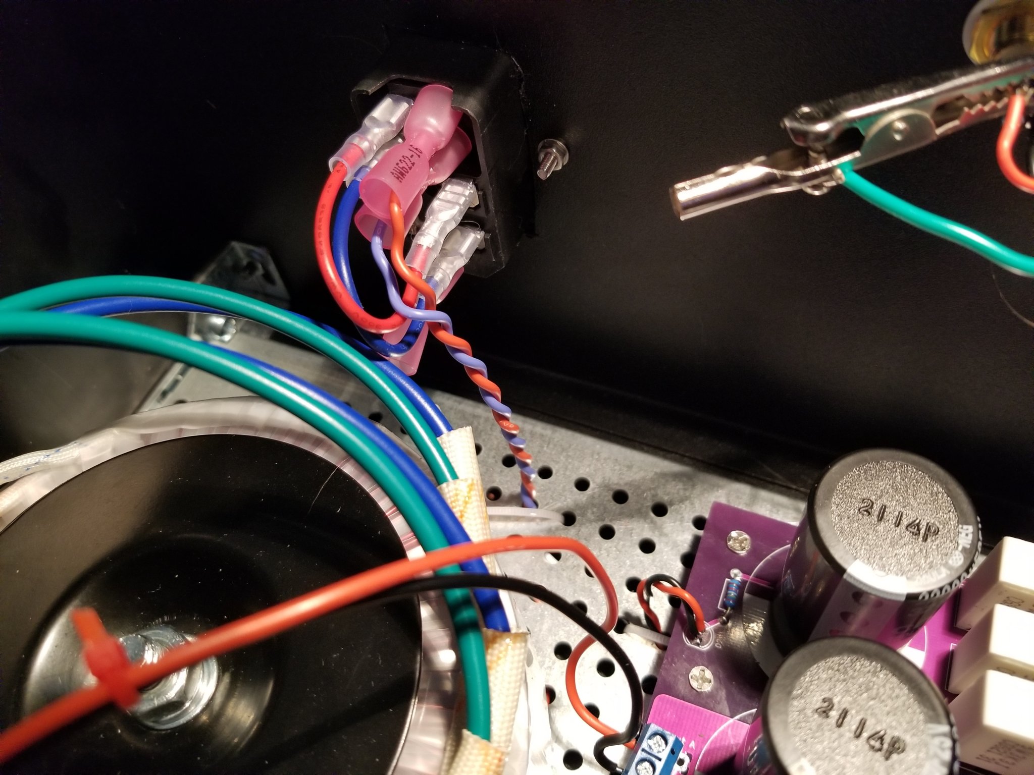

Here you go. This is the louder of the two alephs. In Twist1 you see the "L" and "N" from the AC twisted, then it goes under the baseplate and comes back up right under the front toggle switch -- where there is no room for twisting before it goes to the block that adds the CL60s and sends them out to the 2 transformer AC ins. The Twist2 shows the RCA connection from the board to the RAC input -- twisted 22awg. There is no possibility of twisting the speaker outputs. The short leads from the rectifiers to the PSU PCB can be twisted but because they are so short (see the Full Innards pic) don't see any reason why. John , from Antek, told me that the purple cable we discussed above had the purpose of lowering hum and you see it goes direct to the PSU PCB. Lowered the DC offset to the high-teens mv value and wil conect the amp back up and see if that reduced the noise. More a noise than a hum I would say.
Again, can F2 or F3 create any kind of noise when not correctly adjusted? Also, the amp works fine otherwise.

I can't tell where your earth ground is, but I believe the trafo shield wire should be connected directly to it. You also might try using a spare tapped hole on each heat sink to run a ground wire to the chassis base plate. Tying all these together (chassis grounds, trafo shield, and earth ground) would give you a so-called star ground.Here you go. This is the louder of the two alephs. In Twist1 you see the "L" and "N" from the AC twisted, then it goes under the baseplate and comes back up right under the front toggle switch -- where there is no room for twisting before it goes to the block that adds the CL60s and sends them out to the 2 transformer AC ins. The Twist2 shows the RCA connection from the board to the RAC input -- twisted 22awg. There is no possibility of twisting the speaker outputs. The short leads from the rectifiers to the PSU PCB can be twisted but because they are so short (see the Full Innards pic) don't see any reason why. John , from Antek, told me that the purple cable we discussed above had the purpose of lowering hum and you see it goes direct to the PSU PCB. Lowered the DC offset to the high-teens mv value and wil conect the amp back up and see if that reduced the noise. More a noise than a hum I would say.

More ideas:
Twist all the DC wiring tightly, too.
- Transformer secondaries.
- Rectifiers to PSU board.
- PSU to amp board.
Consider moving that CL60 barrier strip to corner away from amp PCB. Did you get a CL60 Pcb?
Did you do the "rotate the donut" thing yet? That has a big effect.
That article I linked above has decades of hum busting-wisdom in it - it's gold.
GOT IT! Turns out it was the wall outlet chosen. Am running out of Furman outlets so I plugged this directly into the wall -- that is, I think, a different path back to the main box than the other equipment. So pulled some plugs and inserted the Aleph into the Furman pfi-15. Deathly quiet.
SO SORRY to have bothered you folks with this. Can now get onto some serious listening -- and buying another Furman conditioner.

Good job sleuthing and finding out that plugging the amp into the Furman conditioner cleans up the buzz. Most likely the buzz wasn't hum but perhaps DC present on your mains and the Furman squashed it.

P.S. Just another tip. Since you have your twisted wire of your AC mains going into the baseplate hole and then coming back out, perhaps consider enlarging those holes and putting a rubber grommet or two so that the mains wires don't accidentally get scratched/loose their insulation especially during transport/etc...i.e. safety is terribly important. You don't want a baseplate energized at 120V AC. Those baseplate holes are nice to have but they can be sharp too. I see that you have a nice safety measure on your terminal strip with a plastic cover for insulation and prevention of accidental shock on curious fingers.

Anand: Thanks for the info. Am using a rubber grommet for the transformer hole (1/2") and keep that bolt entirely free from the chassis and any ground. Have had the same thought about the wires going through the base plate and will consider that next time. Hope you saw my post above that mentions heat and the use of thermal paste -- NT-H1. After placing the amps on spring supports to raise them, they are averaging 54 C after an hour or two. This is one hot amp as has been noted. As long as it stays in the 50s, it is fine. The front plate is around 46 C where it joins the active heatsink, then cools to 36 C at the middle and to 27 C on the other, unused heatsink side. So the transfer is there but the faceplate is not providing much additional cooling, I suspect.

Woooooooo!Here's a photo showing the "not ready yet" positioning of the Aleph's.
