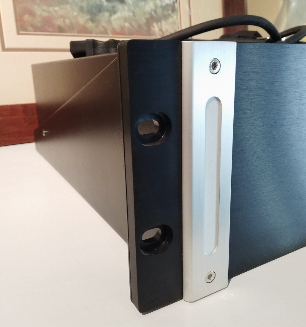

I am creating a build list for a rack-mountable 3 channel amp with 3 class D amp+ps modules that I purchased from 3EAudio (pictured below). I am thinking of doing this with a 3U slimline chassis (350mm deep) since I don't need any cooling fins but will add the vented aluminum top option.
I plan on keeping this case around for a long time even if I end up swapping out the guts occasionally. So I'd like to make it look as classy as possible. I have a number of questions that I am hoping to get advice from the many savvy builders here.

I don't think I saw an option for DIYAudio/Hifi2000 to provide a 10mm front face long enough to be rack mounted? I am hoping that I could repurpose the Emotiva side rails from my old Emotiva UPA 200 power amp (pictured below). They are 3U high and I should be able to line up the fronts to match that of the 3U slimline 10mm fronts.
