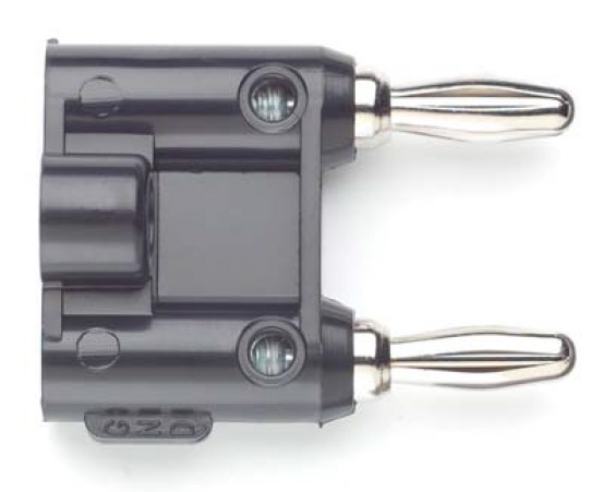

You're not the first that I've seen to make this kind of comment but I'll bet you that the spacing aligns with General Radio standard. So, you're the salmon swimming into the torrent of decades of convention.
Might be one for you to deal with by customisation. There's sense for the store to stick with convention, even if between us it's a bit daft. Still, no harm in letting people know.
My Vandersteen II speakers' back panel follows the General Radio standard. There are four banana females on the back panel, spaced to fit a pair of Pomona dual banana plugs, to easily implement bi-wiring.

1) The spacing is banana plug compatible. It was a decision that needed to be made, was heavily debated, and in the end, we went with that. This standard is not used in the EU I imagine primarily because it's exactly the same spacing as used in an EU power plug. Yep...
In the future, we might do another back panel with spacing appropriate for mega-cables and mega-connectors. One thing of many on the todo list... In the meantime you can always make your own custom rear panel, using the customization services.
