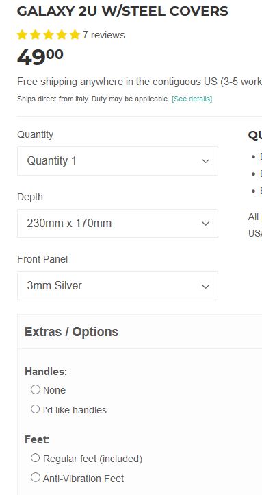

I've bought several chassis from the store, and this is the first time I've been disappointed in HiFi2000. The order form for the Galaxy clearly states that feet are included, but no feet were in the package and Jason says they are not included (just bumpers which are shorter than a transformer bolt head). In addition, there were no sheet metal screws to hold the covers on, so I guess I'll pick some up at the hardware store and paint them black (Rolling Stones reference unintentional).
The Galaxy doesn't use sheetmetal screws to hold the tops and bottoms on...

My bad on the screws - should have looked closer at the diagram.
But the order form says I should have gotten feet. Your response is frankly not great on this one.

Those big plastic feet are for heavier things like the power amp chassis.
Also, they mount to the chassis in a way that a Galaxy's construction can't accommodate because of the aluminum extrusions - they screw into the bent metal frame rails that the heatsinks are attached to in a Dissipante, for example.
Thanks for writing into the helpdesk email ticket system yesterday. As I said in my reply to your helpdesk ticket yesterday:
1. Yes feet are included and those bumpers are the feet. Hifi2000 has been selling the Galaxy chassis for decades without any major changes and it has always been this way. A while back they upgraded the feet (bumpers) from a harder material to the current hemispherical ones which IMO have a softer more squishy feel and I prefer them. They are both "small feet" however, and I will certainly document this better in the future.
The rub is that to stick the Pesante Dissipante feet on 90% of Galaxy chassis (ie: small ones) would be overkill and they would be grossly oversized. I think the issue here is you've bought one of the largest Galaxy chassis and for that size it falls in between the use cases for the two different kinds of feet.
2. When you asked about the missing screws, I requested you send a photo of what you got so we could ascertain if something was (a) missing in which case we would would send an immediately replacement for the missing screws, or (b) this was a case of the included assembly manual not being super intuitive.
From the conversation here it looks like it was the latter in this case. I do apologize that we don't have assembly videos of each chassis yet, this is something I would like to do in 2019 for sure, and it would in this case have both shown the style of feet included as well as shown how to assemble the chassis. You're not the first person to be confused about how to assemble a Hifi2000 case.
Thank you for your past and present patronage of the store and I'm sorry about the lack of good instructional medium in this case (pun intended).

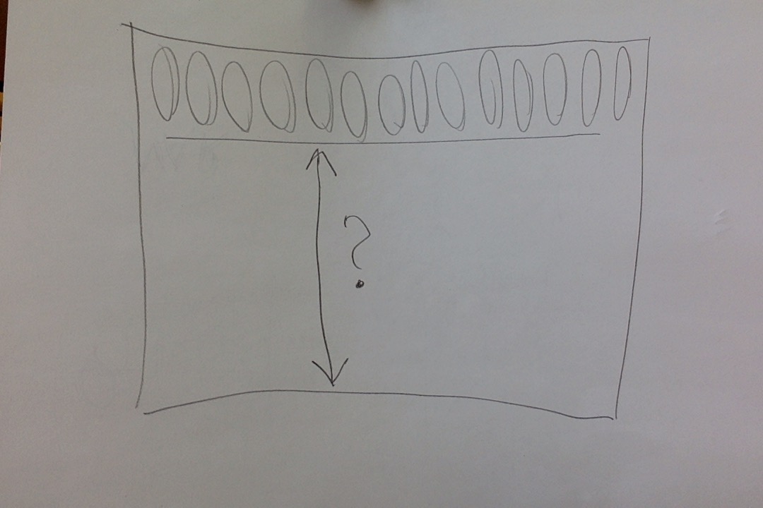

What are the size and position of the row of holes in the default aluminum cover of the 350 mm deep Slimline chassis? If you can show a drawing, it would be super helpful; otherwise, I'm mostly interested in the distance marked by the question mark in the attached drawing.
Thank you!

There's about 29,8 - 29,9 cm from the end of the vent holes to the edge of the cover
