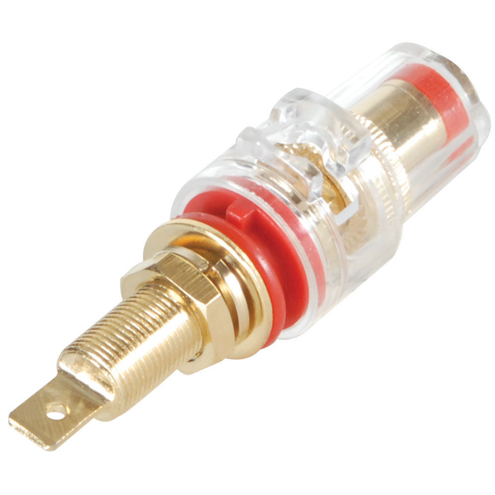

Hi -- I have a Deluxe chassis with the binding posts from the back panel kit. I'm having trouble figuring out how to attach the binding posts correctly, and I'm pulling my hair out looking for images of the Dayton BPFI-G's installed.
I'm attaching the posts with the hardware in the order it shipped with the posts, but I cannot tell whether the keyed plastic ring belongs on the outside or inside of the chassis. It seemed logical the keyed plastic would be on the outside (fits great that way) and that the second plastic ring would be on the inside to isolate the binding post from the chassis, but I cannot get a tight fit when I screw down the washers against the inner plastic ring. It tightens great with both plastic rings on the outside, but then the post isn't isolated. That can't be right.
Am I doing this right? Just wanted to confirm before I keep trying to find a way to get it tight with the plastic rings aligned this way.

This appears to be the proper orientation -

Sometimes the keyed washer fits into the clear plastic cove of the outer post, other times it's the non-keyed that fits better. There seems to be production variances. Regardless, the shoulder washers will keep the metal of the post through the chassis centered and therefore isolated. A couple turns of trimmed electrical tape on the shaft is also useful if you are worried, but those posts normally work perfectly.

It appears the backplate for the steel disspante may be too thin for these binding posts. Once I filed the keyed plastic rings down just a bit and got them flush with the chassis, they tightened up okay.

Interesting observation. The Aluminum Deluxe 4U has a 1.5mm alu back panel and the the Steel Deluxe 4U has a 1mm thick steel back panel. It might well be that the Dayton posts you got (from an earlier run of back panel kits) have a notch that is > 1mm thickness, and this is the cause of the problem. If that's the entirety of the issue, then it's great to hear that filing them back to being 1mm thick solves the issue.
The last run of back panel kits (now sold out) didn't use the keyed washers.
