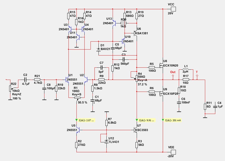

But is it possible to get away with the resonance at T?
As long as the insulation L is attached, resonance is unavoidable with capacitive loads, but I think it is possible to reduce its effect. Try the following:
The standard value for R in parallel with L used to be around 10Ω, but recently 4.7 to 2.2Ω is often seen. This dampens the Q of the resonance.
Place the zobel after the inductor as well. (Example: 22Ω + 0.047uF)
This does not reduce Q, but isolation L of 5uH may be a little large. 1uH or less (~0.5uH) may be sufficient.

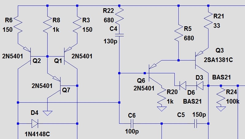

What do you consider a safe limit for base current on a 2SA1209 for example? Datasheet does not specify it.
I think it is generally about 1/10 of the maximum collector current, but even if it does not lead to destruction, overdriving the VAS may cause other problems. My previous post may be helpful. The context of this post should be read from #1313.
Does it have to be BAV21 or can one use some other diode?
One thing "better" means in this case is low capacitance.
I see BAV21 used as VAS baker clamp in most of cases.
As I mentioned in my previous post, the interelectrode capacitance of Baker clamp diodes leads to worsening of high-frequency distortion. As mlloid and minekk say, it is better to choose one with a small capacity.
However, in my experience, the three candidates in my previous post have a decreasing distortion penalty from left to right.
In any case, changes are easy and without cost to make in simulation😀. It's a good idea to try out different things.

Here is the new schematic.
Added overcurrent protection and Baker clamp diode.
Also is added input filter and a 10kOhm potentiometer.
The test with 1uF across the load looks like working okay.

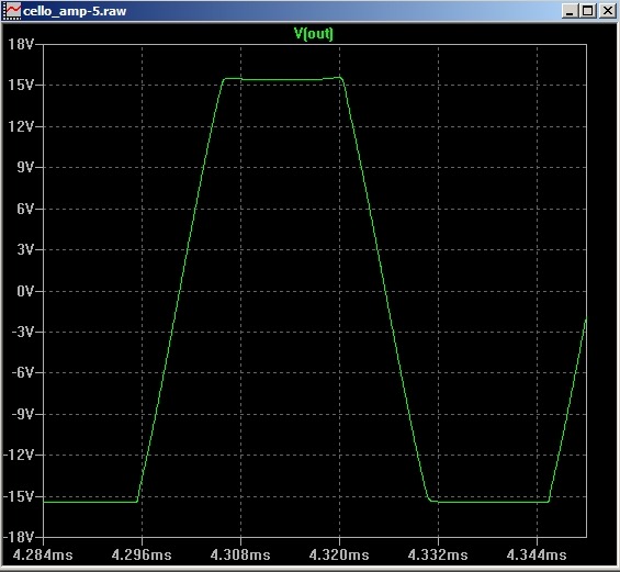

Just to talk about recovery from overdrive, because it is an important issue in amplifiers, and especially those with feedback. When an amp is driven into clipping, it is effectively running open loop and the LTP or diamond buffer will then drive the second stage open loop and this generally means the front end will have switched, and all of the available front end signal current will be getting pumped into the VAS/TIS. And this is what causes rail sticking. There are two problems with this. The first is it generates a lot of HF harmonics that make things sound worse, but also pose a serious threat to the tweeters. The second is that the amp can break into HF oscillation as it exits clipping - which only happens because the input signal will have moved well away from overdrive.
In bad cases, rail sticking can be as much as 3-5us. So, the upshot of this is, I would recommend you always check how your amp behaves on overdrive. I happily trade a few ppm in HF distortion for clean overdrive recovery since there is very little HF energy above 10 kHz anyway - I do not know of any music modern or otherwise that demands full output from an amp at > 10kHz.

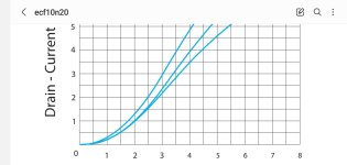

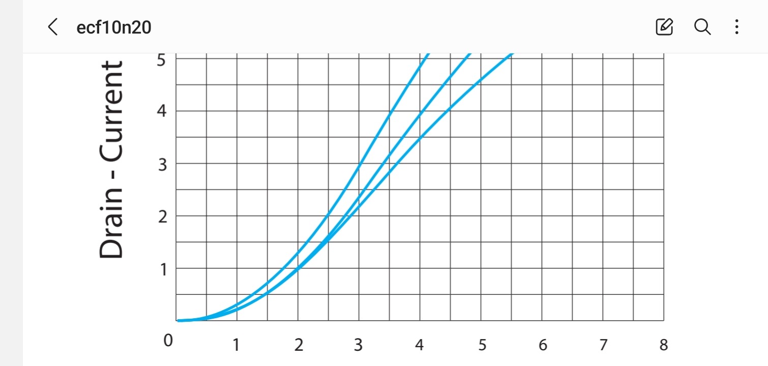

Mistrust the spice model of 10n20 and probably its Co.
I measured the model for 10v Vds the Id current for 1, 1.5, 2, 2.5,and 3 Vgs.
The 1v and 1.5v are correct but with 2v I get 1.18A instead of 1.35A. With 2v, instead of 2A I get 1.75A. With 3v, instead of 3A I get 2.38A. As if the modler used the 25°C curve for the first two and 75°C for the last 2 and interpolated for linear progression.
The low distortion on simulator is very far from the reality.

@HAYK: There is no reason to mistrust the model in that aspect. Please keep in mind that the model is based on a TYPICAL MOSFET transfer curve. The data sheet grants a range of gate threshold voltage. So you cannot expect exact bias calculations from any model. Another aspect is that using two transistors of same type, for instance the differential amplifier, are modelled exactly the same. Which in reality does not occur and results in too optimistic results. Not the fault of any models, but the fault of the user with wrong expectations.
