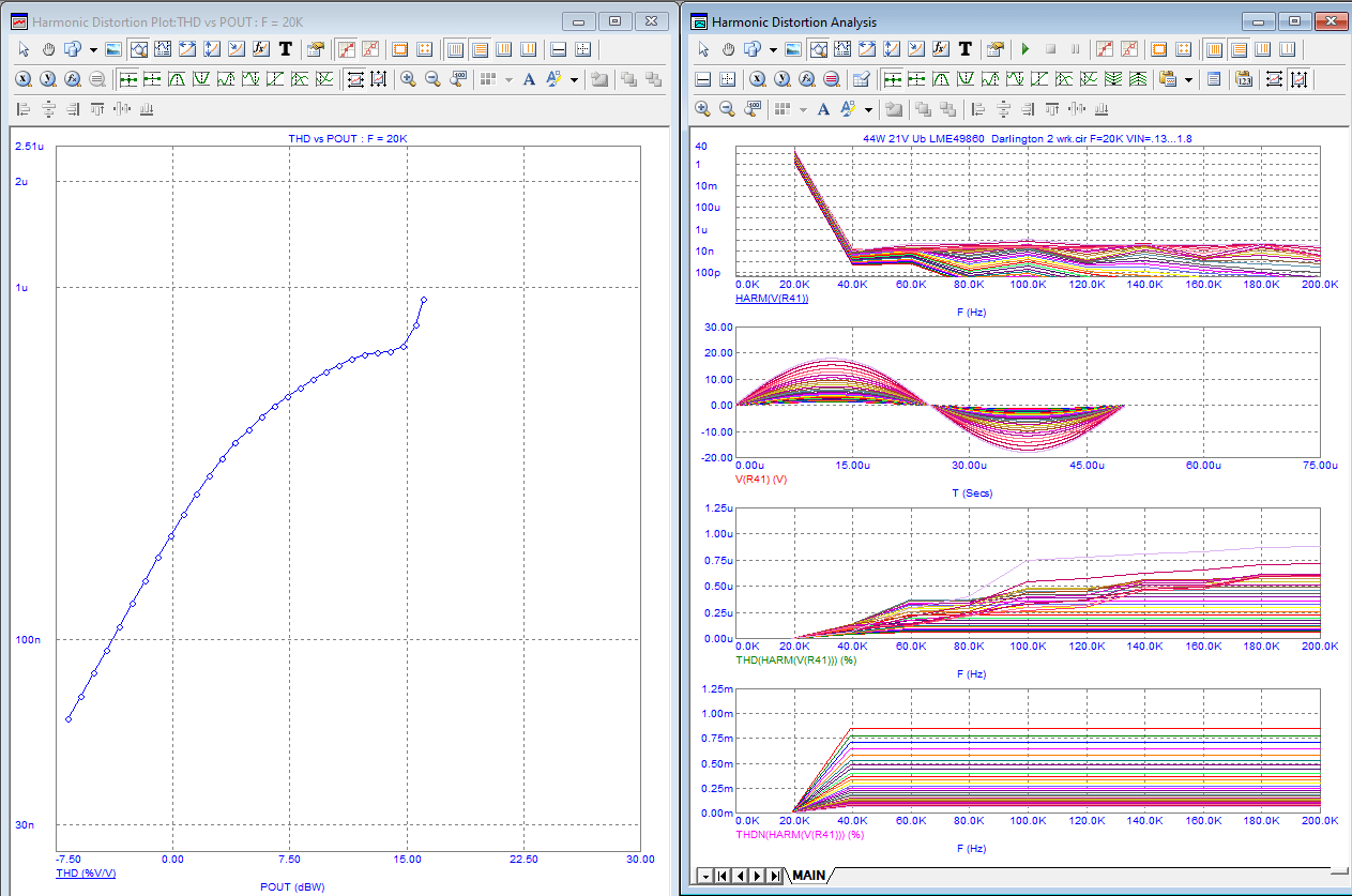

Why write 0,000%? It could be 0,00099 which means that it is 0,001 really.
It is a simulation - and as such VERY uncertain - to play with decimals leaving the actual value out, pretending that it is 0 (?) is silly - nobody here is fooled by that - you must realise that. Be open - play no games.
I agree, completely. THD 10kHz might be interesting as well. Numbers below 0.001% must always be validated with a prototype. Otherwise it may get to 0.03% very easily. I know what I am speaking about.

Well, what happened was that I called you on your false statement. It is not true that the distortion is 0,000% (=0) at 15,762 watt. So, it wasn't a question. You persist in playing games - why?

However, build execution can affect distortion result by order of magnitude (or two). Not to mention that Spice models are incomplete in comparison to the real components. You can be very close or very far with real circuit results. In example, my amplifier simulates as 0.00004 % at 1W/8Ω and latest measurement with improved and recalibrated gear is about 0.00007 %. This is not general measure how close to real life simulation is.
+ 4 or 5 more uncertainties inc. who measured and with what. In this case it isn't even a complete amp - power is missing.... just non-sense...

PCB design is an inseparable part of any electronic project. You add parasitic impedances, coupling impedances, voltage drops, EM capture. It all should belong to a simulation and it does with professional tools.However, build execution can affect distortion result by order of magnitude (or two)
Cello One distortion
By SPICE simulation
THD figures
01W 0.00005%
02W 0.00008%
05W 0.00010%
10W 0.00011%
15W 0.00013%
By SPICE simulation
THD figures
01W 0.00005%
02W 0.00008%
05W 0.00010%
10W 0.00011%
15W 0.00013%
I leave building this amplifier to diyAudio members.
if built as shown it will oscillate.
the circuit has many omissions.

I think it could be a nice little amp to build.
A simulation would need to be expanded to see how stable it is (open loop phase margin and gain margin),
perhaps zobel needs to be added, etc.., but it's definitely something that can be built, and it will work.
Actually, it's simple enough to build it on a breadboard, at least the 1st prototype.
