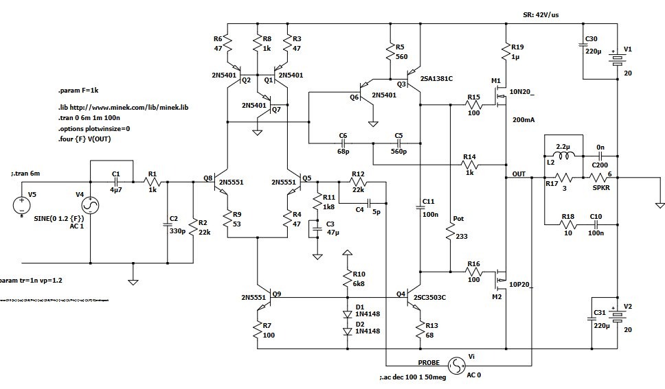

I will study your changes @minek123I tried to adjust the TMC circuit, here are initial results:

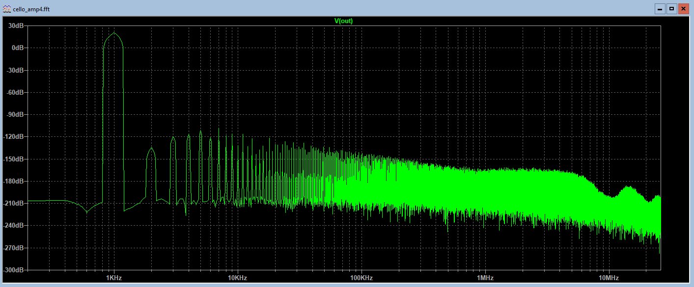

Thd at 1kHz: 0.000050% (full power)
Thd at 20kHz: 0.019115%
Slew rate (estimate): 42 V/us

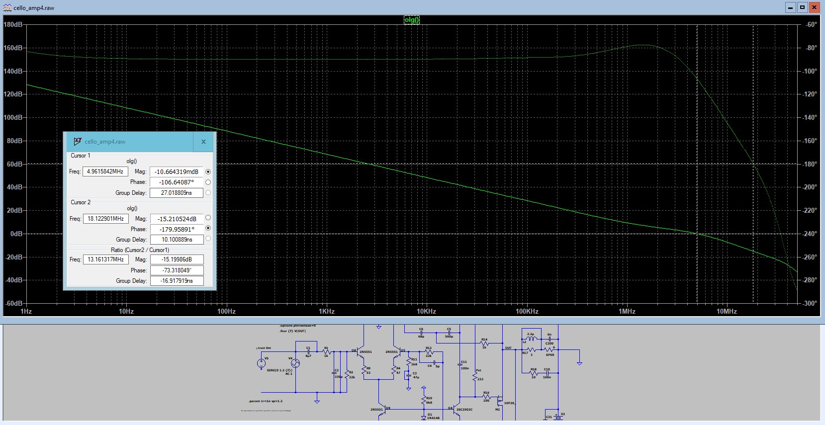

Phase Margin: 74
Gain Margin: 15
I also increased VAS current to 8.5mA.
Lineup, I hope you don't mind me messing with your amp. Please review and let us know if these changes make sense?
FFT looks good, with floor at -210 dB, and all harmonics below audible level of -120dB
Have downloaded your schematic.
Why did you change the VAS current?

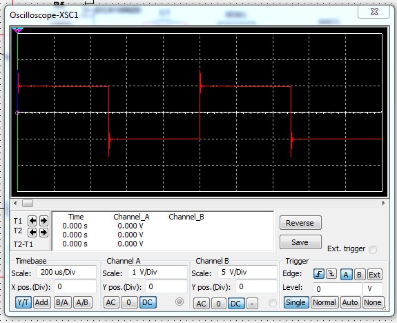

This is the squarewave with 200nF across load with the original Cello circuit
It is 2Vp-p and a Zobel filter in place.
It seems to be stable but with overshot.
Reasons for lower LTP bias current are
- self heat up giving thermal drift
- lower base currents reduce dc offset errors
- decreased input noise current
1) See D. Self's book page 163, 6th edition
Optimal VAS current is determined to be between 6-10mA
2) See this thread https://www.diyaudio.com/community/threads/vas-requirements-for-mosfet-ops.404529/post-7484758
Same conclusion as above

Thanks to @minek123 I have redesigned Cello One.
It is among other things a completly new TMC compensation.
Also changed currect in LTP and VAS.
Added a Zobel filter.
The result is to find in my first post in this thread:
https://www.diyaudio.com/community/...att-with-tmc-and-laterals.406282/post-7526480

Was the #62 waveform acquired at point T? If so, it may be a damped vibration (f=1/(2π√(5uH*200nF))=159kHz) due to LC resonance.It seems to be stable but with overshot.
To check stability, it is necessary to observe the ”OUT” point.
If the output hits the positive rail and becomes saturated during excessive input, excessive current can flow through U10 and the bases of U6.
I recommend adding an overcurrent protection circuit.
The resistor added to the emitter of U6 should be about half the value of R3.

Please use scope time division like 10us/div or 20us/div. I do not understand why you use 200us/ div, such setting masks any details and shows nothing on stability.This is the squarewave with 200nF across load with the original Cello circuit
It seems to be stable but with overshoot
