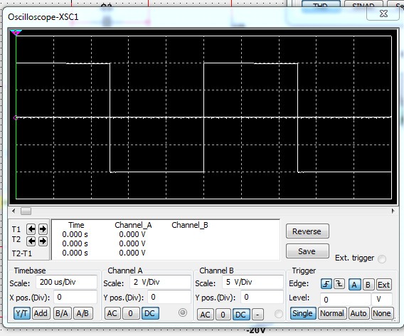

The amplifier was tested with an dummy load of 8Ohm+100nF
Square wave 20Khz 10Khz 1Khz without any problems
I will add an oscilloscope screenshot later

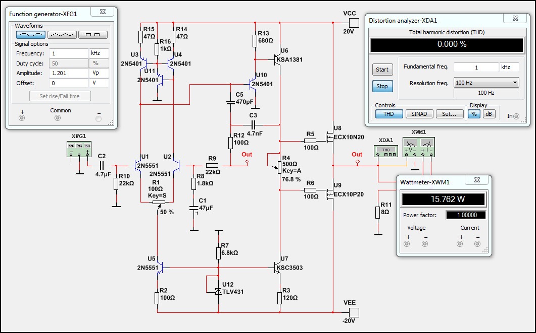

@lineupExcellent.
Any component power ratings in particular to watch out for?
Are all the resistors 1/4w?
What power ratings should be used for R17, R18, R5, R6?
I made an SMD version of this circuit. It played briefly before some of the smoke escaped...... 😤
The amp still plays, but lower volume and the channels are out of phase.
Suspecting R18 is the culprit as one channel is open circuit and the other looks discoloured but measures in the ballpark.
I notice Zoltan has used some 5W ceramic resistors. I used 2W for R17 and placed it inside an air-core inductor as I've done on previous builds.

I added source resistors and pins for measuring current. Regulation is much simpler.
I have ceramic 5W 0.1 Ohm in stock The resistor in Zobel is 3W, in the feedback is 1W, in the power supply branch (22 Ohm) is 2W. The rest is standard 1/4W
I see. The source resistors are a good idea.
When you say "in the feedback", do you mean the 22k?

The zobel resistor R17 should be 5 Watt or maybe 2 Watt will do.@lineup
R18 can be 2 Watt.
All other resistors can be low power. Say 0.6W or 0.5W.
