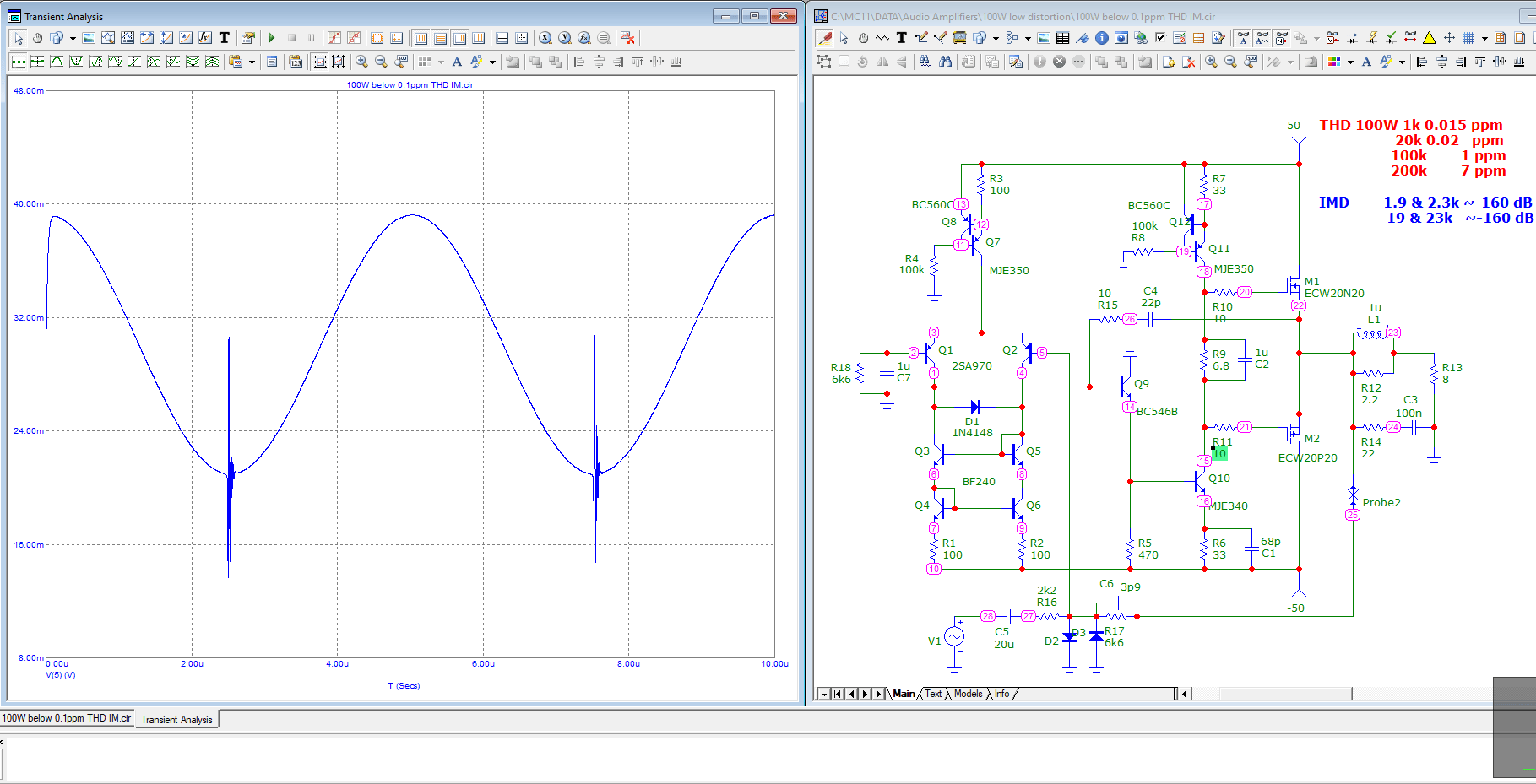

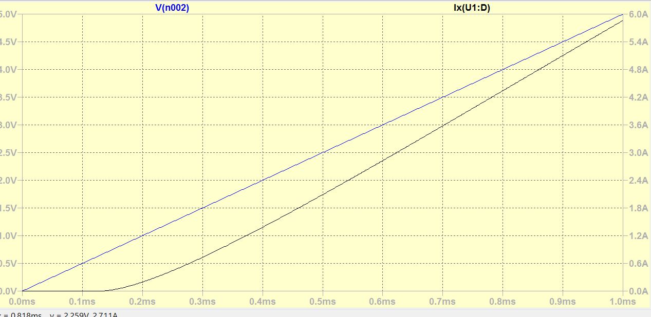

Some time ago in another thread I posted a sim of OPA552 with ECW20N20 and ECW20P20. It was simmed by others and they noticed the ucap models of these fets were too optimistic. Not inclined to set up elaborate measurements, I tried to sort out "what matters" in a sim comparing darlington and mosfet, with input impedance (R62,63) as parameter. The results were quite telling.Here is the post with measurment of capacitance for ECX10N20 and ECX10P20
https://www.diyaudio.com/community/threads/sound-of-zenquito.35782/post-6448661
I have 2 models of ecf10n20, the first is labeled 10n20-70c. C maybe Cordell. It comes from Maplin circuit. The second is a file I found on minek's lib. Ltspice doesn't read but can be made auto-generated, this one is a true ideal to get 0% THD.

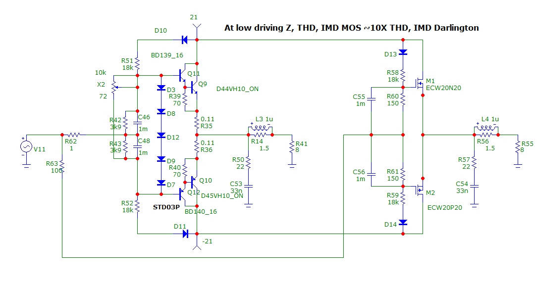

One of the best examples of the difference between ECW-N and ECW-P was observed in my study for low IMD: series resistor with gate has to be different. BTW the amp clips well and is fairly well protected against input overload. A more "realistic" distortion results when increasing the gain. Notice the value of the series R in the P-device.
When using same value as in N device, the virtual ground node looks different.

Thanks @AridaceOne of the best examples of the difference between ECW-N and ECW-P was observed in my study for low IMD: series resistor with gate has to be different. BTW the amp clips well and is fairly well protected against input overload. A more "realistic" distortion results when increasing the gain. Notice the value of the series R in the P-device.
Virtual ground is very useful if just for study, because ideally the AC voltage there is zero. But I'm living in a region, very prone to extreme electric storms (lost stuff even at so called "same ground potential". So in my case that topology is a must.

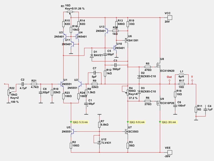

Here is the current circuit.
I have done numerous changes:
Input filter now has 82pF cap
Moved the DC-offset adjustment to the top at the current mirror
Changed emitter resistors in the mirror
Added baker clamp diode
Added overcurrent protection
Added mosfet protection zener diodes
Changed gate resistor values
Output inductor is now 6uH
Increased current in the input LTP
