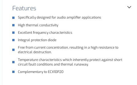

I will check out if they are built in.As far as I know Exicons have gate protection diodes built in, but it won't hurt...
"I am told by Profusion that the Exicon mosfets have 14V 1W protection zeners"

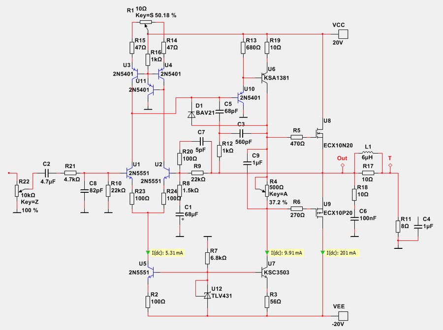

For the 500Ω trimpot R4, might consider adding a 100n bypass cap.
For the 5pF cap C7, maybe add 100Ω in series with it?
I agree with mason from post #122. Add some 1N4004 diodes in opposite direction in series with the current limiting zeners. You can see that Rod Elliott's P101 uses this configuration.
Sure.I know you are designing this for a ±20V supply, but with the components designated, I don't see any reason this wouldn't with with a ±42V supply from 30V secondaries.
It is very possible to use other supply voltages.
It is just because I do think 10W or 15W is all that is needed for a power amplifier.
Many hunt for power. Even when it is not necessary.

We can remove the gate protection zeners:
https://www.diyaudio.com/community/threads/paralleling-exicon-lmosfets.313792/post-5221218
Have a look at ECX10N20 features:
I will test this in simulation, thanksFor the 500Ω trimpot R4, might consider adding a 100n bypass cap.

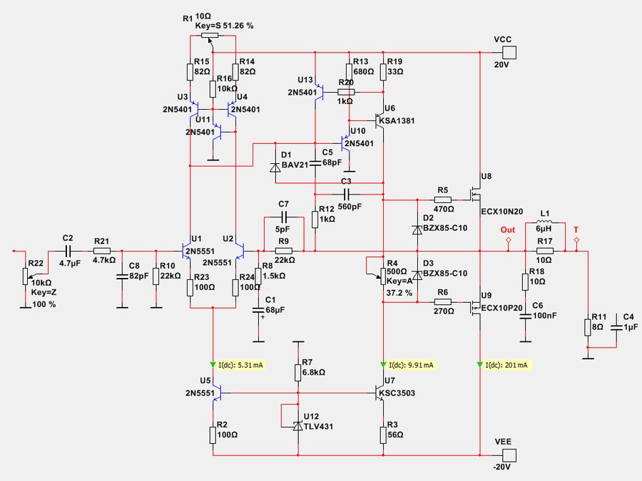

If you are using the BAV21 you probably don’t need U13 or vice-versaHere is the current circuit.
I have done numerous changes:
Input filter now has 82pF cap
Moved the DC-offset adjustment to the top at the current mirror
Changed emitter resistors in the mirror
Added baker clamp diode
Added overcurrent protection
Added mosfet protection zener diodes
Changed gate resistor values
Output inductor is now 6uH
Increased current in the input LTP
I will do this later today.
Yes, that is the case according to the datasheet - however other laterals may not have so its probably wise to provide protection to allow any brand of lateral to be used safely?As far as I know Exicons have gate protection diodes built in, but it won't hurt...
Lineup, I don’t see any supply rail decoupling. I would suggest 220uF per rail along with 2 off 1uF X7R 100V per rail.
I think those who will build this amplifier will use ECX10N20 and ECX10P20.Yes, that is the case according to the datasheet - however other laterals may not have so its probably wise to provide protection to allow any brand of lateral to be used safely?
There is no recommendation to use anything else ...
