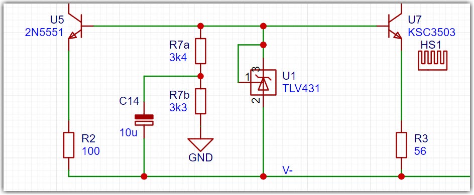

Adding to this, would splitting the 6.8k R7 and bypassing the midpoint with a 10u to 47u cap to the negative rail help with PSRR?
Here's a illustration of what I was referring to in Post #155. You can tinker with values for the cap to see what improvement (if any) to PSRR it makes.

TLV431 is prcise and is not very affected of current variations.Here's a illustration of what I was referring to in Post #155. You can tinker with values for the cap to see what improvement (if any) to PSRR it makes.

You made a point, I was wrongI don't see how U10 in latest schematics #158 is in danger, at around 1mA or little bit above it is already fully engaging the VAS transistor U6 and the Baker clamp comes in.
The LTP can't pull more than 5,3 mA which is dictated by the CCS.
1mA * 20V = 20mW through U10.
With neg output clipping U7 saturates and thus shorts the ref voltage delivered by U12. A baker clamp diode around U7 fixes this roughly. A base series resistor of 330R before U7 shows better results.
