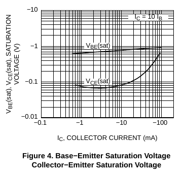

@wahab
U1 in the LTP can sink max 5,3 mA in worst case, but when the upper VAS stage U6 is driven into saturation via U10 by slightest current overdrive, the majority of the that current will start to pass through the Baker clamp due to U6 Vce starting to saturate, that is because it can be as low as 0,1V (see attached picture for KSA1381) meaning it can go past required Vbe to satisfy on-state conduction mode, that is, the Baker clamp will self-strangle any currents through U10-U6 because there will not be enough Vbe*2 to cause any current runaway scenario during U6 saturation.

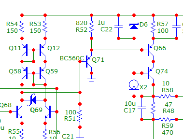

@Aridace
Your attached circuit does not use a Baker clamp or any other current limiting circuitry so of course there is no current limiting properties around the VAS stage that could prevent rail sticking, also, a Baker clamp can not be added straight forward onto your circuit because of Q74 cascode, it would have to be reworked.
@bucks bunny
U7 is a CCS and not in any situation over-driven by any preceding gain stage causing rail sticking, so therefore does not need any Baker clamp or other current limiting circuitry
@Aridace
@bucks bunny

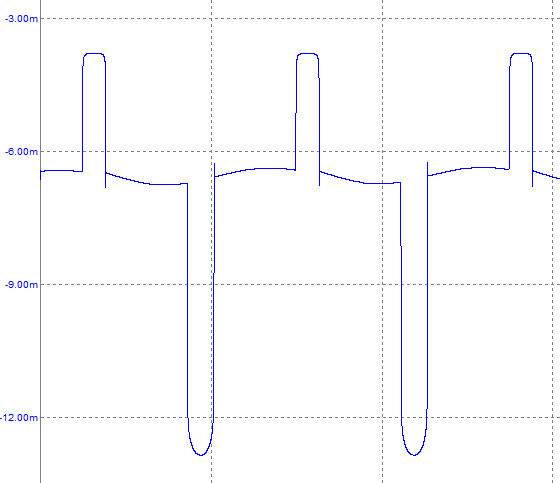

U7 saturates on neg clipping when the pos VAS current drops to zero and so does collector current of U7. A well known scenario, that I saw on simulation. Btw the baker clamp is of little help, but a series base resistor does the trick.
In my simulations THD varies only slightly with output bias current and output load. So I think it is dominated by VAS distortion, maybe Early effect. I should mention that all my BJT models are from Bob Cordell.
Long ago I simmed the effect of Baker clamp on distortion and decided never to use that in an audio amp. Instead I take care that max current through VAS doesn't violate parameters and response time @ overdriving is fast enough and doesn't cause any mayhem.
The baker clamp adds a small voltage dependent capacity that contributes to high frequency distortion. Like the collector-base junctions of the VAS transistors do. Anyway this is outside my focus.
ok, but does it rail-stick, or are you using the expression "saturation" interchangeably for rail-sticking, or "over-drive", sorry I didn't follow.U7 saturates on neg clipping when the pos VAS current drops to zero and so does collector current of U7.

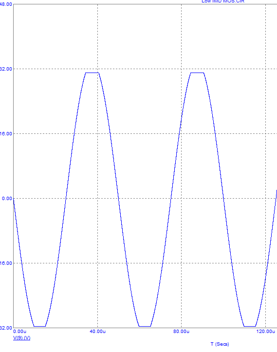

My wording may have been a bit misleading. The fact is that when the hi-side VAS transistor is blocking during low-side clipping, the collector current of lo-side VAS-transistor drops to zero and there is no current gain remaining. This produces a sharp rise of base current which is limited by the emitter resistor only.
I have adressed this in a previous post, a 2.2k resistance, or a little more, is needed in serial with the base of the transistors that is used as CCS for the VAS loading.
This also help the amp starting to work at a lower supply voltage when powered on.
