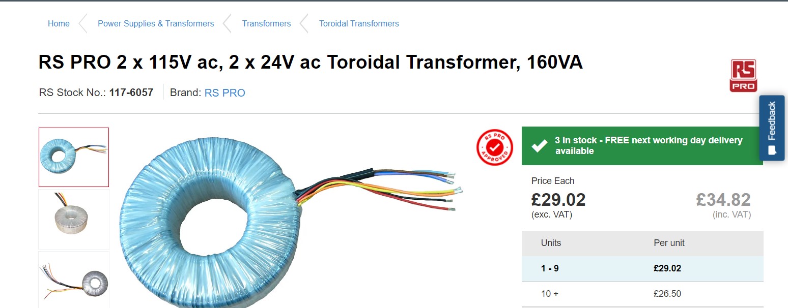

I have the transformer which russc has sent. My question are:
Firstly, On the transformer in the amp it has 6 wires where the one i got has 5 so im not sure what to do.
Secondly, i need to remove hot glue to get transformer out but dont know how to remove without damaging components.
Hot glue can usually be carefully pulled, picked and snipped off using cutters.
If you are totally unsure about the transformer then lets wait for russc.
Otherwise we need to see pictures and you need to first identify secondary from primary windings before going any further.
Hi.
Glad it arrived safely.
Brown & blue are mains in (match European standard live/neutral colours).
Ensure brown goes to live (fused) side.
Ref your photo, post #5. You will see white & red go to a common connection.
With the replacement transformer, this is a single red wire.
Original has 2 secondaries with separate wires, the replacement is the same but the secondaries are already connected at the transformer. AKA centre tap.
The other secondary wires are both orange.
Orange correspond to Yellow (AC1), the other orange to violet (AC2). It does not matter which way the orange are fitted (AC1 or AC2).
I hope all is clear?
