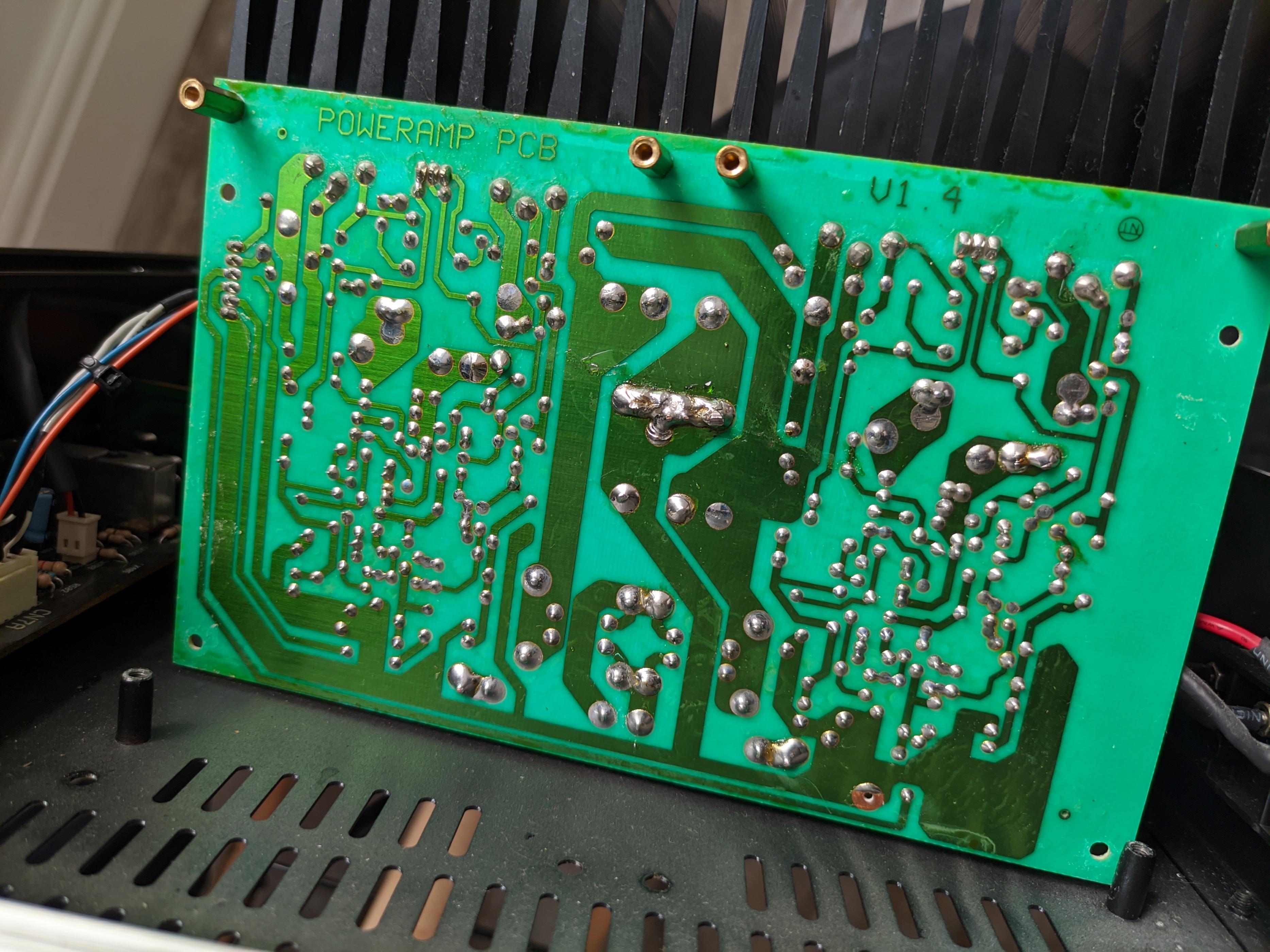

if people would like design of the bottom of the pcb then i can send pictures or even possibly make a schematic on a program.

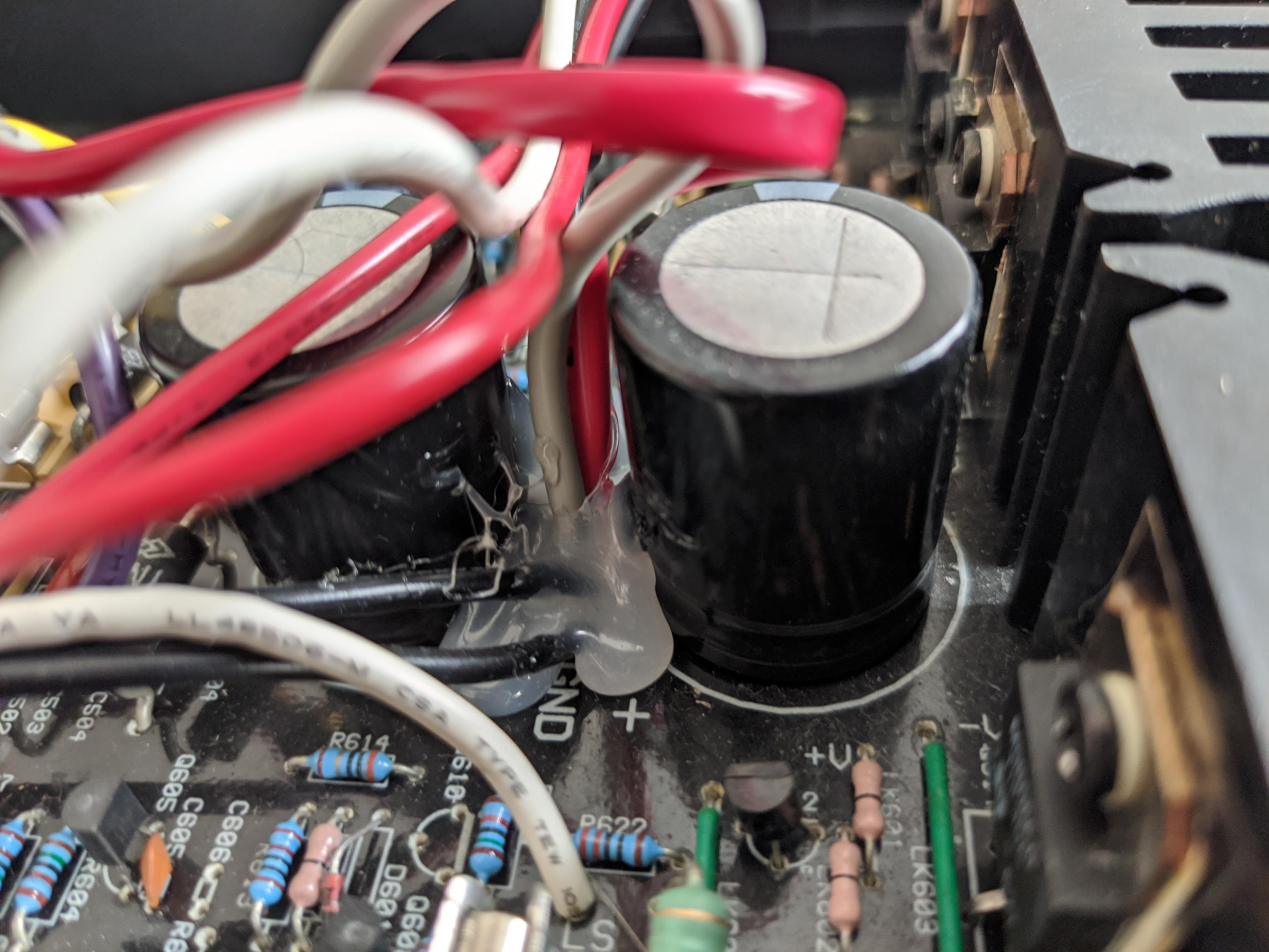

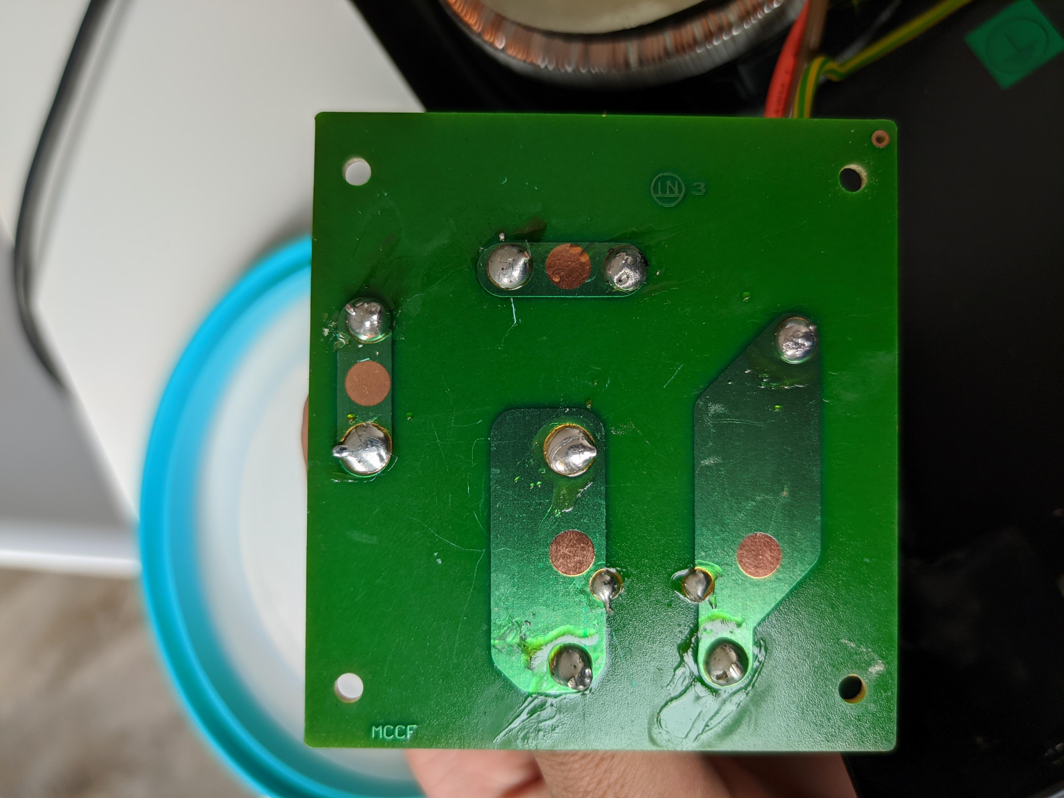

Can you post an image of the bottom of the board with all the hot melt glue covering the transformer secondary winding.
You need quite a lot of heat to solder a length of copper in the primary winding because this gets conducted away from the heat source.
The amplifier is now 25 years old which raises the question of cold solder joints which is not an uncommon problem over time. There is a certain amount of heating involved with electrical currents.
It will cost you nothing to remove the old solder and remake the joints then retest for continuity in the primary winding.
Here is the image of the bottom of the board and a image of the hot glue.

Im not sure if this is the board you asking about but i think this is the right one. If this isn't could you elaborate.
Yes and the solder does not look too good. I suggest you remove this and remake all connections with fresh solder. Then retest for continuity.
You will need plenty of heat in your iron for the primary winding as the copper in the transformer is a good conductor of heat. You are not going to suck all the solder off in one step.
A small wire brush would be useful to clean the ends before the continuity test or subsequent application of fresh solder if there is a positive result.
