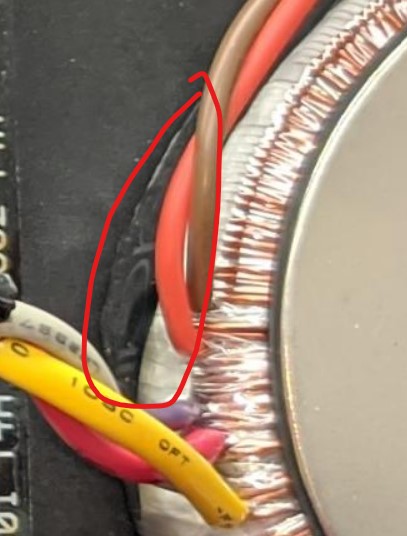

We would need to know the correct voltage for any replacement transformer and that really needs a circuit diagram.
We can estimate... if you look at those two large black capacitors they will have a voltage rating on them. For example 6800uF (the capacitance) and say 50V DC (the maximum working voltage).
That DC voltage sets an absolute upper limit and so working back we could say that 50 divided by 1.414 (the magic number for all these calculations) gives 35 volts.
So a transformer would have to be no higher than 35-0-35 volts AC. In practice it would more like be a 28-0-28 type which in my example would give 40 volts across each of those capacitors BUT ideally we need to know for sure what the manufacturer used.
The other big question is whether the transformer has failed on its own or was it pushed... meaning there is some other problem lurking there that has damaged it.
In the picture there is 'something' near those wires. What is it?

The fuse which had blown was the one closest to the heat sink on the main board. I did say the value but if you don't have the amp or schematic then i agree hard to tell.
On the transformer it says that it is 230V and the thing you pointed out on the transformer is just a label on the transformer.
There are two fuses close to the heat sink.
These are respective channel output fuses.
This has nothing to do with transformer operation.

Not sure you checked for conductivity of the mains circuit
properly using the ohmmeter (reading "1" means overflow,
i. e. infinite resistance, probes not put together, open circuit,
otherwise reading should be different from "1" if the "range"
setting of the meter is correct/adequate).
Apart from primary open winding of the transformer you may
want to investigate the power switch :
- pull the mains plug form mains
- remove the power switch insulating sleeve
- check for resistance using the ohmmeter
- if not sure send a picture.
If you find the switch to be operative, a thermo fuse may have
failed inside the transformer. In this case your local transformer
winder can help. This may have happened during a party overload
I suppose you checked the mains fuse ..

We have established that there appears to be an open circuit as measured directly between the two primary leads into the transformer. See image in post #17.
We have also proved the meter at least reads 0.00 when the leads are shorted together.
Rubber suspension
Could be. I was curious because it looks like there is some lettering on it (unless a reflection) and so I wondered if it could be heat-shrink hiding something within 🙂

No need to. The primary issue is that there appears to be no transformer output. The capacitors, if indeed they are so bad as to urgently need replacement, can still wait until the transformer condition is certain. If the transformer is toast, you're wasting time and money fiddling about with what follows.
The OP is obviously unfamiliar with power amplifier electronics - perhaps fault tracing and repairs are also beyond his understanding and capability but that's hardly a reason to remonstrate about how the thread isn't progressing.
🙂 No problem.
The important thing at this time is for you to be 100% certain whether or not that transformer is open circuit... and if it is then you have to be realistic as to what is possible, particularly considering that there may possibly be a problem within the amp circuitry itself that would have caused the failure in the first place.
