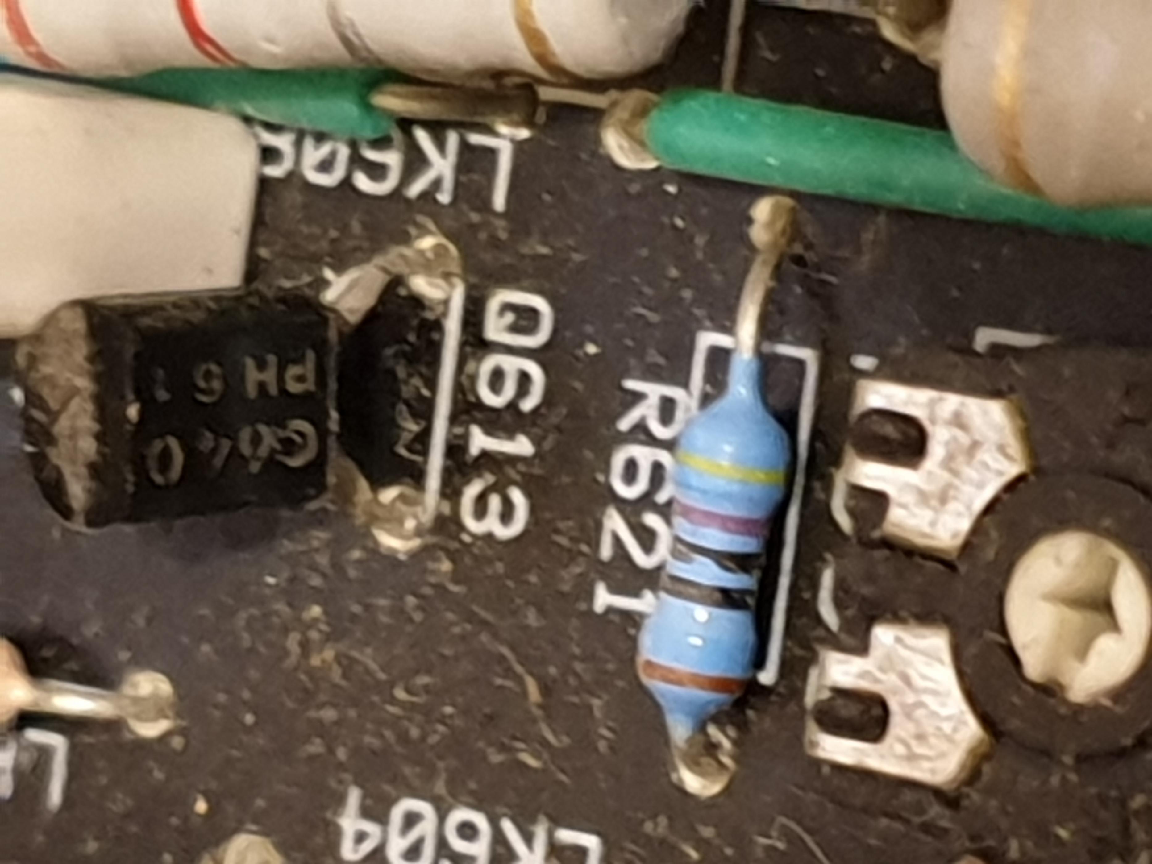

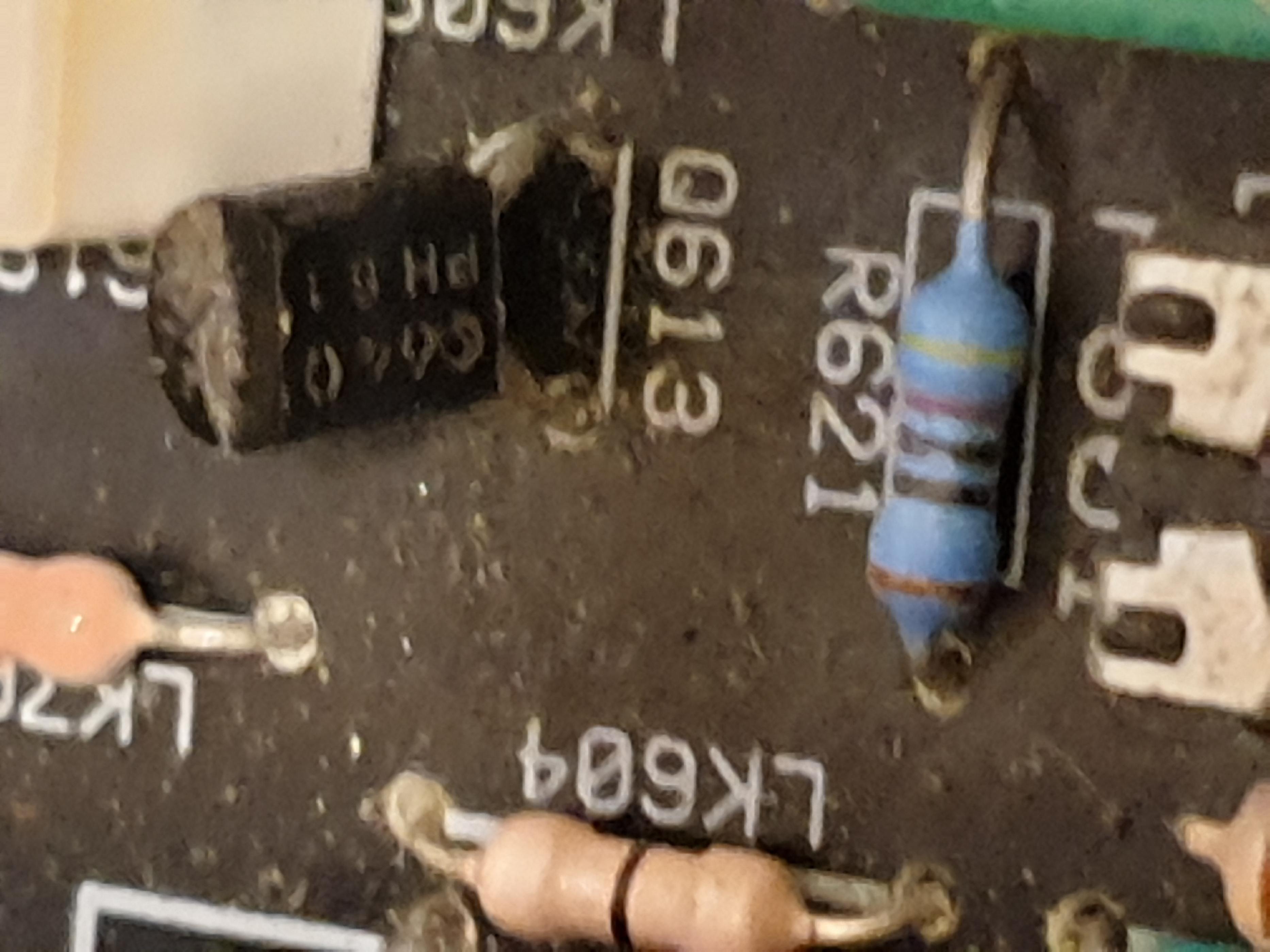

Hi I must say a big thanks to everyone all the replies have been really helpful . I'm much more au fait with valve technology having repaired and modded mainly guitar and bass kit for over 40 years and had 2 years of tutorials from a ex senior Marshall designer, never really got into these ew fangled sid state stuff except for relatively simple pedals and amp stuff! Stereo stuff is way more complicated and without a circuit diagram I'm fighting a loosing battle. Brief recap as I might have one more go, right channel very distorted, full vbe multiplier supply of 1.1v on base of bd139, 30mv on output transistors left channel 1.1v supply with vtage drop to 5.9v on base of bd139 and around 10mv on emitters of output transistors .Assumed open base on left hand bd139 replaced it in correct orientation now had 0.88v instead of 1.1v and still full supply voltage of .88v on bd139 base checked both associated transistors which both have 32v on collector but only 0.4v on bases and 0.88v on emitters, right channel was still OK with 0.6v on bases and 1.1v on emitters. Double checking readings is when I shorted q313 both channel supply rail fuses blew q313 and both left hand channel output transistors

Thanks for all the advice on balance I'll give it another go as Power supply is fine it survived! One issue is the transistor I shorted has so far proved difficult to identify I've attached photos hopefully someone can clarify the code, I've tried a few permutations. Also apologies on previous posts as looks like auto correct has kicked in hope you could all still decipher info

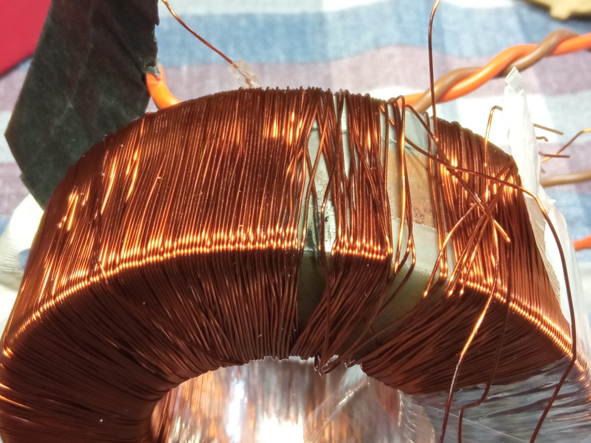

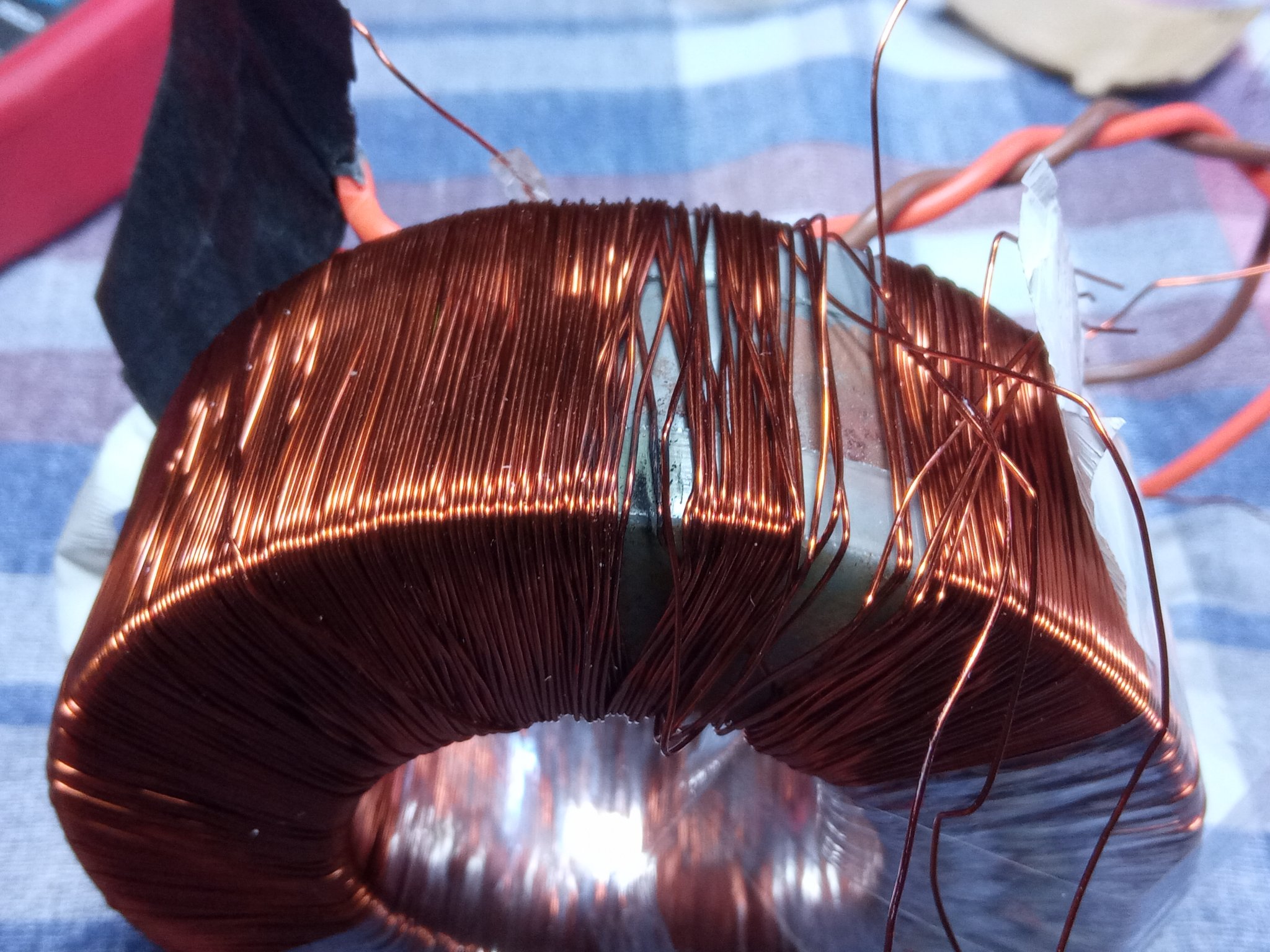

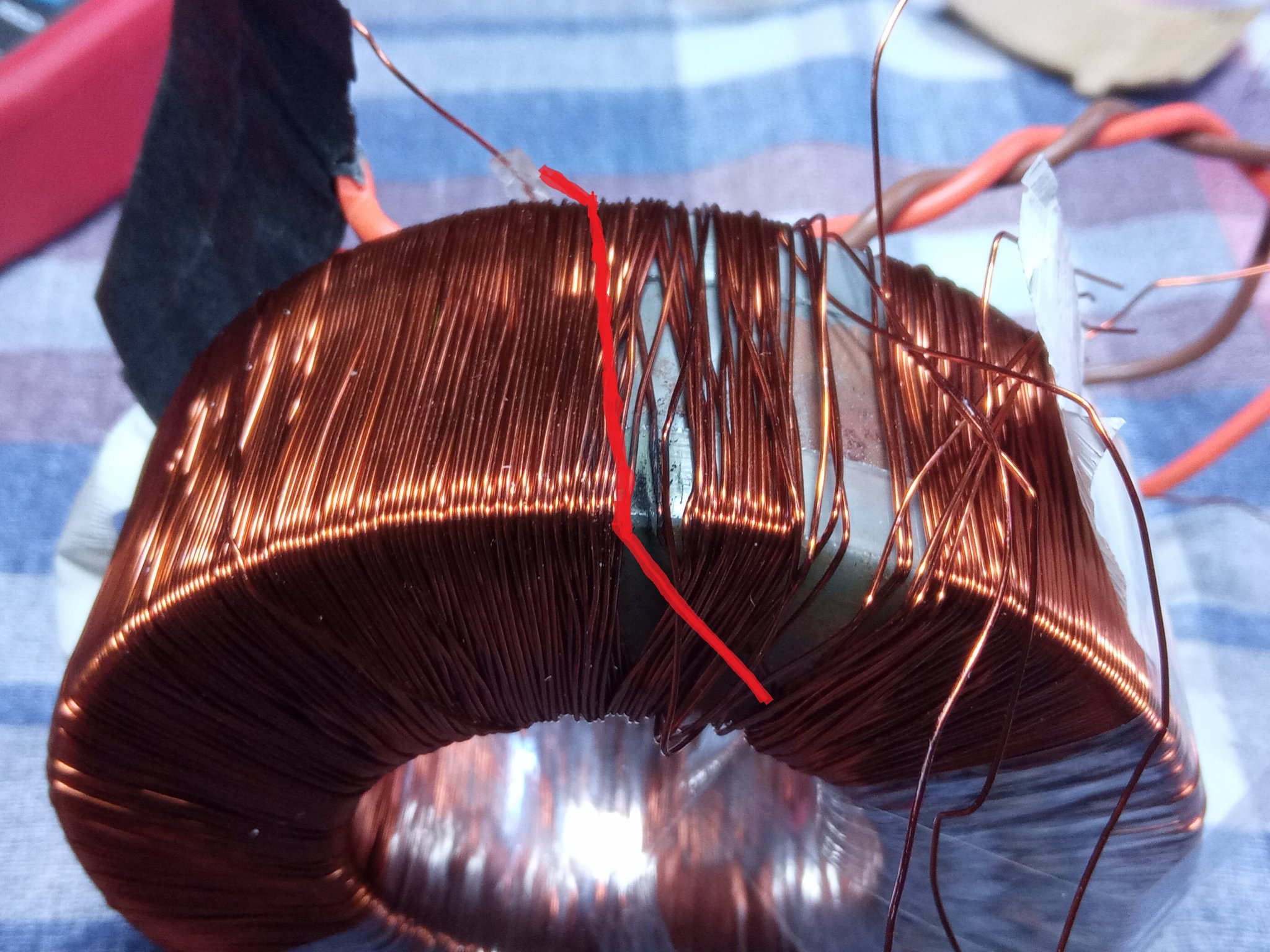

I had to find out "Why" they fail so much (the transformers) in this amplifier model and all 3 versions of it so I had a poke around with this toroid before it goes in the bin...
Enamel failure right under the card with the thermal fuse and lead connections (just a few turns from the start of the winding).
The winding is very poor with wires crossing on top of each other.

OMG!.... you'd have to be intent on sabotage to do something that badly. Either that or QC in the factory was non-existent. I've bought quite a number of new equipment and replacement toroidal trannies from India, HK, China, European countries and UK - lifted the label too but never seen any wiring done that haphazardly.
So, that's the standard Cambridge Audio found acceptable for their A series, eh?

That big gap there was me looking for the damage had to remove a few turns.
The fault was in the first layer (closes to the core) and the 3rd pic is self explanatory.
Just remember this amp is over 30 years old and made with parts from the lowest quote.
