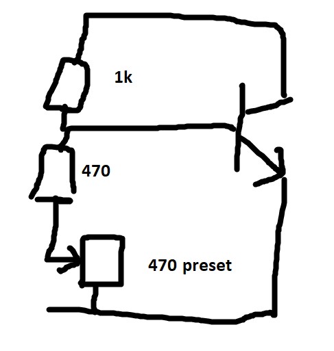

So it looks like this. Reducing the 470 ohm allows the BD139 to turn OFF more and so increase the bias volts which in turn allows more bias current to flow.
Be sure to turn the preset to the full 470 ohms first before powering up. That give the minimum bias possible.
After replacing the R620 with a 370 Ohms resistor I realized that I could have gone with a 330 one ( no 390 ohms in my parts bin) is up and running with 10mV across the emitter resistor for now.
Not always wanting to correct but it is good practice to connect the wiper to the other now unused contact of the potentiometer. A bad wiper contact then has less impact.
I'd never actually thought of it in those terms although I've seen what you suggest done often enough.
RS232 if the wiper were bad and the preset went open circuit then in your configuration the bias would default to the minimum (so amplifier safe).
This was the bit that didn't seem right when I was taking a while to unravel the pictures yesterday... and then you posted the transistor was mounted with the face side to the heatsink... so then it all made it sense configuration wise.
