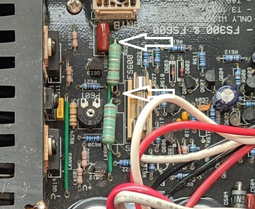

Does it look like this from earlier in the thread?
If so then the bias current is measured by taking a voltage reading across either of the two wire wound resistors.
There should be no signal and no load attached.
I can't make the value out from the picture but 0.22 ohm would be a common value.
A typical current might be around 100 milliamps and so that would be 22 millivolts across the resistor. Manufacturers sometime bias low to aid reliability and cool running due to commercial restraints on heatsink size and so on.

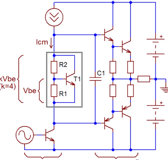

The middle transistor on the heatsink is the 'vbe multiplier' and probably looks a bit like this.
You will need to study how yours is configured but I would guess that R1 (most likely) or R2 is the preset. You need to see if there are any series resistors going to the preset end pins and work out which one to increase or decrease the value of to get more range on the control.
I would suggest you use a bulb tester initially if you alter anything because if you get it wrong the current could be very high and cause damage.

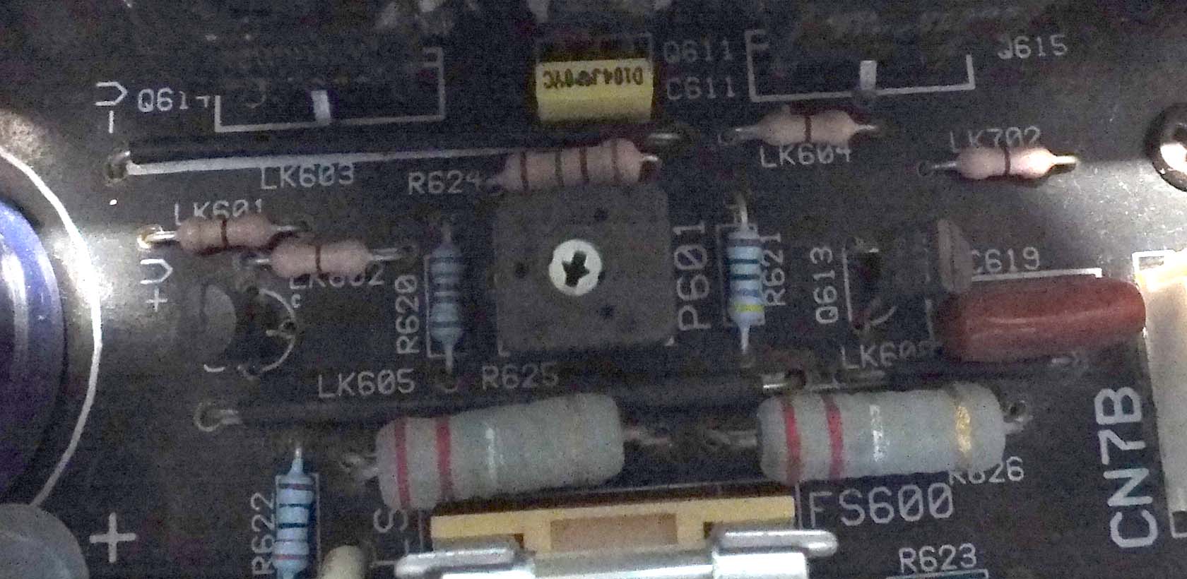

2 minute job if you know how to do it and I'm no good at altering circuits/components I can fix then with the correct (read original) components.
Lets try this if you are willing to help me.
R620 goes from Vbe multiplier to "wiper" leg and R621 again from Vbe to lower let on trim pot going to open the amp to check values and vbe transistor p/n.
R620 = 1K5, R621 =470 Ohms and Vbe transistor = BD139
Please check picture on page 10 post 94

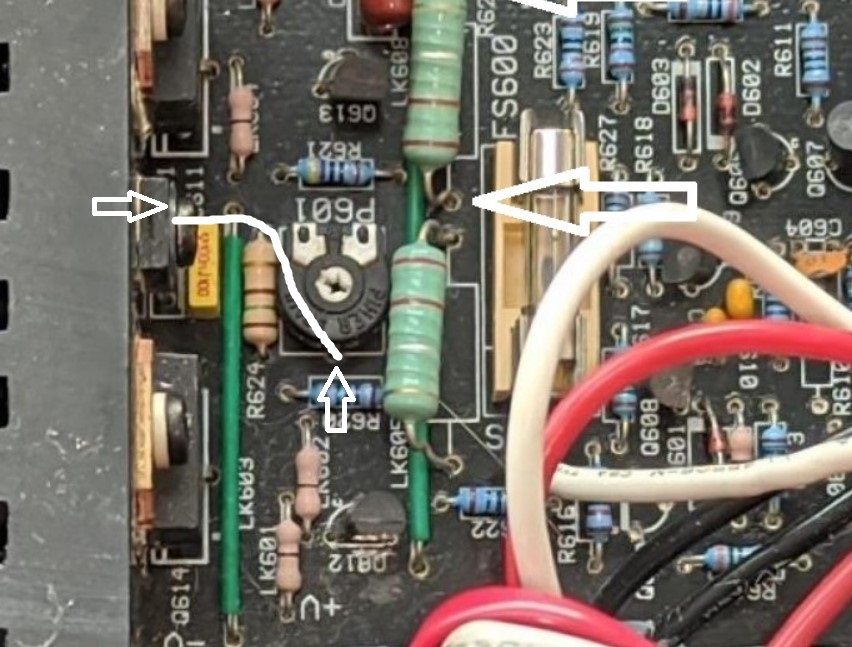

Does this pin connect to the base of the multiplier?

Going a bit Neanderthal but I scribbled the components on the pic on post 94 have a look

Just one more thing the BD139 is reversed (plastic face against the heatsink)
that explains a lot... I was struggling to figure the configuration out.
Lets try again then...
So it looks like the preset and its series 470 ohm is between base and emitter.
There is then a 1k between base and collector.
To get more range on the preset you need to decrease the 470 ohm fixed resistor. It is important that you first turn the preset to give MINIMUM bias by setting it to its maximum value. That means the preset should read as 470 ohm when set to maximum and not zero ohm.
I would try a 390 ohm for that fixed resistor and I also have to add the mantra of using a bulb.
You could also (if easier) just tag a 2k2 across the 470 ohm fixed resistor to bring its value down.
