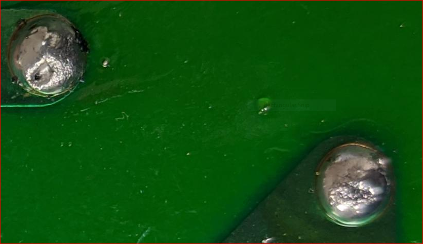

So i thought i was getting a transformer but apparently its the full amp. Sorting that out and will go from there. Couldnt i just gut the main board out and switch them or can i not do that
Don't do that you going to get more problems
I'm 99% sure there is nothing else wrong with it just get the transformer 2x24Vac or 2x22Vac the first one is the original voltage
Okay will listen to you and buy a transformer
I enlarged the image you posted in message 96. This shows how messy the solder work looks close up. It is easily possible this is responsible for the apparent open primary winding of your transformer because of cold solder. You are going to have to clean this up in order to solder the new primary if that is necessary. My suggestion was you do that and remake the joints of which I have shown two.
You have given no indication that you have looked at into this. But you are going to have to do the first part regardless.
You might then remeasure the primary winding to see whether or not this restores continuity.
If you took the amplifier to a repair shop that is what they would do to establish whether or not there is a need to order a new transformer.

I have remade the 2 joints and nothing has changed so my next step is im getting the transformer.I enlarged the image you posted in message 96. This shows how messy the solder work looks close up. It is easily possible this is responsible for the apparent open primary winding of your transformer because of cold solder. You are going to have to clean this up in order to solder the new primary if that is necessary. My suggestion was you do that and remake the joints of which I have shown two.
