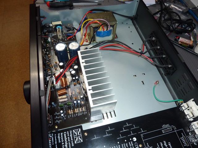

Hi rs232 kindly linked me to post hoping I can get some help on the mk1, right channel is badly distorted the right channel bias on the bd139 is the full supply of 1.1v with .56v bias on left channel(1.1v full supply) the right channel ifeal emmitter voltage is about 20mv with left channel about 5mv. Iassumed right bd139 was open base but after removing it tests fine on a transistor checker. I can't find any other issue the output transistors seem to measure fine , and I can't find any discrepancies in component value thanks in advance antony

To tiefbassuebertr the amp is question is the original A1 also known as A1 mk1 and is a full discrete components audio amplifier (no integrated stuff anywhere).
There are 3 different versions of this amplifier.
1st one is the original one described above
2nd one has a E I transformer and a LM4765
3rd one has a toroid transformer and is based on the TDA1514.
None of them share the preamp board/design.
To Antspants check associated resistors and trimer as this last one can "dig" a hole in the track inside it and give strange readings.
PS: Don't forget that the BD139 is mounted with face to heatsink.

VBE multiplier circuit: Q611 (BD139), C611 (100nf), R620 (470r), R621 (1K5) and P601 (470r).
If everything reads rights reset idle current (compre with good channel) and test if noise/distortion is still there.
If it is still there disconnect the preamp board (had several issues with it) and test again.
Repaired 2 different A1 mk1 with sound issues caused by the preamp board.

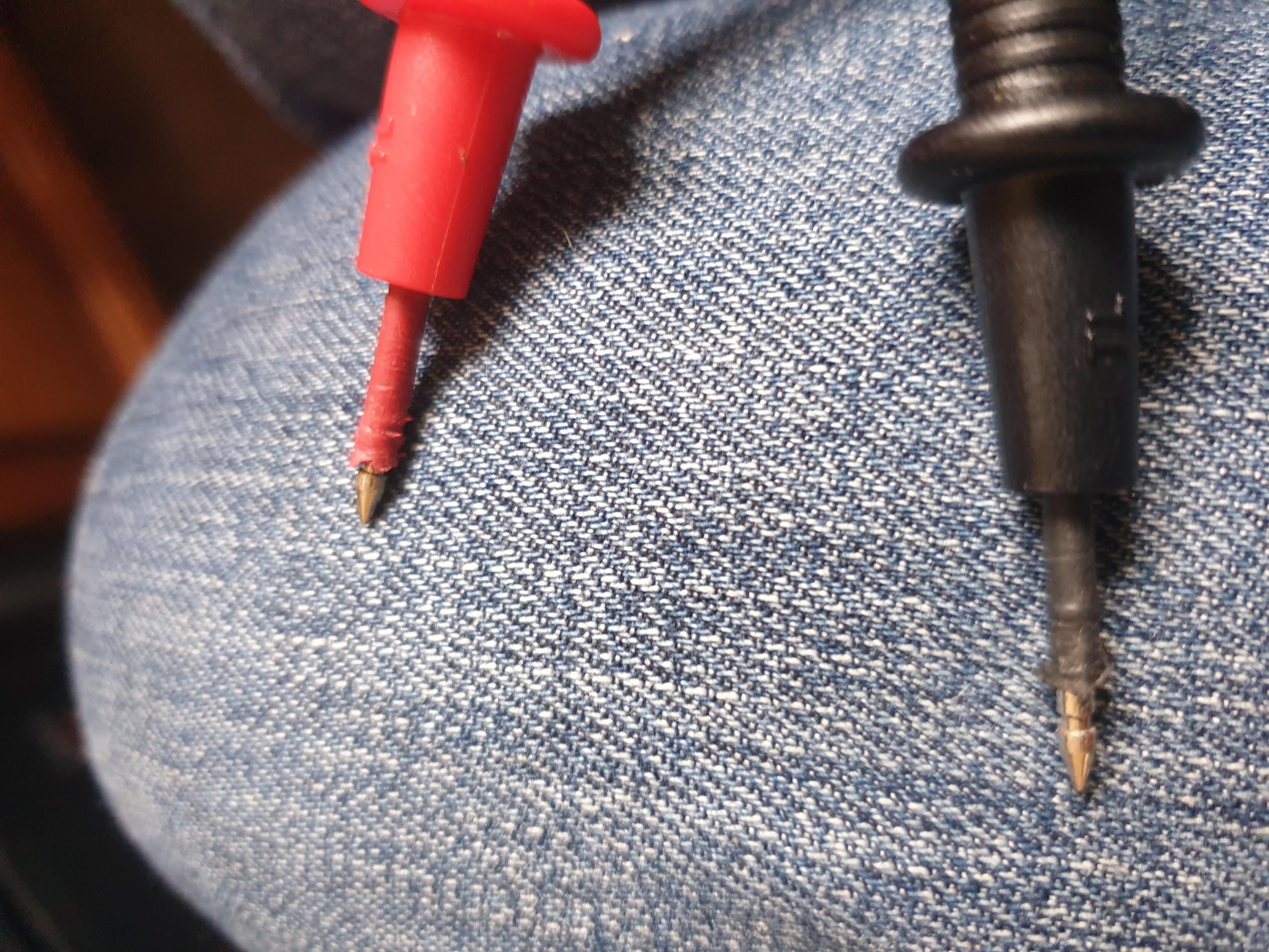

Welcome to the "oops" club. Using plain and slippery meter probes? If so, get yourself some hook probes or fit some cheap IC clips to probe leads before trying to manage both probes and adjust a loose meter (or some similarly awkward operation) at the same time. Fortunately, the output transistors are about the cheapest genuine spec. power transistors anywhere.
Hi there thanks for all the advice had a disaster today and shorted output transistor! Will report more fully tomorrow
