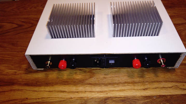

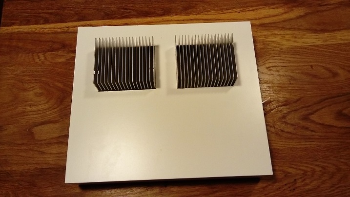

What a clever idea, Btsd, of DIY'ing the sinks! To get the back surface plain, I'd take them to an engine overhaul shop and ask them to put them at their cylinder head milling machine.
Best regards!
Thanks, I would like to take the credit for the idea but that came from the net. These are small enough 100x120mm to fit in my lathe and face the back of them. The next ones approx. 400x250mm will need to be taken out for machining the backs flat.

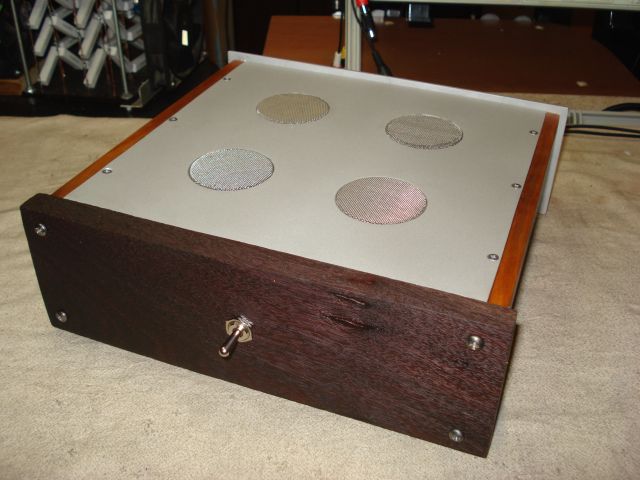

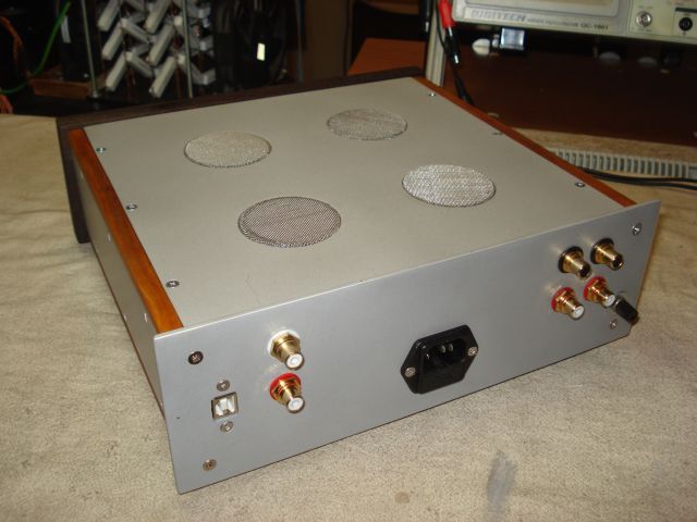

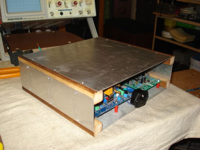

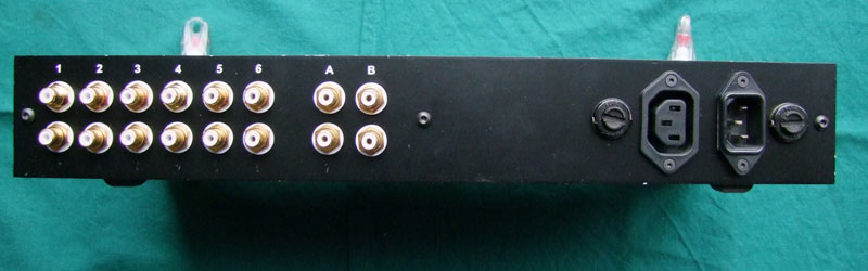

Another box. This one like the little ACA box is more a proof of building style type thing. All shed scraps. Not wasting what good timber and ally I have on an experiment.
Tony

Nice work. From where do you get the circular mesh grilles?

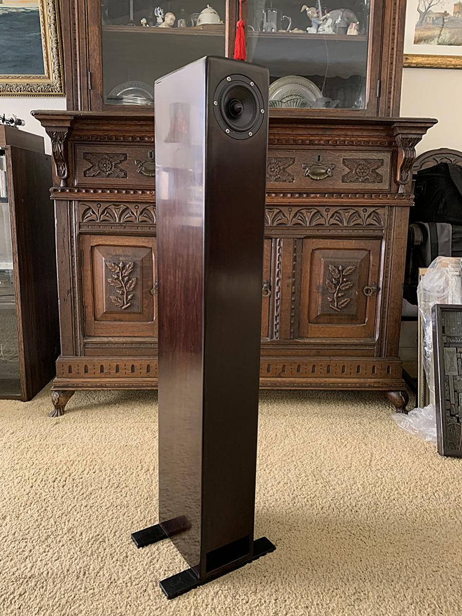

Excellent stuff everyone. I'm about to start work on an enclosure which will house a little 2.1 class D amp and a 24v power supply that i use to power a pair of Dayton RS100-4 Cyburg Needle Speakers I recently built. I'll likely upgrade the amp board sometime once i find a suitable one.
I'm going to be going with the sides of the enclosure made from Walnut, with an inset top that will be perforated aluminum. Probably the same for the bottom of it. And offset to one side in the front an inset aluminum panel which will have the knobs, etc. Should be a fun build. I love working with walnut. Has a great smell to it. lol.
Here's one of the speakers i built. Figured i'd stick with the wood theme.

Nice work. From where do you get the circular mesh grilles?[/QUOTE]
I made them out of some fine stainless steel mesh I had sitting around for years.
I machined up a crude die for the hydraulic press to get the right shape and depth for the hole.
Tony

MDF?, wood? in close proximity (~1cm) to very hot glass tube envelopes? Over time? Smell?
Cases are open at the bottom with some mesh protection. With preamp tubes(low power) no heat problems or smell.
I have now in the same mdf enclosure with open bottom 2 x 400W class D amp and linear power supply . No problem with heat at all.
