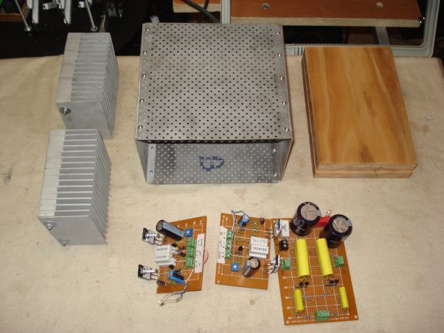

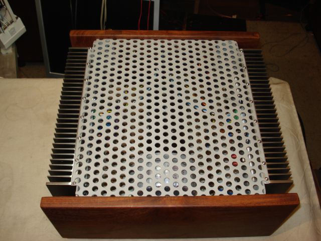

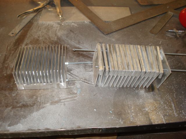

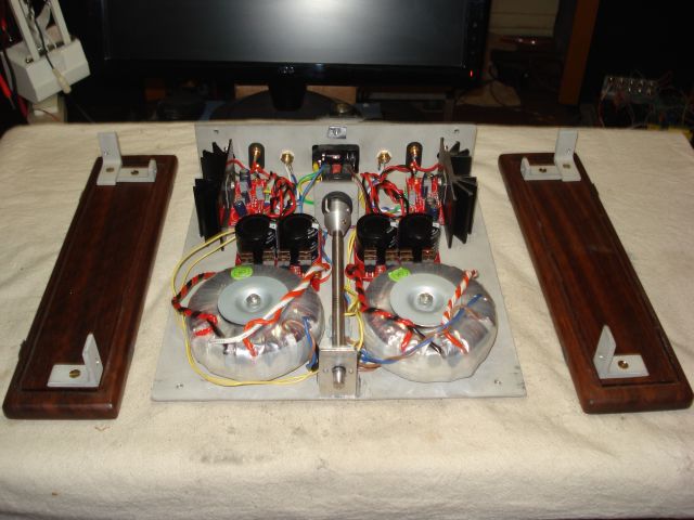

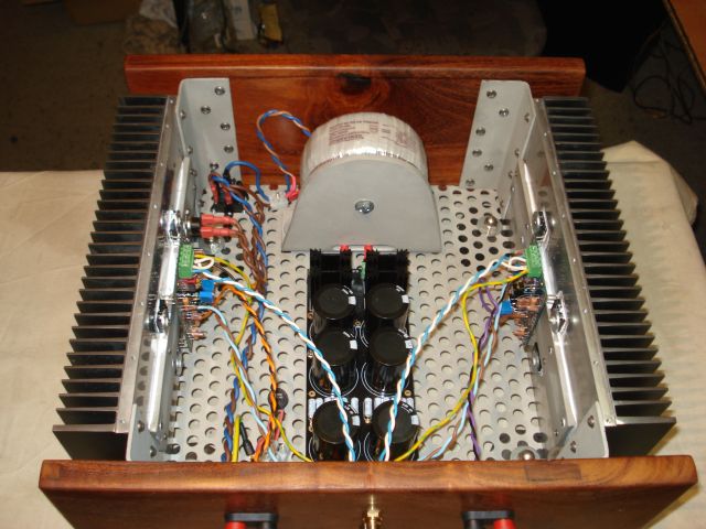

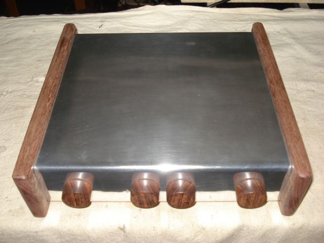

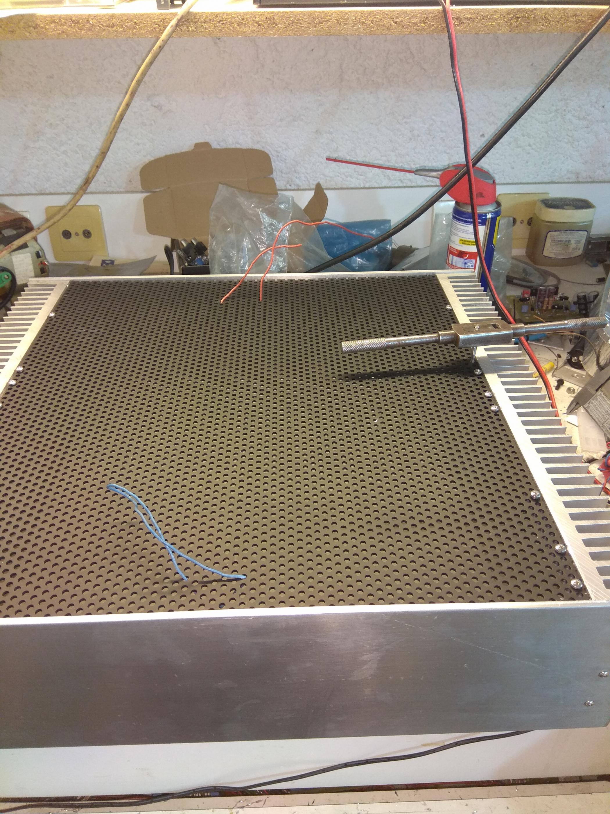

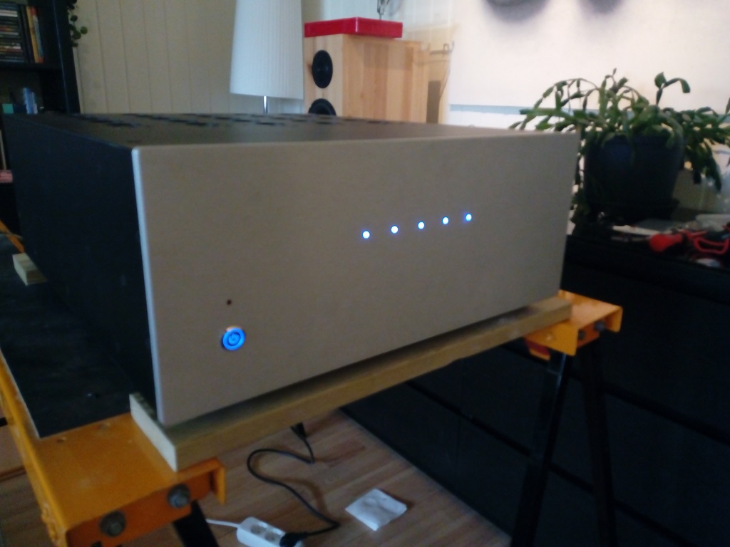

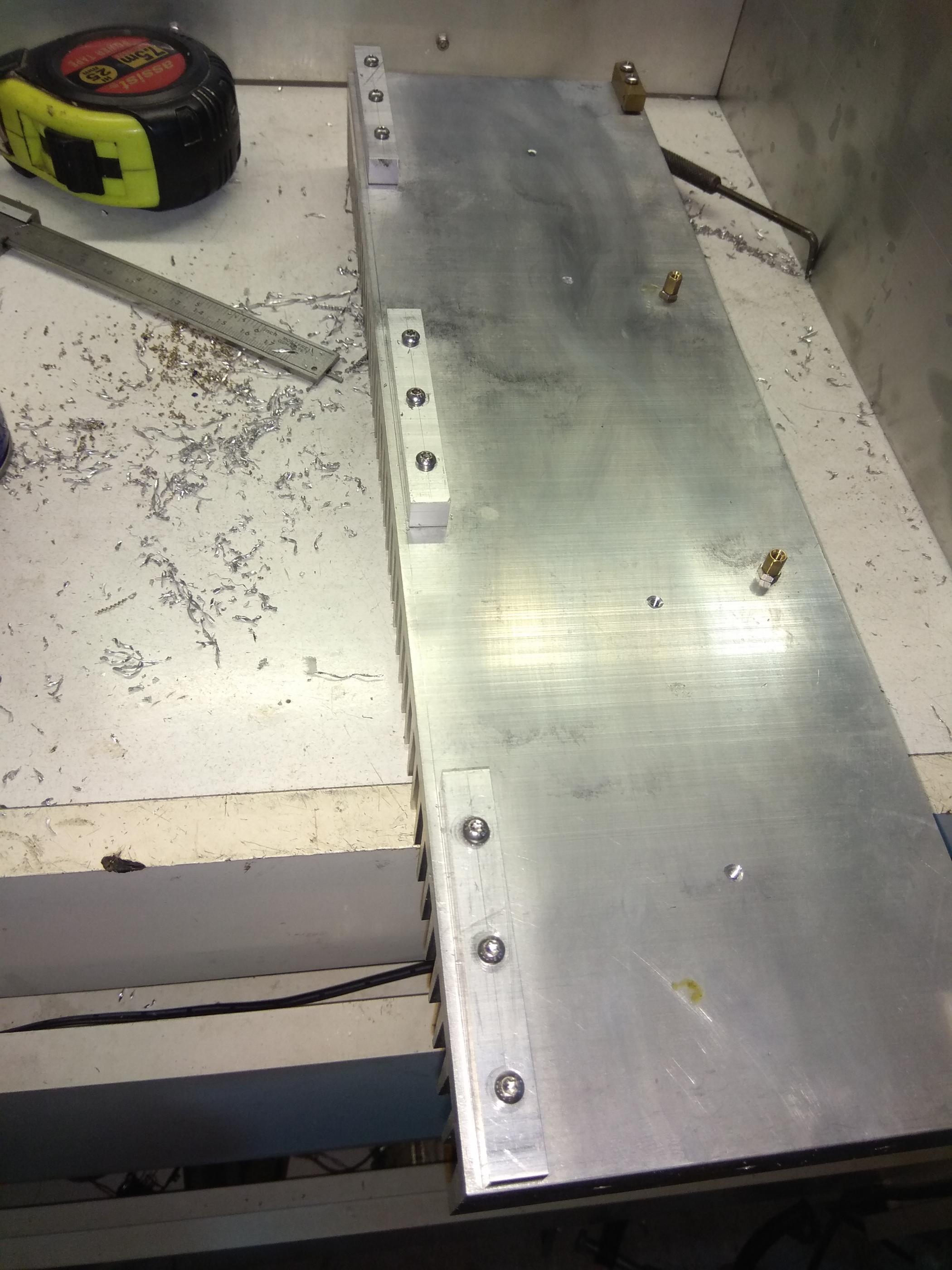

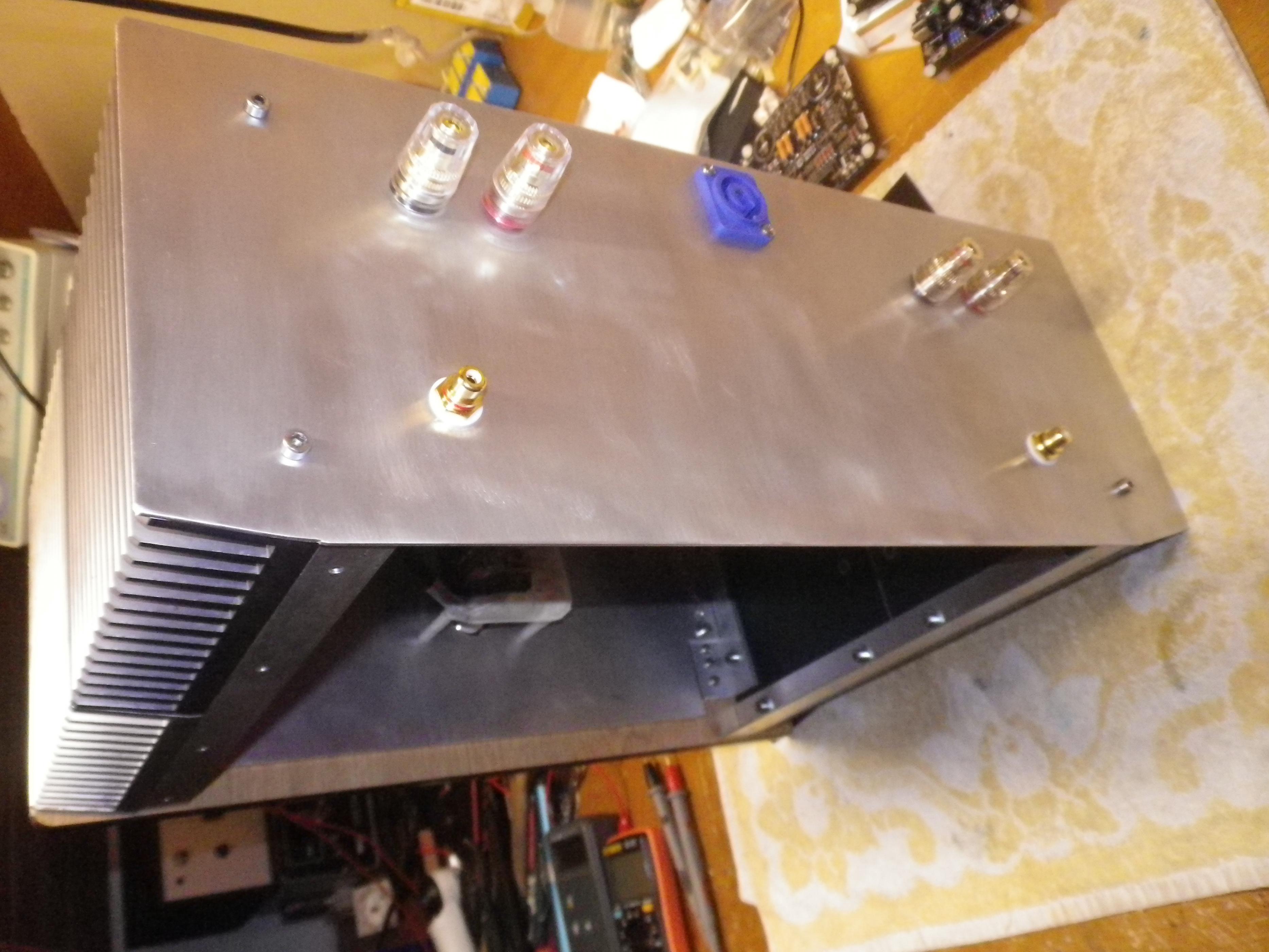

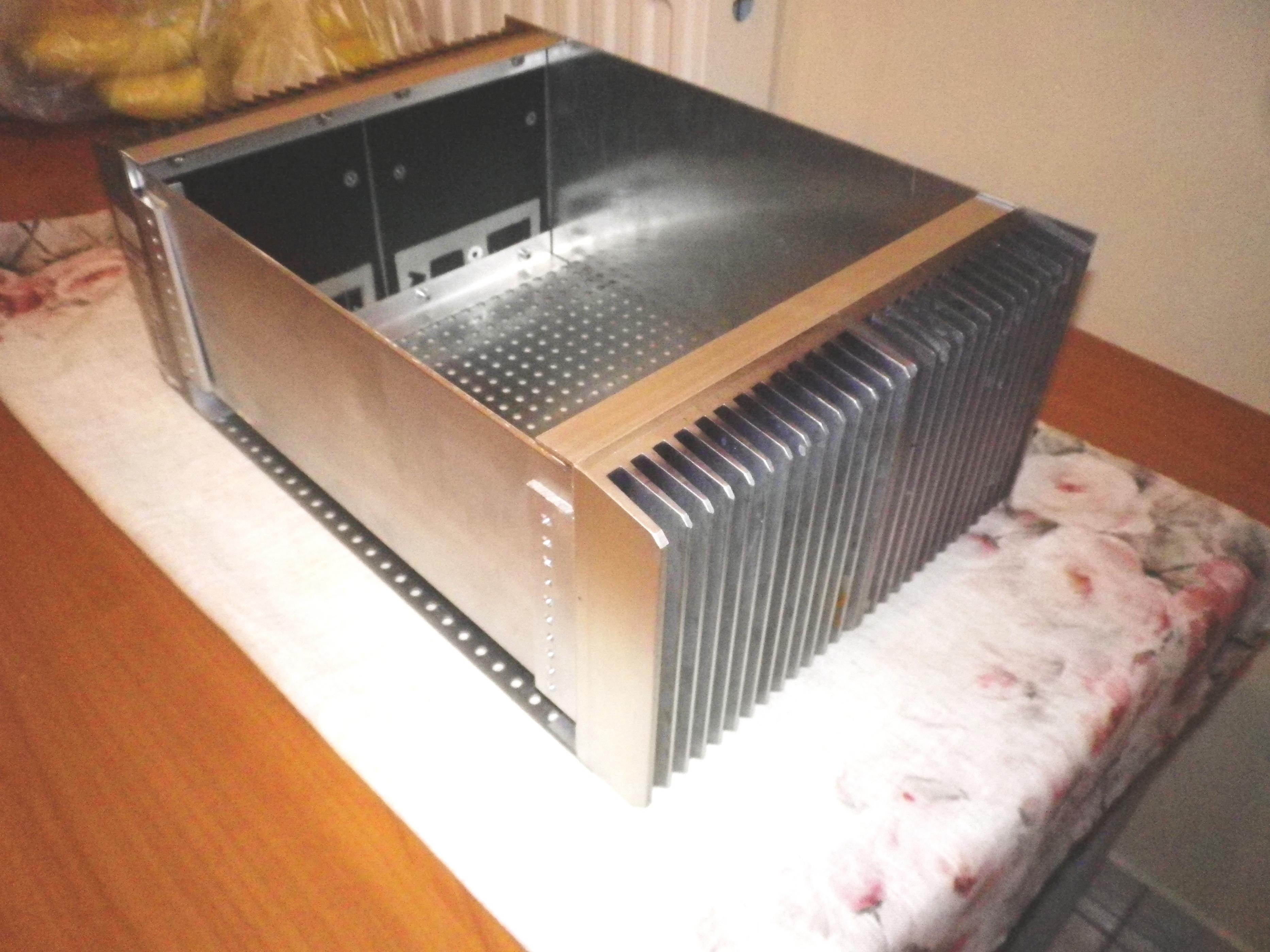

here's the last chassis i build from scratch (besides the front panel that is from modushop). build cost was about 130€ inkluded Paint.

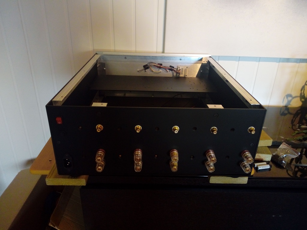

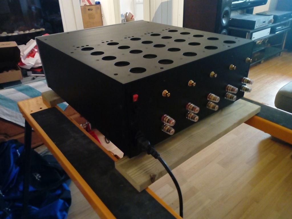

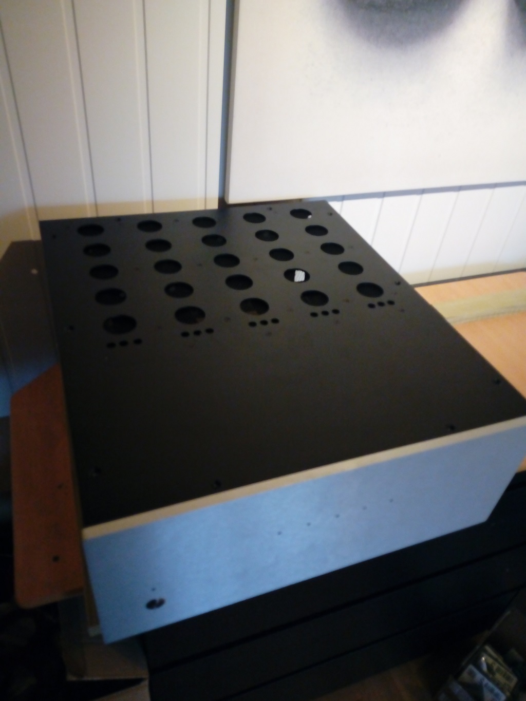

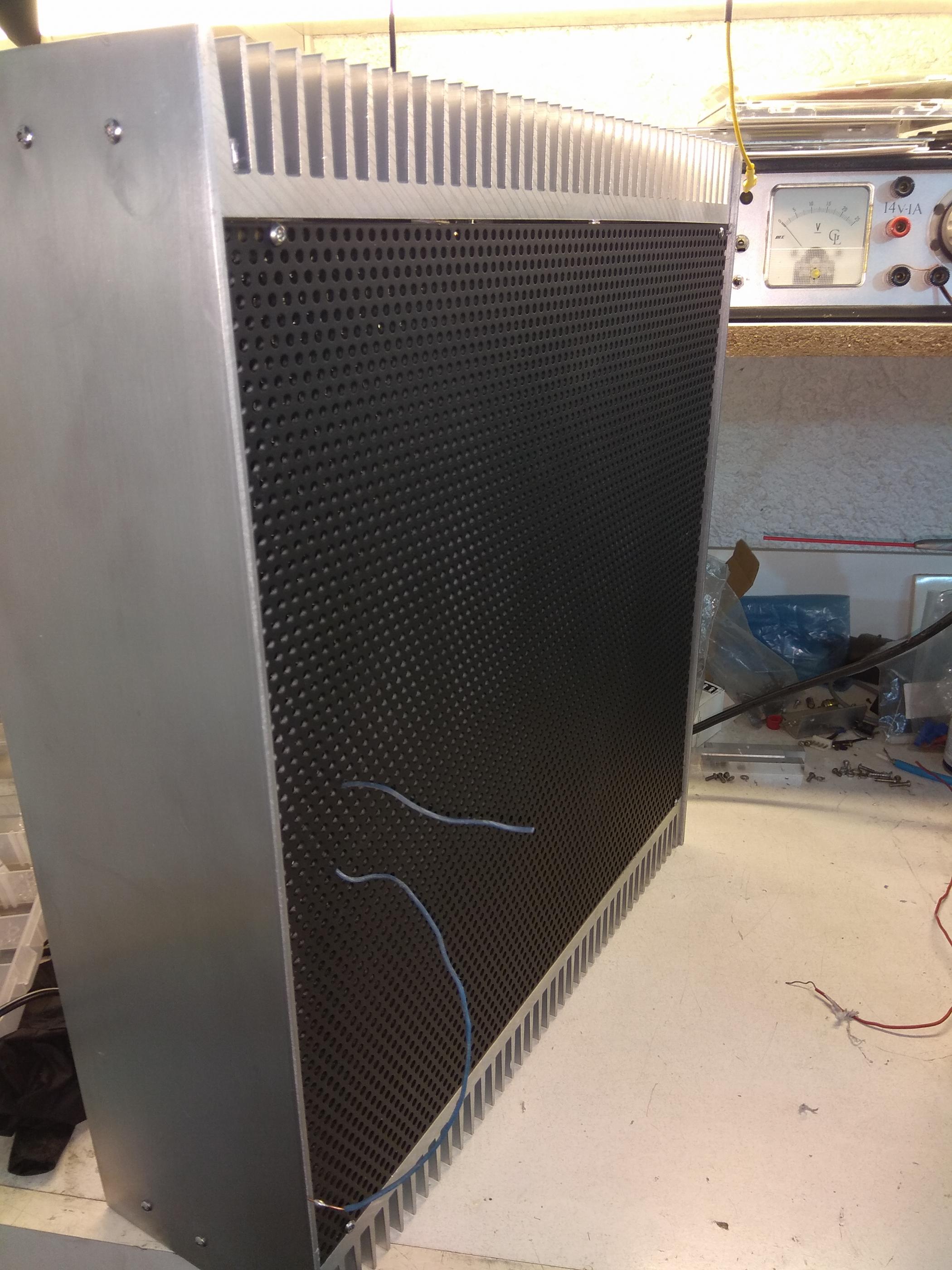

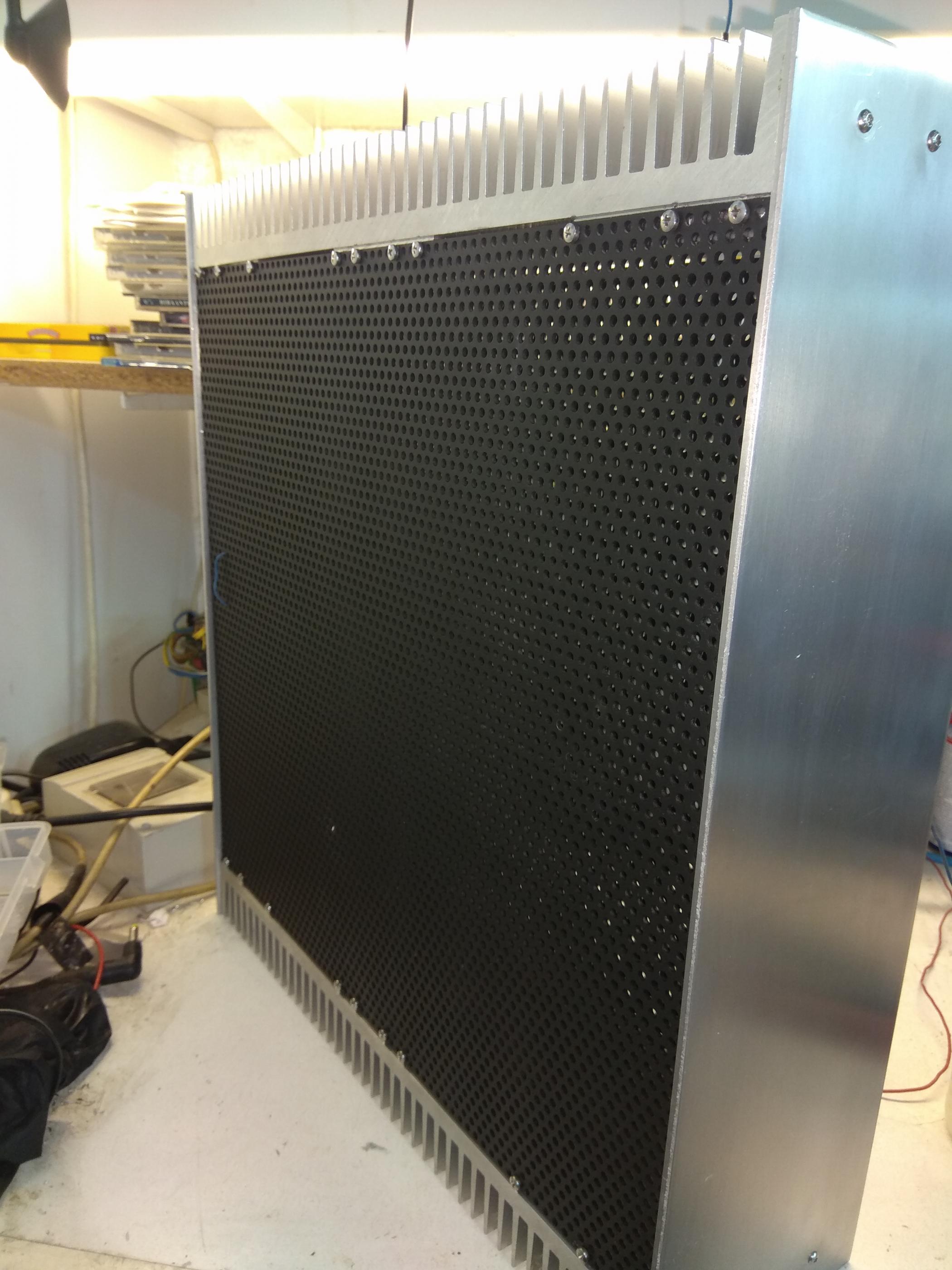

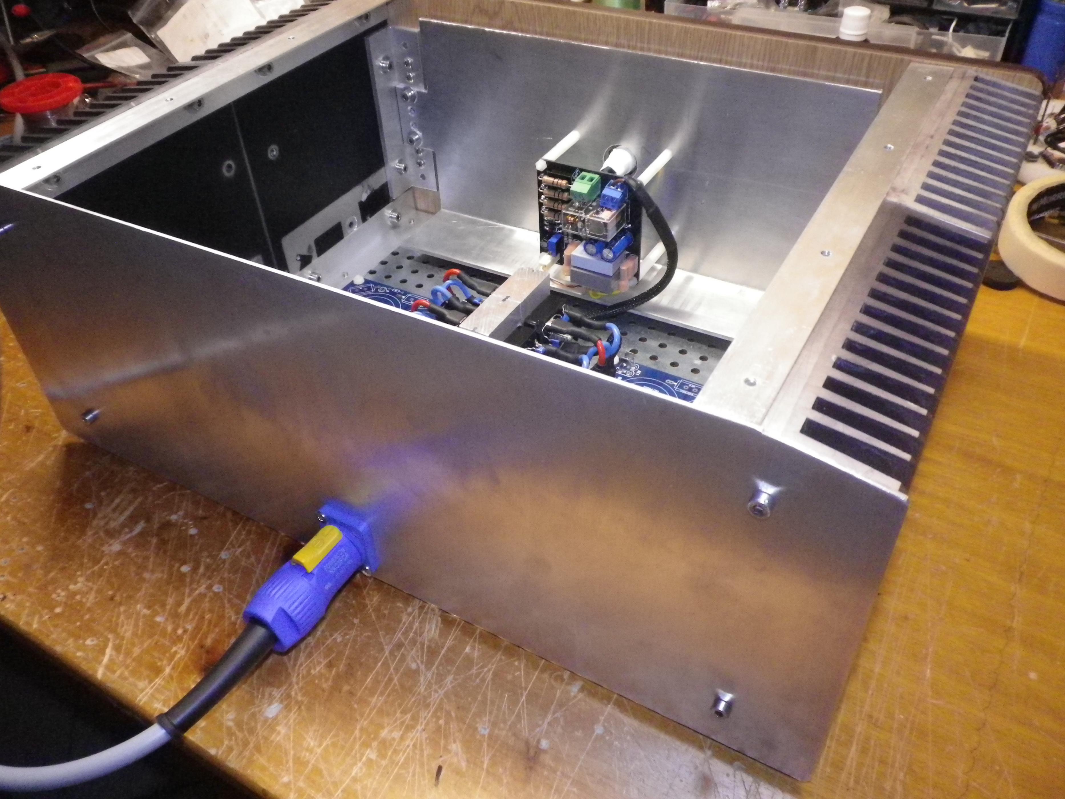

Look Andy, the top and bottom aren't aluminium.
They are steel 3mm.
They are painted using primer and then paint.
Frond and rear are 4mm aluminium.
My plan is to anodize and paint this.
I use a mixed method,as i can't buy clear, not scratched aluminium.
I will anodize the rear and frond and then i will paint with a mat black spray.
Some pictures with the progress.

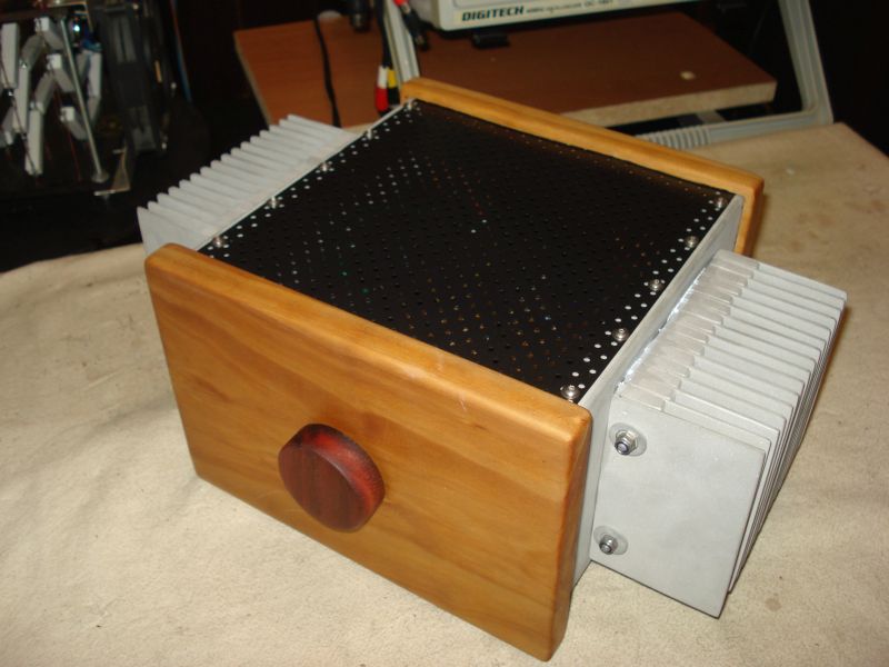

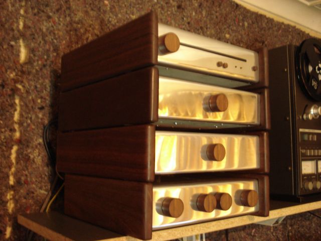

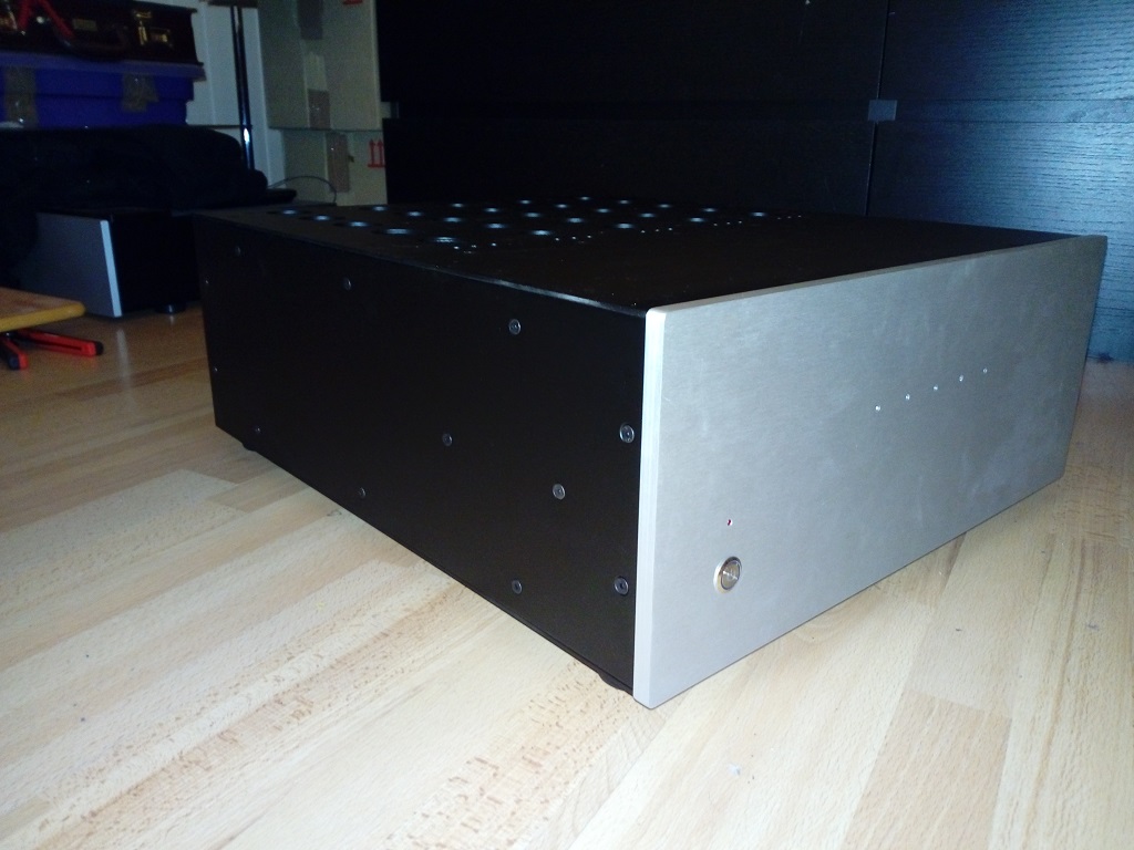

Some of my boxes.

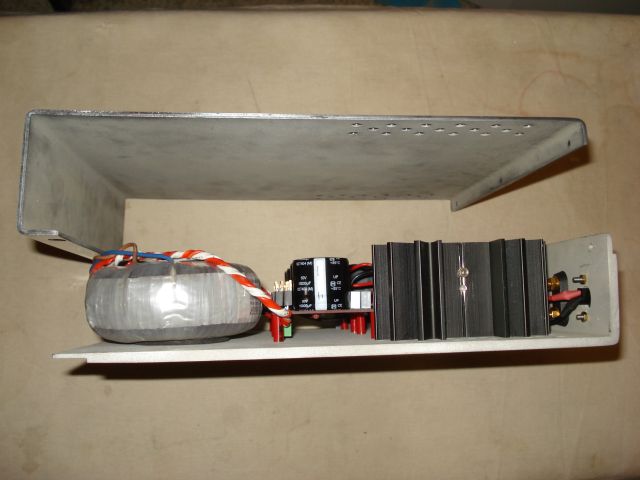

Hello!

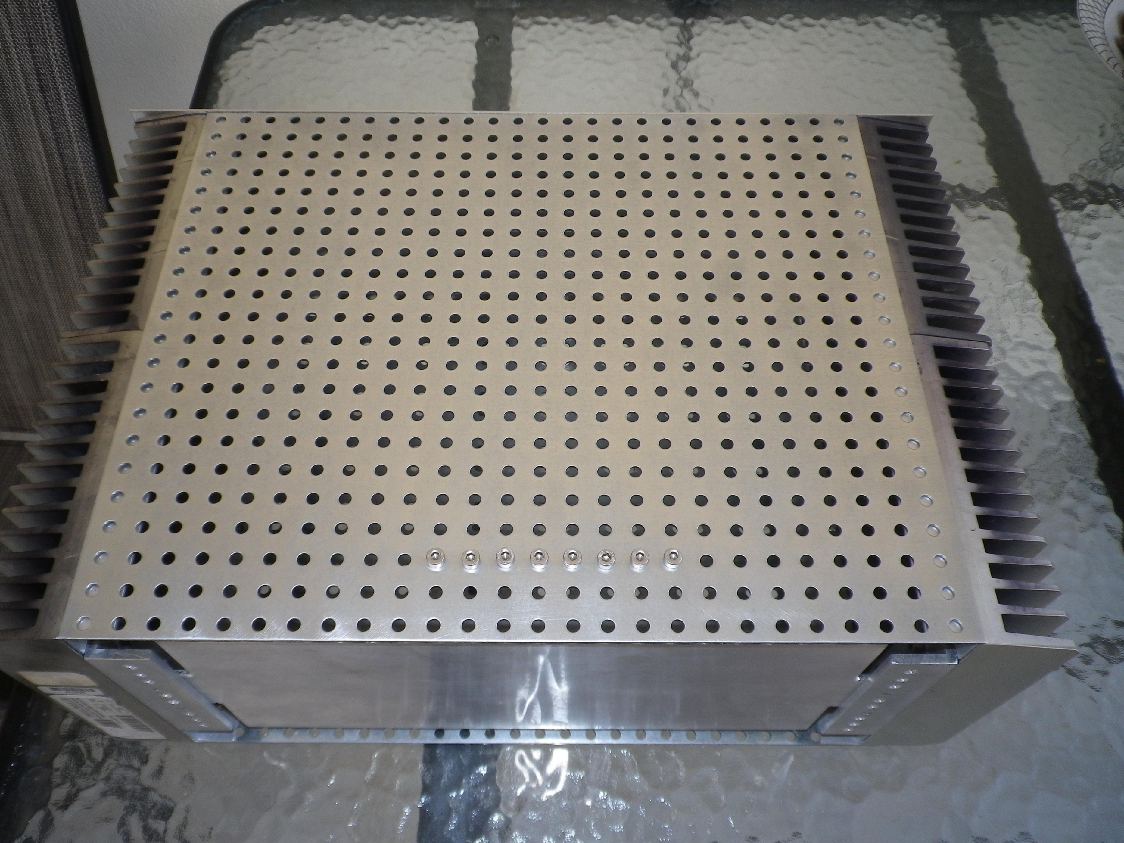

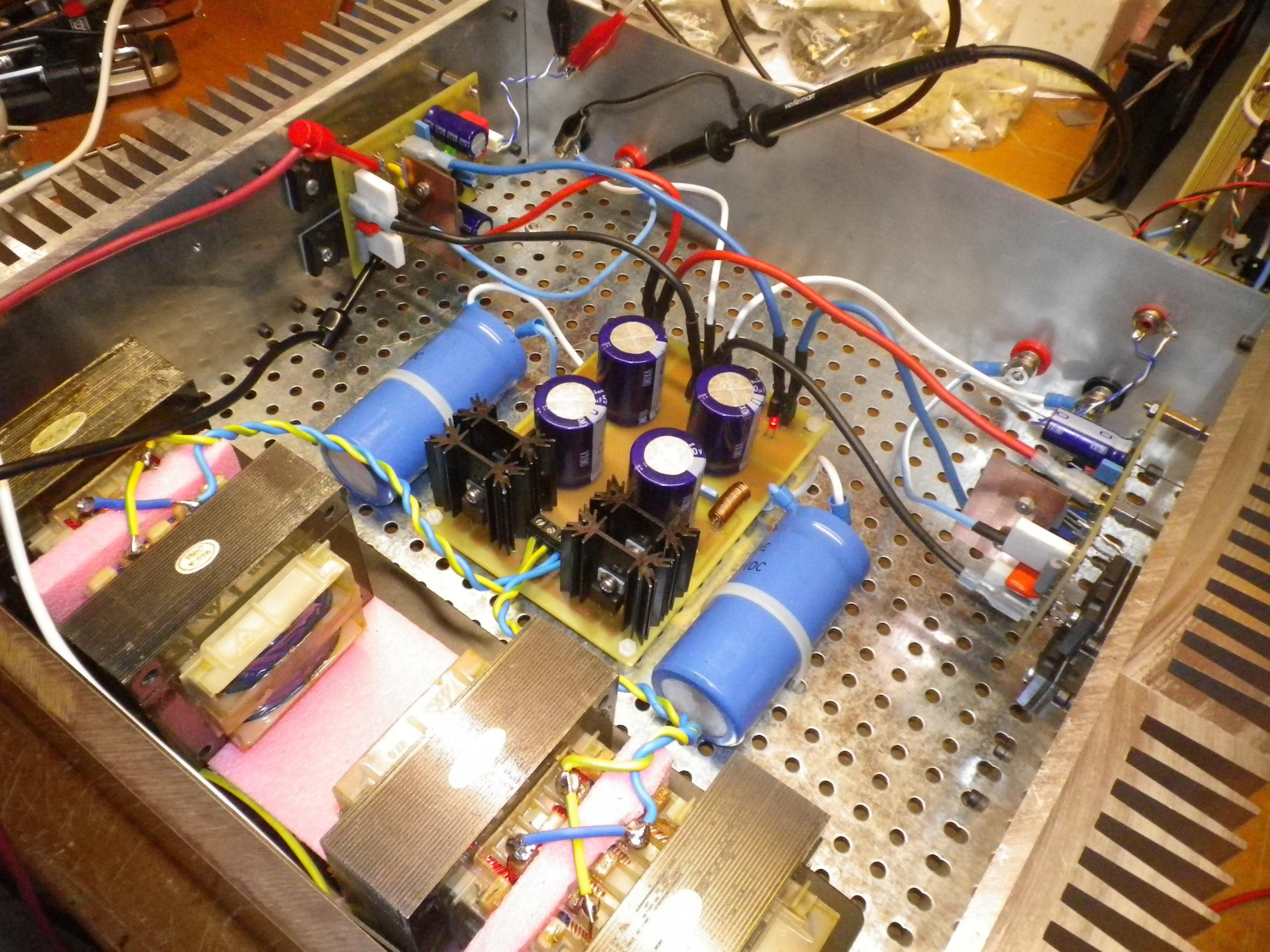

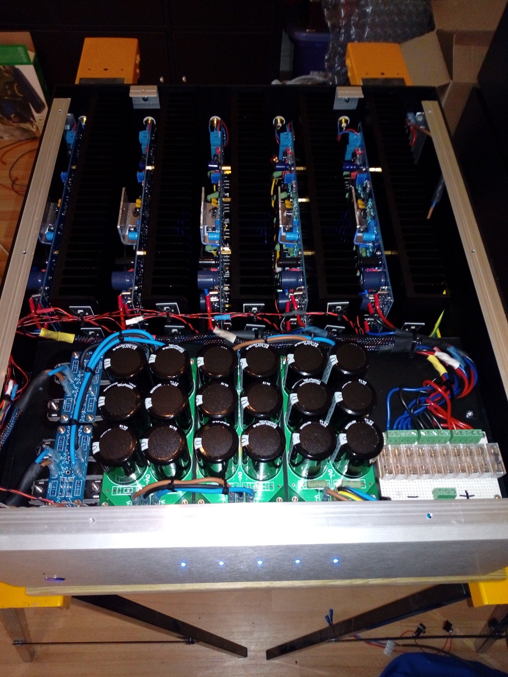

I'm building 6 monoblocks right now, and after thinking about what boxes to make, I decided on the following option.
From the sheet metal, I built the internal skeleton of the amplifiers, making sure that the power supply was separated / shielded / from the circuit boards.
Since the monoblocks will be in bridge mode, there will be 1 radiator board on each side and the power supply in the middle.
I know it looks pretty ugly, but it's the internal skeleton of the amplifiers, the supporting structure, and you won't see any of it in the final version.
When completed, there will be facade panels installed around the skeleton.
The topic is very interesting and contributes to the exchange of experience.
Greetings!

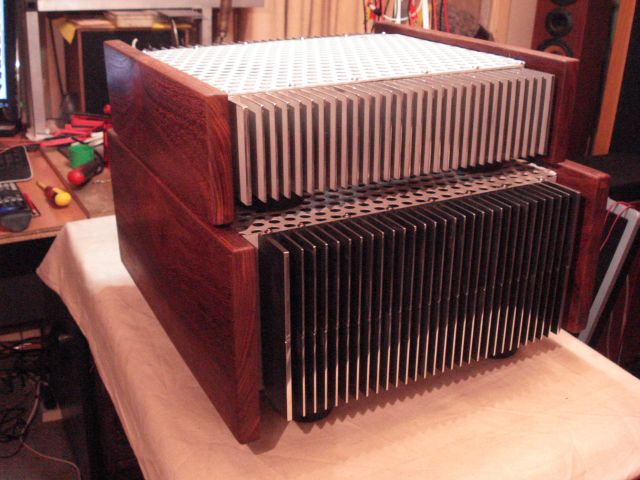

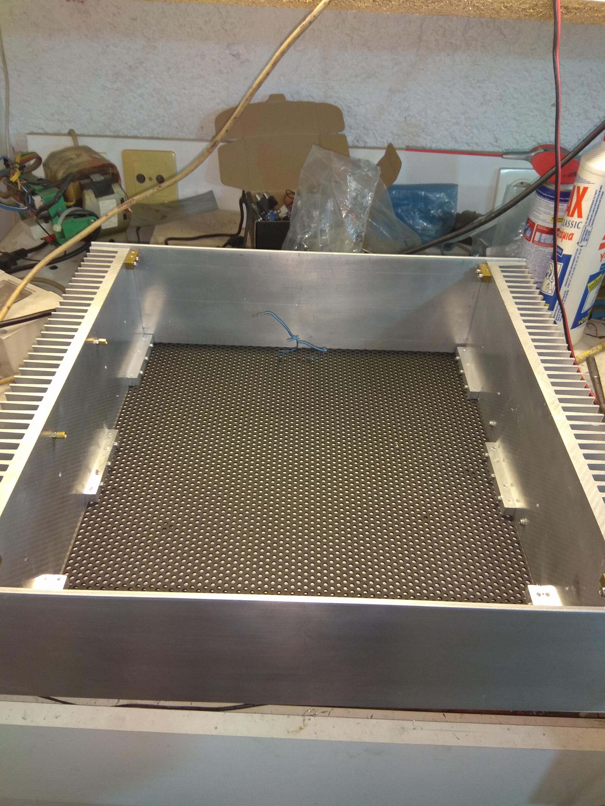

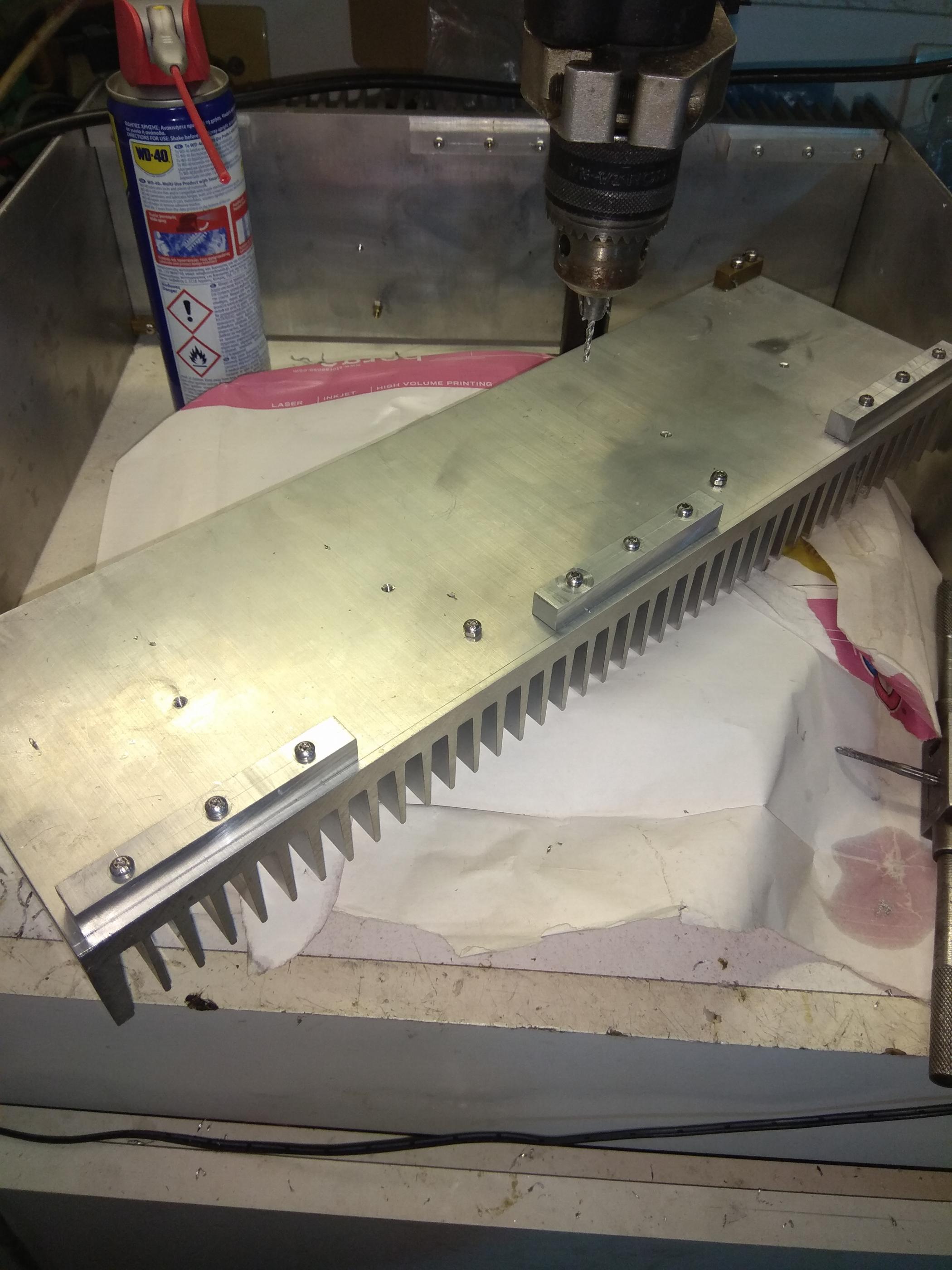

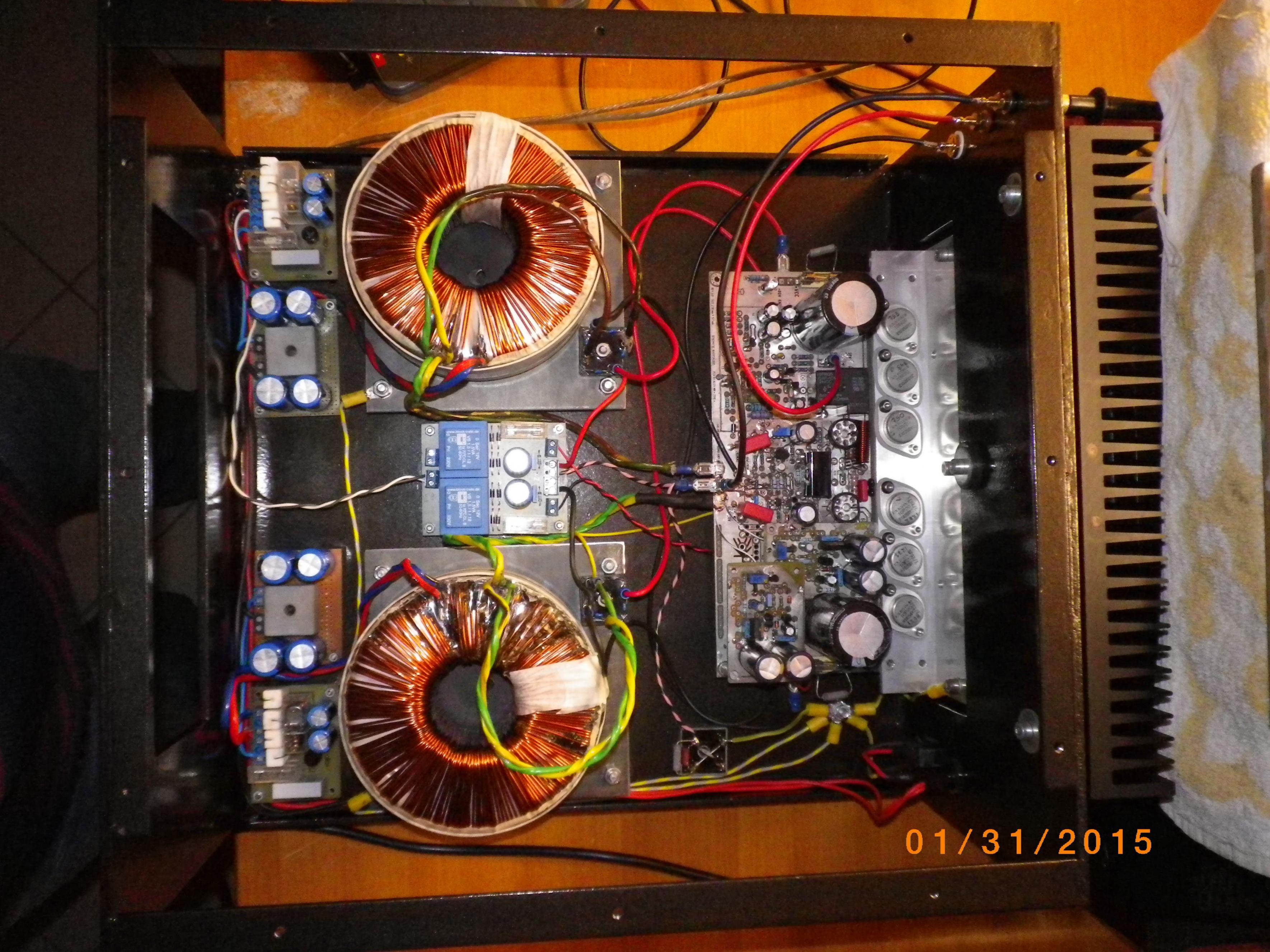

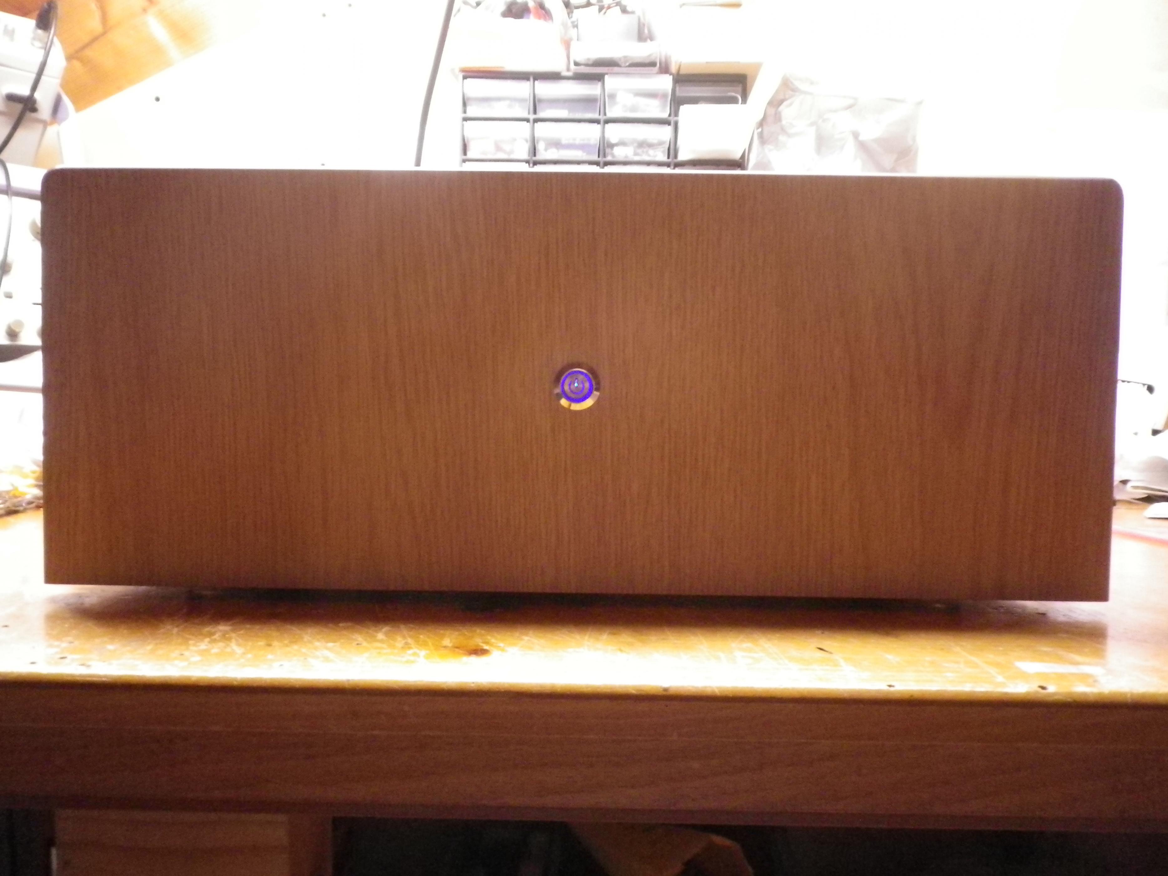

Hand made all as my friend Thimios.
Mimesis 9.2 clone steel plate 4 mm -USSA -P3A.
