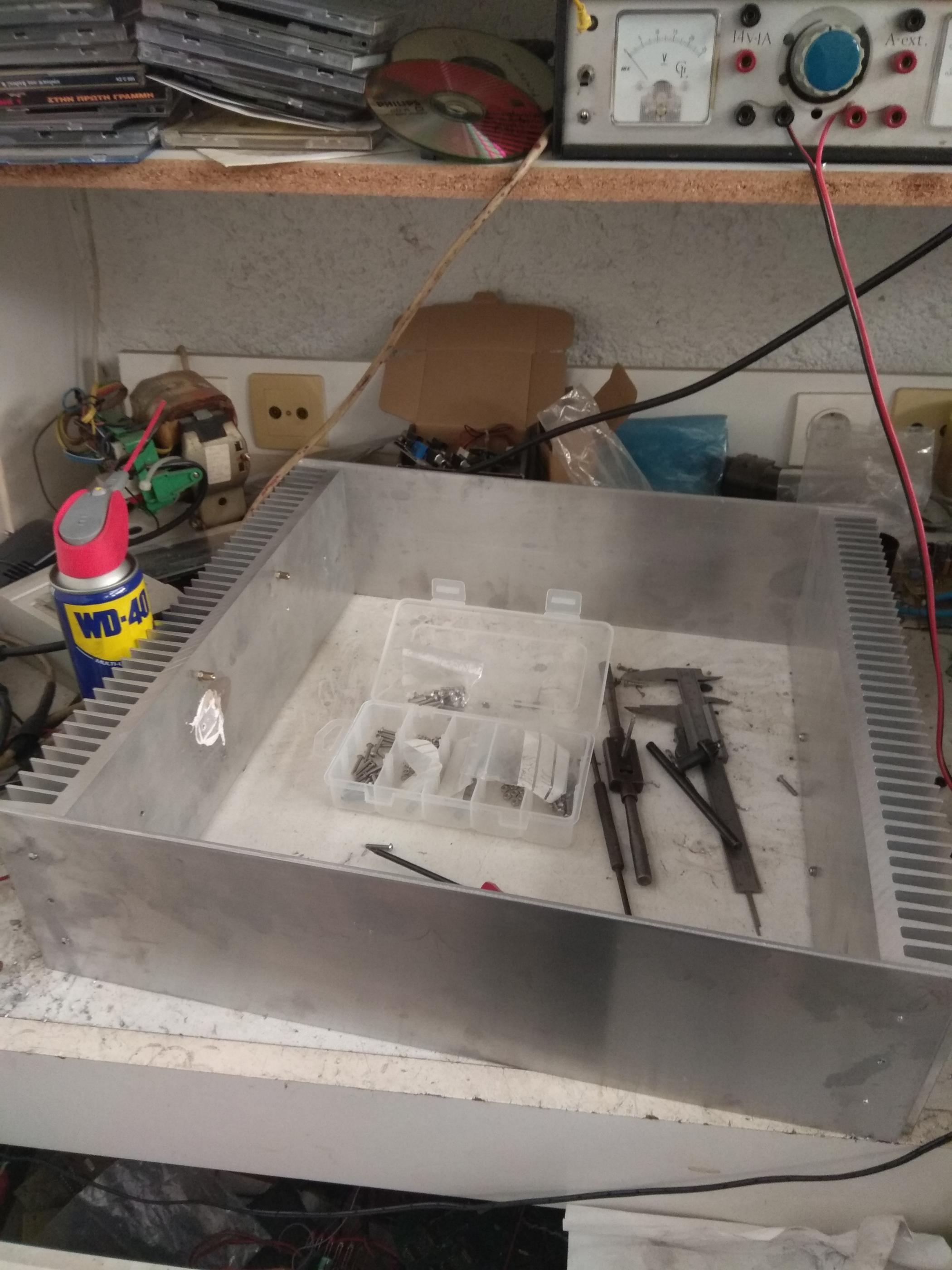

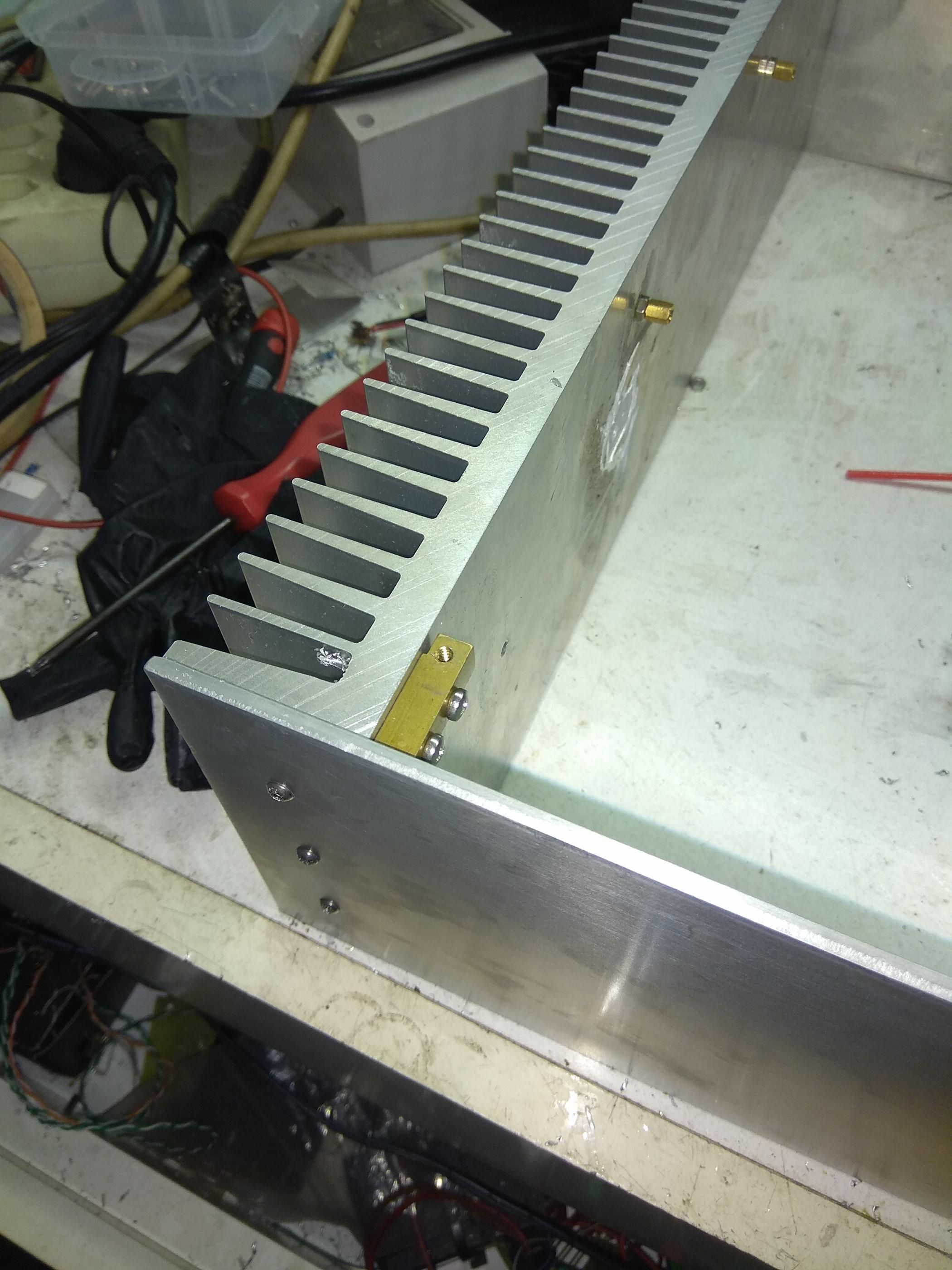

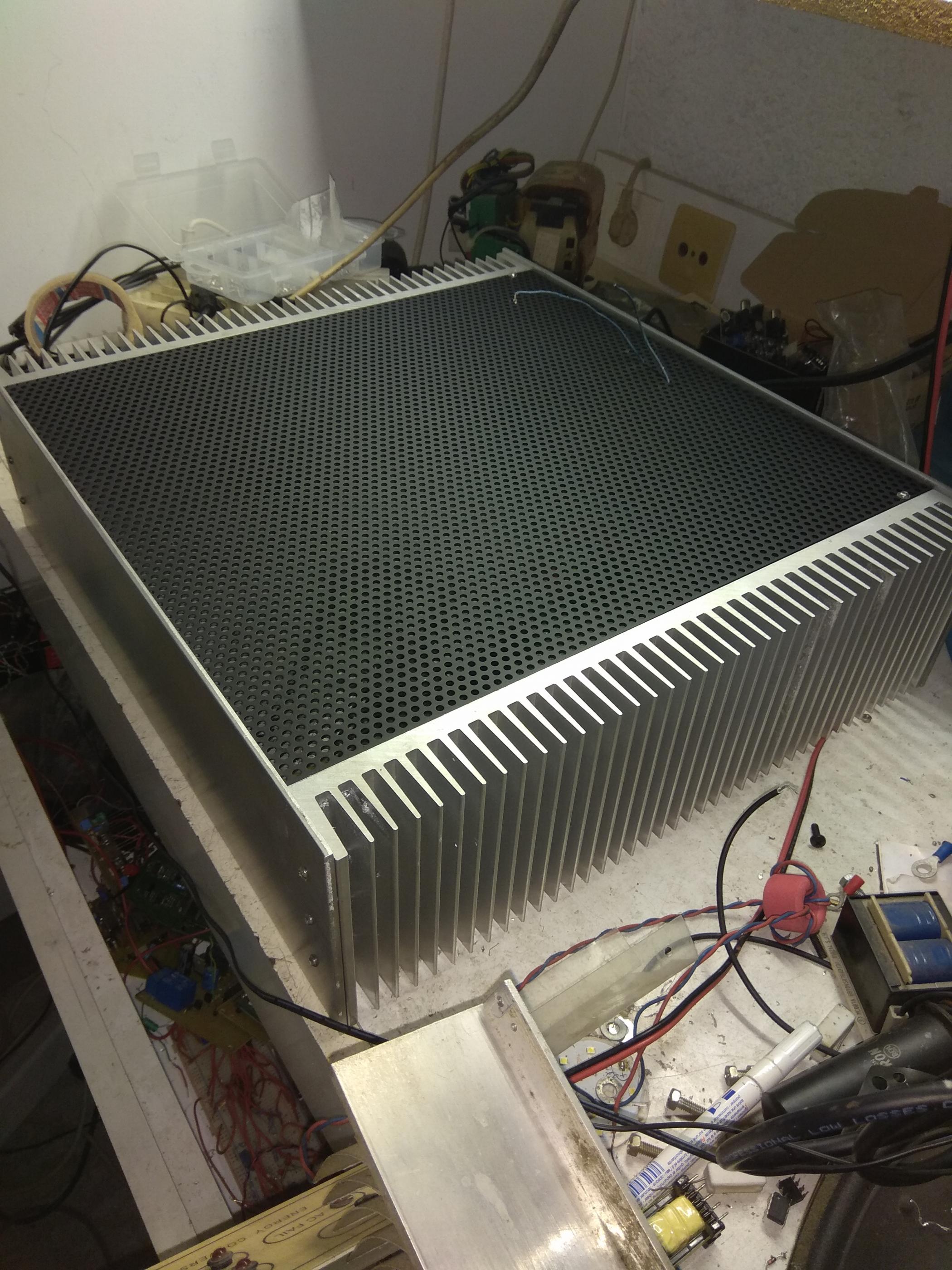

Building your own amplifier enclosure.
I have many amplifiers but i can't afford the cost for housing.
Here is an attempt for my own building.
Heatshinks is a donation from the past.
Thank you Toni. :)
So far I have spent 25 € on the aluminum, front and back sides as well as the perforated sheets.
10 € for spray primer and paint.
Front and rear are aluminium.
Top and bottom are 3mm steel.

Thanks for sharing - at some point soon I may need to design a custom enclosure and this sort of idea is great to have. BTW copper-clad FR4 is another, lighter, material for cabinet construction and front/back panels. You can spray paint it if polished copper isn't your aesthetic. Its nasty to mill/route though, and I suspect getting a PCB fab house to do this for you isn't cheap, but can get it screen printed drilled and routed to arbitrary specification and even mount components on the inside if you wanted.

That is great Thimos, well done, I have the same idea to use the heatsinks as the sides.
I wonder where Tony sourced the extrusions?
I know that we can get similar ones at Extruded Aluminum Heatsinks from HeatSinkUSA for a reasonable price, also the ones from the DIYAudio store are more expensive have a finer finish and are anodized.
I do agree with rayma, extra bracing required, esp for the transformer weight.
Good luck, keep up the good work and us informed as you progress.

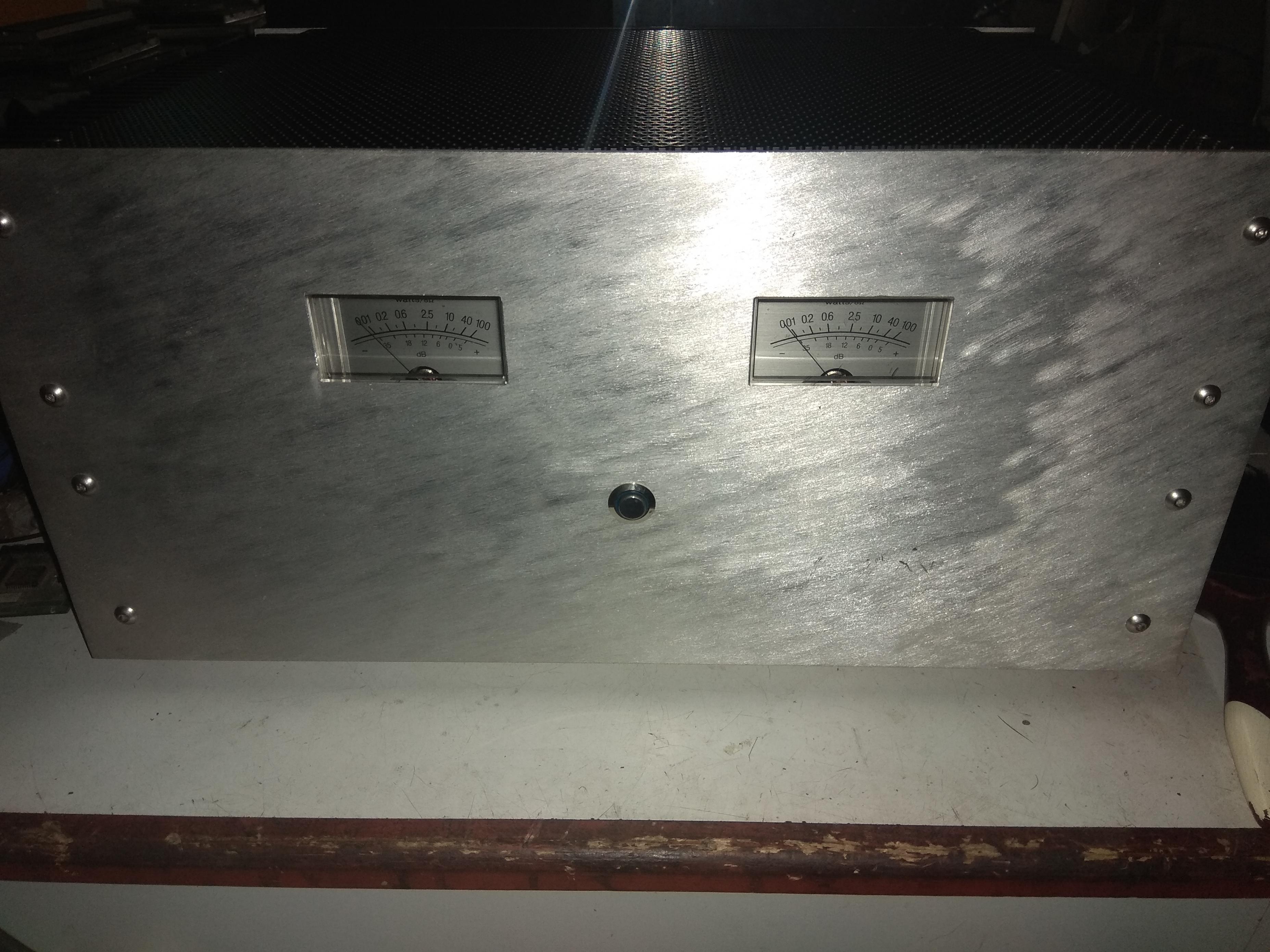

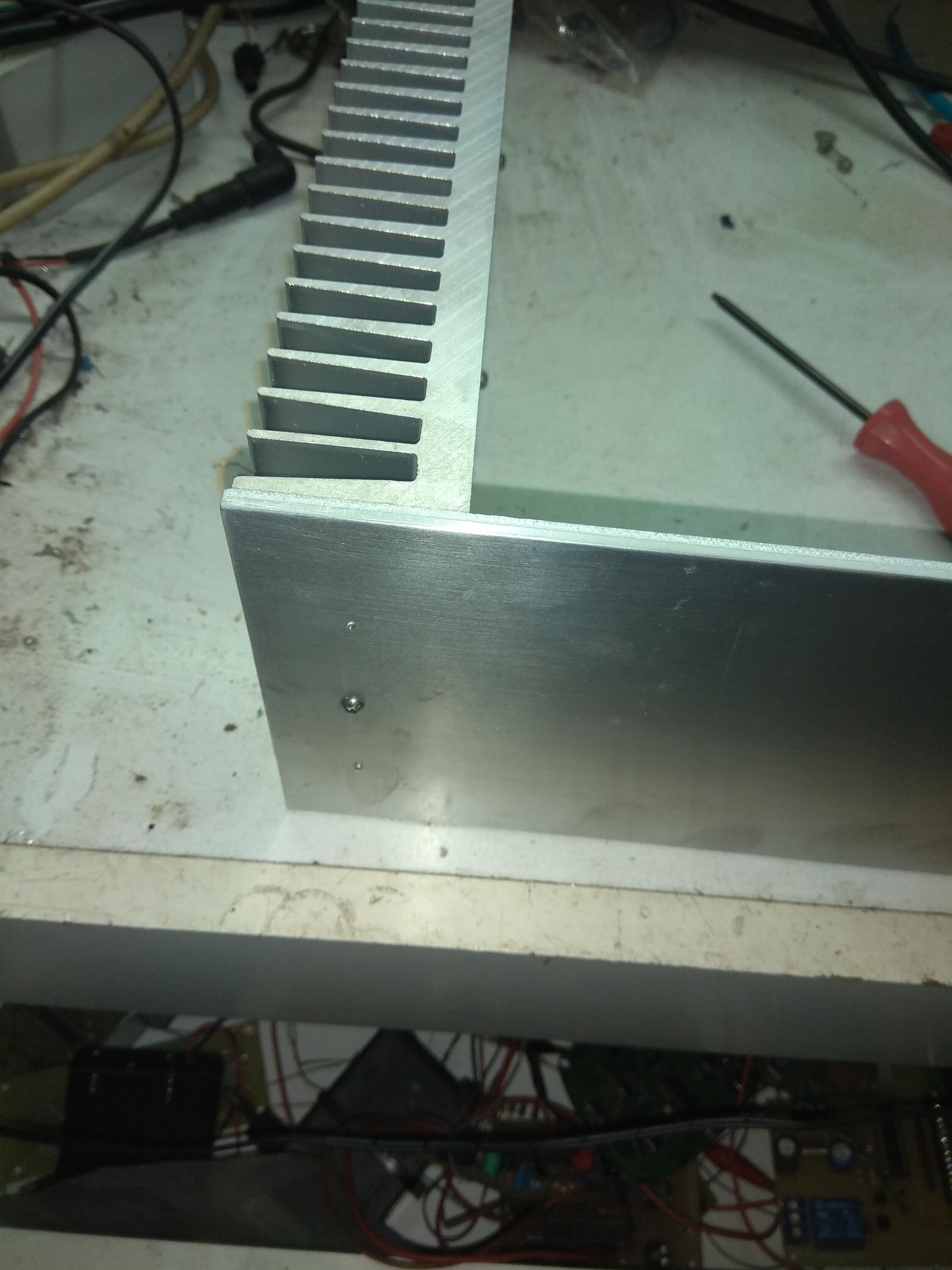

Thank you all for the perfect explanation on anodizing procedure. Here is how they look.
My SX class A.
In the first picture the front braced but no anodized not painted yet,after 2 or 3 years! :D
In the second picture the back plate anodized and painted.
Top and bottom is 3mm steal.
Isn't enouph?
