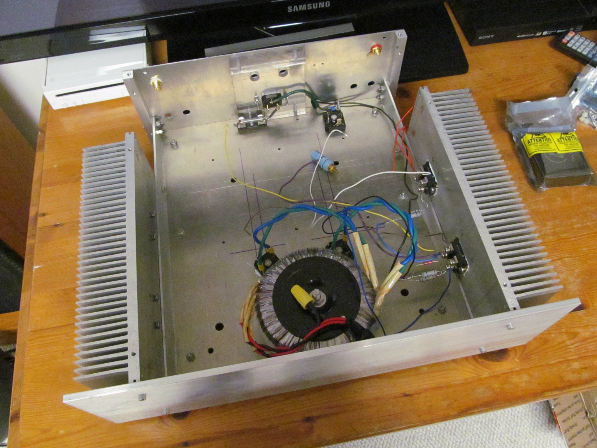

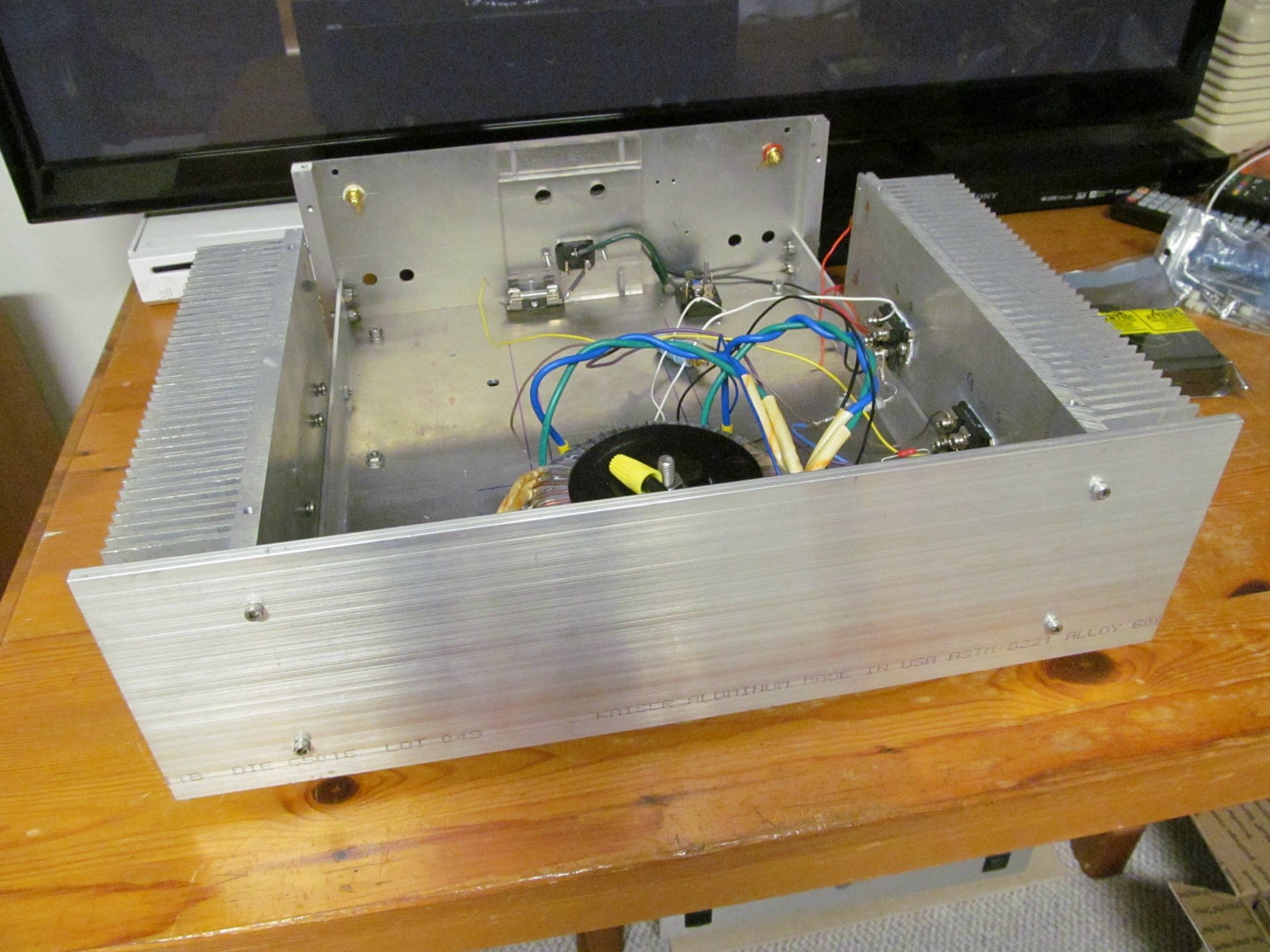

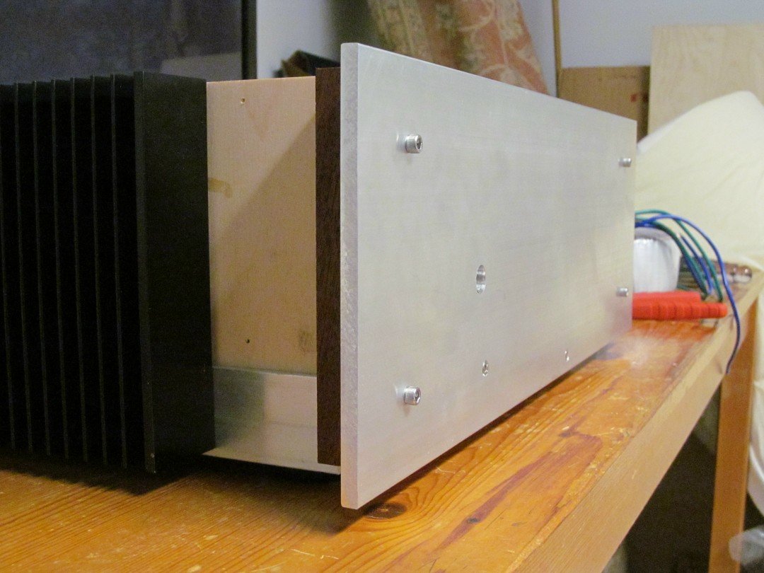

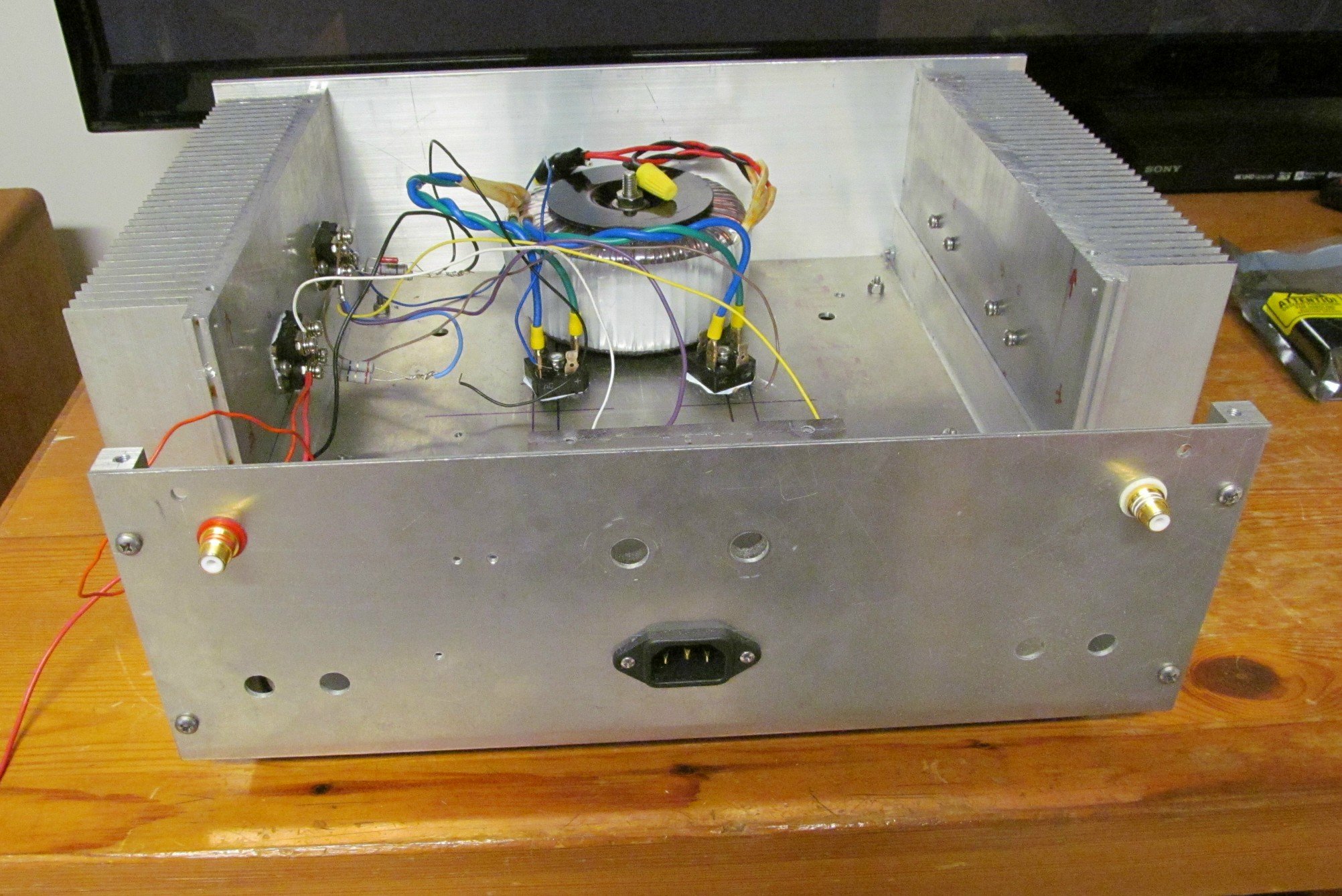

Throwing out ideas , here is the first case I made for Power Amp .
AnTek used to sell heat sink material - I don't think they do any more .
The face plate is just a piece of 0.25 x 5 " piece of flat bar 6061 Aluminum .
This can be cross cut using a table saw , a good cross cut guide , and a carbide blade .
Note that if you are going to cut any material , there should always be at least 2 teeth in contact
with the material being cut .
In hind sight , I should have built the case with the heat sinks at the back
in order to shorten the length of the power supply , speaker and RCA wiring .

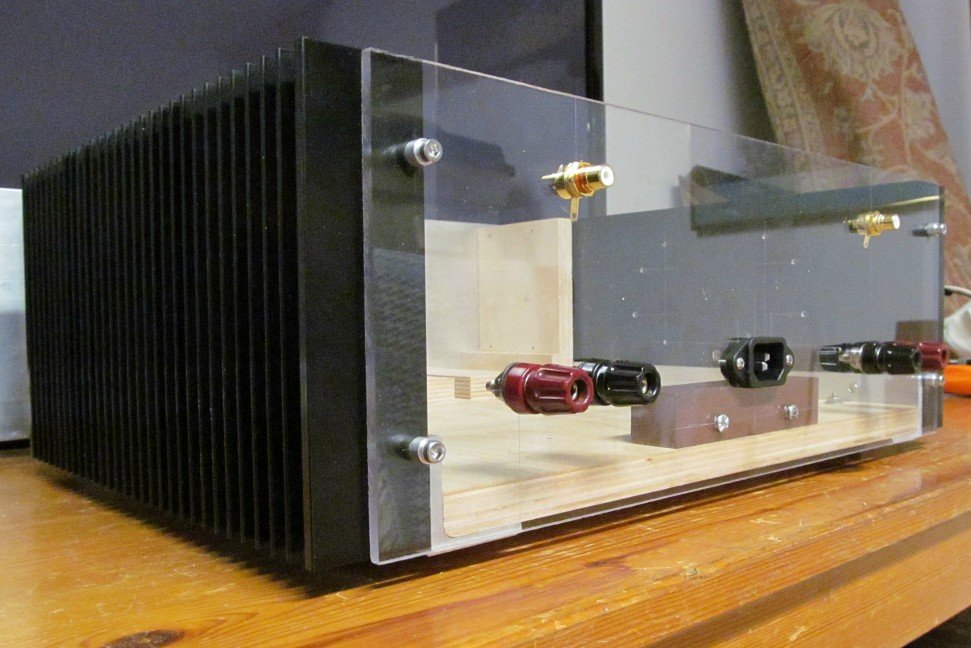

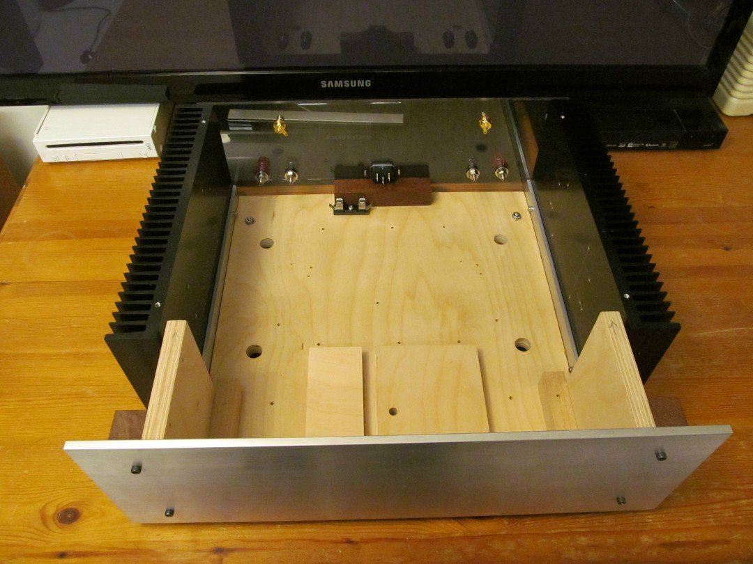

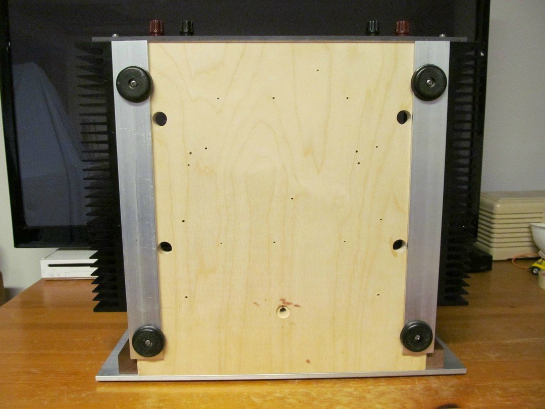

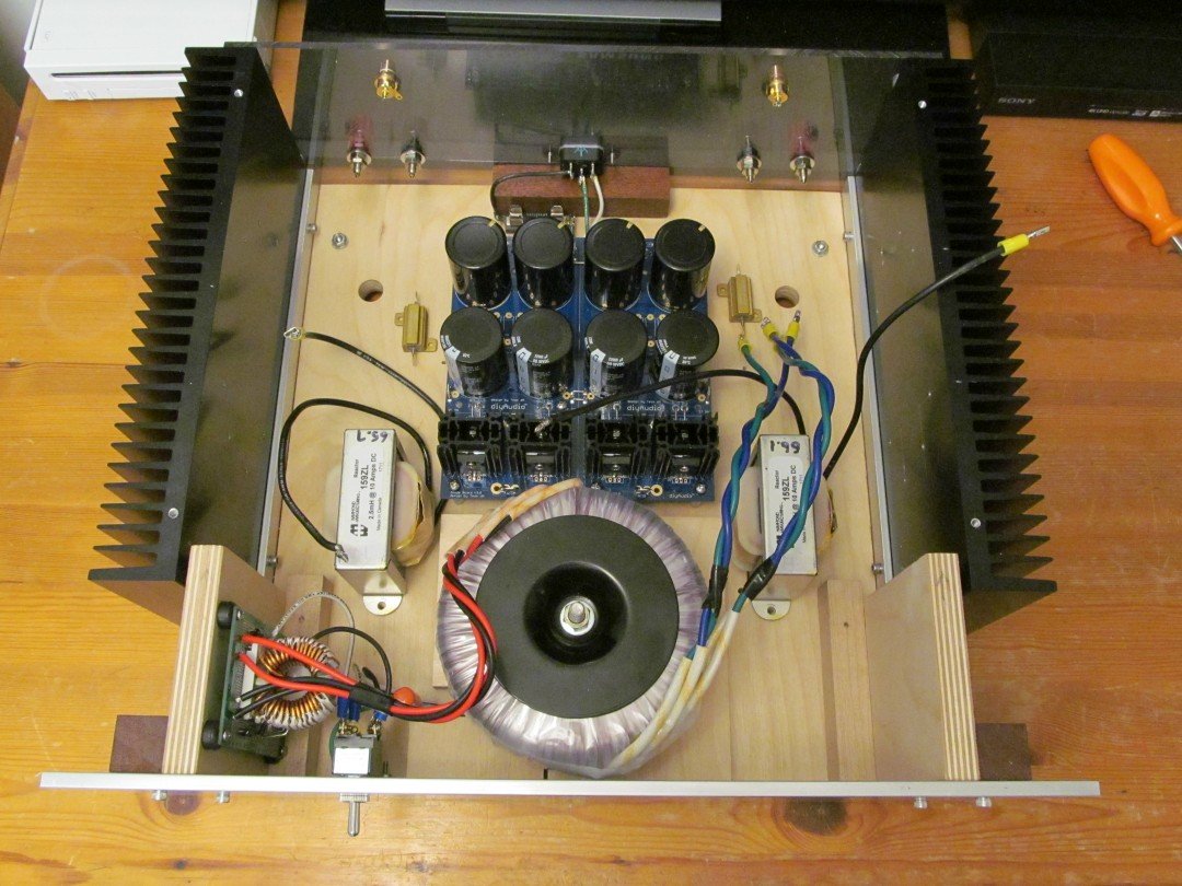

So I'm in the process of making my second power amp case .
Going to use a piece of 15mm thick Baltic birch plywood for the base .
For the face plate , I've just ordered a piece of 0.25 x 6 x 19 " flat bar 6061 aluminum .
The heat sinks are made by Multicomp
MP008442 is rated at 0.42oC / Watt
MP008443 is rated at 0.36oC / Watt
There will be heat sinks on both sides .
Going to use 1.5 x 1.5 " L aluminum , with a 0.125 " wall thickness , as L brackets , to hold up the heat sinks .
For the back plate , was thinking of using a 3/16" thick piece of polycarbonate . *
If anyone has some suggestions here , please jump in .
I'm over thinking this , so I'm a bit stuck .
* Note : I've heard of 2 people who had accidents cutting polycarbonate on a table saw .
I don't know the details , but make sure if cutting it , it never has the opportunity to bounce .
Maybe the person was foolishly using the ripping fence for a cross cut .
The throat or yoke insert on the table saw , must be flush with the bed of the table saw .

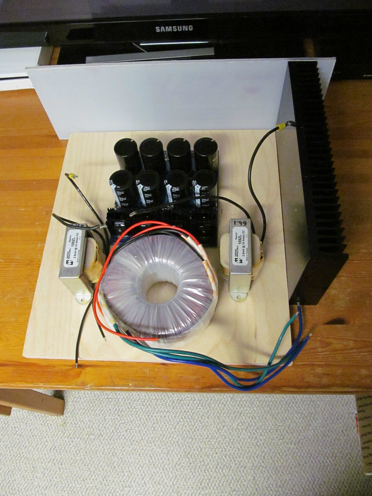

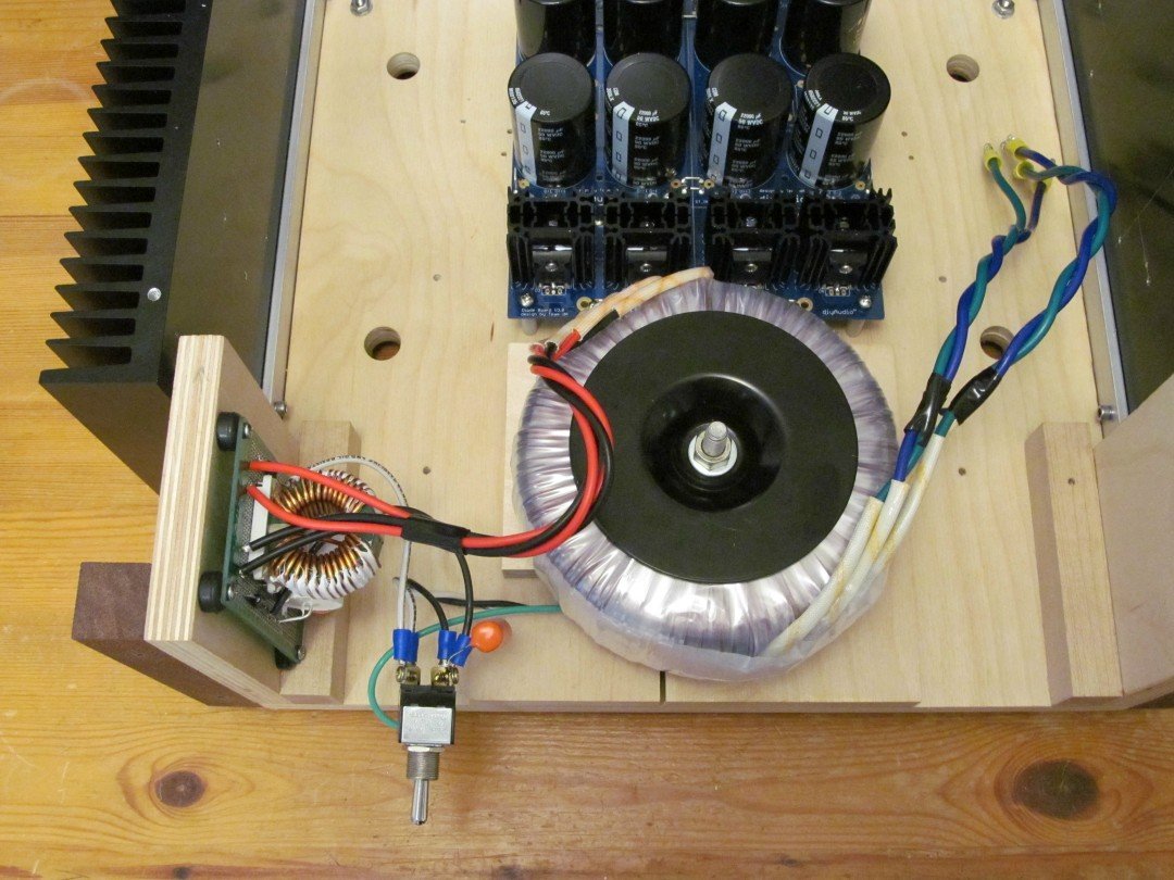

Andy , Thanks for your support . I was going to separate Hydro Earth and Analog Ground as shown in figure 5 in this article by Rod Elliot
https://sound-au.com/earthing.htm
Going to move the power switch to the front . As I was sternly told on this website , Both the hot and neutral should be switched .
To prevent arching of the switch contacts , connect a cap across the 2 hot terminals of the switch.
Please check this , but as I recall it must be an X rated cap , and I think the value is 0.01 uF ... again check this .
For an EMI filter , I highly recommend building a Fo Felix .
I'll be using a Bourns 8120-RC for the common mode choke .
However , the windings can move a bit so it may need potting .
https://www.mouser.ca/datasheet/2/54/8100_series-777217.pdf
The devices are IXYS IXFN180n10 switching MOSFET 's .
The back of these devices are floating .
As such , there is no issue with the L and R heat sinks being in electrical contact .

The transformer shown is a 300 VA made by AnTek with dual 18 Vac and 18 Vac secondaries .
However , if the bias set to 1.2 Amps - For both a L and R channel , 300 VA is right on the border of being too small .
I'm told its best to go with dual 300 VA transformers .

No worries - Rod Elliot's site is amazing, we're lucky to have that resource.
Re caps across mains SW's, I don't like them, they're always passing current to the tfmr. Though I build valve amps I use toroidal tfmr's, I prefer to use a thermistor from the IEC connector, to the mains fuse & then a delay start. That way you don't need mains SW spark suppressor caps/snubbers & everything in the PSU has an easier life.
Re dual power supply's, in my experience it's well worth doing. The stereo image is a lot better. I have a Stage Accompany SA900C power amp which has dual PSU's, it sounds brilliant even if it's a bit overkill @ 450w per channel. That said, you can't beat over engineered power supply's & amps with plenty of headroom, they seem to handle the transients, like a bass drum, low piano keys etc better.
Keep up the good work mate, Andy.
Andy , Thanks for the advise .
I have two Belles power amps one with a 1,000 VA transformer and the other with a 2,000 VA transformer .
Without a cap connected between the 2 hot connections of the power switch ,
you can see the spark when the amp is switched on .

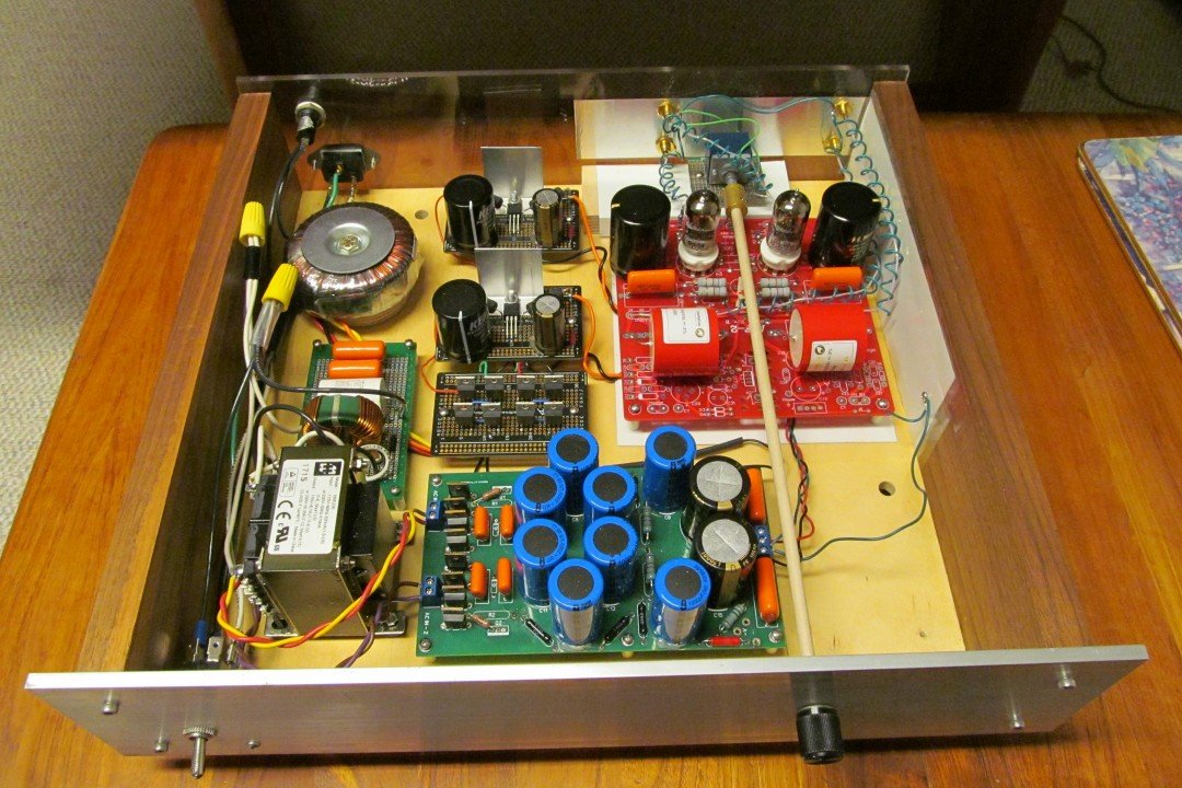

Here is the case I made for a line stage cathode follower tube preamp .
Its not the prettiest case in the world .
I used a piece of Baltic birch plywood for the base .
This allows what I call the " Audio Note " method - allowing boards to be changed around .
Used 4-40 x 1 " stainless steel machine screws which thread beautifully into the Baltic birch plywood .
The nylon spacers are mouser part no . Keystone 534-878
Also , note the hex cap screws , holding on the face plate , thread into a hardwood like walnut beautifully .
If ever cutting polycarbonate , please take note of the advise above .
I don't know the details of these accidents , but clearly the polycarbonate sprung back .

Apologies for the delay . Here is my second go at making a power amp case .
A few points of interest
So take what I've done and improve it .
- Note how the heat sinks are raised up about 10mm above the table , allowing ventilation underneath the heat sinks .
- There are 4 holes in the Baltic Birch Plywood , 15mm diameter , allowing ventilation inside the amp .
- Heat Sinks are at the back , allowing shorter lengths for the +Ve , - Ve , Amp Out and Speaker Gnd wiring
- Feet are from Home Depot
- the back plate is polycarbonate - spec's say it does not start to get soft until 115oC
- Note the RCA's allow removal from the back - so a complete amp and heat sink can be removed and tested , without unsoldering an RCA .
- Note the trick of taping a 8 - 32 machine screws into hardwood to hold on the face plate
- L and R side are insulated from each other
A few more comments
- Metal retailers will often sell aluminum that is scratched - so something to watch out for when buying the face plate
- The power switch I had has machine screws - It would have been easier if it had push on disconnects
- I'm concerned the Chokes will pick up EMI - so the diodes selected used have the backs floating
- The anode or cathode is not connected to the back , so the heat sinks don't end being noise transmitting antennas .
- Note the DIYAudio stores V3 power supply board require a specific pin out for the diodes
- Used a Bourns 8120 RC common mode choke for the Fo Felix EMI filter , but IMO this choke needs potting https://www.mouser.ca/datasheet/2/54/8100_series-777217.pdf
- There are epoxies made specifically for potting , but I used Lepage's PL ... not hot glue .
- Having reamer taper is really useful to have tight fitting hole diameters for the power switch and binding posts
