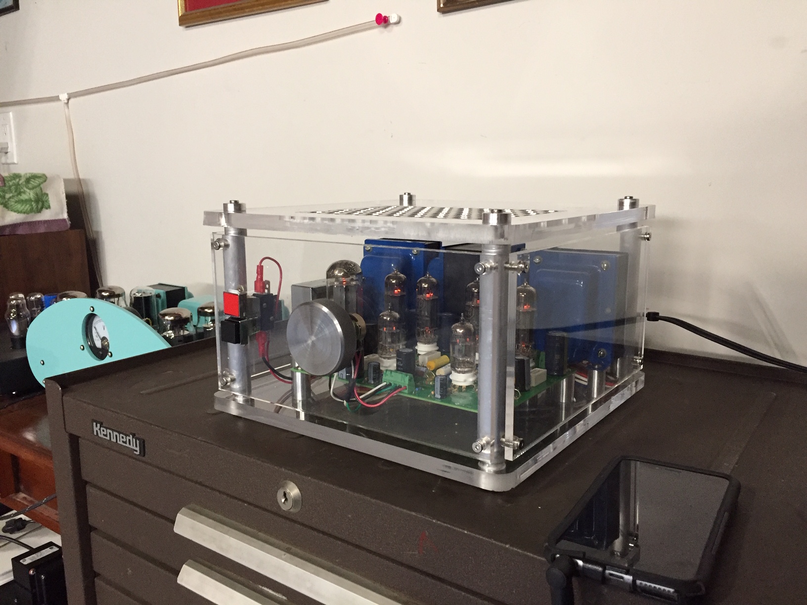

Here’s a pic of some transformer mounts for the F2J mono blocks I’ve been working on for some time.

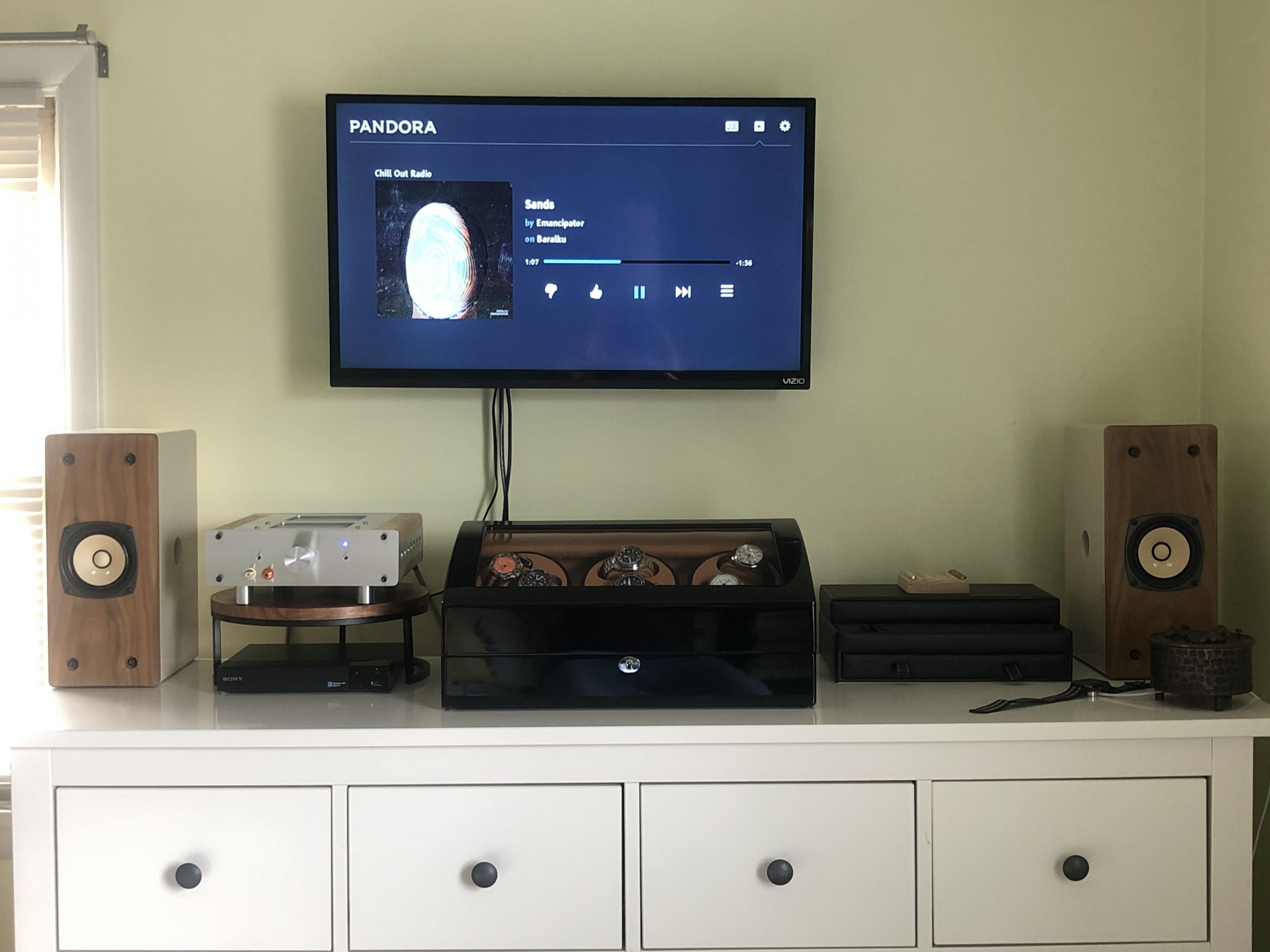

Also a pic in situ of that little chip amp I tore apart recently and turned into an integrated amp for a small bedroom system.
P.S. @jeff I wish those F3 boards you helped me out with would fit in the same mono block cases I had already started for the F2J. They are a little too long and require a different solution. I may just pull the heatsinks off the top of the cases with the amp boards and use the cases as separate power supplies when I get to the F3.

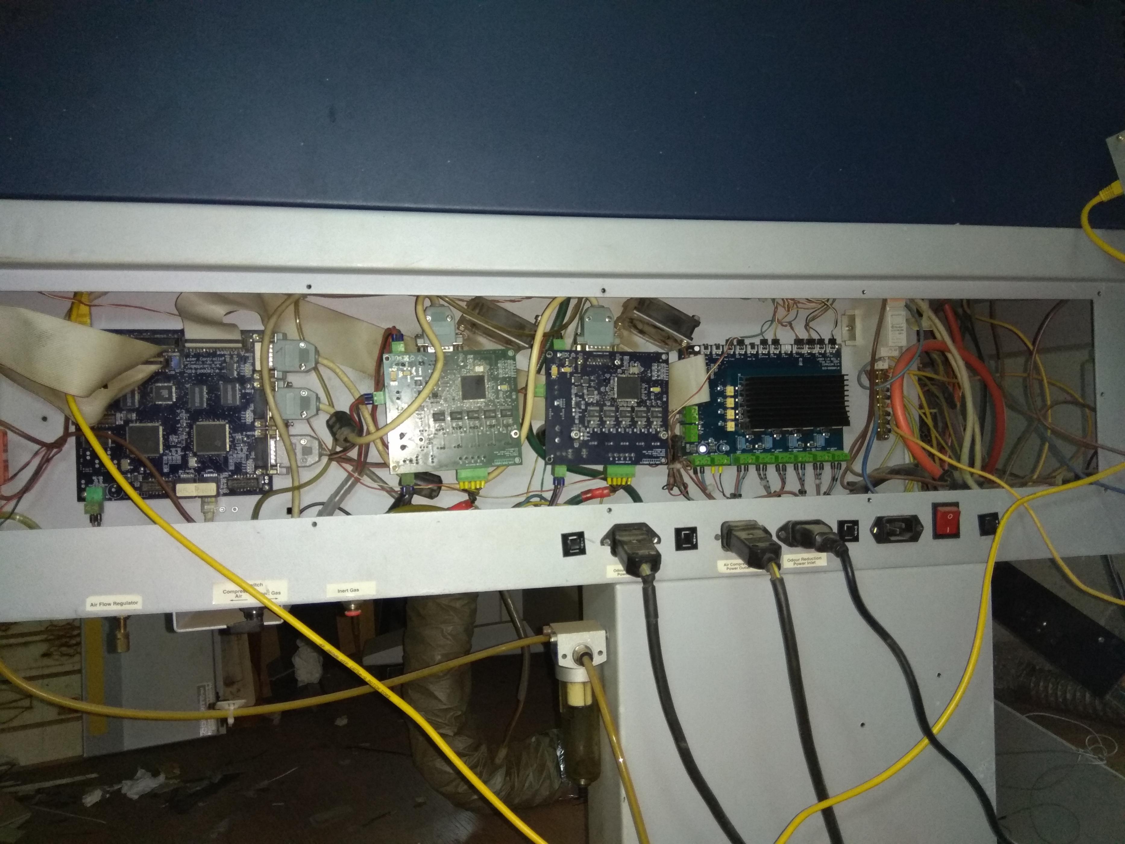

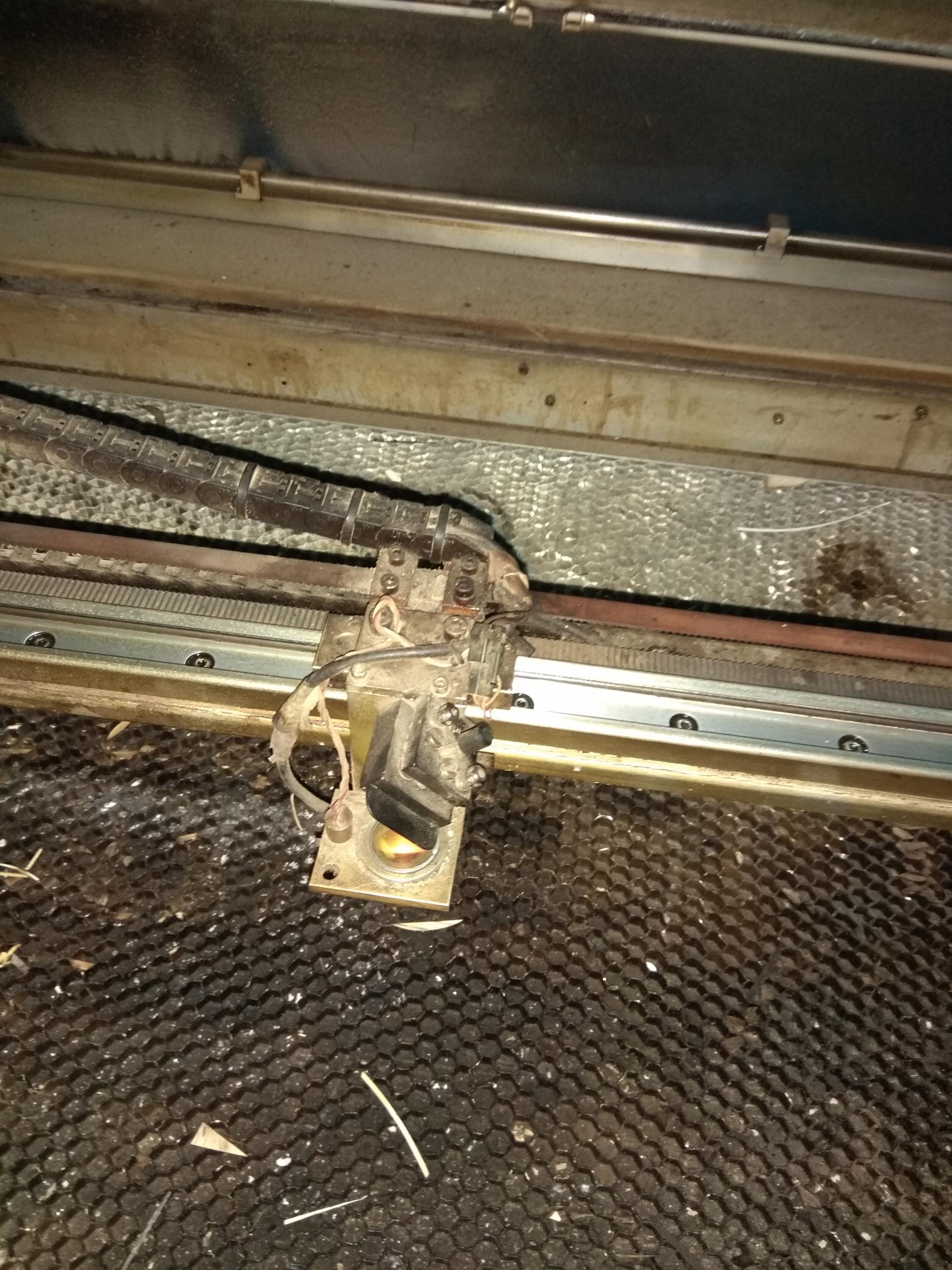

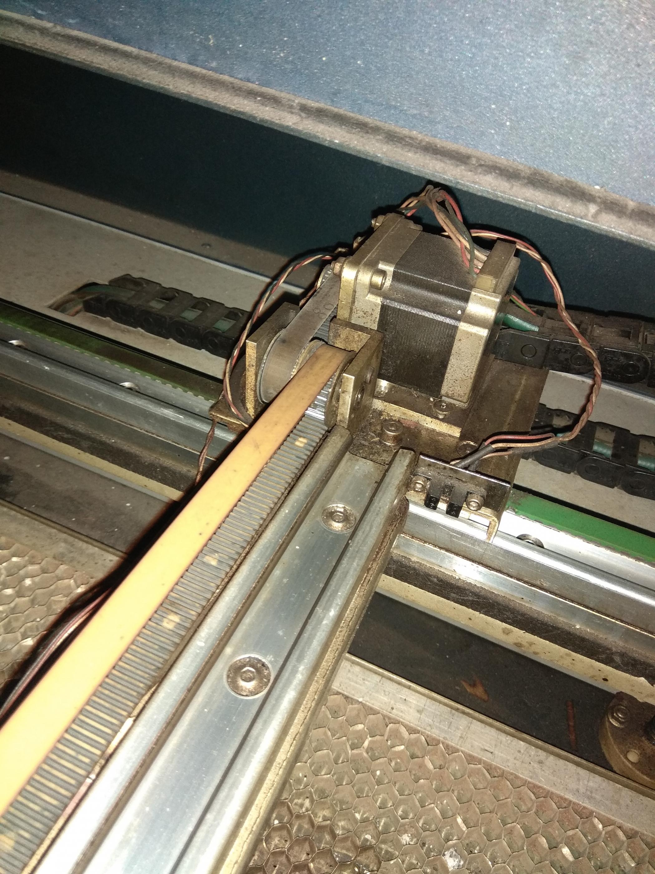

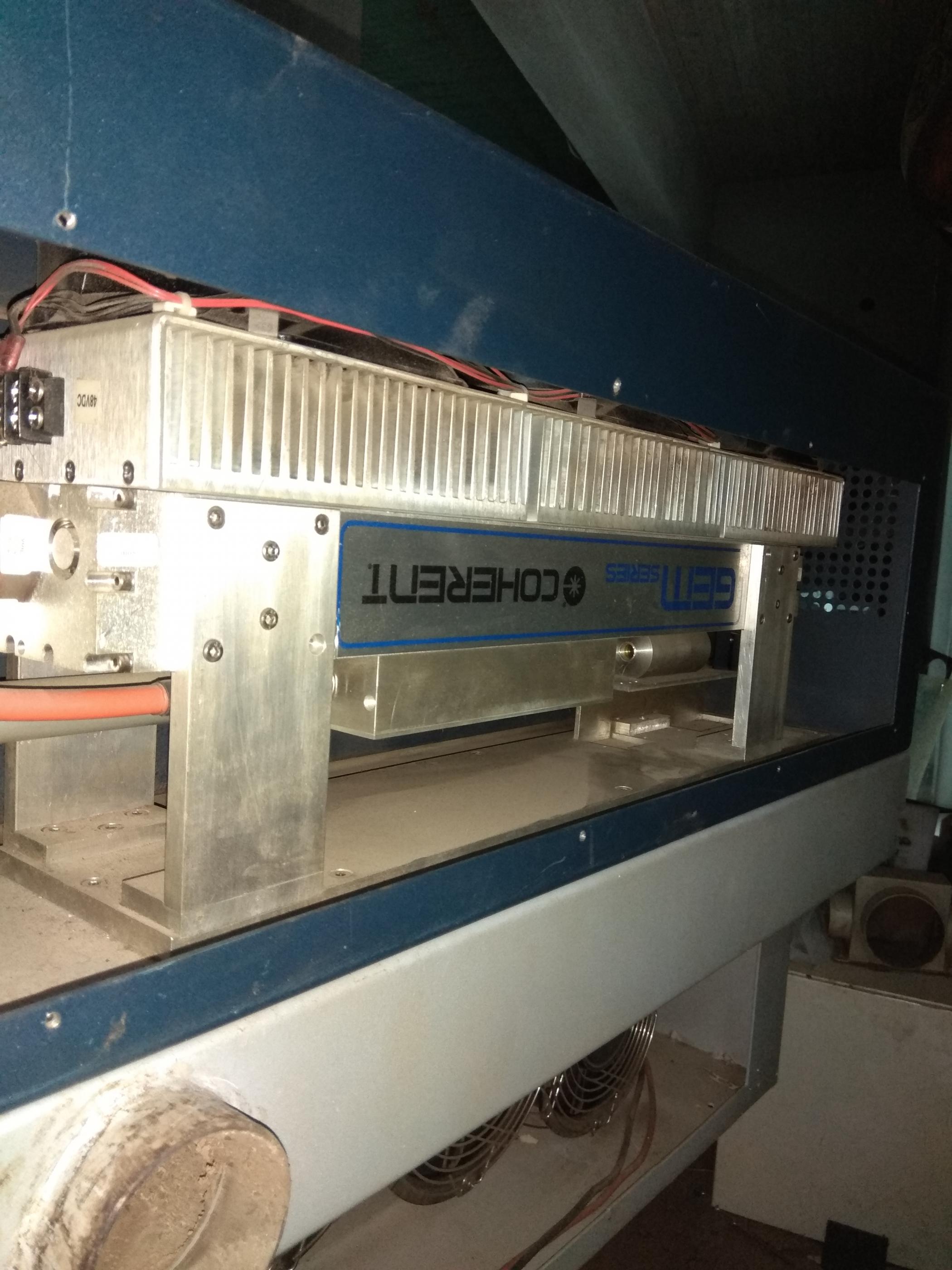

I have a friend you help me with this laser engraving machine.Unfortunately this time is fault and i would try to repair it.Hi Thimios,

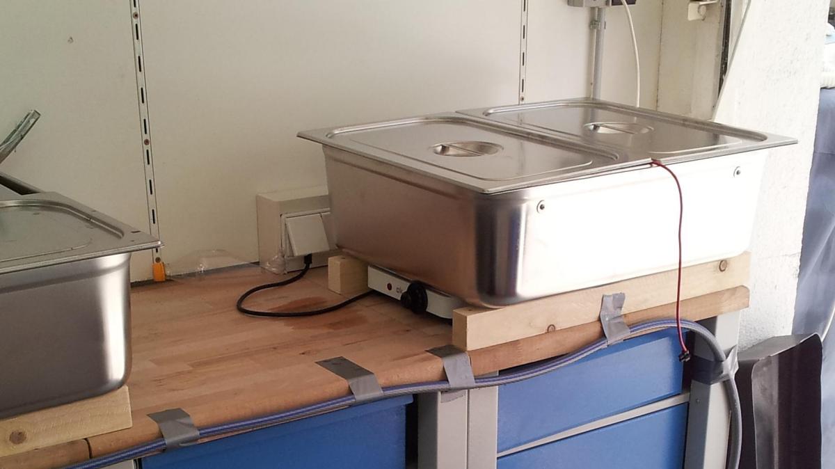

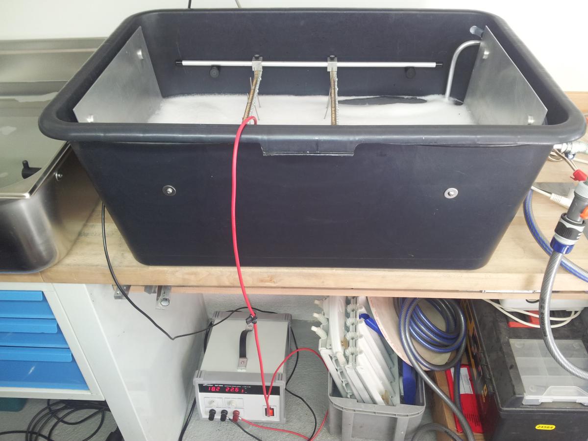

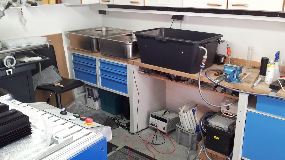

aluminium anodizing in my friends garage
In 2013 my friend and I have anodized parts for several bigger amplifier projects ourself
The pictures show the setup:
Have Fun, Toni
- acid bath for cleaning
- distilled water
- anodizing bath
- coloring bath
- sealing (in boiling destilled water)
Have Fun, Toni
If current is too high you will actually strip the anodization coating. 6 amps per square foot is the recommended current. Depending on the size of the tank and the acid mix this could require over 20VDC.

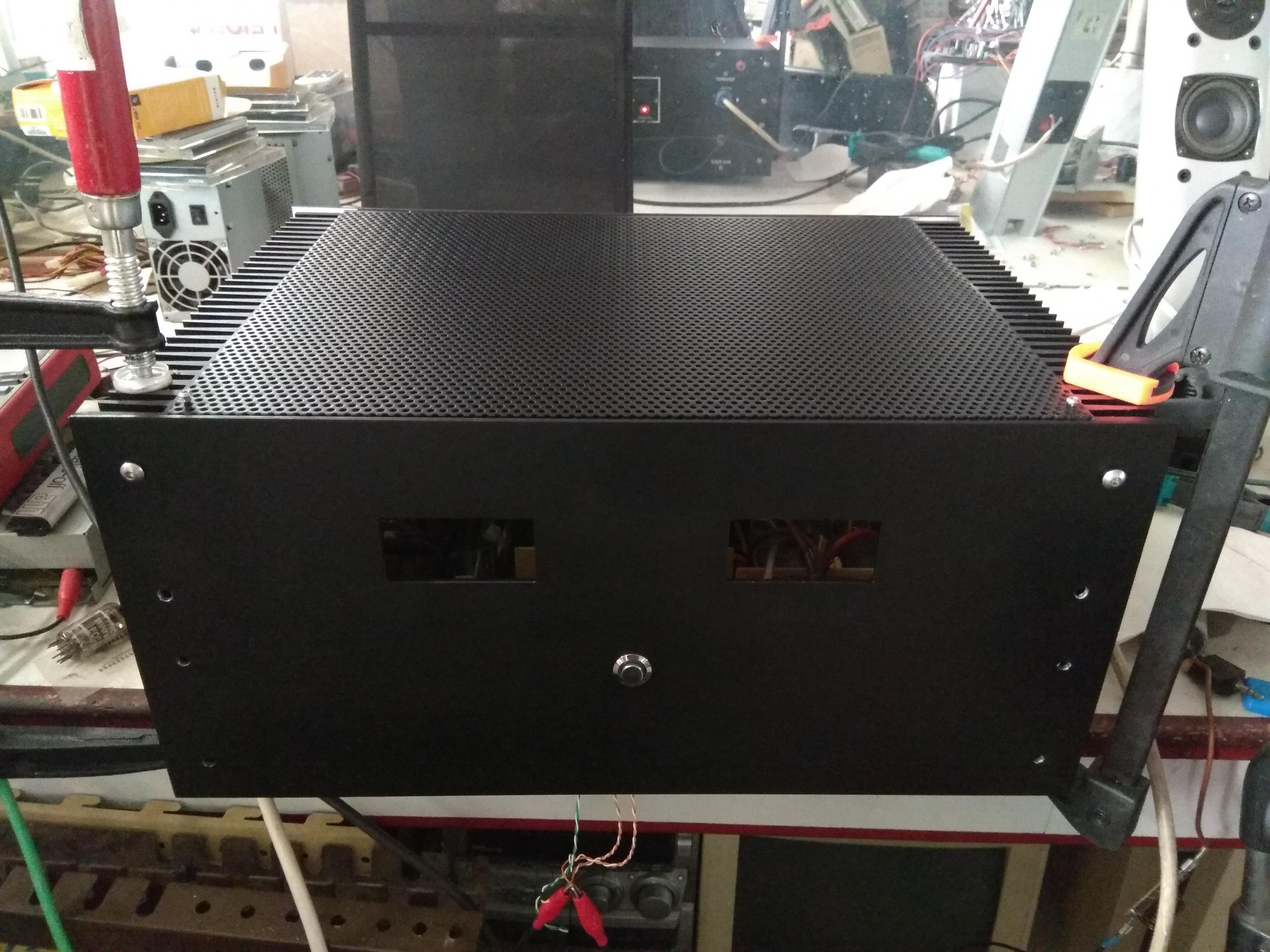

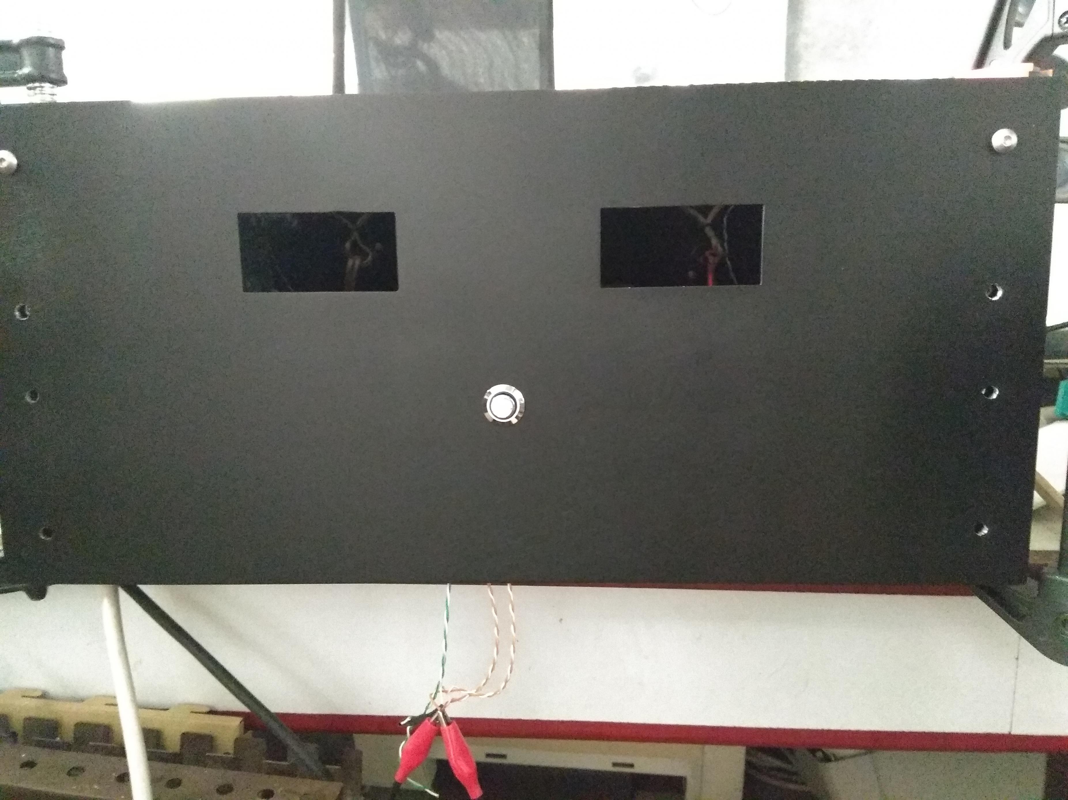

A first plan for my new enclosure.
All parts are from donation.
Thank you all!
Thank you all!
