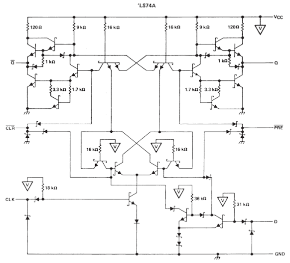

Something from the "What I found" section. This is 74LS74 flip flop internal schematic.

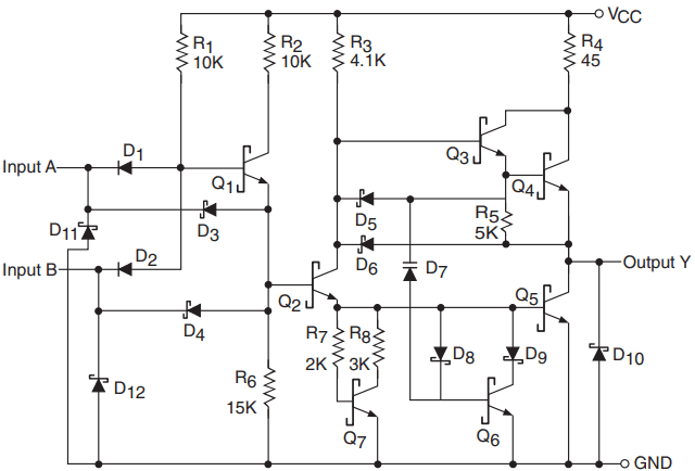

The 74F74 looks very similar. Here the internal circuit of a 74F00:
Main differences are slight changes to the output stage that speed up the output stage, resistor values in the rest of the circuit.
While not on the same level in terms of freedom of noise etc, as ECL, it's pretty decent.
We will see some current dependent on the actual clock that drives the clock input, around (~ 0.38mA @ 5V) internal and a similar current via the the input circuit.
Data related current changes should be minimal, it looks kinda like a see-saw due to the balanced circuit, the rest is all balanced.
The totem pole outputs in 74F circuits are especially concerned with avoiding shoot through current, so these should be pretty clean too.
Hence using 74F74 for reclocking, we should use the lowest reclocking frequency usable (same of course applies for anything except ECL), decouple the power supplies primarily for this frequency and harmonics.
The "flying attenuator & slew rate limiter" sit between the two outputs and are pretty high impedance, so they do not effect the current flows. If we place the attenuators directly at the IC, there is no extra capacitive load to drive, which thus doesn't causes charge/discharge current spikes in the supply/gnd lines.
E.g. if we allow 384kHz max Fs with 6.144 MHz BCK, using 12.288MHz for reclocking BCK, DL, DR is the lowest frequency possible.
Take account that data lines change on the rising BCK edge but is latched, bit by bit on the falling edge of BCK.
So with 22.../24... MHz MCK we divide by 2 and latch BCK and Data reclockers on opposite edges. We can likely divide reclocked BCK more to reclock LE and generate FDEM.

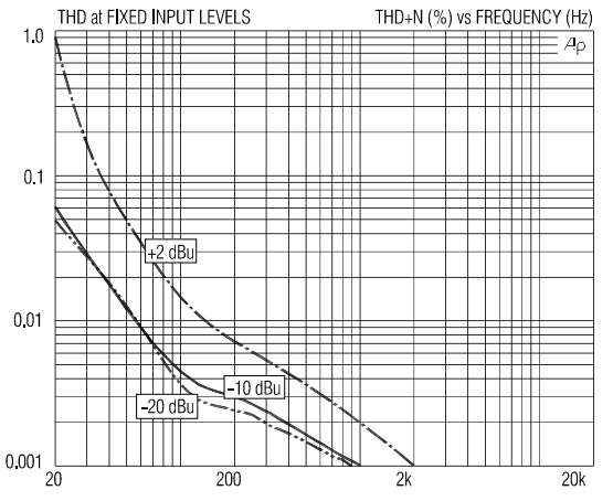

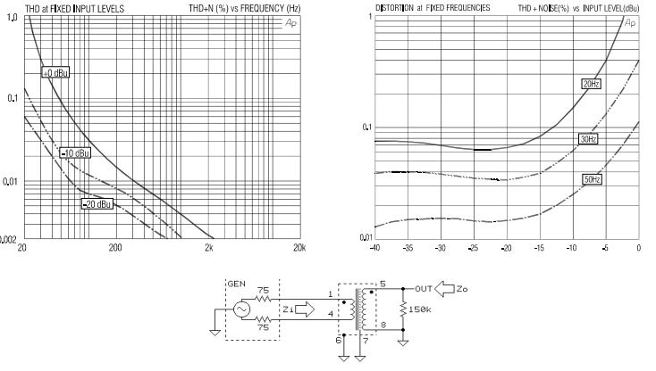

I measured very similar THD. It seems one either needs a big core with many turns or some other trick to achive low THD at the bottom frequency range. The best I could get is 1% at 40 Hz 0 dBu, 0.004% at 1 kHz (acceptable) 20-30-40 kHz is no problem.
It seems one either needs a big core with many turns ... to achive low THD at the bottom frequency range.
Correct.
or some other trick ... to achive low THD at the bottom frequency range.
Zero Field.
Not enough turns. Try 10X. And yes, that is extremely thin secondary wire, many turns and layers to get good results.

It is not about the area of core. You dont need the power... It is about permeability of core.I measured very similar THD. It seems one either needs a big core with many turns or some other trick to achive low THD at the bottom frequency range. The best I could get is 1% at 40 Hz 0 dBu, 0.004% at 1 kHz (acceptable) 20-30-40 kHz is no problem.
And the inductance of primary.
if it is core area increased, the lenght of the turn is also incresaed and Rcd of all turns will be significantly larger.
Simulate or calculate the needed value of primary inductance, with respect to input source impedance, but with minimum phase shift...
So the minimum phase shift is about +5 to +8 deg at 20Hz. That will end up with lower -3db point most probably lower than 10Hz...
And increased primary inductance.

The problem is to keep both B field and Rdc very low. This is why we need a bigger core with more turns and thick wire.
I think the requirements are different than for a moving coil transformer, where there are lower currents and lower voltages. MC transformers can be small.
Post DAC stages should approximate cumulative THD+N around 0.0003% at 0dBF ~110dB across the audio pass-band to guarantee 16 bit res.
It is VERY difficult/elaborative/expensive to achieve this with transformers at lower band of spectrum.
Ofcourse one has the choice of neglecting this . . . . Many designs do.☹
Yes, but you need still need to handle the flux.
"Magnetic flux is inversely proportional to frequency, meaning that as frequency increases, magnetic flux decrease"
Low distortion at low frequencies = (relatively) large core
And flux, which doubles with halving frequency.
You see that here, above where hysteresis/barkhausen screws up the relationship, a near straight line of HD increasing with lowering frequency because flux in the core increases. Once you get to high enough levels the relation between increase in level (flux) and HD for a fixed frequency is also pretty linear.
Of course. You have a choice between more turns on the same core (less flux) and a larger core with the same turns (less flux) to lower LF distortion. Again, to the best of my knowledge this is independent from the specific core alloy/material is used. How far we deviate from this ideal at low and high levels does depend on the core material.
Audio transformers are a great illustration of TANSTAAFL.
