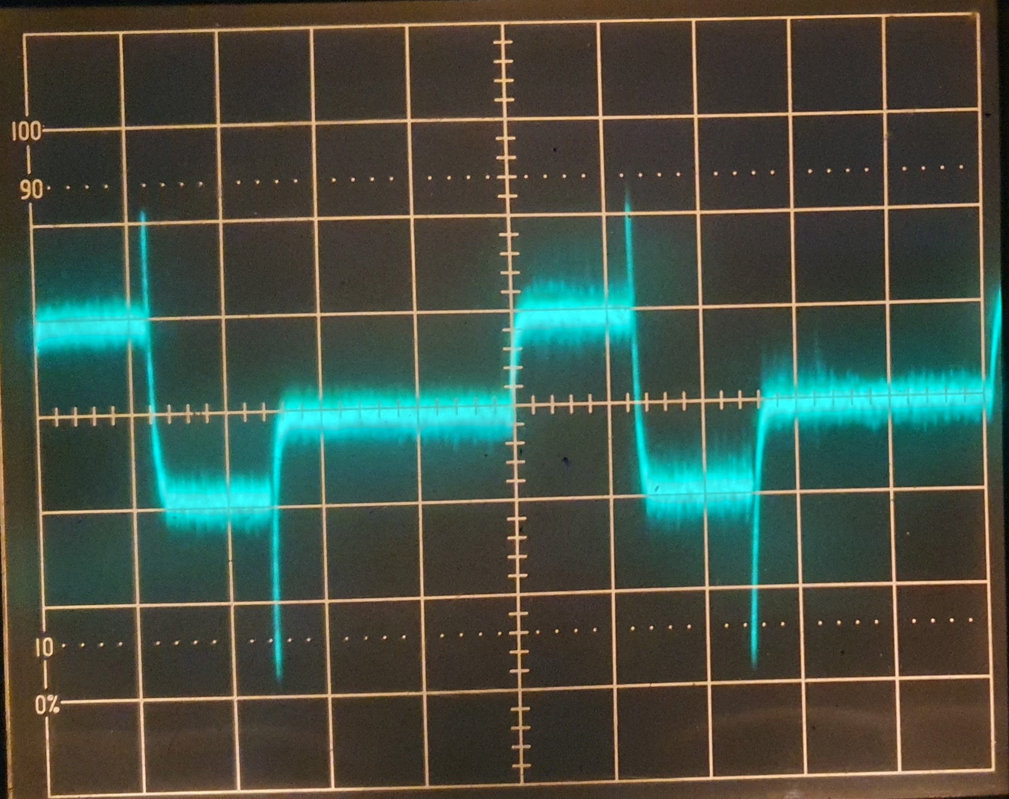

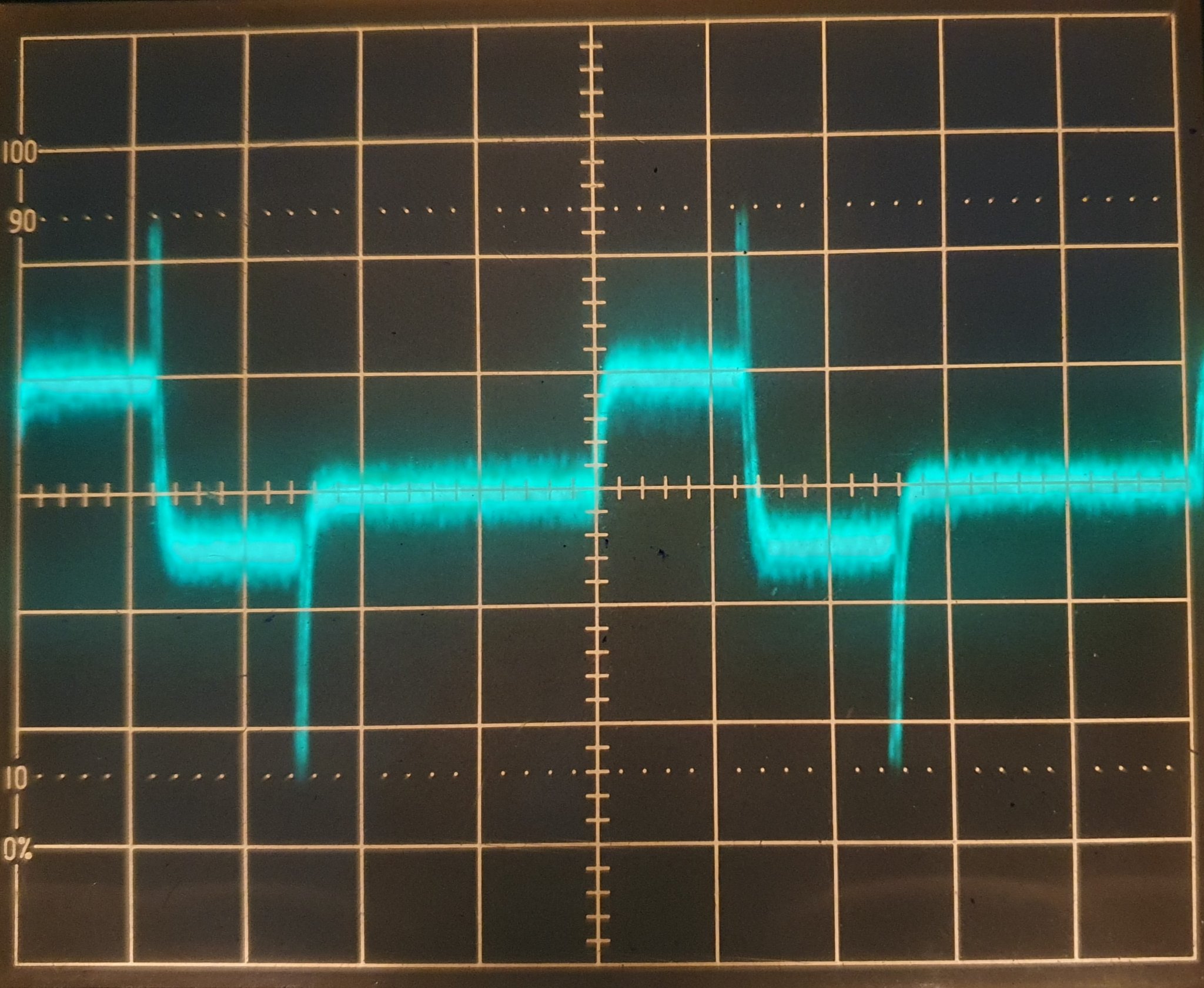

Excellent. I'd be curious to see the FFT, but don't go out of your way,
Thor
There is not much to see on the FFT. The 3rd HD increased a bit. However (or rather because of) the bit step accuracy is worse at 768 kHz DEM frequency, compared to 384 kHz. And THD is a little bit better at 384 kHz, compared to 192 kHz.

What conclusion do you draw from this?
I can see what your alluding to but I dont think I can come to a conclusion based off someone else's experience without knowing what they concluded. I'd be interested in hearing from @koldby and what he ended up concluding from his experience from trying Ecdesigns signed magnitude approach.
Nope, I don't think so, because the Glitch for sign magnitude designs is generated by different mechanisms.
Thor
That may explain the results koldby was getting. So in trying to solve one issue, another has been created.

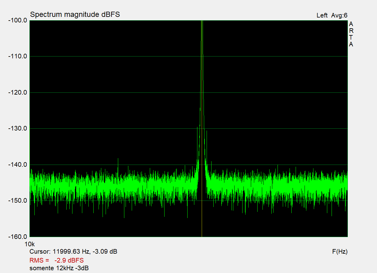

Now, for some "fun" 😉 / measurements, about my not ultimate TDA DAC (yet...)
The one from photos a lot of posts ago. Using yet the async DEM clock (no time yet to make the MCLK divider):
The J-Test generated by ARTA. For this case, I have 3 limitations:
1 - I cannot use the same PC as a generator and measuring device, due to ground loops. I not wanted to use coupling trafo this time. So, I generated the test in a notebook, and a PC having a Xonar audio board reads the result. SO the wave are not in sync;
2 - The notebook generating signal not have ASIO drivers, so maybe the WDM audio driver PERHAPS pollute the signal a little;
3 - the end limit is the Xonar ADC jitter.
Anyway:
Here a J-Test from the TDA1541 out, pusing the tube output stage:
And here is only the 12kHz signal:
Not too shabby for a collection of parts lying in drawers... 😀
Reactions: Brijac
