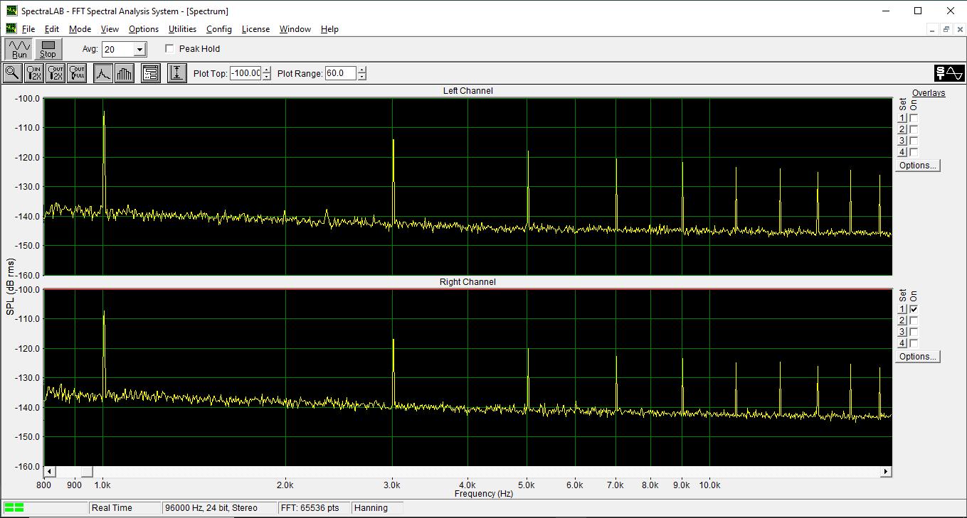

The Nakamichi patented glitch balance was tested with a 1 LSB step 1 kHz square signal. Ideally, the square signal has only odd harmonics. The even harmonics, 2 kHz, 4 kHz, etc. was cancelled by applying 40 ... 60 mV DC bias on the + input of the I/V opamp. Unfortunately the L and R channel needs different voltage: L = 54.1 mV, R = 38.2 mV on my specimen. (If a 10R resistor is inserted between AOL/AOR and the - input of the opamp, the idle -2 mA elevates this voltage by another 20 mV).
This looks excellent! This is no dither? Just direct +/-1LSB (so the raw performance baseline of 16 Bit?).
H3 at appx. -10dB from +/-1LSB is great. Just Curious what both channels look like with 46mV on both channels.
The addition of 10R with 10nA to ground before the resistor, any changes to wideband noisefloor with -60dBFS?
Thor
This is 0/1 LSB square wave, not sine, 24x 0's, 24x 1's with 48 kHz BCK. I think 1 LSB is -96 dBFS.
The addition of 10R with 10nF to ground before the resistor, any changes to wideband noisefloor with -60dBFS?
I could not detect any increase of noise floor, but my sound card is not very good, either.
Reactions: diyiggy

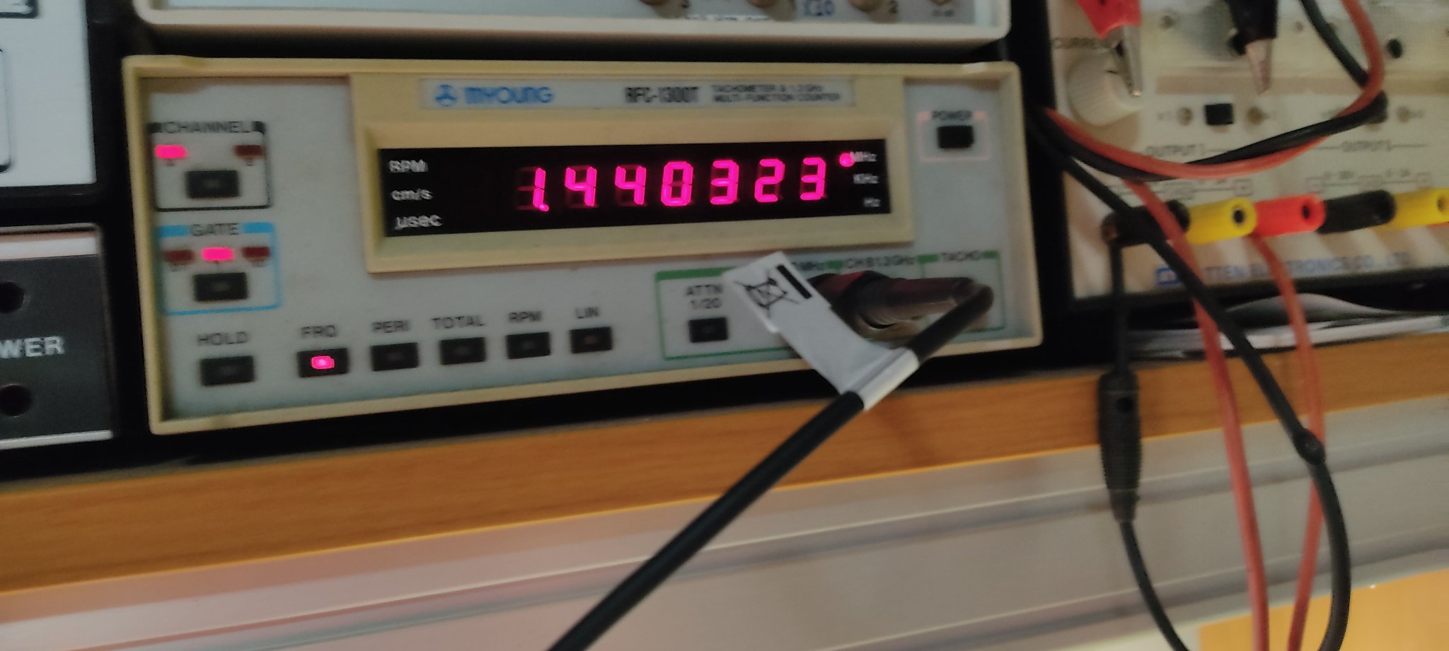

Hi! I would like to obtain the best DEM clock for my TDA1541 DAC in SIM mode get from CPLD by Miro code.
Strangely i have measured 1,536Mhz bck on pin 2.
Please can you show me how i can do to get best resultate?
Antonio
Divide MCK to get 352.8/384kHz
Like most of the IIS 2 SIM converters this uses "stopped clock" which is a poor idea originating in a datasheet for a part completely unrelated to the TDA1541.
You cannot use this "stopped clock" to divide it down to create the DEM clock.
And using a frequency counter will give wrong results. The actual clock frequency is the same as the IIS BCK on the input if the IIS 2 SIM converter, but for part of the time the clock is not active.
Additionally, BCK changes with sample rate, something @lcsaszar has shown to be a poor idea.
So we need to use MCK, which is stable but synchronous with the rest.
Commonly MCK is 256 x FS for older systems (11.289/12.288MHz), USB interfaces like Amanero or SPDIF receivers like AK4118 usually 512 X FS (22.579/24.536MHz) and 16X capable USB devices use 1024 x FS (45/49MHz).
If we use 512FS we need to divide MCK by a factor 64 to hey 352.8/384kHz.
The 74HC4040 seems hard to get, so using 74HC161 will only divide by 16. We need to add a second 74HC161 or some other divider to get enough division.
The 74HC161 struggles to reliably get fast enough for ~ 25MHz, so either use 74LVC161/74LCX161 or use a fast flip flop as pre-divider.
As the 74HC161 is easily set for different division ratio's it would seem that adding a 74F74 or similar can divide the MCK down to something that the 74HC161 can handle as clock and select the correct ratio for the actual MCK (/128 -> 1024X MCK; /64 -> 512X MCK; /32 -> 256X MCK; /16 -> 128X MCK) and use the second half of the 74F74 or similar fast flip-flop as re-clocker from MCK for the final DEM Clock.
