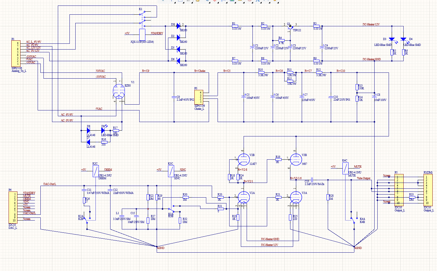

The ANALOG Stage:
Straightforward 6072A with a "ring of two" CCS anode load using a N-Channel FET (IRF710 or something like that).
Thor
There are no exotic parts, very simple and straight-forward design, with attention paid where it matters most.
I really don't see how or what can be further improved on the design.
I am not sure if it will fully resolve 16 bits, but that's not the objective of the thread here.

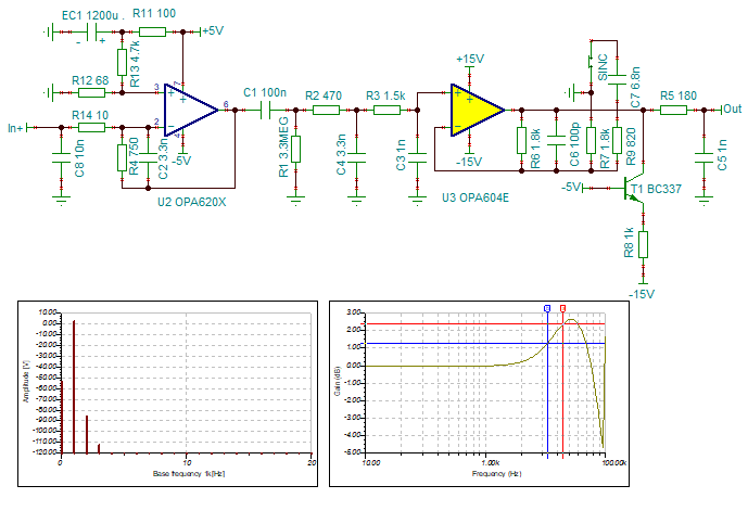

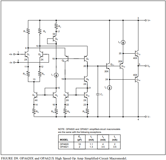

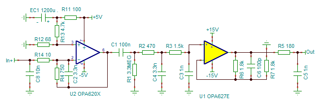

For the I/U conversion WITH SAA7220 I would suggest something like this:

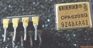

The OPA620SG is just a cool looking, hot running antique Video Op-Amp in folded cascode with a flat 60dB open loop gain to past 100kHz. Chinese vendors have a lot of equipment pulls that look genuine, Power supplies are +/-5V max (so this is NOT a "universal replacement") and one Op-Amp draws 21mA. The actual circuit is very simple (see below).
Any sufficiently low noise and fast Op-Amp can be used. If you want to use a current feedback type, sure, but make sure to keep them stable. FET OPA's should be ok, but here is one place where bipolars do well.
How low noise? The 750R I/U conversion resistor contributes ~ 3.5nV|/Hz so super low noise OPA are
C2/C8 set the noise gain to ~ 4 so many a decompensated Op-Amp's can be used. C8 is actually under the TDA1541, for simplicity to AGND.
The Op-Amp uses the TDA1541 +/-5V as supplies, so the signal current circularises to +5V, removing signal-dependent current modulation on =5V. The limited supply voltage means we limit the signal at the I/U conversion stage output to 1V RMS and there will be a ~1.5V DC offset.
A simple CR highpass and second order CRCR Bessel lowpass remove the DC and implement with the feedback capacitor of the I/U conversion the 40kHz 3rd order Bessel lowpass required for SAA7220B.
A Fet input Op-Amp buffers the purely passive Filter and adds 6dB gain. A SINC EQ for non-oversampling can be placed here.
For subjective sound quality reasons, if available, I would use OPA(2)604 with Class A bias (OPA2604 makes this nearly mandatory - look up the patent describing the output stage US5019789A), this will still keep distortion low.
All OPA2604/604 on e-bay & ali are fakes AFAICT BTW.
OPA1642/1652/1656 can all be used. Pick your favourite.
Thor

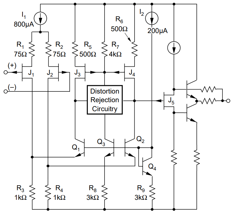

Here a simplified schematic of the OPA(2)604 Circuit. Note all J-Fet's are P-Channel while all bipolars are NPN, likely do the limitations of the higher than average voltage process.
While the output stage is quite clever and all that, giving it a pulldown current of (say) 10mA will help. A single NPN transistor and a Resistor will do a perfectly good job with base to -5V emitter via 1k to -15V and collector to OPA(2)604 output.
This of course also works for other OPA's. For arguments sake, we could use a use a NE5534 with an external J-Fet input (using JFE2140) and this pulldown CCS as output amplifier. It would likely sound pretty good.

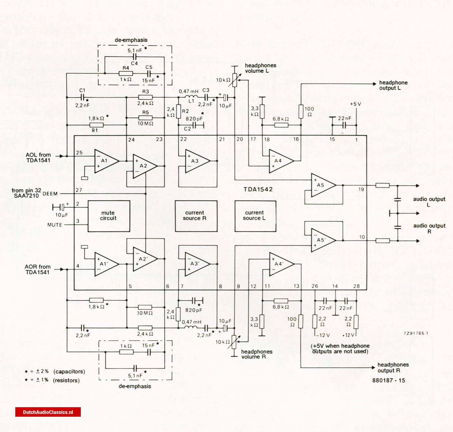

The SAA7220B has a little build in attenuation and HF boost, to compensate for a 3rd order, 40kHz Bessel characteristic analogue lowpass, such as implemented in the analogue companion IC for TDA1541, the near mythical TDA1542.

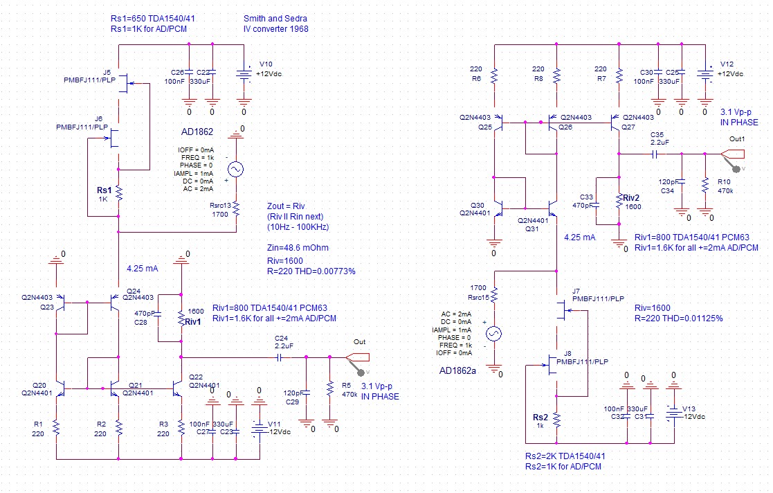

More discrete IV convertors.
I came across Smiyj and Sedra invention printed in 1967 of IV converter circuit. Just after Wilson Current mirror circuit.
This IV is SIMPLE, has low number of elements, available, ca n be replaced without much harm of Q. Very good FFT, very good THD.
AND
Voltage are IN phase at the output - almost all other discrete IVs has opposite phase on the output. With these values it is about 3.1 Vp-p output whic is more than enough even without premaplifier...
Low Zin of 46mOhms cca. Zout depends on Riv value and Rtermination value, but generaly it cam be low.
Two SE circuits are in the CSH PNP and NPN based.
Also these 2 circuits can be "merged" to classic PP complementary circuit.
These values are for 2 mAp-p and without Current at the Iout dac pin. So it for the PCM56, AD1865, AD1862, and so. For PCM63 just half the value of Riv and double the value of C parallel to Riv.
For TDA1540 and TDA1541A, increase/decrease I with Rs resistors as noted in the SCHs
Cheers
