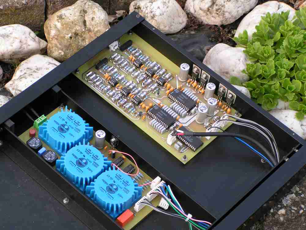

My understanding is if you have L- and L+ from different dacs output will be out of balance somewhat unless you have perfectly match dacs. Another approache, that is allready cover in this forum, is spliting I2S signal in to left and right feeding two TDA1541A. That way you'll have L- and L+ output signal (or R- and R+) from the same dac, and the signal is perfectly in balance (hopefully). Current offset could be eliminated by offset nulling circuit, like 2m current source in front of I/V converters. For I2S spliting circuit see link.
http://www.diyaudio.com/forums/attachment.php?s=&postid=647561&stamp=1116801939
Twin DAC photo
Thank you for the replies,
I added a photo of the twin DAC, it is in use for over 3 years now, there are definitly no problems with DC component. I will post some more photo's and diagrams as soon as possible (I have to convert the diagrams first). The question about the differential mode: In differential mode the worst DC component I had was about 10mV. How is it done? First you have to INVERT the SERIAL data of the SECOND dac with an inverter (SN74HCT04 or so), clock and wordselect are the same. Then put an I/V converter on every DAC output (4X). Now the L- goes to the - input of the differential amplifier (classic set-up around a single OP-AMP). So +900mV with a digitally inverted sample. The L+ goes to the + input of the differential amplifier So 900mV with a normal sample. Out comes: +900mV (-) +900mV=0V DC. The Inverted sample is inverted again ( - input diff amp) and becomes positive, then it is added to the normal sample, so you get twice the amplitude. Do the same for the right channel. So inverting the SERIAL DATA on the second DAC makes this possible. The schematic diagram I will post later will explain this more clearly.
Re: photo twin-DAC
Hi.
It looks VERY neat !
Andy

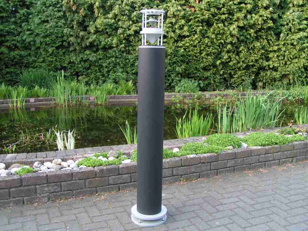

photo Sonic Resonator
Here is a photo of the sonic resonator, a 360 degree radiator with real-time correction system for sub-bass, bass and mid. This system needs no damping materials. Mid-high and High are placed in an open resonance chamber with conical deflectors and polarizer discs for incredible realistic sound, it actually reconstructs the acoustics of the place the recording was made, with pinpoint accuracy. Chesky audio recordings sound magnificent on these sonic resonators. The photo shows an early prototype of about 4 years ago. Components are handcrafted form MDF and sprayed with metallic paint. The new version has solid aluminum and plastic parts and is sonically optimized to the max. It has a highly optimized passive filter using some very exotic parts like NON-inductive stranded copper wire resistors (took a long time and many listening sessions to fine-tune). You cannot believe how much effect a simple component as a resistor, capacitor or coil can have on sound reproduction. As I already said, hearing is believing. The most common reaction I get from High-End enthousiasts is: this sound cannot possibly come from those speakers....but then, it does. Second is, where is the subwoofer? ,those speakers cannot produce that bass or can they... sure they can.

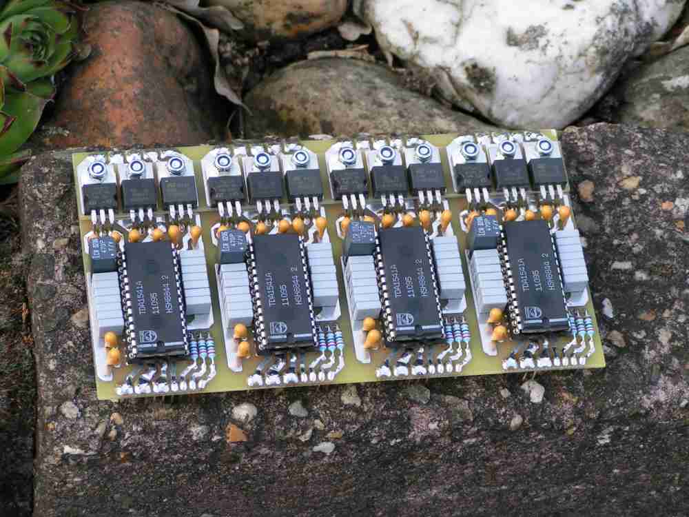

Photo Quad DAC module
NOS DAC's have one little problem: ultrasonic interference. The mirrored frequency spectrum above the sample frequency causes interferences and a drop in the high frequency audio range among other things. But still they sound so nice. First I designed the twin DAC wit an 8th order active filter, this was a real big improvement, but... that filter kept bugging me. Imagine how a NOS-DAC would sound without this interference, after many sleepless nights (I never rest before a problem is solved) I solved it in an elegant way. Here is a photograph of the Quad DAC module, part of the new NON oversampling DAC with Direct Interpolation (other circuit boards are being designed). The prototype is already operational (spaghetti breadboard setupjavascript:smilie('😀')). This NON oversampling DAC has 176.4 KHz virtual sample rate. Virtual? yes, because all DAC chip's still run on 44.1 KHz, but the output signal sports a 176.4 KHz sample rate. The resolution (without any filtering) is boosted to 18 bits. The output voltage is qadrupled. There are no phase shifts since there is no filter, it is true phase linear. Pulse responce is what you expect from a NON-oversampling DAC. Needless to say that dynamics are impressive using 4 DAC's. But how is this possible? by using Direct Interpolation. It uses timing tricks and analog wizzardyjavascript:smilie('😉'). I added a 2nd order bessel filter to avoid possible problems, but on my set it works perfectly without any form of filtering. This DAC sounds so clear without the ultrasonic interference and the absence of a brickwall filter, it makes the TDA1541A really shine as it has never done before. Is this DAC very complicated?, well actually NO. For each problem there is a complicated and a simple straigt forward approach. This is the simple straight forward one. I can post a picture of the breadboard prototype, but be warned, it is not a pretty sightjavascript:smilie('🙂').
Re: Photo Quad DAC module
Please post a photo and schematic.
Andy
-ecdesigns- said:............ Here is a photograph of the Quad DAC module, part of the new NON oversampling DAC with Direct Interpolation (other circuit boards are being designed).
......... I can post a picture of the breadboard prototype, but be warned, it is not a pretty sight .
Andy
Direct Interpolation- it's very interesting. Could you give us more details or post schematic? Is virtual multiplying Fs caused only by doubling TDA1541 and differential mode?

Re: photo twin-DAC
Is that wonderful white connector at the end of the coax handling the 75ohm spdif?
-ecdesigns- said:Photo was still too large, I rescaled it again

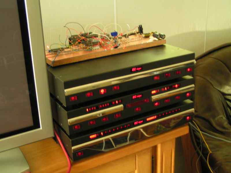

Hi Andy,
Here is a photo of the new Quad DAC on the breadboard, below it is the High-End set I designed. On top is the input switchbox, in the centre is the 6 channel control amp, at the bottom is the fully symetrical rock-solid MOSFET cascode amplifier. I tried to post the schematics, but the file is to big, if I scale it down it's unreadable. I could email it and attach the original file (about 1,5Mb).
Hi Andy,
Hi, Uchi Deshi
Thank you for your reply
Direct interpolation uses at least 2 DAC's, this creates 88.2KHz virtual sample rate and doubles the resolution. The Quad Direct Interpolation DAC creates 176.4 KHz virtual sample rate and results in 18 bit resolution. And yes sure you can use more DAC's in parallel, 8 DAC's will create 352KHz virtual sample rate and so on. How does it work? It involves slight timeshifting (delay) of both Data and Wordselect and connecting 2 pair of DAC outputs in parallel, then these two are fed into a differential amplifier after I/V conversion. So this system only needs 4 I/V converters. The easiest way of visualizing this system is comparing a 1 cylinder engine with say a 4 cylinder engine. The 4 cylinder engine runs much smoother and achieves much higher revs than a 1 cylinder engine would. Now the DAC's are the pistons, the crankshaft is the output stage and the ignition is the timeshifting. So all 4 DAC's receive their DATA in sequence (not simultaneously). So they output their sample on slightly different moments in time (one clockpuls after wordselect changes) and thereby creating addittional interpolated steps i.e. increasing the resolution. So basically it's a quite simple technique. Since an added sample always stays in the timeframe (64 clockpulses) of the original (large) sample, there is no phase shift. Schematic diagrams will follow.

Hi analog sa,
The white connector you referred to is actually the analog output. I use a custom made fully differential SPDIF interface like in professional sound studio equipment. So no 75 OHm coax cable, certainly no TOSlink, actually I am using standard SVHS cable for this purpose. So I have a normal and an inverted SPDIF signal to cancel out interference that causes jitter. Obviously I had to modify my CD player (added schmitt trigger differential stage) so it would output this clean jitter-free differential signal to start with. Why a schmitt trigger? to get very short rise times as long risetimes can cause jitter. And jou must make sure the CS8412 get's a stable low jitter signal, otherwise its PLL keeps fluctuating and makes matters worse. So if you want to get rid of jitter, tackle the problem by the source and go differentialjavascript:smilie('😉').

Linear interpolation
Hi rfbrw,
Thanks for your reply,
You are right, the prototype uses a form of linear interpolation, but without the traditional form of digital filtering, no decimating, no brickwall filtering, and no phase shifts. So I called it Direct interpolation as interpolation takes place instantly without computations. The beauty of it is that you have a filterless NON oversampling DAC outputting 88.2KHz, 176.4KHz or even more. A pure clean signal. Please read my other posts were I explained the system.
Hi rfbrw,
It's not linear interpolation, more like nearest neighbor. You still have a stair step pattern. Interpolation means that a newly created sample is some combination of the surrounding samples. This method should be called "Direct Repetition".
