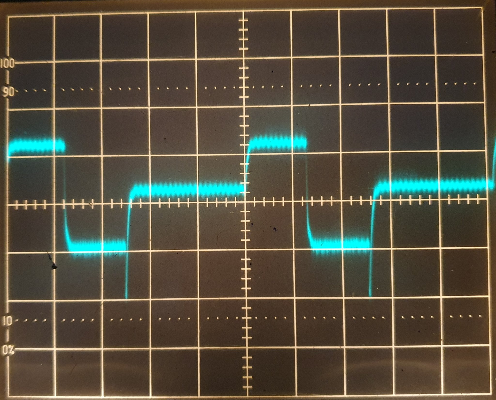

Fig. 9 shows a photograph of the most difficult bit transition (from 0111.1 to 1000.0) where the largest glitch occurs. The output current of the converter is directly fed into the 50 ohm 1-GHz CRT input. Total glitch charge is within 0.4 picoCoulombs. The contribution of the glitch current to the output current of the D/A converter is 0.25 I(LSB)
384 kHz DEM clock divided from BCK by ÷4 works fine. For me this is the optimaly synchronous DEM clock frequency. 768 kHz increased the low level distortion, it is unusable.... do you want me measure the THD with a synchronous DEM clock >200 kHz? If not free running, the THD won't increase, and we could use smaller filter capacitors (or better filtering with the standard 100nF), is that the idea? I can try 352.8 kHz, one divide-by-2 flip-flop less.

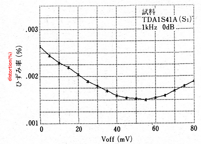

And based on the results in the other thread, add a DC offset of ~ +45mV on the outputs and a 3.3...10nF Capacitor (IMHO to DGND - [dirty ground] not ADNG) for essentially free reduction of signal and/or sample rate correlated noise.

768 kHz DEM clock worked also, and there was no difference in THD compared to 384 kHz. However, the -60 dB distortion increased from ~0.25% to 1% or more.
Most tests I have seen are done at full scale, that is not very revealing. I prefer testing at low level (must be dithered sine) FFT spectrum, and with 100x amplified +/- 1 LSB step signal visualized on the oscilloscope. This way we can magnify the low level behavior.
Yes the above resulted in best performance in my setup.

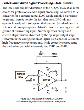

From the data sheet: "The OPA627 is unity-gain stable. The OPA637 is stable in gains ≥ 5"
What gain can we calculate with in an inverting I/V converter application? Sorry for my ignorance.
Excellent. I'd be curious to see the FFT, but don't go out of your way,
Thor
Stability is determined by noise gain.
The output impedance of the TDA1541 I estimate as 160pF//some MOhm.
So closed loop gain with 1.5k//2.2nF will be a very large negative gain.
Without the 10nF Capacitor from output to ground, OPA637 is not stable. The 10nF capacitor with a 2.2nF feedback capacitor sets noise gain to ~ 5.5 so it will be stable. This is originally shown here, though the stability issue is not mentioned, it applies:
In this case noise gain is actually very high at almost 30dB, but the turnover frequency is very high at 636kHz.
Anyway, if you have a compensation capacitor at the NE5534, with 10nF at the TDA1541, you can remove this.

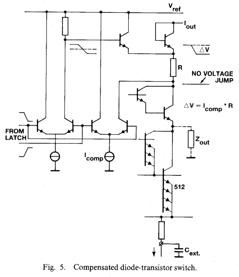

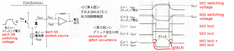

I found on the computer some deglitch circuit from Nakamichi 1989.
It seems that concerns TDA1541A DAC in description.
TDA1541 doesn't need a deglitcher.

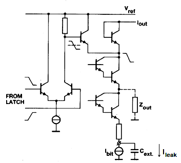

The "glitch" addressed in the patent is a consequence of the bit-switches that have a small amount of charge injection.
It's shown here. The MSB's using these "uncompensated" switches cause these "glitches".
Here a "compensated" switch as used on the LSB's:
The idea is to cancel this using an additional externally generated "counter glitch".
As this "glitch" is an extremely narrow needle pulse I'm dubious on the practical success

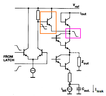

Just to be clear what happens there.
The Bit Switches work by turning on/off one transistor (outlined in Orange):
Vref must be more positive than AGND.
Iout is stated to be +/-25mV of AGND (in practice more is possible).
The node outlined in purple is where the switch forks.
Below that switch are two sets of cascodes, the DEM Filter and the DEM current SINK (not source).
Ibit sinks whatever is the bit current.
When the switch transistor is on, the current into the sink flows from +5V via Vref (internal rail) into the current sink and then into the -15V Rail.
The purple node is biased at a Voltage that reliably turns off the diode connected Transistor connected to Iout off. Iout is close to zero (a few nanoAmpere). This voltage must be slightly more positive than the voltage at which the transistor would conduct.
Now we turn off the Transistor to turn on the bit current. This is illustrated in the diagram, incidentally.
Stored charges in the transistor are rapidly drained by the driver circuit, the Base and thus the Emitter (which follows) drop in voltage until the current in the circuit no longer flows in the transistor and now flows from Iout through the diode connected transistor and into the node outined in purple.
In order to turn on this transistor, the voltage on on it's emitter must drop a little, this is actually not the real problem. It is at the leading edge of current step up. All that happens is that the edge is slowed and the DAC settles a little slower:

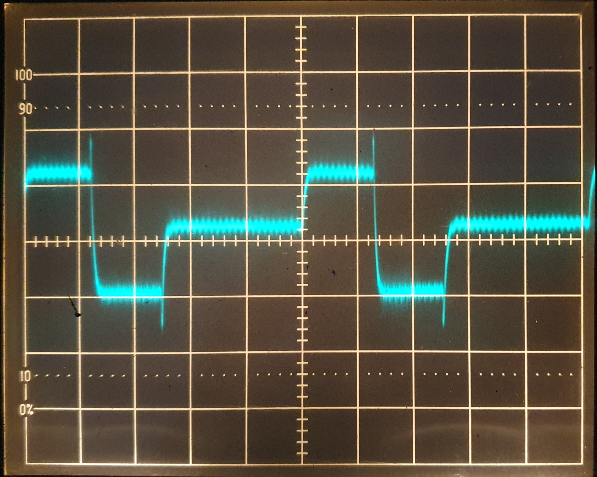

This Photo is from @lcsaszar's post in the other thread - remember this is after the inverting I/U conversion, so a negative current step (turn on a bit current) will show as positive and a positive step (turn off a bit current) as negative, a positive glitch will actually show up negative, we see here a +/-1LSB Step, around digital zero I presume.
Now we see a narrow Dirac or Needle Pulse when we turn off the MSB and return to digital silence. The pulse is appx. 2 LSB tall but of extremely short duration.
It happens when the Diode switch turns off. The step function at the emitter of the diode connected transistor is conducted to the output, while the capacitance in the transistor discharges. Then everything is "Off".
DC offset can shift around the "null" point of the glitch by applying a DC offset of +45...55mV to the TDA1541 Output. Here again a 'scope shot from @lcsaszar:
What we have done here is to raise the Iout node by 45mV and now we get positive and negative going spikes that are the opposite of the direction of the switching. Here is how Nakamichi (where this originates) explains it:
Without the DC offset to compensate the glitches, the glitches create even and odd order harmonics, compensating them removes the even order components but not odd order. Still, it seems a simple and worthwhile measure.
The rather complex added pulse DA Nakamichi proposes to create a "counter glitch" is questionable IMNSHO. Given the pulse is rather narrow, in the region of a 48kHz FS IIS BCK pulse width (~ 160nS) simple RC filtering should do.
I would propose something like this (I found some Gold plated lid ceramic case OPA620SG [does SG stand for Solid Gold?] and decided I like them) as I/U conversion and analogue stage:
The 10R/10n combo keeps the AC component at the TDA1541 to less than +/-25mV PP with 48mV DC offset and forms a 1.6MHz lowpass.
So the now symmetrical 1/2 LSB pulses equal to around a cycle of 3Mhz are attenuated, well, around 8dB or 2.5 times passively before reaching I/U conversion. That should clean up everything significantly.
Even an NE5534 should improve considerably. If using NE5534 or LT1028/1115 of course +/-15V can be used. I'd be curious if @lcsaszar wants to give this a try on his test board.
The rest is a simple I/U circuit with unequal -2.6V/+7.8V (equivalent to +/-5.2V) supplies. That makes sure all inputs remain within their common mode range and allows ~ 0....6V PP output swing, while not exceeding the +/-6V PSU limit of the OPA620SG. The OPA620SG Rails decouple to +5V DAC, so the analogue current returns to the DAC rail.
The output stage is running in SE Class A and the output always remains at a positive voltage never crossing "zero" (mA). The OPA620SG is a chunky Op-Amp, meant to drive 2V RMS into 50Ohm at 10MHz or so, so there is also a lot of quiescent current in the output stage anyway.
The RLC filter and DC Blocker Cap (Nichicon Muse Bipolar) give a build out element, 2nd order lowpass and DC removal. If not using an Op-Amp that cruises driving ~ 300 Ohm loads, better scale the Filter to something like 10mH/1nF/47uF/2.4k.

In my view, the solution is the DC Offset to make the glitch symmetrical and lowpass filtering to reduce the amplitude to the point where it disappears.
