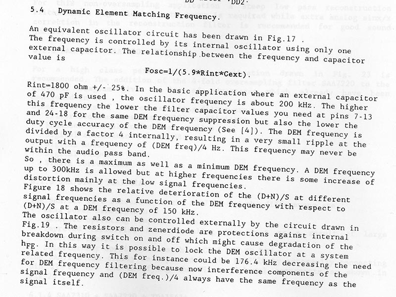

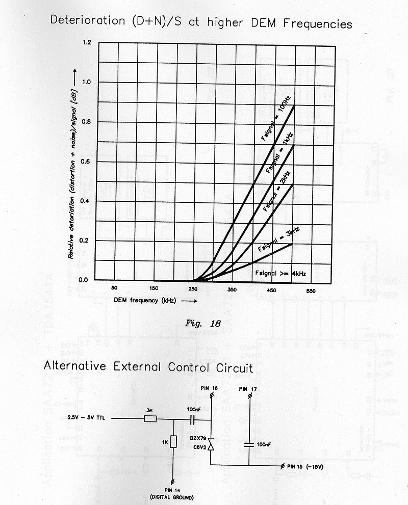

@thorsten: What is the source of this picture?More on the various switching noise path's in the TDA1541 . . . .
. . . . .Thor
That's in the Philips paper that shows details of the DEEM Circuit, including HD vs frequency et al., IIRC.@thorsten: What is the source of this picture?
I did have a xerox of the whole thing way back.
This is what is floating around on the net.
Note that the HD vs frequency comes from the free running oscillator, not synchronous. The free running oscillator is quite jittery with poor longer term stability, which may be the root cause.
If @lcsaszar is bored, he could try this on his test board. The lower the signal frequency the more DEM clock cycles have time to drift, jump into phaselock and out...
Thor

Anyway, I believe there are not many options for the ideal DEM clock in a NOS setup. According to Philips the clock frequency should be >=4x sample frequency, but it should be below about 200 kHz. And it should have 50% duty cycle, jitter-free, etc. The best option is, in my opinion, a divided BCK. I use the circuit described here and it works perfectly for me.
Or do you want me measure the THD with a synchronous DEM clock >200 kHz? If not free running, the THD won't increase, and we could use smaller filter capacitors (or better filtering with the standard 100nF), is that the idea? I can try 352.8 kHz, one divide-by-2 flip-flop less.

Or do you want me measure the THD with a synchronous DEM clock >200 kHz? If not free running, the THD won't increase.
I am hoping THD doesn't increase, you already tested?
Otherwise (say) 0dBFS @ 31/125/500/2000Hz with 176.4/352.8/705.6kHz DEM clock would probably interesting.
Yup. See if you can get 16X too.
Thor
