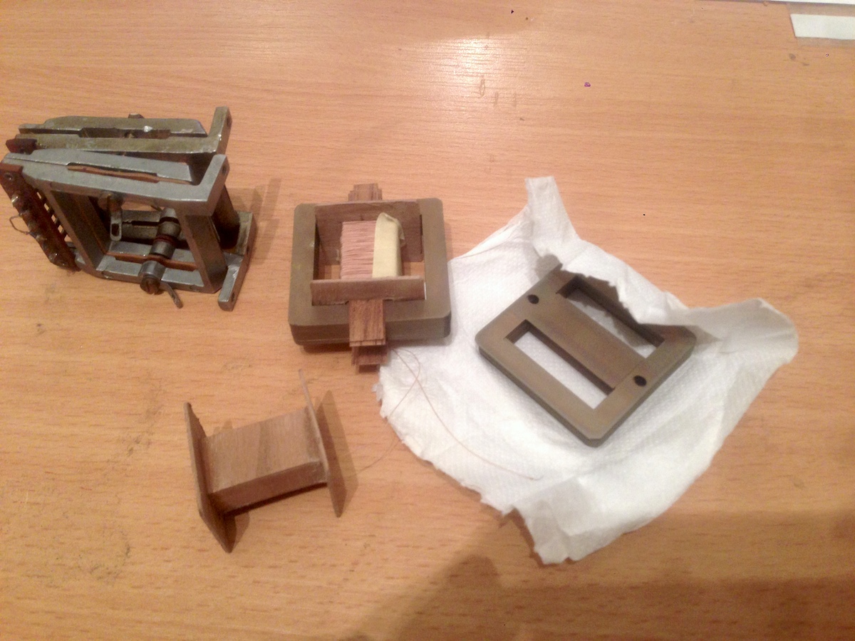

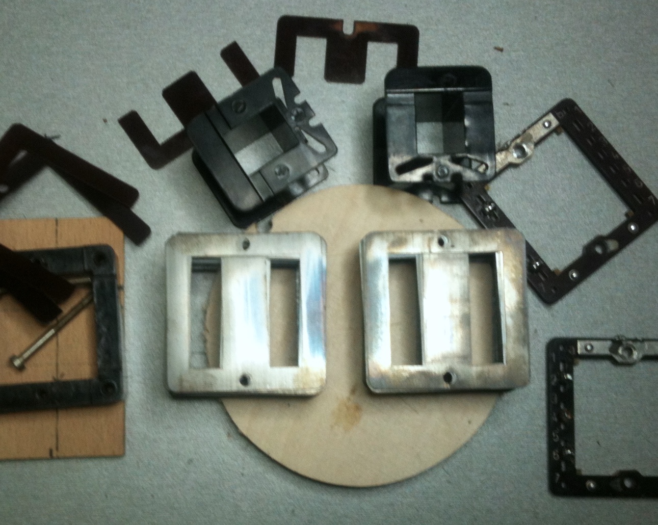

Anybody has any idea what lamination material is this? Dimensions: M42, thickness: 0.1 mm, gap width: 0.2 mm. I am building a pair of 1:16 transformer from it. I will publish the measurements if ready.
It is VAC nickel laminations "Mumetall-A" type. Don't know the type, You can determine by measuring inductance with 2-3 different turn values.
The gap is fixed, so the gap int opposite direction will be somewhat of 1/3 (from my measurements and calc) if You are using it withhout any DC magnetization...
I have almost probaly the same laminatons. That is what I am talking about...
If You have the wire for HF one with silk jacket and multiplied enamelled wires inside - good for windings
If You pulled them out from some wquipment, maybe it was the chance that the cores are magnetized with DC from fault equipment. Stack and combine them 1 from each other core into 2 cores for the start.

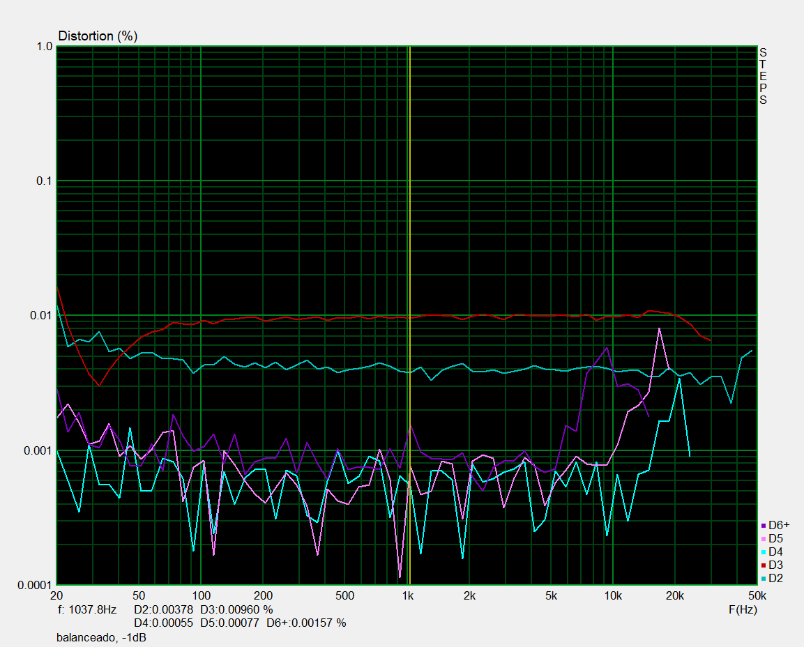

Harmonic distortion vs frequency (PWM9, loud mode, -1dB signal): (-1dB of digital signal generation feed🙂
Balanced. My test gig is unbalanced, so I summed the output from this DAC using a nanocrystalline trafo. Notice the constant HD vs frequency. Rsource = ~800R+10µF (the 2 output R in series, plus 2x 20µF caps in series). Rload: some shielded wire // 50k.
High order HD raising at near 20kHz is from my gig ADC. Some across the band are from the DAC being measured. This DAC have ~0.015% of THD at 0dB.
Most of this distortion are coming from the DAC. The core ar not adding almost nothing to low frequencies here, and some reaction with coupling cap, rotating the 3H, is seen here.
Is not too shabby, although the analog signal here is less than 300mV RMS. Reducing the Rsource we can safely arrives at some required level of HD at 20Hz with more amplitude. ( I deduce).
Have a lot of potential. So, I think that the proof #1 is there.
Interesting. But a DAC with ~ -80dB H3 can hide a multitude of sins...

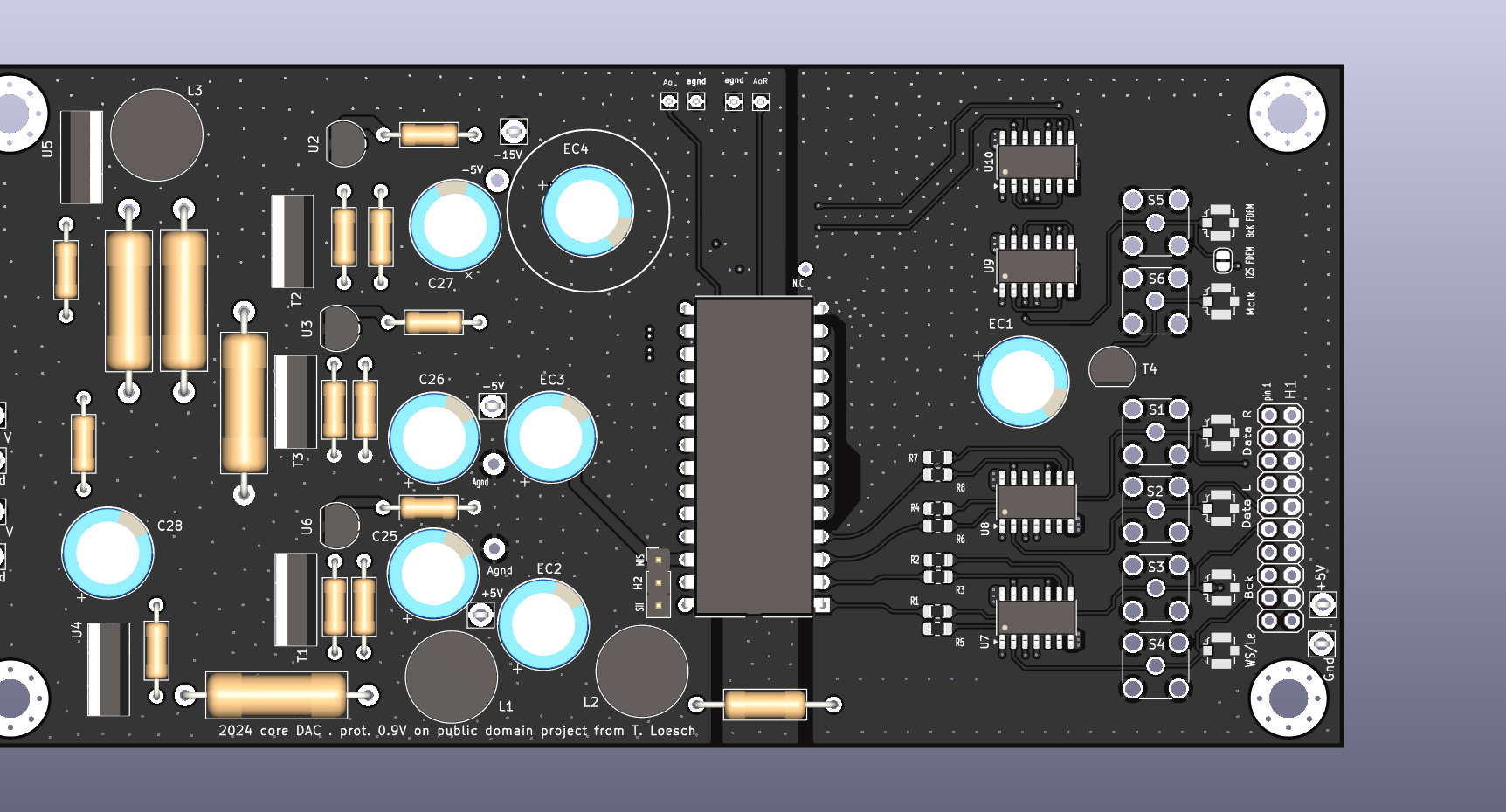

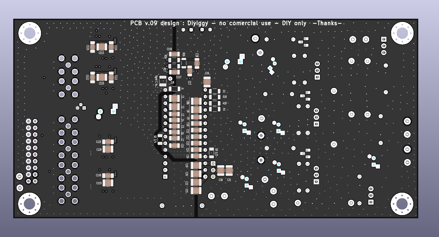

I putted the 4 layers core pcb proto in production yesterday. It will be tested first and if measuring good, it will permitt also to make some tests as theories and measurements poped up a lot since 30 pages.
It shoud take one month between now and the populated and tested boards according the time free for the testers to check it, experiments their ideas (different decoupling, etc). It is a proto for experiments : he has an header (JLSOUNDS lab for sim mode) and SMA/UF-L inputs for testing all sort of digital front ends. With and w/o active clock DEM synchro. Versatile board w/o trade offs for signal routing.
It is SE though not balanced 15cmx7cm. so balancing at the output of the I/V stage migth be the best option if noone has planned to make a balanced one.

Nice job @diyiggy
Can we see what you've done with layer 2 and 3?
