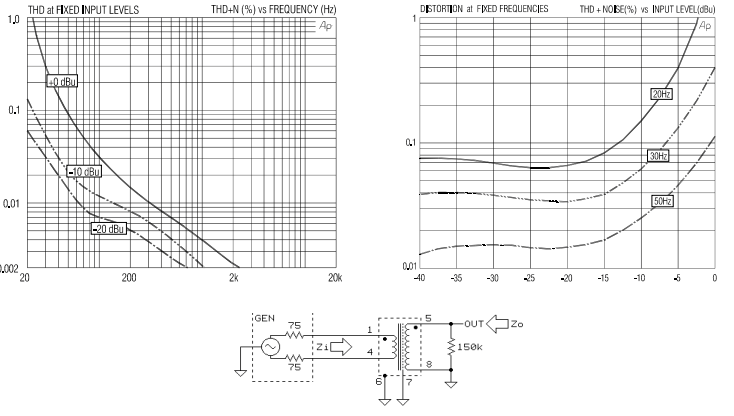

Saturation flux not so much, but permeability is very important for low level audio signals, along with core loss / eddy current.Saturation Flux / Relative Permeability is not a metric that is relevant in low signal level audio applications.
Modern......I use VAC Vitroperm 500F (nanocrystalline) toroidal cores since 1999; until then I used VAC permalloy EK cores 80%/0.1mm but when these became really expensive and VAC nanocrystalline toroidals entered the market I tried these, and finding out that these were at least on par (measurements; sonics) I went along with these toroidals and never looked back. Last year I bought 100 pieces for my inductive volume controls for 5 euro/piece. Pricewise try permalloy nowadays.....If you want Amorphous or Nanocrystaline Core transformers because it's modern and sexy sexy and super expensive, get them, clearly audio performance is not at issue.
As I apply these cores for MC SUT's as well, I will see if I can do HD measurements but based on the properties it will not be worse than for permalloy.If there is actual measured HD performance for a 1:10 Transformer at (say) 20Hz/30/50/100Hz and 1kHz with primary levels from -50 to 0dBu I will be happy to look at the results and if warranted change my view.

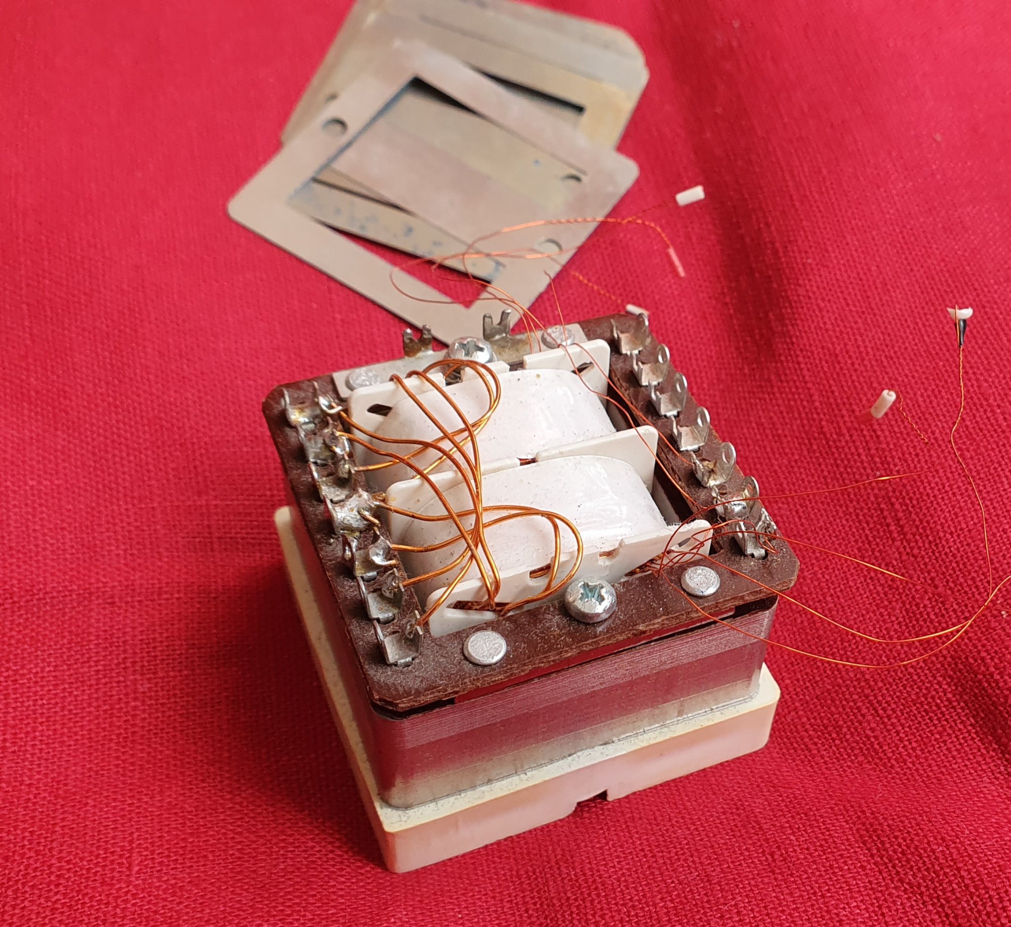

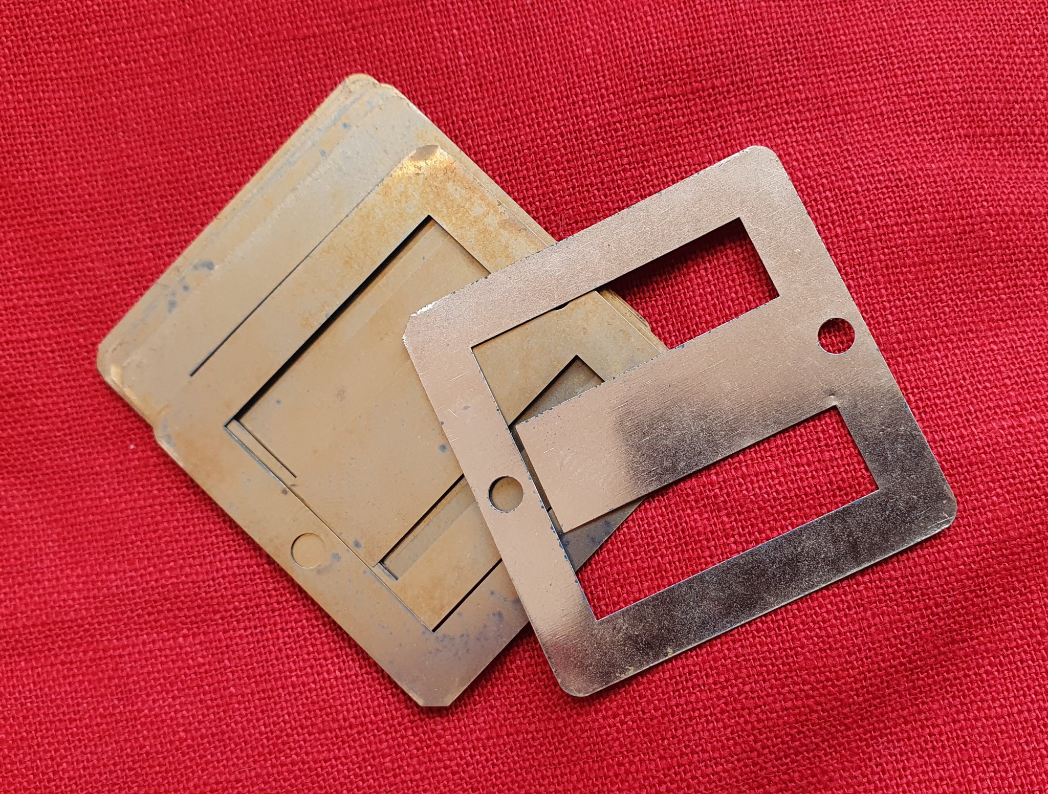

Quite likely it is (in German) vacoperm100 (80% nickel) or permenorm5000 (50% nickel), which are grades of permalloy. Nice stuf.
It seems to have a fixed airgap.
Check here; it seems to be an M-type lamination:
https://sekels.de/fileadmin/PDF/English/20_Info_Core_Packages.pdf
Very useful information, thanks. From a quick measurement of µr with LC resonance method I got 28500. That looks like Vacoperm 100B material.

IF VAC Vitroperm 500F really is competitive with 80% Nickel permalloy (and nothing in the Datasheet on VAC's would remotely ever make me suspect such a thing in a million years) that would be great.
Looking forward to see something I can relate to this:
So test with Zsrc 150R and 20/30/50Hz at -40dBu to 0dBu.

Anybody has any idea what lamination material is this? Dimensions: M42, thickness: 0.1 mm, gap width: 0.2 mm. I am building a pair of 1:16 transformer from it. I will publish the measurements if ready.
Shiny, so definitly nickel. Others chipped in on the details.
One concern, permalloy looses performance when mechanically stressed (bent) and needs to be heat treated to "come back". Which is why normally it does come in EL so assembly of the core does not cause mechanical stresses.
Thor
Another one, the airgap is substantial. It will make it good for TDA1541 without offset compensation of course. And the airgap may moderate performance losses from mechanical stresses.

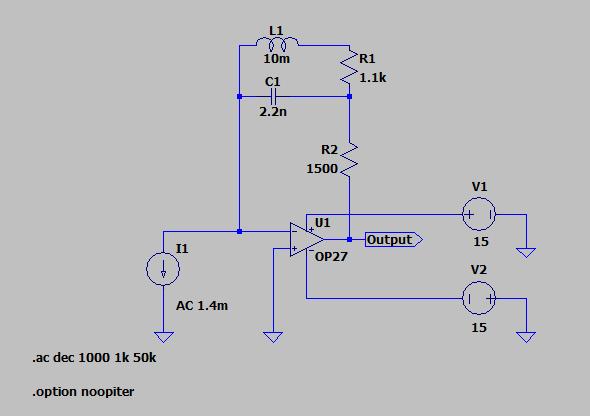

I will try this active filter as per your advice.I would suggest to not place anything between I/U conversion and DAC.
Add a peaking lowpass after the Op-Amp.
Say 10mH series inductor, 3.3nF +2k2 to ground after the coil.
Do a bit of curve fitting in the actual system to get a flat response at 10kHz.
Thor
My advise was to place the LCR Filter between Op-Amp output and Line out, where it may also be used as normal 2nd order 40khz lowpass per TDA1541 design.
Thor
