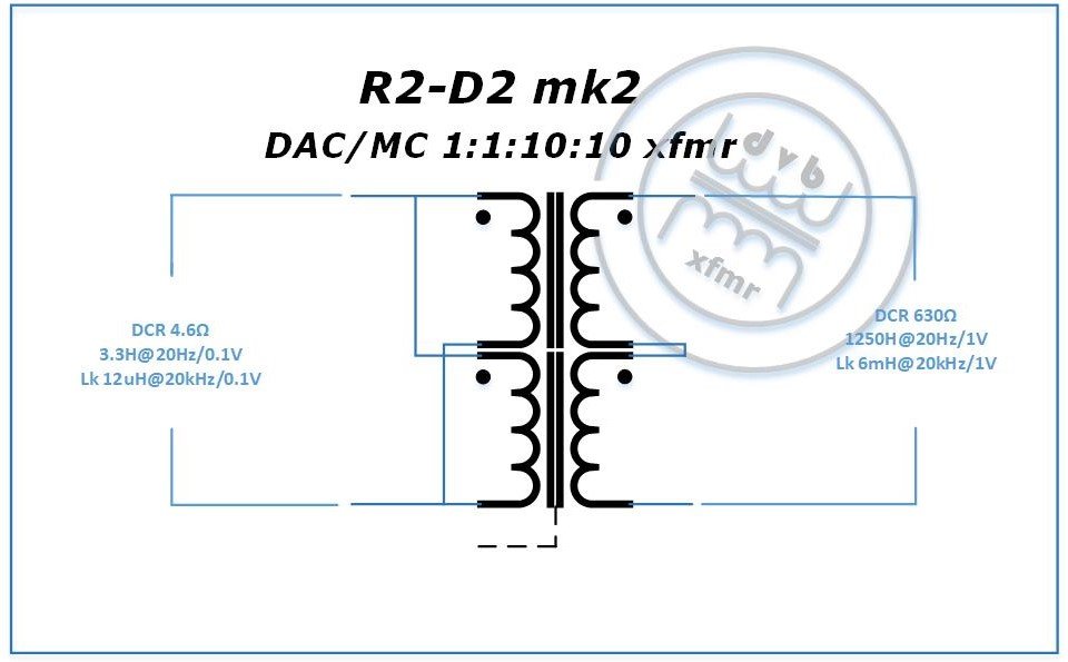

More than 10 years ago I built a SUT xfmr for MC cartridges (R2D2-1:1:22:22) using nickel 80%, since then I've tried about any other type of core with no better results, same goes for HiB in output xfmrs (sure, after a detailed PROS and CONS assessment)
@Brijac - If you're looking for directions have a look on my page here, I make custom too (only if I like the project 🙂 );
https://www.facebook.com/profile.php?id=100057288107123
There's a highly sophisticated "1:10" xfmr 🙂

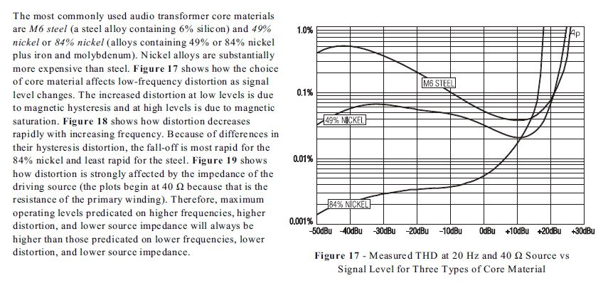

In my view mumetal/permalloy (50-80% nickel) covers 95% of the use cases for small signal
It is important to remember that permalloy was empirically developed for audio (and near audio) band performance with low distortion for signals, be that electromechanical transmission of the hypnotism in the speech pattern of the Fuehrer and Senior Nazis (mid 1930's Germany) or the precise echolocation of German U-Boots under water (ASDIC UK 1930's). All of these were found to require low distortion transformers (among many other challenges).
Non of the modern cores and core materials have that explicit application profile. They are all designed for power electronics.
Can modern cores be pressed into audio use? Sure. You will have to do a lot of homework and the more exotic versions that suite audio are eye wateringly expensive and unsuited for traditional audio transformer winding machines. So there is extra investment before they can be used. Who pays for that?
Are they superior to traditional "designed for audio performance" materials?
I fear necessity (as there is less 80% Nickel Permalloy processes each year worldwide) in order to stay in the transformer making business are here "The Mothers of Invention":
If AM/NC cores were really superior to 80% nickel, their purveyors for sure would produce for sure detailed datasheets to demonstrate the superiority of their wares over "obsolete permalloy".
But I can find many detailed datasheets for permalloy cored transformers with distortion data, while all the AM/NC offerings are sold with datasheets I would not even describe as vestigial and which are heavy promotional superlative language and have zip useful data.

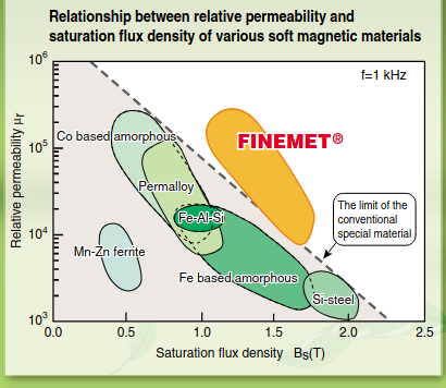

A graphic (Finemet is Hitachi brand name for nanocrystalline):
Screenshot 2024-11-02 at 20-51-33 Intro Finemet brochure - hl-fm10-cFinemetIntro.pdf.png

Welcome in 21st century 😉
Scarce literature?
Seconds of googling yield loads of scientific papers on amorphous and nanocrystalline core materials and their behavior in relation to older soft materials like permalloy.
While you're trying to look down on me with a shiny graphic (which is not literature, neither depicts THD) you're shooting yourself in the foot but I'm glad you posted it because it validates my opinion on permalloy and GOSS and maybe you'll learn something today for conveying this glorious commercial ad for FINEMET... but only if you take 2-3 steps back and analyze the big picture, yes? As such, permalloy is exactly where it should be for small signals PLUS the lowest THD in the bunch! Further more, HiB/GOSS has the highest tolerance for saturation, which is critical in high voltage swing over the lower band frequencies.
In other words, to welcome me properly in the 21st century, your graph should contain at least 3-4 more axes 🙂
PS. Oh yes, forgot to tell you that your graph is at 1kHz, here's the fourth missing axe 🙂
PS 2. Don't even think that this graph was issued for "Audio" purposes, it's strictly for industrial use!

That's all nice and all. But how does any of it relate to the behaviour at low flux levels for audio signals?
Saturation Flux / Relative Permeability is not a metric that is relevant in low signal level audio applications.
If you want Amorphous or Nanocrystaline Core transformers because it's modern and sexy sexy and super expensive, get them, clearly audio performance is not at issue.
If you want audio performance for low level applications, high nickel (79...84% nickel) permalloy is the best choice and relatively affordable options that will deliver both objective and subjective high performance can be found.
Now, I may be wrong here, of course.
If there is actual measured HD performance for a 1:10 Transformer at (say) 20Hz/30/50/100Hz and 1kHz with primary levels from -50 to 0dBu I will be happy to look at the results and if warranted change my view.
Absent proof, I will remain skeptical on the benefits for low signal level audio.
