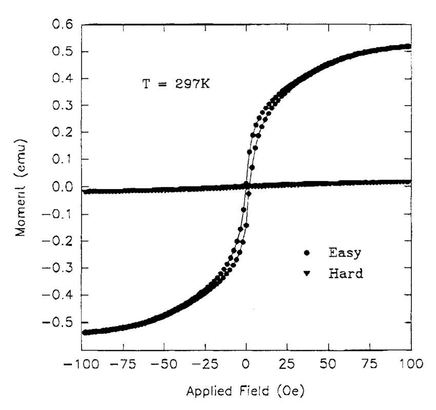

80% nickel core
Iron core
1 Oersted = ~ 80A/m

To begin with, amorphous and nanocrystalline are different in properties. Saying that the high content of iron make them unsuitable for audio application is utterly nonsense.It is. It has a direct relationship to level handling and distortion.
Nowadays we are sold "Amorphous" and "Nanocrystaline" Cores, guess you what, they are essentially > 90% iron cores and that suited for Audio, EXCEPT with a big aigap and for use with a lot of DC offset (SET Amp).
Now if we had 80% nickel in Amorphous or Nanocrystaline Cores, we might have something to discuss for DAC's.
Correct material makes a huge difference, incorrect material selection for the core, distortion performance becomes poor.
Thor
You should know better. Start checking the differences in properties; their pros and cons.
Then figure out why these amorphous and amorphous related core materials are there in the first place. Think in terms of price of raw materials.
By stating that "if we had 80% nickel in amorphous or nanocrystalline cores, we might have something to discuss for DAC's" you merely demonstrate your ignorance. Think in terms of permeability, eddy current (core loss).
Nanocrystalline cores are iron-based, but with crystals controlled at nanometric proportions. Results in a lowish hysteresis core that I measured when I worked for a transformer company. Hence my use in the PCM DAC. I symply not resisted and make a pair when I worked there.
For instance, comparing cores using a simple current transformer: CT's it are sensitive to hysteresis and magnetizing current, due to intrinsic loose coupling. Nanocrystalline cores better normal cores with a outrageously very large orders of magnitude (in same model, it detects nA currents vs mA for normal cores).
Is not fully absent of permeability variation distortion when driven by medium impedances, but also, is very low and we can abuse near to relatively high inductions levels and even so results in decent low freq. distortion. Far from saturation, measures very low.

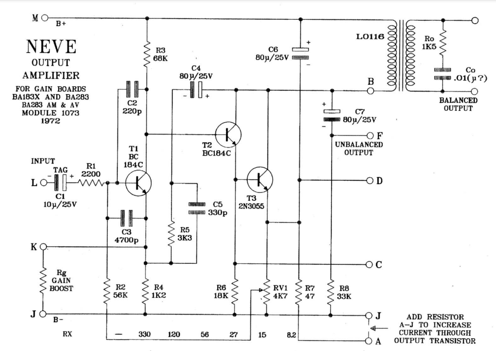

OF COURSE, perhaps low distortion is not the design goal. Or we are not operating at 0mA DC. Then using GOSS is a good choice.
Like in the Neve 1073 Output:

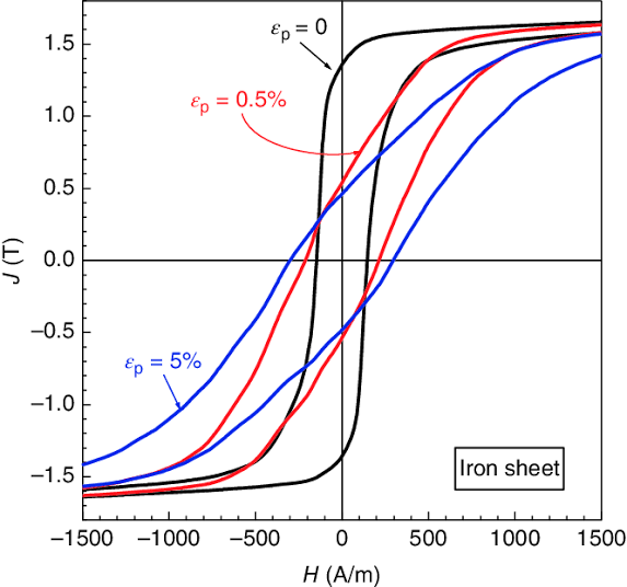

Nanocrystalline with DC, obviously not without gap. Not a problem any cores (possible to add a regular spacer) but the toroidal ones (unless one make a cut on it).
Amorphous vs nano: amorphous have more sigmoid BH curves, so distorts more than nano at higher signals.
But also depends on the type, both cores exists in various grades (some dedicated to high power transformers for electric grid).
Same for ferrites, not try mundane ordinary cores: the distortion and hysteresis are HORREOUDOUS.
EDIT: also, with GAP, inductance drops, and needs to compensate with more turns... is good to watch the HF response. Normally it demands more interleaving of layers (for higher signal trafos).

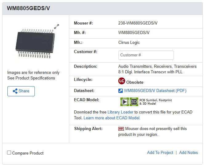

If the WM8805 was still RND and not NRND I'd be tempted to just use WM8805 with 16Bit PCM Output with a 32FS BCK, up to 192kHz (needs software) and use USB-2-SPDIF boards and isolate all inputs with SPDIF Transformers and be done. This solution would work perfectly with the "insurrection" core but alas, too late.
Comtrue has a SPD Receiver chip they pitch as replacement, but alas, nobody uses it, the documentation is flaky and I have no idea if it offers as low jitter as WM8805 does in practice.

True, but tda1541a is obsolete as well, for quite a while now. This is not a dac to be reproduced 10 years from now. It's going to be made now and few hears down the road, and seldom after that as prices will be hiked up way too much.
I myself don't use SPDIF, but i'm implementing wm8804 on board since it's still available in sufficient quantities from official sources. And nothing else comes close to it currently.
The key point is, "Nanocrystaline" or "Amorphous" in itself is not attribute that make a core especially suited for audio and the ferromagnetic (mis)behaviour of the material is maintained (if reduced).
Now 80% be it as metalglass or other tech guarantees low distortion because of it's magnetic properties. So again, it is the material that matters.
I'll take 80% Nickel EI Lam's in 0.05mm over 95% Iron AM/NC ANY DAY in low level, no-dc offset applications.
