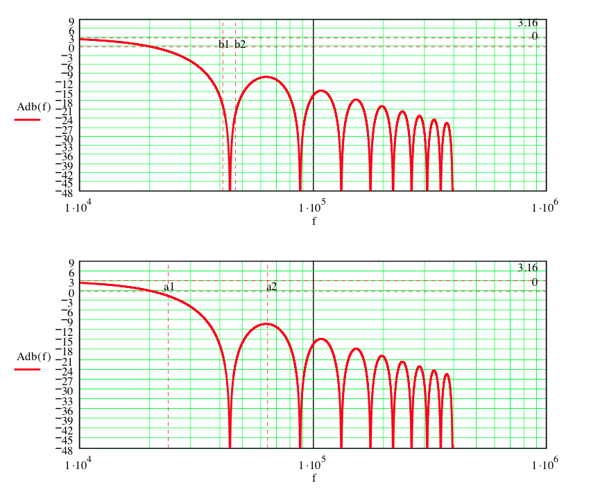

No it is not... Just marked red lines in relation to n x Fs. But without frequency?
Ohhh, ok, my bad. I thought you were interested in the SINC envelope, not in the frequency of the image os a single time.
It's mirrored around FS, with a minimum at FS.
If FS = 44.1kHz and the single tone is 1kHs, the the image appears at 44
1kHz - 1kHz or 43.1kHz.
For (say) an equal mix of 19kHz and 20kHz images appear at 24.1kHz (image of 20k) 25.1kHz (image of 19kHz).
For (say) a 100Hz tone, the image appears at 44kHz.
Level of a given frequency image follows SINC plus any additional filtering.

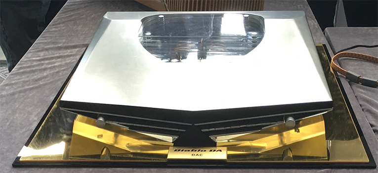

AMR Diablo dac . . .
The "iFi Diablo" was codenamed "red label" . . . .
Thor
The picture does not do justice to the VERY exclusive & futuristic enclosure design.
What was visible through the top plate revealed an absolutely no-compromise approach to oscillator design & distribution.
What a shame . . . It would've been a reference design to follow . . . . Alas it was never released.

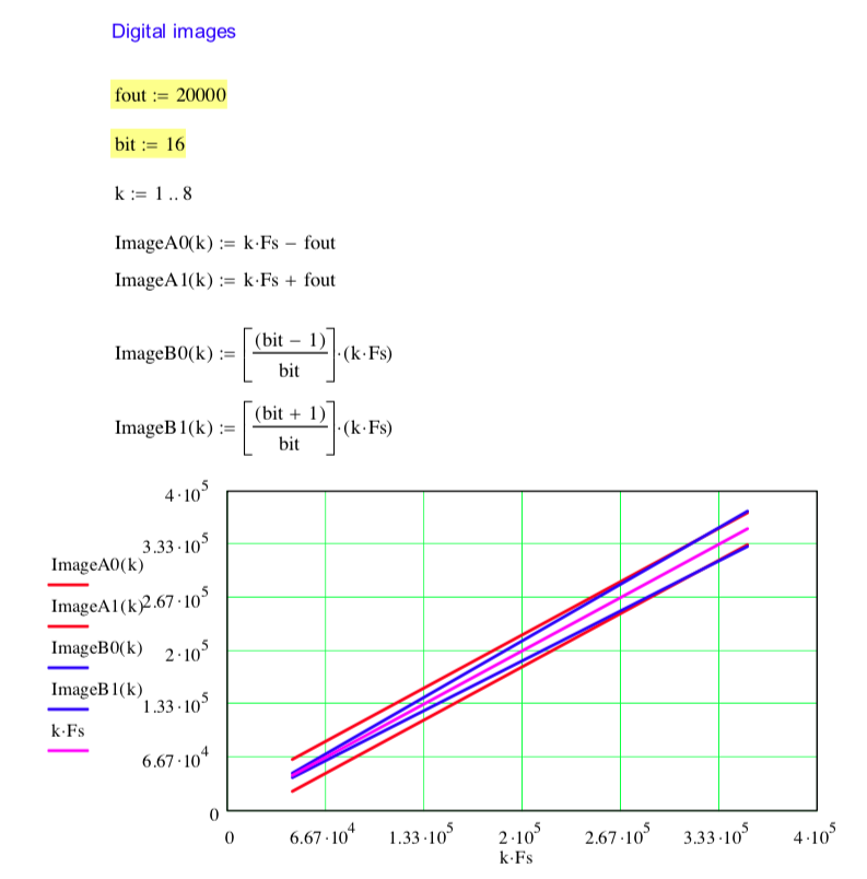

I made it with formulas and with functions plots. To make it more familiar with.
There are some mirror "images" related to Fs rate and Bit length.
I attached PDF file of MatCad .MCD sheet too. If somebody wants .MCD file please ask.

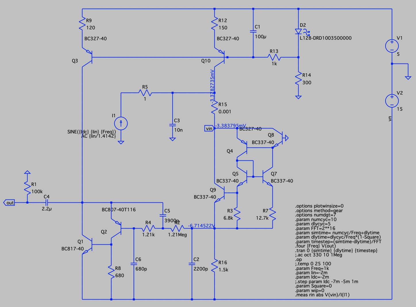

I tried that discrete IV on the veroboard it performs quite good in both measurements and sound. H2 was -85-90db.
Here is what i tried:
I did it without sallen-key filter for the start. Just 1st order (C2). R2 is indeed 1.21k

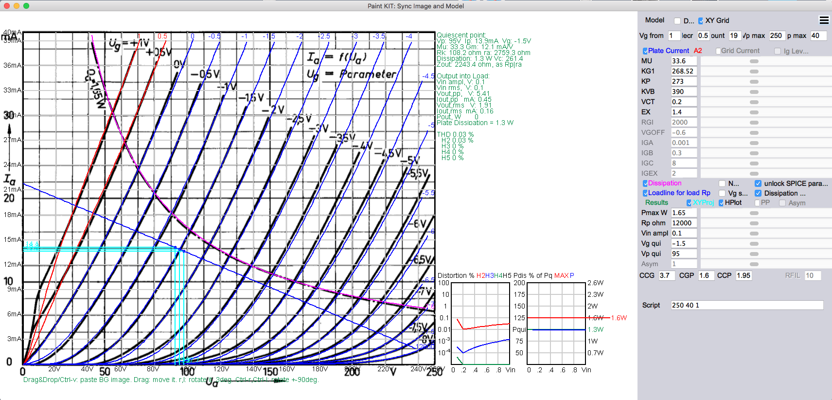

I didnt find ECC188 datas so I used E188CC datasheets from Siemens and Philips.
3 spice models .INC files are In the Zip folder. Almost the same...
there are few solutions to use this tube. Pretty much the same as ECC/PCC88.
1.
Standard Amplification stage with Riv=22 ohm, output in phase, 12K load, 1.5V battery biasing (or RC), about 2Vrms output, Zout=2,2K, two sections im parallel (and load too...) 1.1K Zout... Very low distortion.
2.
Grounded grid, with JFET, sch was in topic before, very small THD, very good PSRR, simple... Also parallel sections with 2 x JFET
3.
SRPP, parallel sections, with EL84 as the load in triode mode.
4.
MJU follower, parallel sections, with EL84 as load.
Paralleled sections because of the lower Ri, higher transconductance and Screen and cross sections capacitances. That is the pretty much standard tube, produced in large quantities, so from the same bunch specimens are identical... Probably wider...

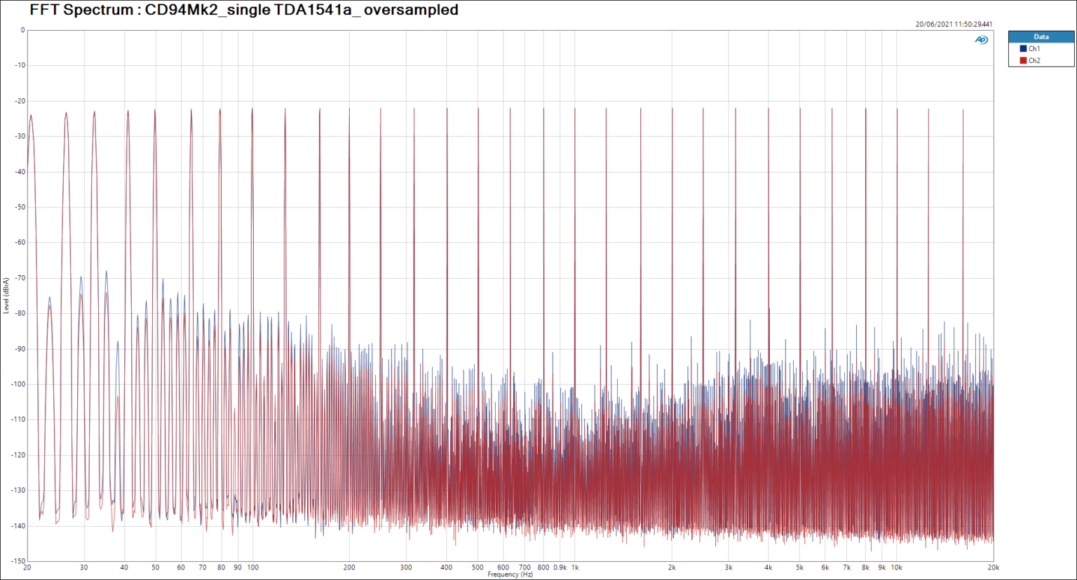

Tips:
Make sure the I/V stage is capable of resolving at least 16 bits.
Tube-based or transformer cpl:ed stages cannot resolve 16 bit from 20-20 kHz:
