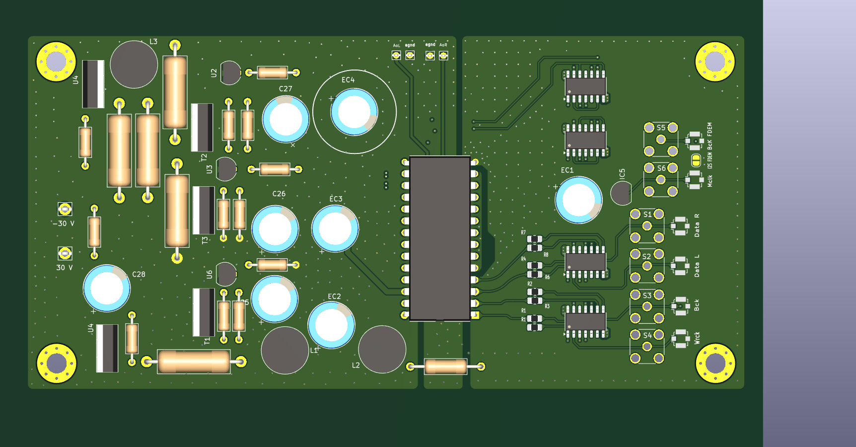

For now the 4 layers single TDA core PCB is ok to test if no further evo to simultaneous mode embeded and/or embed balanced MCLK.
I had to give up dip14 packages but a pcb can be easily made as I have backups....
There is an internal trace with jumper on top than allows or not the I2S Bck FDEM feeding for active sync. I have to add a jumper to pin 26 to 28 prg mode but that's a final detail .
So SMA+UF-L input : pin 1 to 4 , MCLK (BJT attenuator buffer option) + BCK FDEM active sync : internal or external options (jumper of SMA/UF-L). for sim mode or delayed MCLK (think Mori Clock no probs of long sma cables here for the ones who know what I mean) or very short uf-l cable 1" if MCLK classic pcb aside (@Markw4 , etc : ask about stop clock options of your front ends to feed theboard as per discussed in the thread)

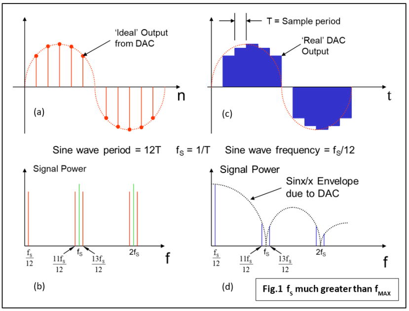

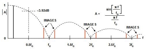

BTW someone post formula or link, about digital images in function of Fs?
I am not in the mood to dig in... 🤔View attachment 1373944
Formula? It's in the picture...
But real DAC's do not follow the theoretical SINC response.
If you want something simple, this page:
https://web.archive.org/web/20240223040226/http://www.atx7006.com/articles/dac_frequency_response
Scroll to the bottom:
I normally find that shooting for +0.1dB over theory @ Fs/4 works for me, so +1dB @ Fs/4 and +0.2dB @ Fs/8.
Thor
Looking good, but being german, so much unrequired asymmetry.
Also, the Os-Con's look small (physically) and the 100uF AC feedback capacitors in the TL431 voltage divider look huge.
Thor
No it is not... Just marked red lines in relation to n x Fs. But without frequency?Formula? It's in the picture...
Maybe it is more informative, it is stated for 1 x Fs that images are 11/12 Fs and 13/12 Fs arounf Fs point.
But
It is not stated for 2 x Fs, 3 x Fs and so...
Since the F axis is linear, and distances from 1 x Fs images are the same as 2 x Fs marked images, probaly
should be the same?
n = 1
(11 / 12) x n x 44.1KHz = 0.9167 x 44.1KHz = 40.425 KHz
(13 / 12) x n x 44.1KHz = 1.0.83 x 44.1KHz = 47.775 KHz
n = 2
(11 / 12) x n x 44.1KHz = 0.9167 x 88.2KHz = 80.85 KHz
(13 / 12) x n x 44.1KHz = 1.0.83 x 88.2KHz = 95.55 KHz
Anyway, NOTE that it is for Sine wave period = 12T.
Thor
Many thanks for the feedback (and PM advices also : much appreciated).
I checked through hole Sanyo Os Con catalog and don't find 1200 uF/16V. My prefered are the SEP serie that has not such high capacitance. When I look at SEPC/F the max is 1000 uF and are 10 mm diameter as the footprints I chose (with a margin to 12 mm diameter spacing on the pcb and double spacing gap for the TPH in order some diyers can choose their own. I disllike a lot the SEPC/F I plenty have but found they sound zingy when used in an anlog DAC supply (pin 15, or else PCM dac ics I tried : AD1862, etc)
So, beyond the excellent ESR of the OSC CON, I find the new ones not sounding as good as the NLA formers and for my tastes till now, mostly for the -15V (so here I put a margin for bigger caps and double leads pitch gap : 5mm + 7mm). Of course, on must hear your design with the BOM as it was simed like that and the tricks you use are subtles and based too on listening long experience (that matterd a lot in my agenda : I bougth the first microIdsd from Ifi but couldn't affoard CD77 from AMR). ANyway I found the SEP serie the best of all the new oscons ! Because darker and less zingy (barely soft at the opposit of the SEPC/F) if not at all, but I don't like polymer in analog decoupling but another brand model (I literraly tried all the new polymers models and brans for my former TDA DAC Audial core based and the winner wasnot an os-con : whatever they have same esr & inductance at iso capacitance/voltage : the do NOT sounds the same too me, whatever I repeat the tests. BUT and it is a huge one, it was not tested in a shunt PS !
What the assymetry you are talking about please ? SMA pads ? Tracks on top layer ? Else ? : power side ( the many island on insides layers make it the topsymetry for eyes difficult but I can try better)?
For the tracks, the minimum spacing I use is the text book x3 width spacing (used for flip flops vinicity for illlustration). On the longer tracks FDEM, AoL/R, assymetry was a question of spacing with some signal vias, or to break too long // Tracks for antena coupling despite the spacing here is huge already (no needs of via fencing walls for instance). Sometimes I used assymetry to avoid things like M4 through hole in a corner (WRclk uf-l) or to make shorter the tracks for Mclk and FEDEM_Bck : but that's my french Cartesian side 😉 : in practice it certainly is not mandatory, so I can align (I do like too it looks good 🙂 )
As I send you a pcb, I'd like you find it looking good too 😊 !
Edit : I'm planning something in order you use the Super caps option you prefer. I willl use this pcb above cause the super caps are a little expensive for my own needs).
The TL431 caps are 10 mm diameter foot print, so caps could breath with all the close heat : double space leads gap here : 5mm and 2.5 mm 😉
(here btw my experience is the Pani FR are f....g good but according the smoothing caps chosen before; Pan FM here, nope; Pan FC yes or not (they are very clear and neutral : my ref to swap a sepc/f on analog sides)
What is the spacing of the Super caps you use, please in order I check the footprints needed.
cheers
yes
and not an reactive elements too.
Maybe the best way will be some current buffer with low impedance output.
And then IV circuit?
Or simply just an I/V with very low impedance input BJT (output impedance TDA 1541A that high ???) as the discussed shematic has a lot of pins filtering ? Jfet seems out cause unconcistancy (T.'s input sooner inthe thread)
By the way I wonder if the outputs of the TDA1541A are not internaly protected by diodes or somewhat ? I know AD1862 hasn't, @Alexandre reported about that last chip times ago.
