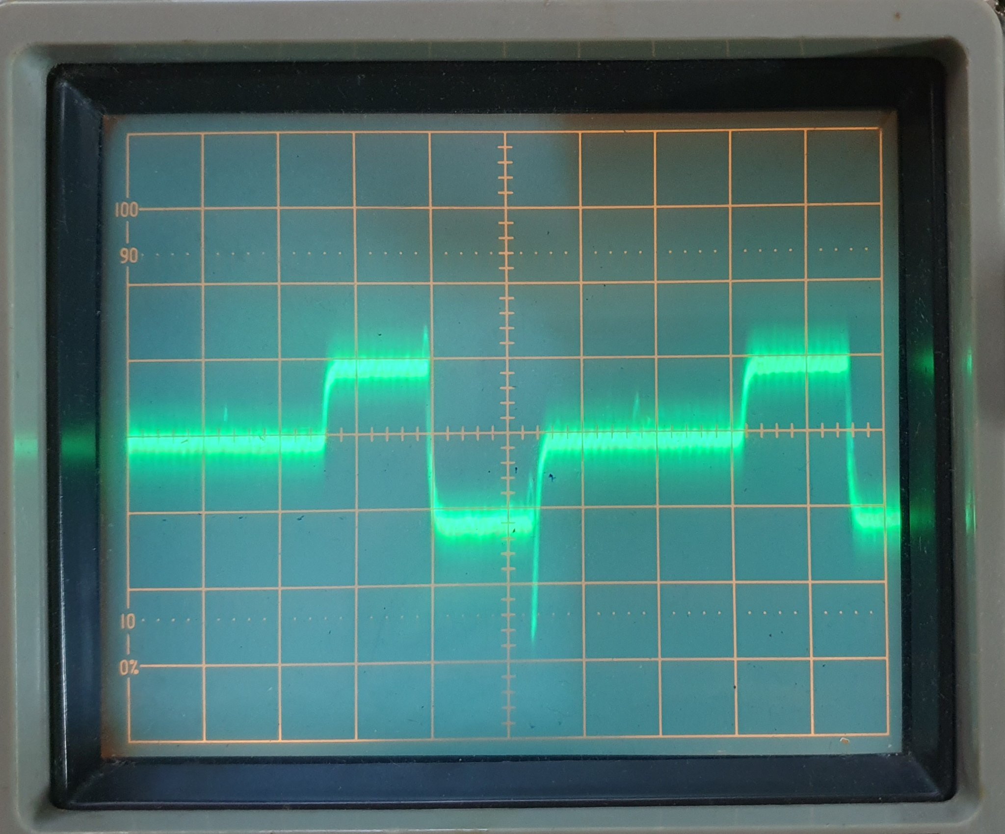

This is a glitch. Bit transition +/-1 LSB. See the spike at the bottom.
Perfect, a good real example! Easier than trying to explain with words.
As we know, basically a subproduct of many internal gates with some parasitic coupling to output.
I understand that being intrinsic with the internal IC layout, that's it?
Sample-and-hold can isolate the transition in theory, but, the amplitude in this example is comparable to LSB, so is not worth the hassle in my opinion (about the question of taming glitch).
They are also there in a DAC with filter, just much smaller steps. Imagine the filter as an interpolator that takesa few dozend to a few 100 (or more in some cases) data points in 16/44.1 and then recreates a new waveform that does not reliably pass through the original data points but is (say) 24/352.8kHz.
Indeed, then we can imagine the worst case being the NOS situation (high transition amplitude; full scale change). And, without any analog filter (ie. no-filter DAC: NOS + no analog filter), the posterior amplification needs to cope with it.
Good point about interpolation not reliably passing to original points; hence some people using heavy PC-based interpolation and sending hardware-NOS to DAC (amongst other things, like pre-echo etc). Hoping that works as advised... 😉
Yup.
Nope, not with TDA1541. It will be interesting to find what it is though.
Not the layout as such, though that contributes.
As for TDA1541 the issue is the base capacitance of the input PNP's capacitively coupling the input signals into the substrate, changing the layout will not help.
Moving the PNP transistors off board and putting discrete PNP outside the IC would have helped.
Yes, levels are low and once @lcsaszar adds 10n to ground on each output it will be even less.
AFAIK this is the worst case glitch for the TDA1541!

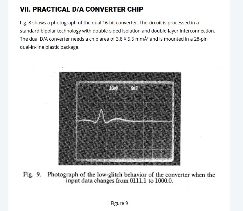

Transition from 1000000000000000 to 0111111111111111. The MSB switches for a signal of only +/- 1 LSB. This is the old school direct binary architecture.
The other popular architecture is sign-magnitude (PCM63, AD1862), where signals near midscale zero switch small currents only, a few LSBs only. The MSB only switches when the signal reaches -6dBFS.
This deserves to be posted again (scope capture by @lcsaszar ).
This is topnotch performance for 1LSB transition, in my opinion. What is the width of the pulses? I mean the signal, not the glitch. Is it a width of 1 sample?
With the glitch, we have to think about the energy concept, what we have below is very low glitch energy because the area is very small (both amplitude and width of the glitch are small).

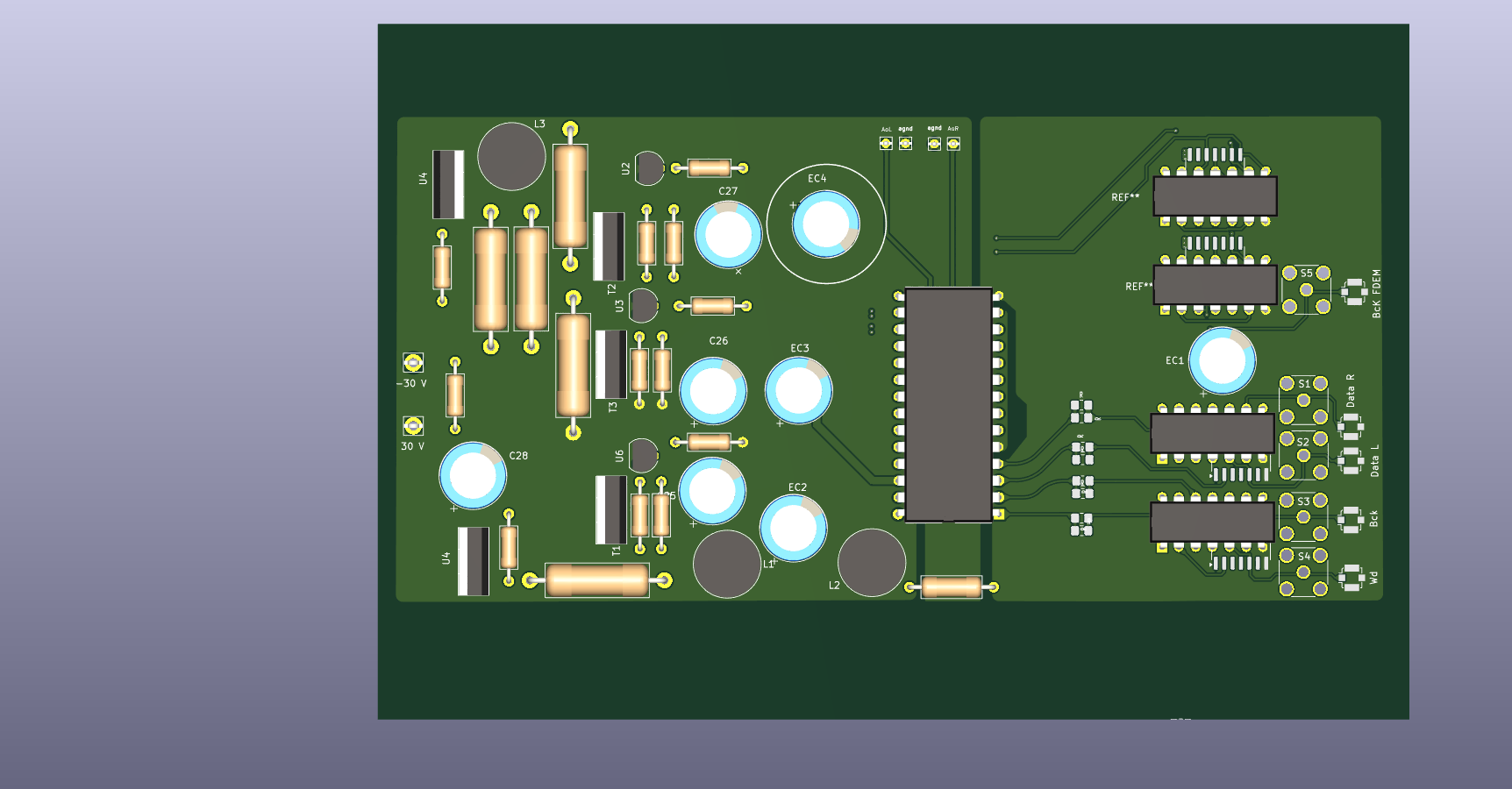

Almost finished (need to make cleaner border; via fencing, checksom impedance and check twice DRC and JLCPCB fab rules (but was designed in that spirit), no embeded clock yet. One can choose Dip or Soic register, SMA or UFL connectors. All the SMD decoupling below as suggested (and helped) by Thorsten.
Here the DIP packaging version of the registers (soic version is inside the Pdip foot print if one chooses it.

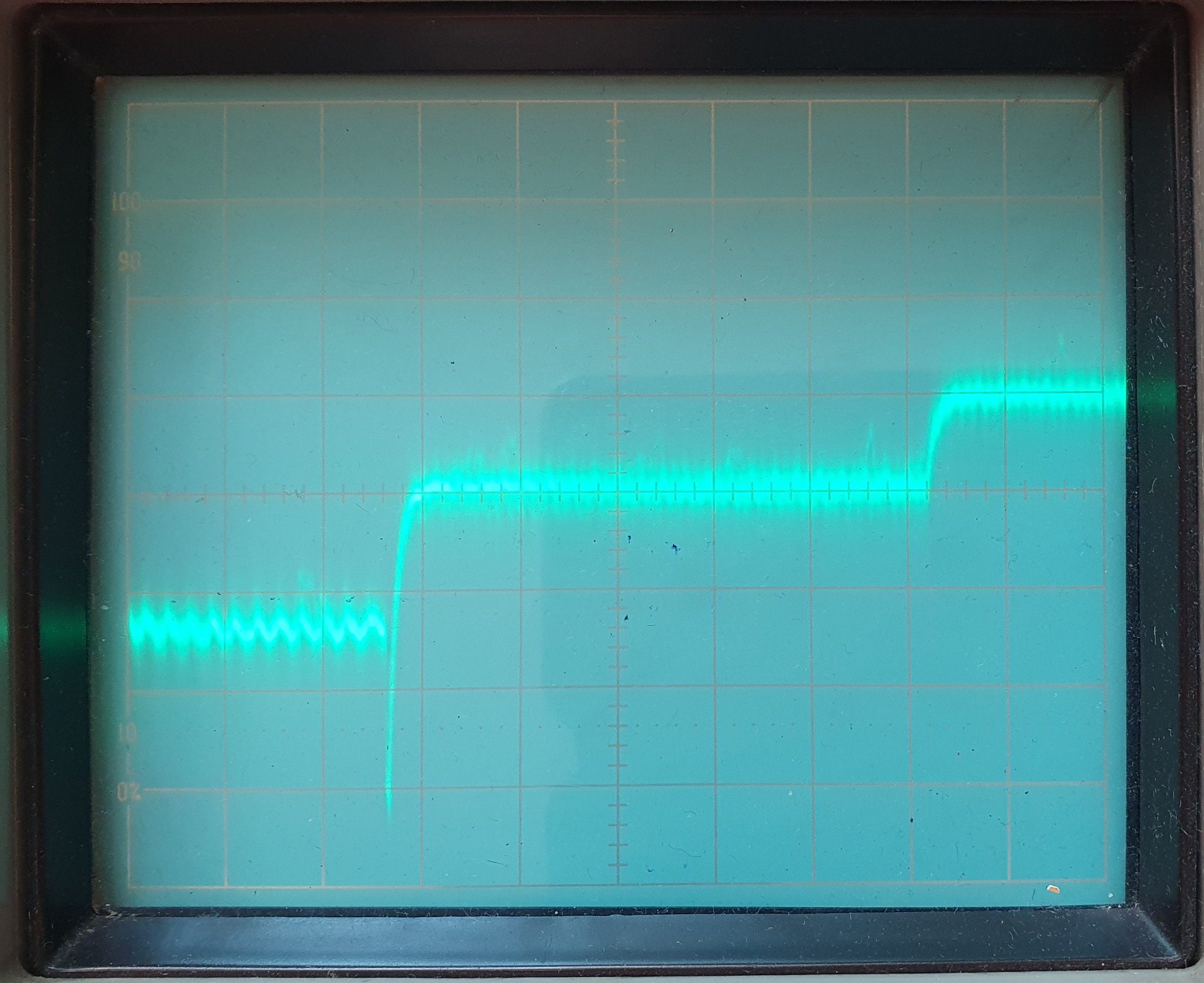

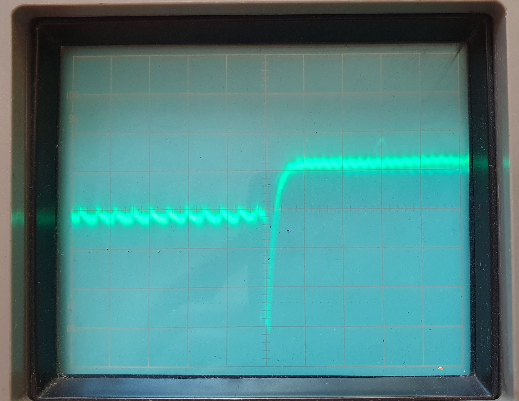

Can you zoom on the glitch as give the pulse width?
Horizontal: 50 us/div
Vertical: 10 mV/div (with x100 preamplifier)
I added 4.7 nF direct at the TDA output.
What we see here is the transition from 0111 1111 1111 1111 to 1000 0000 0000 0000 that is all bits flipped, the step is 1 LSB.
I enter offset binary like the above in my generator, but it sends out 2s complement on the I2S bus. The TDA then converts it back internally, and the offset binary word will be latched in the registers.
The glitch is most visible at bit 12, 13, 14, 15 transition.
