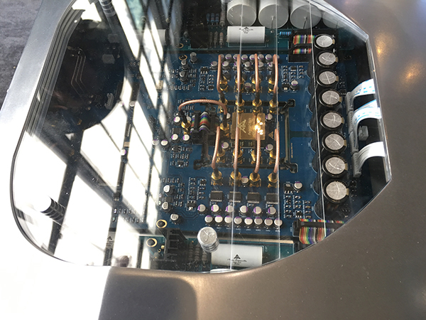

That's a good idea. Iancanada made cutting slots inside the PCB to make the crystal pcb floating inside. But anyway the board shoulld be current feeded and damped, so a coax very thin cable with very soft nylon body makes sense.
On the (likely permanently cancelled) "AMR Diablo" DAC, the clock and clock distribution was completely "carved out" from the main PCB and suspended on the SMA cables and special rubber O-Rings. Its somewhat visible in the picture below:
The extra mass-loading from the "CNC carved from solid copper and then gold plated" shielding lowered resonance frequency into Hz numbers and it was a well damped resonance IIRC.
Thor
