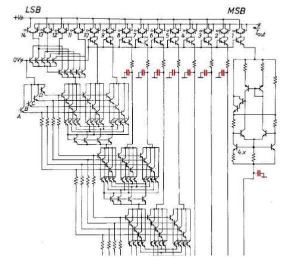

More on the various switching noise path's in the TDA1541
So, after decoding the actual 12pF input capacitance as mainly (~ 9pF) being from the PNP transistor fabrication, I realised that because that base region would have actually become a NPN transistor collector, every NPN transistor has as a result around 9pF collector to substrate, unless it uses a different (smaller/larger) geometry.
So let's re-look at our putative input circuit.
The very crudely drawn in red capacitors are all the collectors of NPN Transistors, Anodes of Diodes (in effect also a variation of a NPN Transistor collector) and the PNP transistor Base capacitance's to Substrate, which in turn is a layer of higher resistance bulk P-doped silicon connected to the -15V line.
We can see that there are at least three and likely six more 9pF parasitic capacitors to substrate.
Interestingly the CM/EC Logic that takes over is balanced and so currents into substrate pretty much net off.
This holds for all the various latches inside TDA1541, noise comes from the Input circuit almost exclusively.
This noise is not ground bounce (we actually don't have that at all, it's not a TTL/CMOS IC) but capacitive coupling of unbalanced switching edges into the substrate and from there straight into the output.
Why?
Let's look at the output. The diode connected transistors that block reverse current flows when the bit is inactive have parasitic capacitance to substrate, as do our cascode transistors.
So, all sorts of currents related to edge-speed couple into the substrate which has a certain resistance to -15V and then into the -15V rail. Any of these needle pulse's that cannot be absorbed, and there is always a residual even with perfect decoupling, coupled back into the output. A conceptual schematic of how this noise couples:
At a guess, Cin is maybe 50pF total capacitance that couples noise into the substrate.
Cout perhaps 150pF total per channel.
Substrate resistance - call it 30 Ohm.
(If anyone has better guesses, do say so)
Thus the HPF to substrate is ~ 106MHz. So -15V RF decoupling matters a lot actually. It will sink a material amount of the noise.
A capacitor to +5V, NOT AGND (correction needed for PCB designs) will form a capacitive divider with the output's capacitance to substrate, so my "bog standard" 10nF will form a voltage divider that attenuates the clock/data etc. feedthrough from the substrate to output by around 36dB or around / 60 times. Even 3.3nF will kill the switching by 26dB or around / 20 times.
We really need to consider the RF decoupling and the DEM/Audio side as separate problems. Where want RF decoupling to minimise switching noise from inputs (and DEM) is different to where want the audio path.
One danger, noisy supplies. So if you want to make "short loop" decoupling work, your power supplies need to be super clean (<< -90dBV noise). Here TL431 become to noisy. I guess super capacitors or extremely low noise supplies become the sole options.

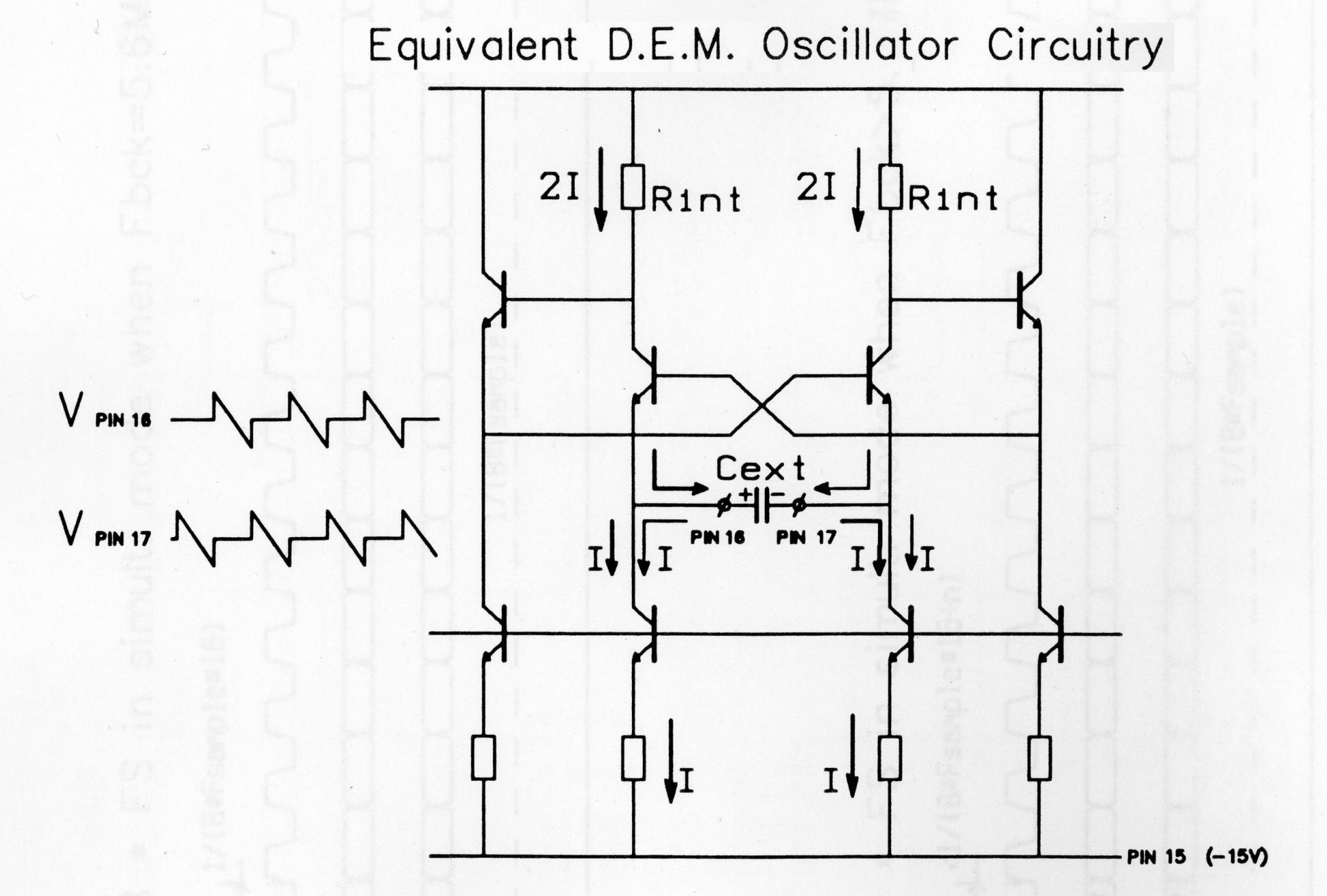

Now DEM, John made an interesting quip.
He wrote "The DEM Filtering needs RF style decoupling at 200kHz" or something similar. I wholeheartedly agree with that BTW. Now what in the DEM circuit can couple switching noise from the DEM into Substrate?
Oscillator and dividers are differential, so no significant noise leakage there, all leakage should net off to near zero. Edges are opposite on both Pin 16/17 and going downstream.
Biggest issue, the DEM synchronisation if used. So we really need to watch just how symmetrical our drive is (SE Grundig style is clearly a PTS) and avoid any more drive than absolutely necessary.
And all the DEM switches into the DEM Filter capacitors can create issues. So the simple solution, RF style decoupling that kills the noise.
If we do not do all that, then perhaps using a low FDEM (50Hz or lower) is a better choice/lesser evil, if we can get the Capacitor leakage issue under control, long term. I probably continue to decline that road.
AGND vs. DGND is again an issue and irresolvable. Really noise from DEM switching needs to loop to -15V. DEM filter cap's for low audio noise loop to AGND. We have to live with this then.
All in all, a little care with decoupling (-15V to +5V especially) and input signal attenuators and slew rate limiters should help a lot, enough to get the RF noise below general noise.

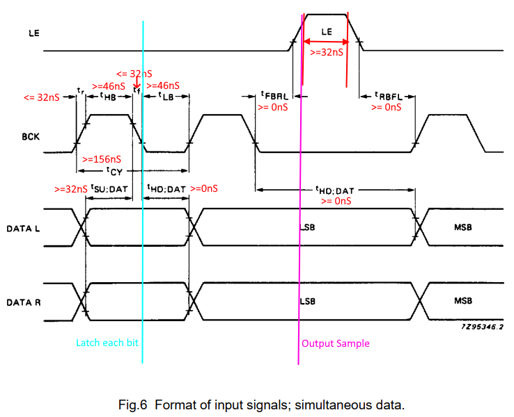

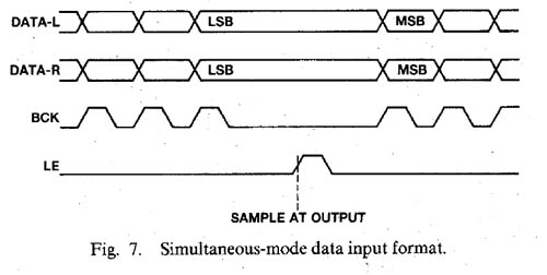

PS, is it me or does the TDA1541 latch the bits on the falling edge of BCK in SIM Mode?
One thing I want to do with my TDA1541 DAC is to add a MCLK divider to operate the DEM system synchronous. But it need to be 3V3 logic, just because the oscillator module is 3V3.
Use 74F... Logic. Runs on 5V, but input levels are TTL (well, it is advanced fast schottky TTL) as are output levels.
All bipolar, no FET in sight.

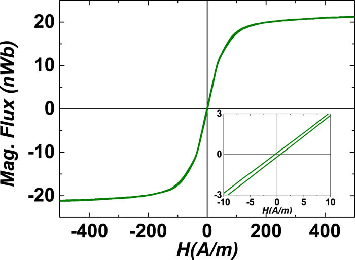

Interesting. Looks like 24% Boron make a good magnetic alloy.
in-Plane BH-loop of the B= 24% amorphous ribbon measured by BH-loop tracer. Inset represents the low magnetic field behaviour of the same sample.
But again, Amorphous has an input here, because the alloy must be amorphous. Cannot be another allow.But Nanocrystalline or not is not relevant.
And the key part is the chemistry which is NOT "nanocrystalline iron". The "magic" is "nanocrystalline".

According with the datasheet, the process starts when LE returns to L level (falling). If I interpreted well.PS, is it me or does the TDA1541 latch the bits on the falling edge of BCK in SIM Mode?
It is!
When you check TDA1541A data sheet & timing diagrams for simultaneous mode (pin 27 connected to -5V), you will see that data is now being latched at the falling edge of BCK.
In I2S mode (pin 27 connected to +5V) data is latched at the rising edge of BCK.
Interesting for reclocking BCK.
But the LE signal uses the rising edge to latch the data into the output registers.
You can see the implied bit latching on the falling edge here as well...
Here all timing written into the TDA1541 timing diagram. This is for my own elucidation.

No not my intention; there are different grades (B-H curve).
Ok, so shall we then say:
Some grades of nickel alloy with iron as well as some specific grades of amorphous or nanocrystalline boron, cobalt or others alloys with iron are especially suited to low distortion, low level audio use.
For nickel based alloys the documentation for audio specific use is extensive.
No documentation for audio specific use of alternative core materials is currently extant, extant datasheets generally omit the key metrics for audio and exactly which specific formulations and properties produce specific audio results is not documented.
Not all or even most cores marketed as 'amorphous' or 'nanocrystalline' are automatically suitable for audio use, let alone superior to traditional alloys.
Absent suitable data only empirical testing can confirm or reject a specific 'amorphous' or 'nanocrystalline' core as suitable in a specific application.
I can happily agree with the above, can you?
Thor

Then I remembered a little test I made: I measured the B-H curve of toroidal cores disponibles at that local that time. The nanocrystalline I used for my signal trafos measured a B/H curve almost square, and impossible to detect any hysteresis with my "poor" equipment. Contrast to "normal" amorphous: round B-H curve and some visible hysteresis (and this provokes more HD in low freq. than the nanocrystalline). But both are far less non-linear than GOSS. Too bad I not had any permalloy to compare, and the disponible ferrites are disastrous.
Of course, the grades/types disponible there at that time. Anyway, amorphous and nanocristalline results in different animals in general. At least the core seller said to my boss and to me ;-)
In doubt, measure and wonder or reject...
+1. But at same time, some makers of these trafos certainly wants to make it secret ;-)
