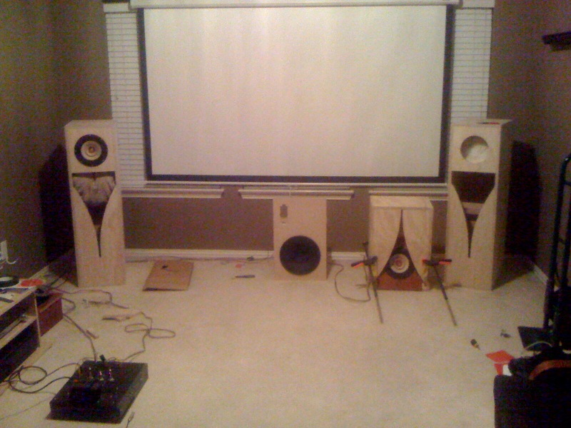

Late last night, we (kenpeter and I0 decided upon animpromptu listening / tweaking sesion.
1. Stuffing a pillow into the top part of the horn seemed to round out teh sound a bit (reduce a bit of a hollow ring)
2. We also tried stuffing a piece of cardboard in the same position after the pillow to forom a sort of 45 degree deflector. This may or may not have helped or made things worse. Okay, .. it made no significant difference 🙂
3. Hooked up my smal tube 1 watt 12AT7-12B4 single ended amp. The lower damping really made a difference compared to the mass market 100W class D panasonic home theater reciever I used previously for testing, bass now bloomed, though I feel improvements can still be made.
4. Freddy has been bugging me to try out one of the 1772 in a Karlson slit vent K-12 that I have. I rigged up a suitable drive adapter plate out of scrap and we somehow managed to clamp the plate in.
a. Compared to the k-slot horn, the K12 doesn't go as low and isn't as efficient (tranditional karlsons are bandpasses and don't have gain above the midbass).
b. The K12 has a bit more solid midbass. Drum and bass are more solid, though the K-slot horn goes much lower.
c. The K12 doesn't have any upward tilt in the sound, and dispersion may be more even. Hard to say for sure fro casual listening, since the tangband has decent dispersion to start with.
Which one is better, kenpeter prefered the K12 for it's more solid midbass, I prefered the K-slot horn for its more effortless sound.
More experiments to come.
