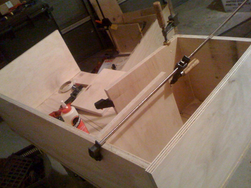

you're moving pretty fast - how are you fastening the internal panels into place? - just glue and pressure? - I want to do something but had fever for >week plus horrible apnea
All credit goes to the number of clamps (thx, Ken)I've had available this time
Yes, glue and pressure are typically what I've used in the past. Sometimes, when the angles make clamping difficult, I've used a couple of drywall screws to hold things together until the glue sets.

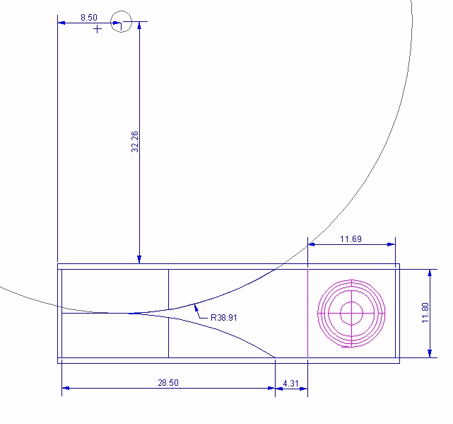

This drawing contains the dimensions needed to accurately describe the k-slot contour.

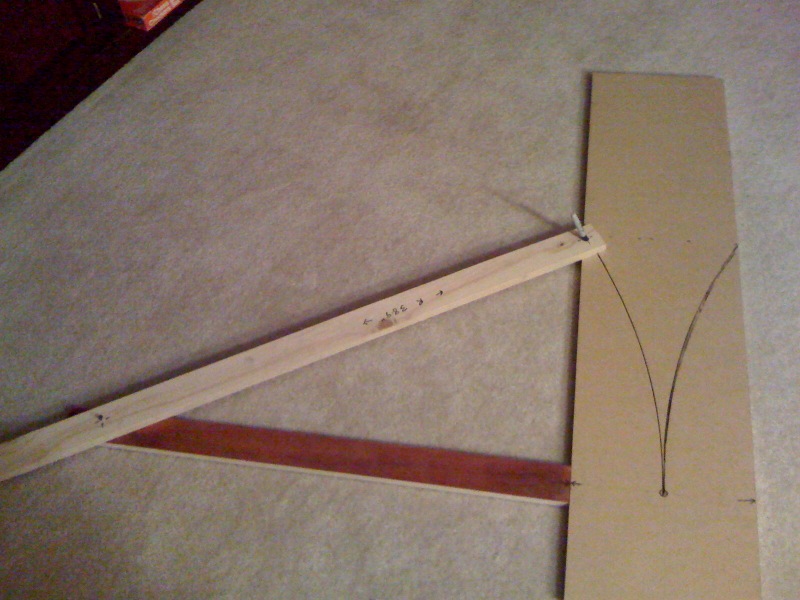

Slots Kut

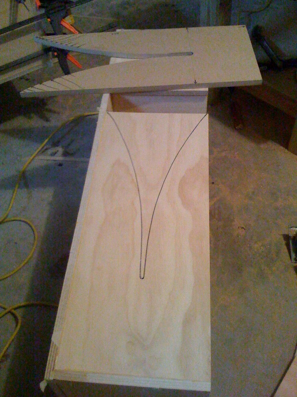

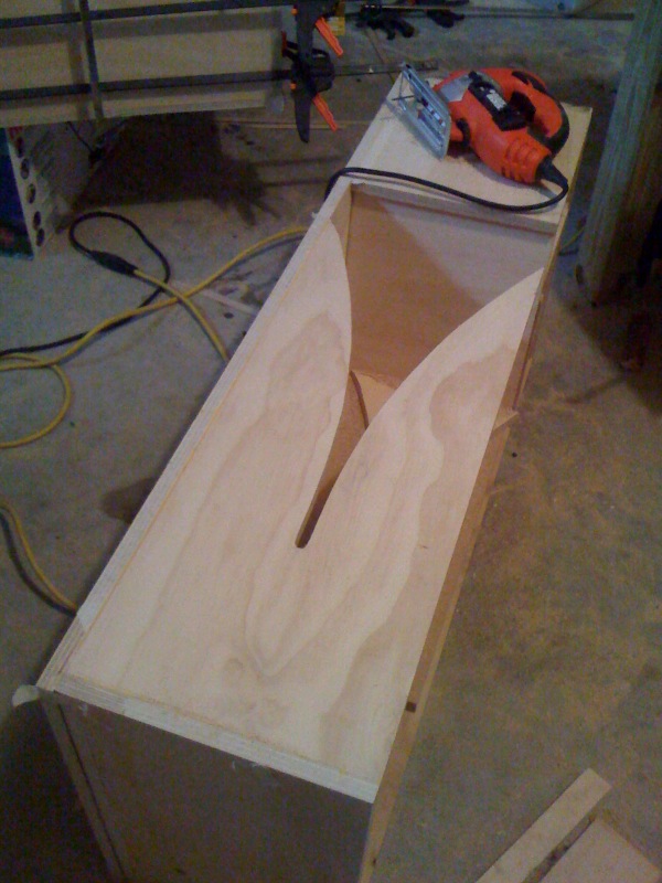

K-slots cut on both cabinets. Rouch cuts made with a jigsaw and the final cuts were with a router + template bit using an MDF template clamped onto the board

attractive build including grain patterns - what actions do you expect of the K-slot vs a rectangular terminus?

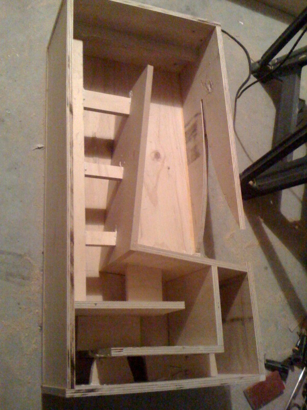

The next steps will involve
1. cutting the driver hole. Arauco plywood is pretty soft so I'm considering using a supra baffle of solid wood for this purpose. Haven't decided yet.
2. bracing. I cannot over emphasize how important this is, IMO. Many folks try to improve their enclosures by the "brute force approach", ie. using multiple layers of ply / MDF, constrained layers etc on the cabinet walls with little attention to actually bracing between the walls. For a change, bracing the contours of a horn is actually easier than bracing a conventional cabinet. Since the contour walls are mostly non-parallel to each other , my technique involves
a. rough tracing of the profile on pieces of scrap
b. cutting the brace out on the saw, the brace usually ends up wedge shaped
c. buttering the brace with liquid nails or PL brand polyurethane adhesive and gently pounding it in with a rubber mallet and leaving it to cure
Taking a leaf out of Bill Fitzmaurice's book, use a brace when possible where there is more than 8" of unsupported substrate.

Not so sure about arauco grain patterns being attractive 🙂
What I'm expecting the K-slot to do is:
1. smoothing the impedance match between the mouth and free air
2. from previous experiments with k-slot tweeters, I (and you, probably) had observed that the slot seems to diffract the sound beam towards the narrow end of the slot. What this could mean in this rear loaded horn design is , to an extent, direct the sound towards the floor as opposed to towards the driver, ... possibly reducing interference with the front wave. This is just a hypothesis, .K-slots are a bit of funny science.
Bears repeating.

That's looking good. I'm intrigued by the novelty of the exotic 'Arauco' which was simply known as 'pine' where i grew up. I might have to build a scaled version for my FE108E sigmas. The grain looks OK to me. Pine always looks rustic.
I've used K-slots on TLs and TQWTs before and they do tend to improve FR -- presumably by lowering the pipe Q.
