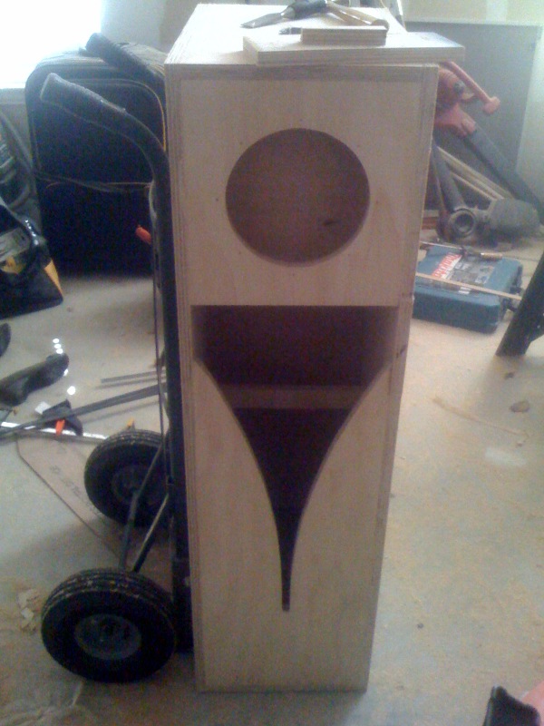

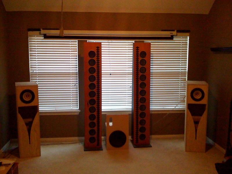

Well , I got one cab hooked up
It sounds balanced down to about 45 Hz and drops below that. I don't heat any knock you off your feet bass ( could use a sub for the first octave)
I'll report after hooking up the other one ( may even put in a karlson 12 to compare)
I'll also try to run some FR curves
The driver itself is pleasant to listen to. it won't take your head off even thought the treble is nicely extended

I've had a few PM's asking for updates. Firstly, sorry I haven't had the time to do much with this project (or for that matter, anything else apart from work) over the week.
I did get both channels hooked up last night. I couldn't find my mic cable , thus haven't been able to measure the response.
There si something worrying about the bass though, it doesn't hit as hard as I've heard with other horns, even though I've verified response down to the 40's . Now, I seem to be the only person with this issue with this design so something doesn't compute. Even though the driver doesn't shriek, It does seem to sound more balanced with a bit of midrange dip EQ'd in.

This morning, I replaced one of my TB-1772 with my 6.5" fostex FE 166E.
Running test tones,
1. Generally speaking, this fostex isn't as efficient above 100 Hz or so.
2. At some point around or below 100 Hz, the fostex is significantly more efficient (I really need to get some measurements going).
3. Additionally with the fostex, low frequency response was extended down to the mid - late 30 Hz area.
In short, the tangband has more midbass, but the fostex seems to have lower bass and better bass definition and extension. I'd bet this is because the stronger magnet is better able to drive the horn air mass.
Sonically, the tangband has better high frequency extention, no doubt. It still sounds a little brittle, but hopefully break in will cure this (my fostex is about 5 - 6 years old).
Midrange wise, I think the tangband is more detailed .
Basswise, I find it easier to follow drum and bass lines and detail with the fostex (no surprise, considering my test tone experiments).
More experiments to come. For starters, swap the speakers to ensure that my observations are not merely room mode artifacts

All rearload horns have some cancellation around 150Hz. The trick is to
suppress it.
this can be done by adding a tuned rear chamber as well.
I tested the Fostex fe208 es, ff225, JBL LE8th and a number of other 8"
fostex which I do not remember now.
The K-slot horn has the nicest "hit" around 100 200hz I have come across
with a rearload horn.
My computer with the curves is down just now, but I will have it back in a
week or so.
In a normal rearload horn there is considerable suck out at 150Hz. This has
been minimized in the K-Slot horn as far as I could punch it.
Listing to a male voice or explosion movie sounds is what the K-slot horn
was designed for.
room placement is an issue. You do not want to get too close to a
wall/corner as this has the effect of making the mouth bigger, which is a
detriment.
I appreciate you showing you test curves, as it gives some analysis of what
the device might be doing.
Of all the rearload horns I have heard or built the K-slot horn is the only
one I have kept over the years.
The Olsen corner horn does the best job of correcting midbass cancellation.
Stuffing behind the driver...no place else..helps.
The stock Karlson excels in the 150hz range, matched,a true only by a true ,
compression load full size basshorn.
Best, Bill"
