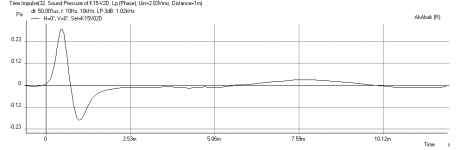

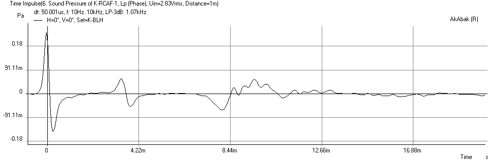

Impulse response of this speaker is what kills it. Huge group delay and multiple peaks make it very "tomb like". It may have something to do with the fact that the end of the horn mouth is a flat wall - reflection from end?. It may improve things to taper it down so that the CSA goes to zero as the K-slot grows to max width. I would also flip it around so that the large mouth aims at the floor for enhanced bass coupling to the floor. A major redesign for sure.
See the impulse response calcs here:

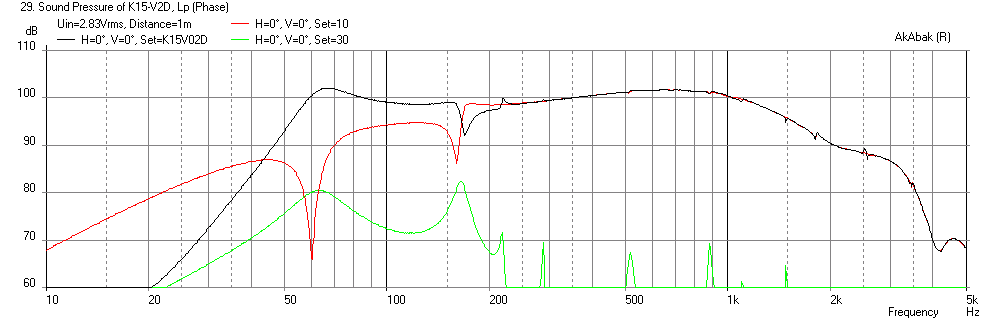

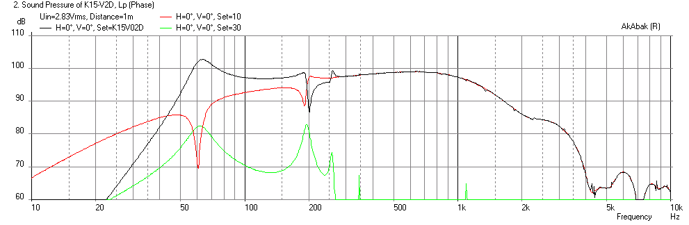

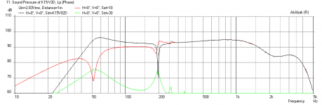

The W8-1772 appears to be a fine performer in a K15 scaled by 12/15. It reaches 60 Hz and has a flat response in the high to mid 90's dB out to 1.2 kHz.
can you easiy truncate the 12/15 k15's vent to half height? (and area) - just wondering if it can lose vent area, flatten the bottom, and not lose the nice midrange. I'd like to find someone to cut some 0.8 scale K15s.

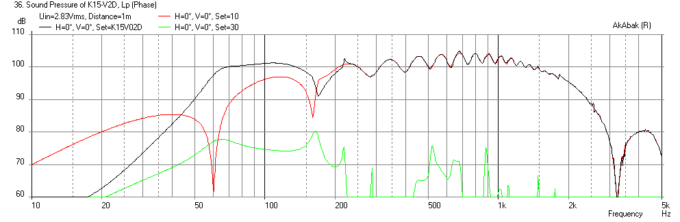

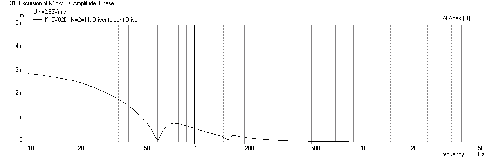

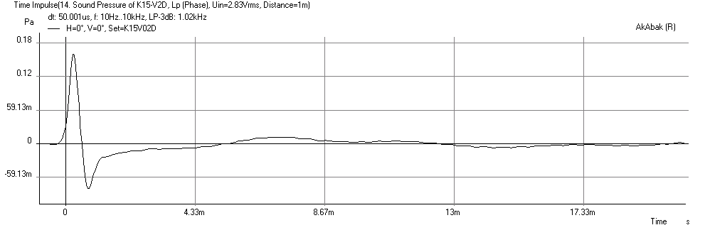

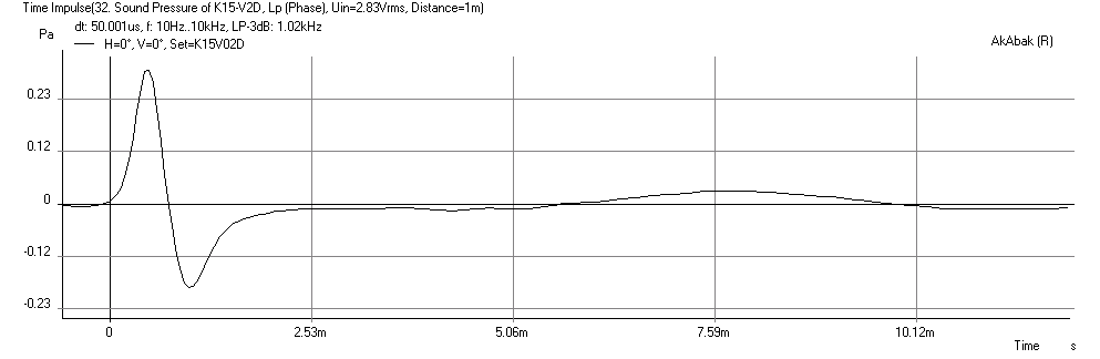

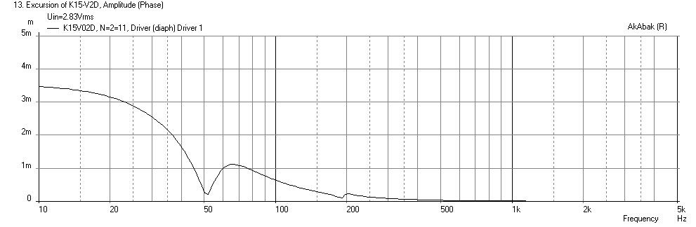

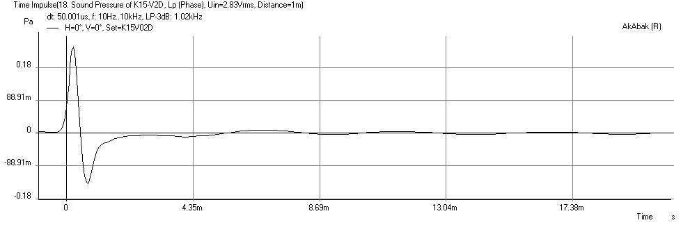

K15 scaled to 12/15 and 8/15 in width with Lowther PM6C and TB W8-1772
Freddi,
Your question about putting a Lowther in a Karlson probably makes some Lowther-centric fans shudder at the thought. 🙂 However, I have never tried a Lowther in any of my models before, so I thought what the heck? Doesn't cost me anything other than typing 10 lines of T/S params.

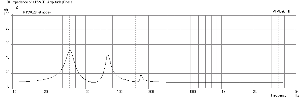

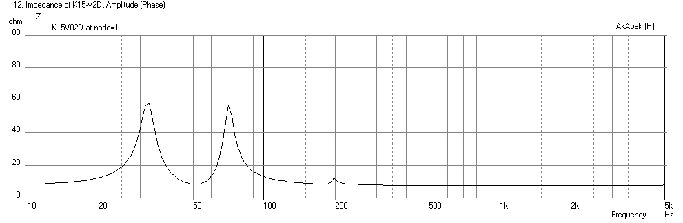

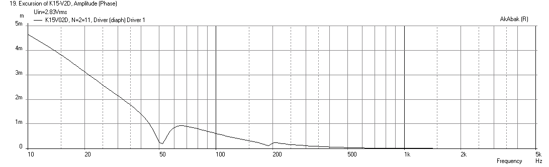

Well, as it turns out... the PM6C was almost made to be in a scaled down K15. I scaled the height by 12/15. left the depth alone at 15/15, and scaled the width by 8/15 - so it will look kind of tall, deep, and skinny compared to a normal Karlson box. It needed the volume reduction - similar to your earlier question about the W8-1772. The W8-1772 is also ideally suited for the same box as you will see. Given the cost disparity - the W8-1772 could be called a "budget" Lowther - though it is debatable if a $230 driver should ever be called "budget". The W8-1772 also has the Lowther beat on being an easier load to drive as the impedance curve is smoother and not as peaky. We are now able to achieve usable bass extension down to circa 45 Hz (at 90 dB). The real beauty of this speaker is the transient response as shown by the nearly ideal impulse function which looks like it is operating in a sealed cabinet. The attack and decays, kick drums, etc will be amazing with this speaker.
SPL vs Freq for Lowther PM6C in cabinet with 12/15 width
SPL vs Freq for Lowther PM6C in cabinet with 8/15 width

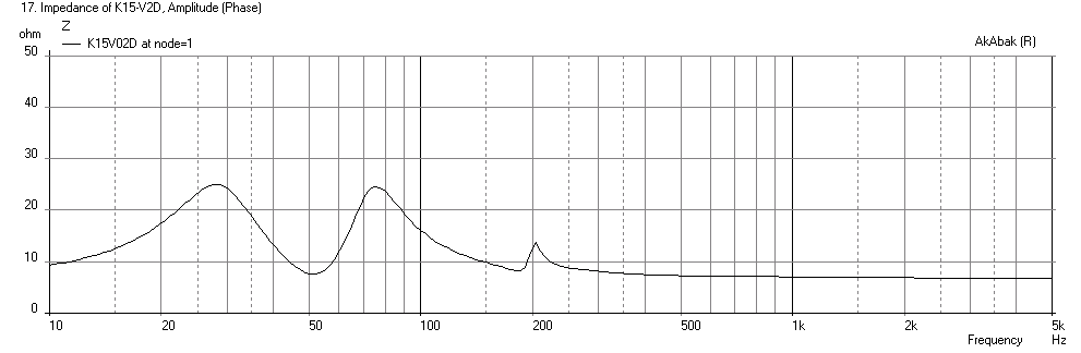

Impedance for PM6C with 8/15 width

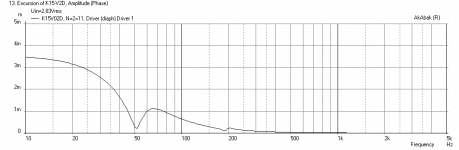

Cone Displacement for PM6C with 8/15 width
Impulse Response for PM6C with 8/15 width

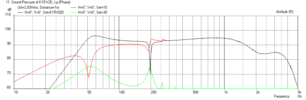

SPL vs Freq for TB W8-1772 with 8/15 width
Impedance for W8-1772 with 8/15 width
Cone Excursion for W8-1772 with 8/15 width
Impulse Response for W8-1772 with 8/15 width
So, when are you going to build a skinny K15 scaled to 12/15 and 8/15W? This looks really promising.

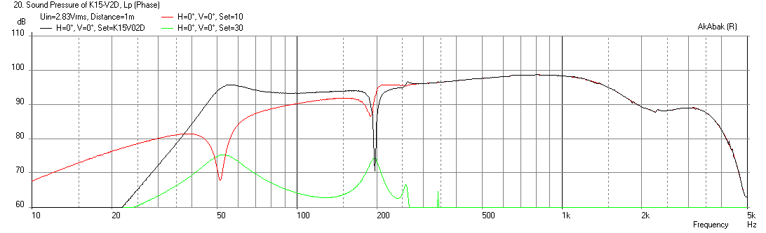

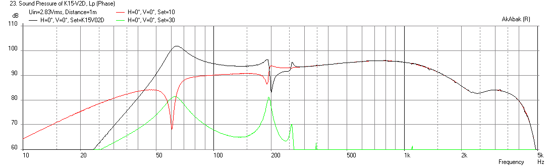

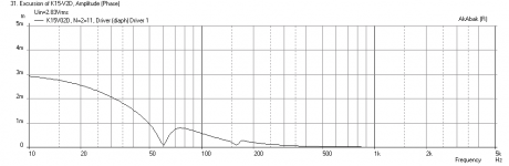

Freddi,
I was looking all over the Web for the T/S params for the AN10 and duh, realized that you had measured it and posted it below the picture. Why doesn't Common Sense Audio post the T/S params??? Too much variability in manufacture?
Anyhow, I put it in the K15 model and WOW this thing Rocks! 100 dB sensitivity and smooth as butter. Reaches 93 dB at 50 Hz - not bad at all.
SPL vs Freq (far away from walls - like in a stadium)
Impedance
Cone Excursion
Impulse Response
SPL vs Freq (48 in away from back wall and measured at ground plane)
AN10 sounded much better overall in K15 than a reflex. Its rather rough as a reflex and had very little power handling. Putting it in K15 kept output good within the plus and minus 1mm xmax spec. It could play some hiphop bass without bottoming out plus vocals ranging from Mario Dwhiel Monaco to Porter Wagoner were very nice. Its too bad the Karlson wasn't picked up by the fullrangers -- they seem fascinated by pipes and reflex and consider those holy while not being able to grasp that all speakers are flawed one way or another and that the Karlson approach has some useful virtues . K15 sounds great in general on harpsichord, sax, piano - about anything. I would like some new K's which are smaller than K15 - and perhaps something similar to K15 sans the front shelf. I need a cabinet builder!
